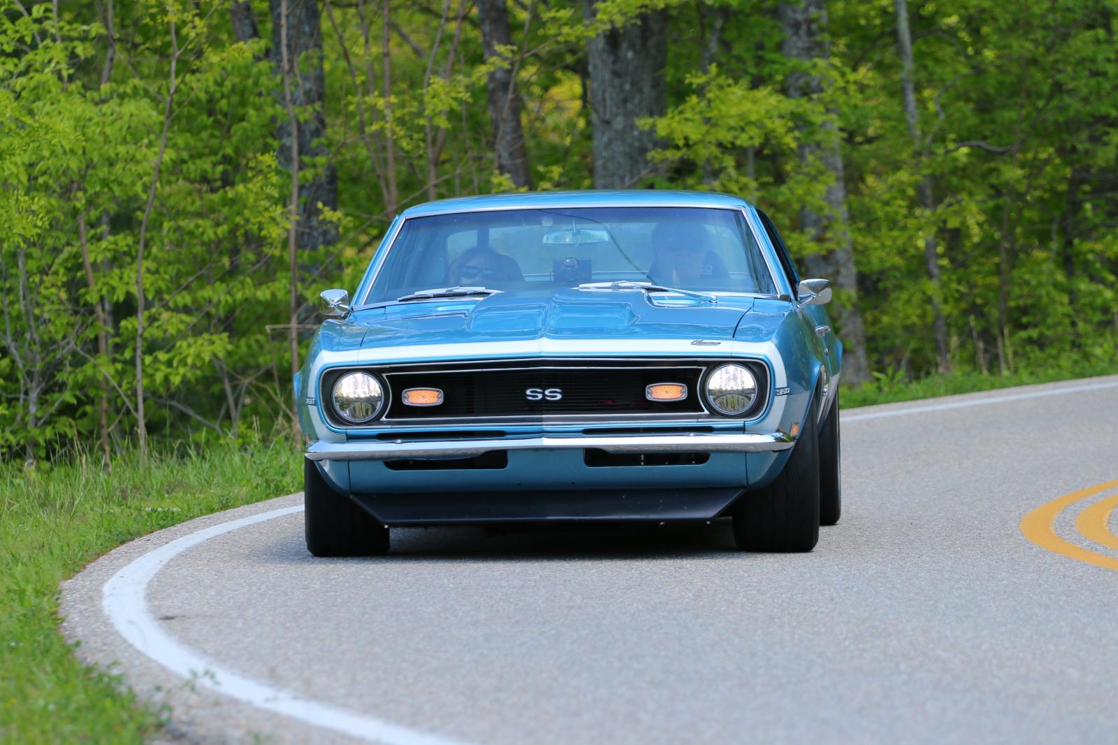

      I am totally happy with my Trucklite 27270C LED headlights. I don't think they look bad at all in a classic muscle car. I'm told by lighting experts that the light beam could be focused better but since they are orders of magnitude better than the old incandescent H4s they replaced, I'm not too concerned.

      Those don't look bad at all, too bad there isn't a 5.75" version available.

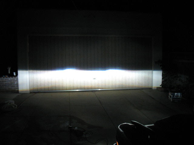

      If you're on the ambitious side and like the high-tech look, you can do what I did... swap in some late model projector housings...
      http://ultm8z.com/HID%20Projector%20...n%20Camaro.pdf
      https://www.youtube.com/watch?v=uQOI...ature=youtu.be
      https://www.youtube.com/watch?v=eAsQ...ature=youtu.be
      Since the time I wrote that up, I've done a few mods, like change over to D2S style LED bulbs from the Retrofit Source. Between the LED performance and the well designed Acura TL projector housings, the system now literally blows away my wife's 2017 Infinity SUV (especially with the high-beams).
      The video also shows the old xenon bulbs with their glacial warm-up time (which I always hated). The LED's are instantaneously at full brightness. But the physical look from the outside of the housing is the same, which is why I posted it... in addition to the fact that you can do all sorts of things with other LED accents once you make the change over.
      The picture below was with the earlier xenon bulbs. But, it doesn't do the LED light quality any justice... the LED's make even the xenons look ancient (and that's saying something).
