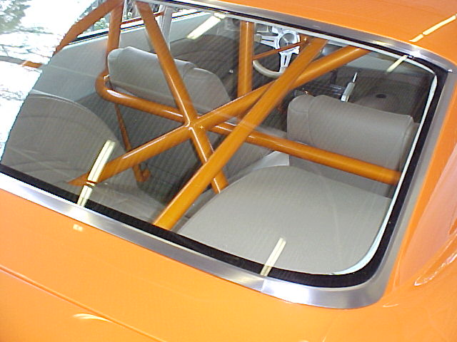

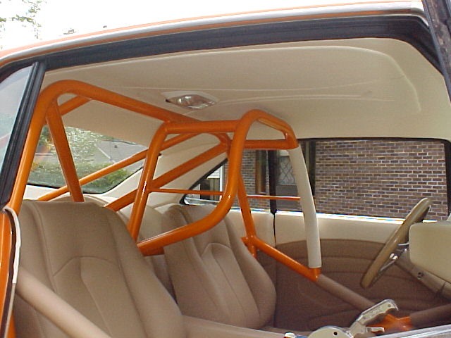

      heres one
      Oct 2005
      pennsburg , pa
      38
      roll cage
      69 camaro---
      Apr 2003
      chbg, pa
      1,157
      nice cage , definately not street friendly . That is a drag car right ? did you smooth the welds ? how will sunvisors work ? I assume this is now a 2 seater
      Nov 2003
      Paradise, Ca
      1,411
      ...And I hope you realise that no sanctioning body will let you run a cage with smoothed welds, if, by their rules, you're required to run a cage.

      thanks for the complement the car is not a drag car it is being built pro touring and i did smooth the weld but i did so w/o grinding the welds downi looks better for the shows. i have not yet got to the point of the sunvisors but i will figure something out also the back seat will be installed and functional.
