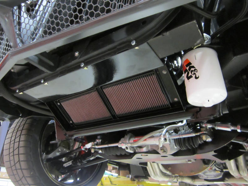

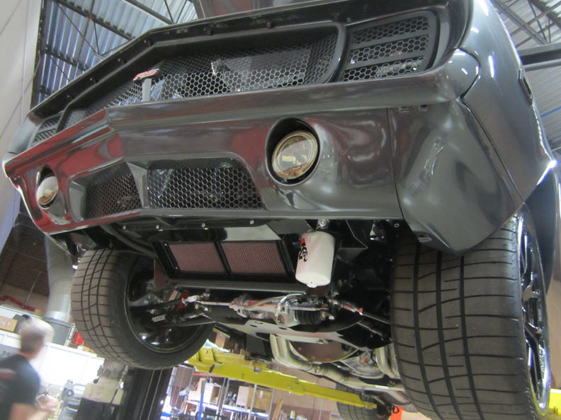

      Here's a look at the bottom side of that cool custom air intake, a trick air filter box that's fed from underneath away from engine heat. Also seen is the remote oil filter location, part of the set up with our road race and dry sump LS oil pans. Next up is a custom air dam and splitter that will help guide air to the filters and provide the necessary down force at higher speeds.
