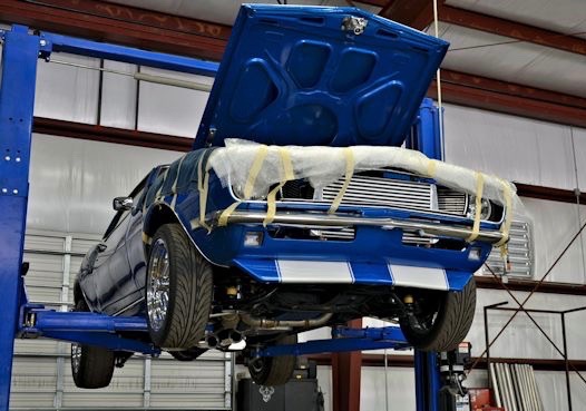

      I have the front mounted inter cooler, pipes run under core support. I had to change my hood latch from the style that comes on them to the one in the picture with a lokar cable release which I like better.
Size:  407.5 KBName:  T5 14Apr15 2.jpg
