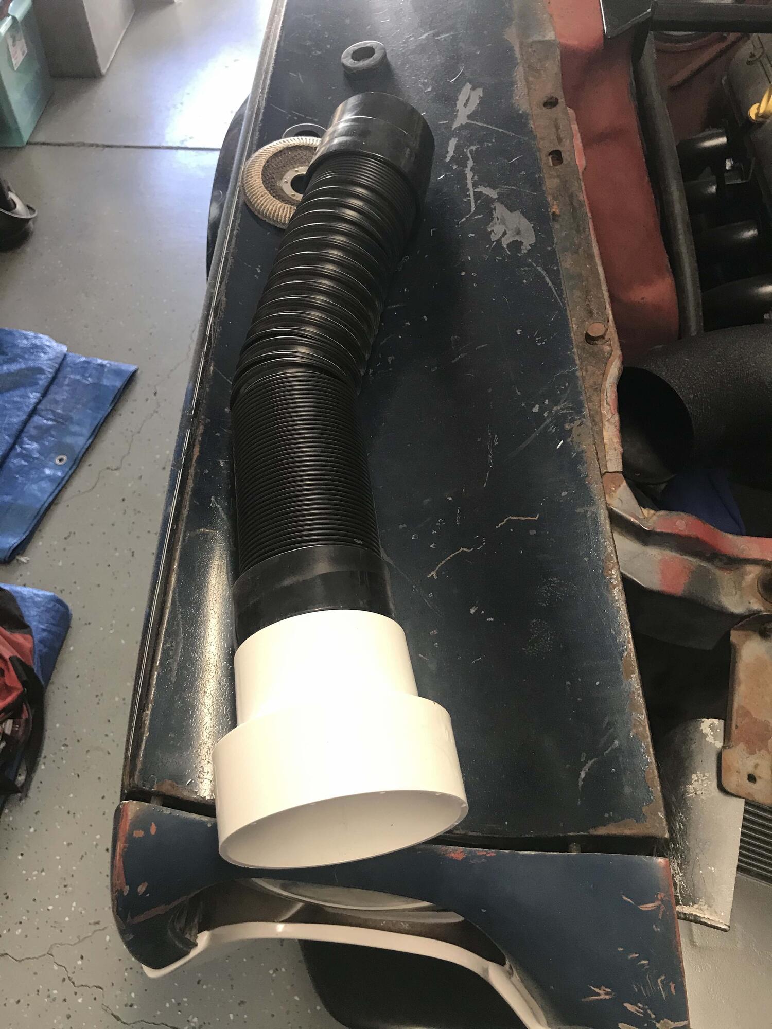

      Life always throws curve balls at us when building cars, but any progress IS progress in my opinion. My plan all along was to use the headlights with integrated turn signals in them and turn the turn signal holes into brake cooling ducts. A trip to home depot came up the PVC reducers that fit the hole perfectly. I then trimmed them down to fit the curves of the bumper, and installed some ram air tubing and sleeves that just happened to fit beyond perfectly.I'll paint them later. I went backwards a bit when I found out the pass side strut rod bracket is wallowed out and I have two of the same side strut rods. Although I did get the drivers side bracket restored. Next up is the rear springs and bushing replacement.

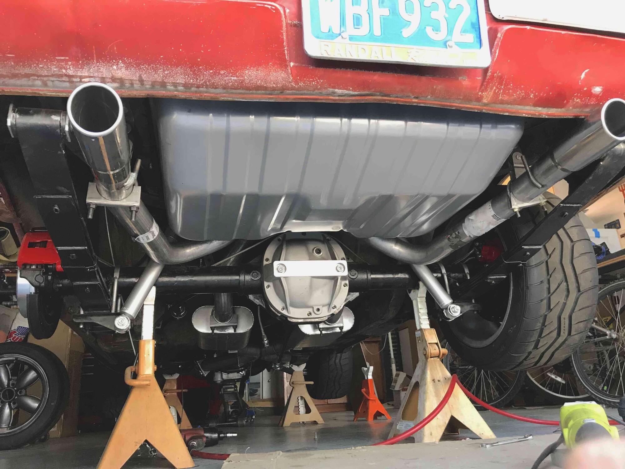

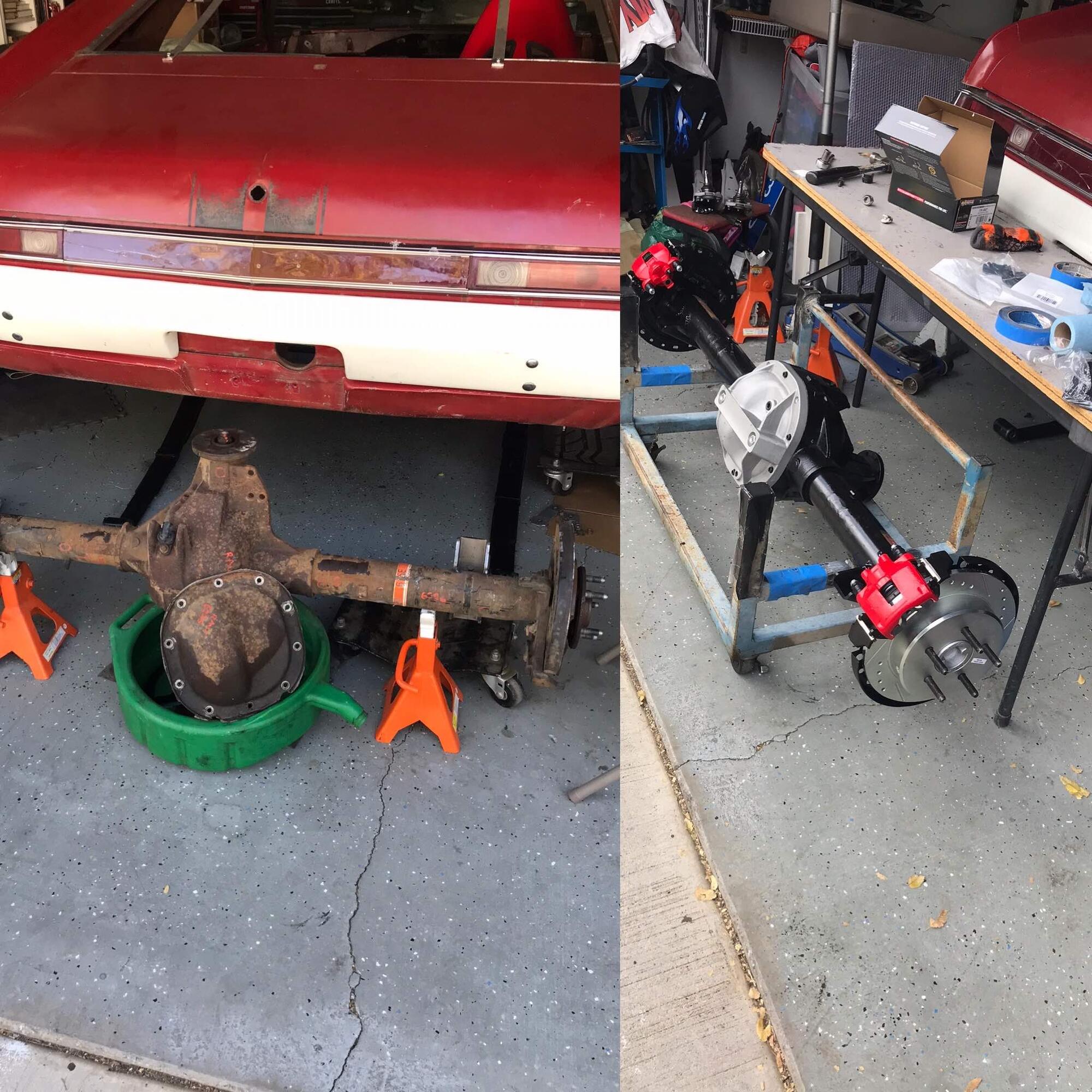

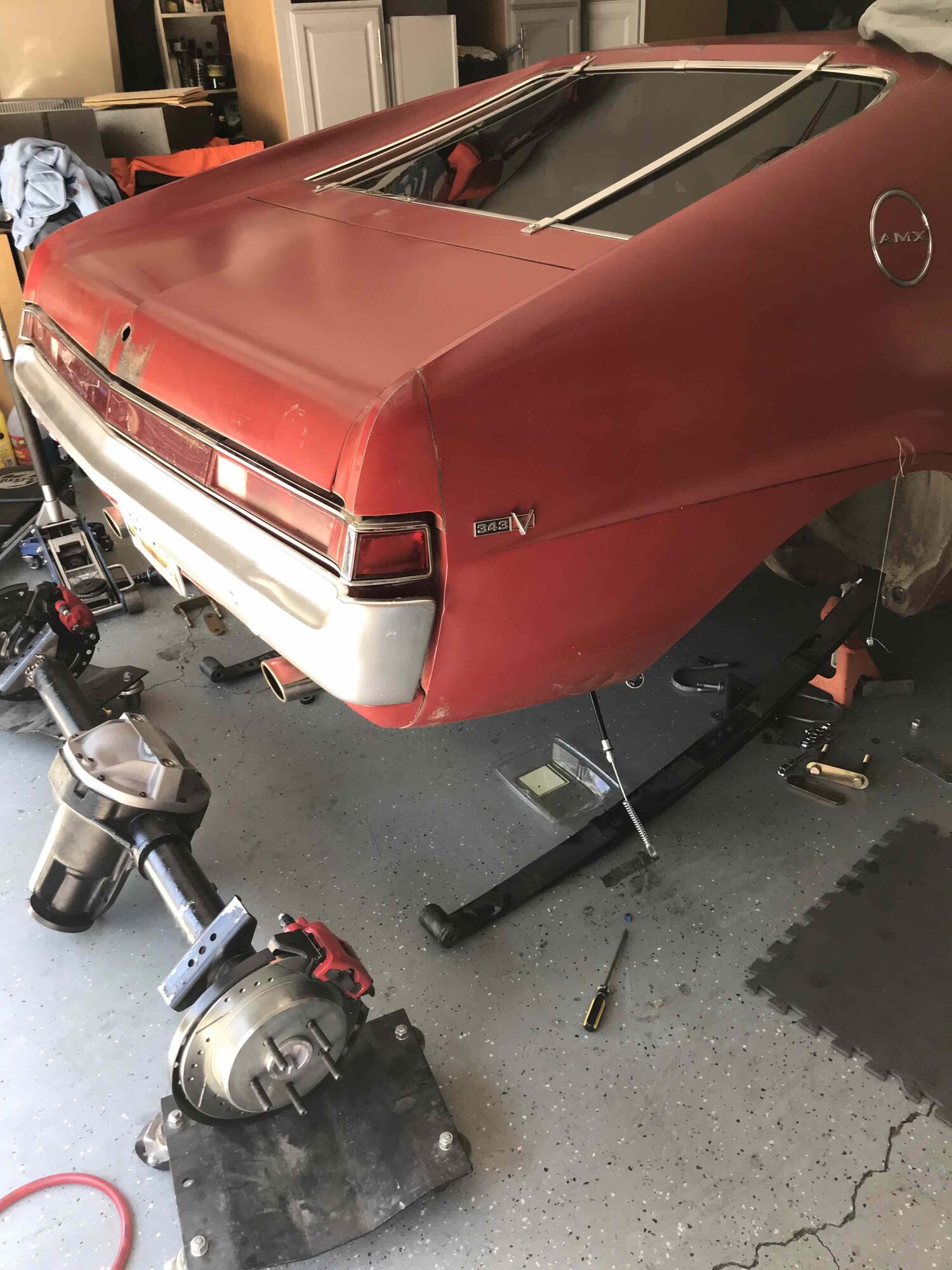

      This update: I got the rear end mostly done, long wheel studs installed along with new brakes and seals. Its a regular width 8.8 from a 2000 Explorer, with 4:10 posi. I didn't need to narrow it with the wheel offset I'm running as it centers them almost exactly in the wheel wells. I cleaned up the original Go Pack HD springs and replaced all of the bushings with Polygraphite. The spring hangers were mopar offset hangers, that I had to unoffset to locate the spring properly. New HD polygraphite hangers are backordered but will be here in Dec. I'm going to fit a center pull ebrake from a Mustang and use the factory Explorer e brake cables. The front end kit should be here soon! Next up I have to pull the drivetrain out to fix a stud, clean some things up and weld in the trans tunnel.

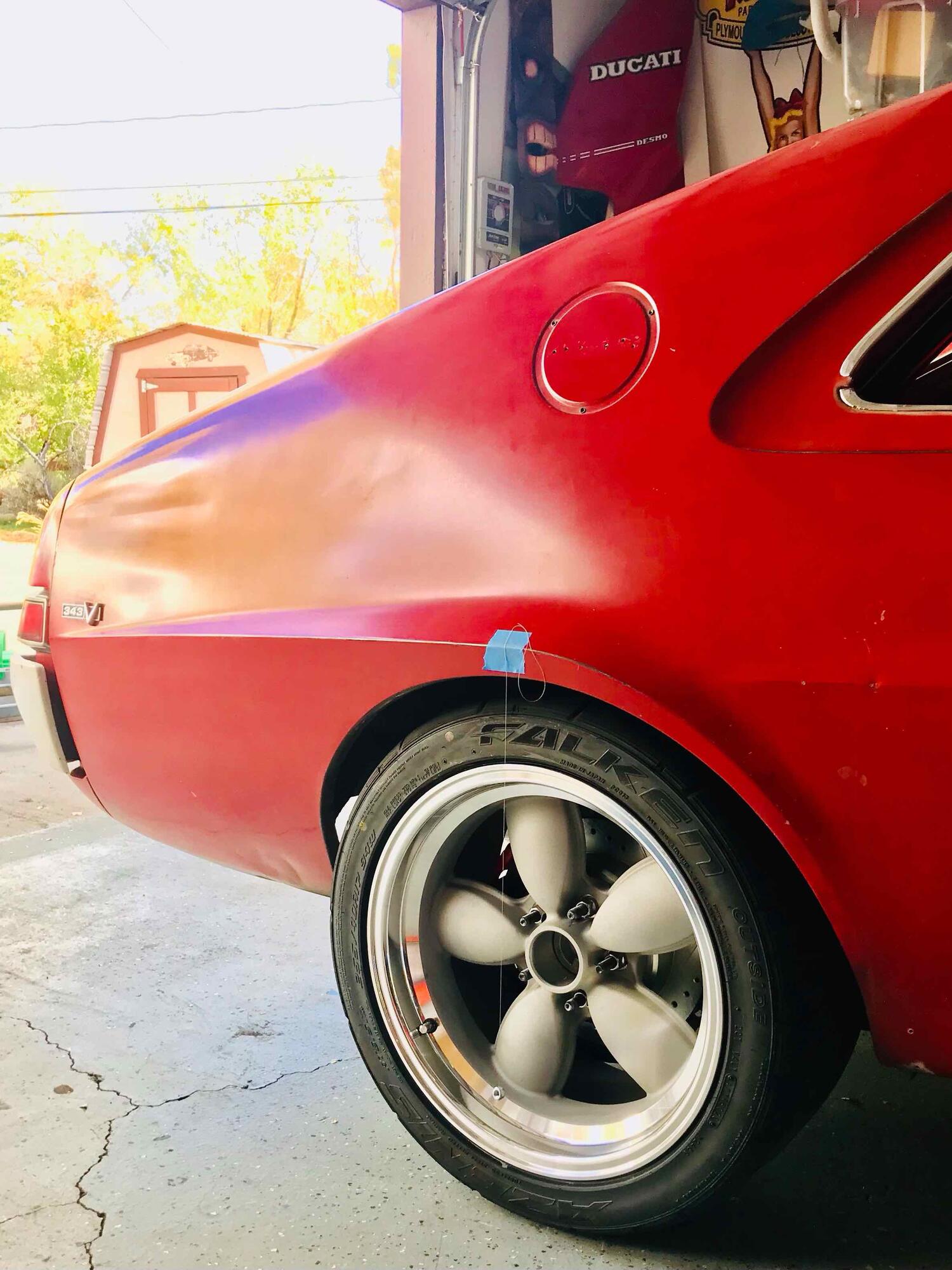

      The back end is getting there, but it needs another inch drop in my opinion to close up the gap on top of the tire. But that will have to wait until it is running and driving at its full weight.

      Definitely wait until it's on it's full weight, but I think the gap looks just right.

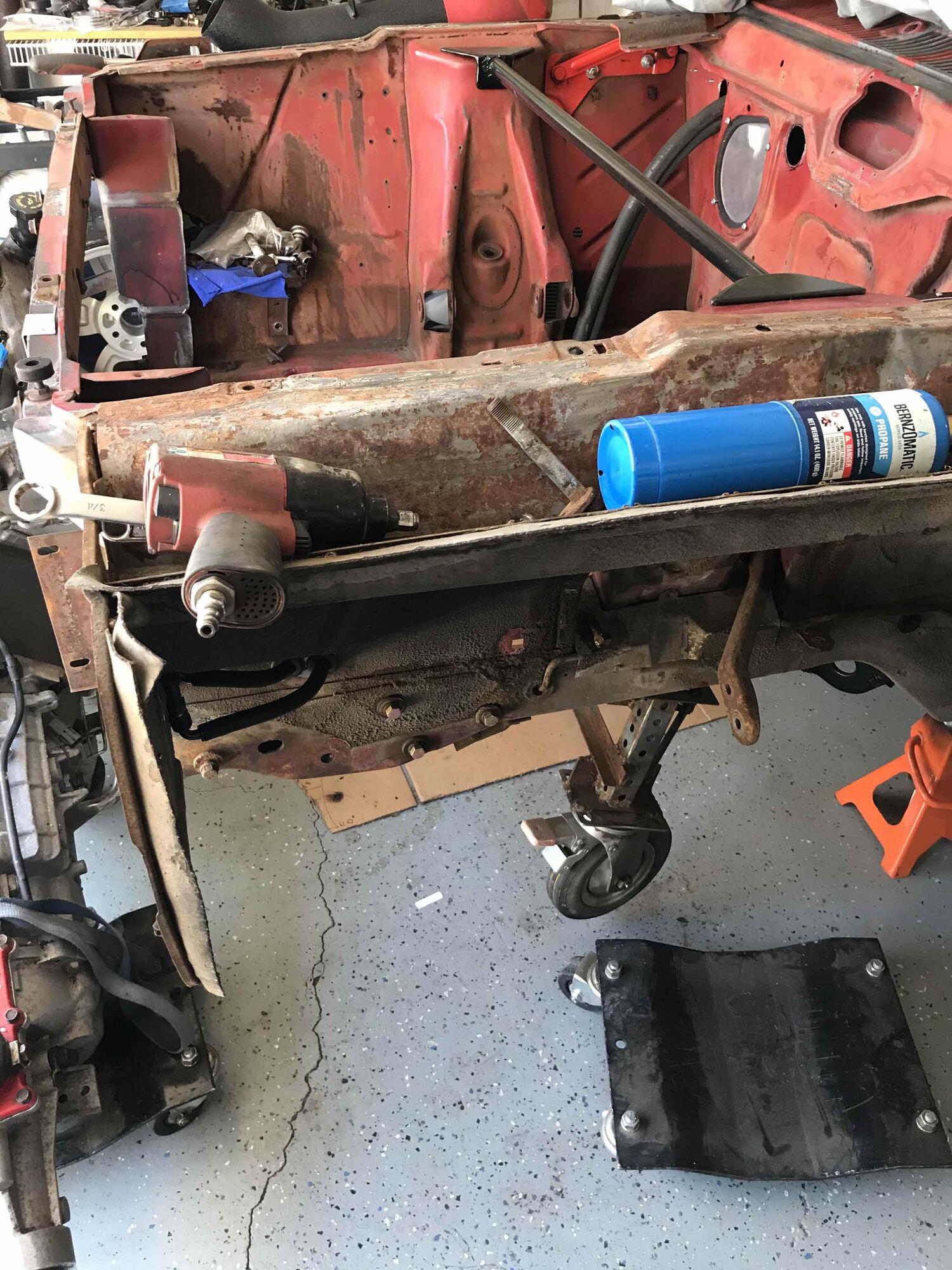

      Winter is over and its time to get back to it. Santa brought me the best present I could ask for, my front end kit from mike343sharpstick!! The drivetrain came out so I could rebuild/ restore the front end components and replace old worn parts with new stuff. I also had to fix a broken exhaust manifold bolt on the back of the head, thank god that one is finally done! Next up on the shortlist is removing the last of the undercoating from the front end and trans tunnel. Then mounting the front kit and welding up the trans tunnel.

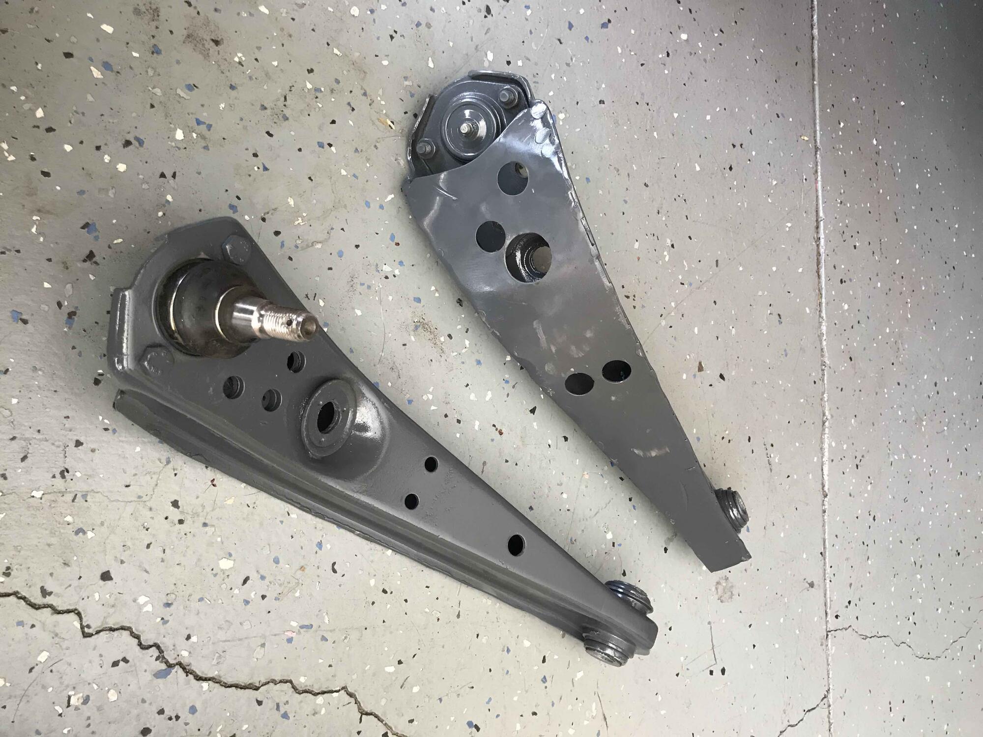

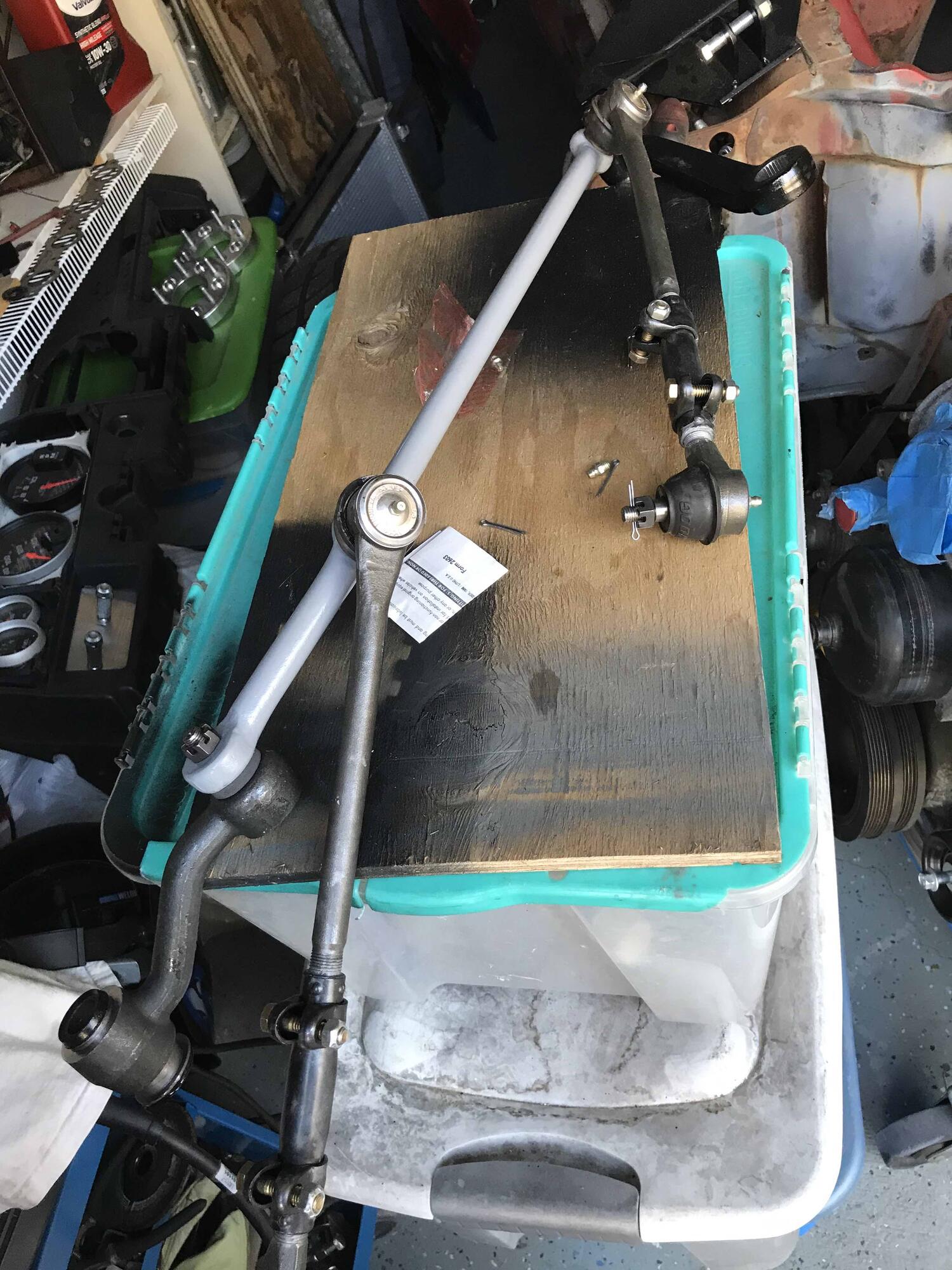

      I found out that I had 2 right side strut rods and not a left side along with a pair of 70's. I finally found the correct left side 68/69 AMX/ Javelin strut rod. So now I have all of the pieces to put the front end back together. I went to pick n pull today and got myself the 8.8 u joint flange and I have ordered the correct u joint to make the Camaro driveshaft and the 8.8 work together, once I get it shortened and balanced. In doing some research on installing my Accusump I ran across this bitchin piece that has a -10 AN line fitting that replaces the factory oil cooler plate above the oil pan. Things are coming along nicely!

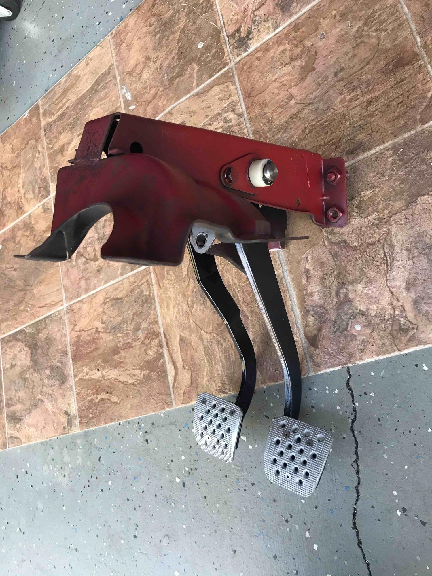

      I got the tunnel welded in and seam sealed. I just need to finish off the cover for the shifter. Trans x member, engine x member, radiator cover, strut rods, and more have been cleaned & repainted. Pedal assembly restored to factory appearance, pedal covers recycled to cover up the different sized pedals. AMC used a primer/ coating that looks browish black with metallic in it. Closest I have found is Rustoleum dark oil rubbed bronze, then flat clear shot over it.
      Undercoating has been removed and cleaned up on the front inner fenders, using a heat gun and regular charcoal lighter fluid to easily remove the residue. Suspension brackets installed. Accusump mounted and line to the front ran. Engine compartment paint rubbed out, although AMC did a real half ass job painting those. Up next is installing the front crossmember, drivetrain assembly, front suspension & brakes. Everything can now go back together for the final time.

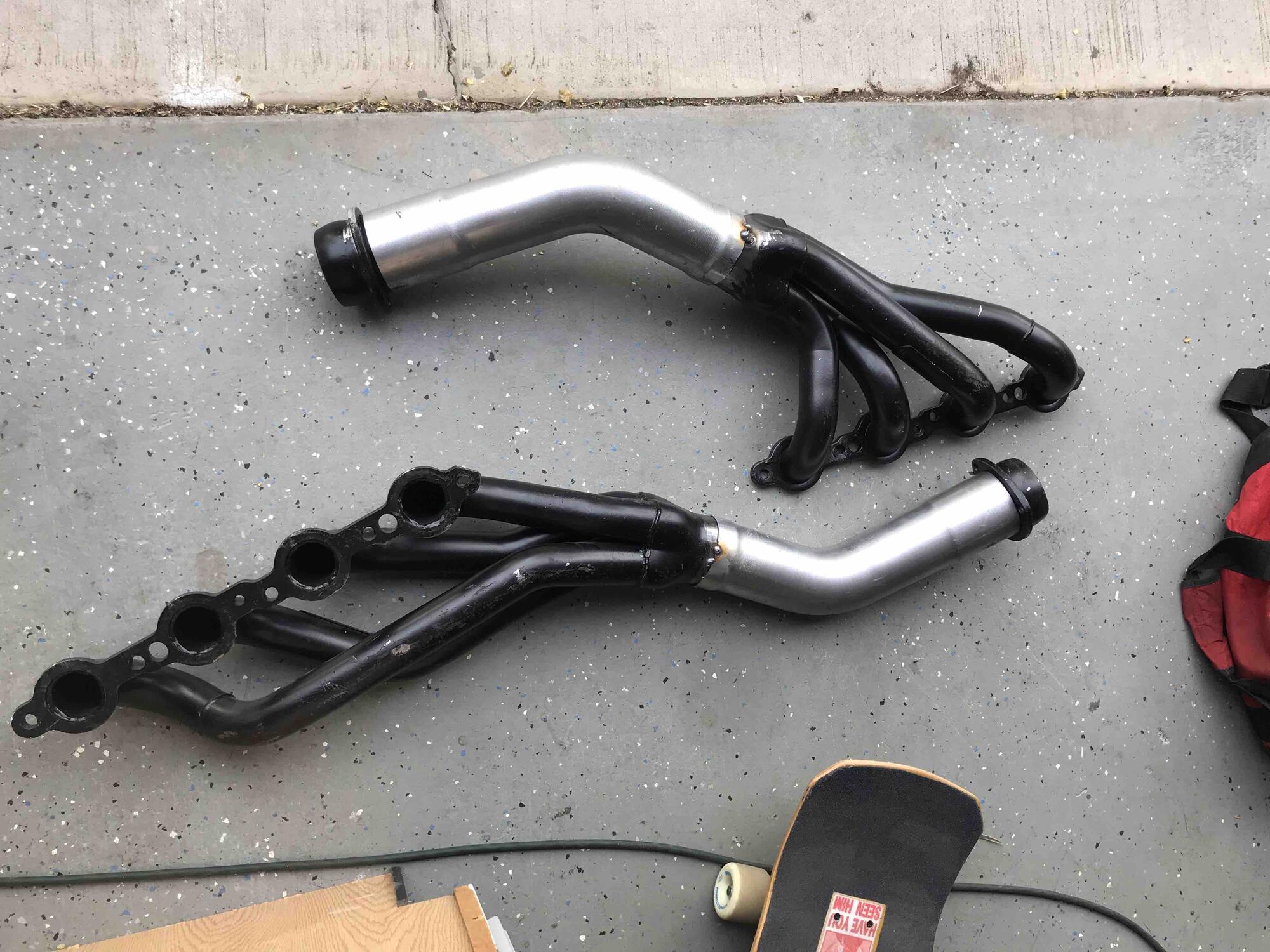

      Lots of progress and final assembly. Basically everything from the firewall forward is done with the exception of bleeding the brakes and clutch. I made my own longtube headers and built a full x pipe exhaust system with pieces from Summit. Its a couple of flex pipes at the collectors, an x pipe kit, flow master knockoffs, and a couple of 5.0 Foxbody tailpipes (which were $55 ea!). It is really nice having them a few miles away and I'm usually there once or twice a week getting parts for work builds. I painted the wheels, added a 1/4" spacer up front for clearance on the balljoint. Caster, camber, & toe is set and I got some sweet spherical bushings from Opentracker Racing for my strut rods. I have most of the wiring finished. The driveshaft was made and installed. Air intake is done and mounted and sensors added. Grille was fixed, repaired, restored, and topped off with a 70 AMX emblem that mounts in the center instead of the side. Fluids have been added and topped off. One of the best scores of my build was finding a pair of original "Randall Rambler" dealership license plate frames. They were the AMC version of Mr Norm/Yenko/Royal. It is almost time to fire it and then drive it!!
