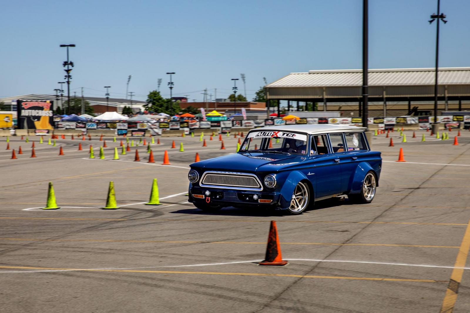

      great to see another AMC product being built, looks like the weird cars are coming around finally, I built this one for my wife, Ls powered, engine set back into the firewall for a 49/51 weight balance, independent rear suspension, 315s on all 4 corners and the Viking electronic shocks!!
      keep building and keep us up to date, if you have any question let me know

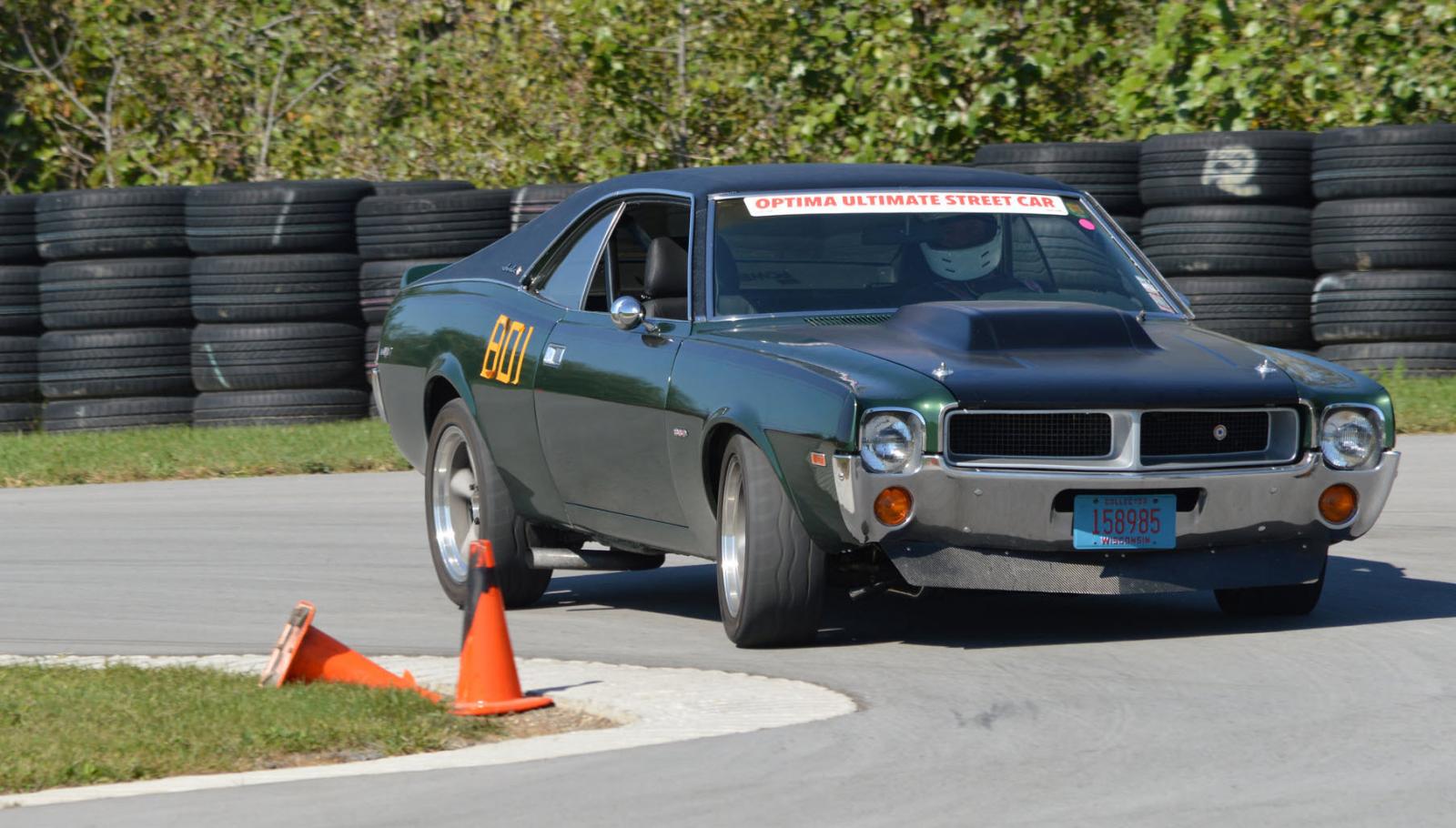

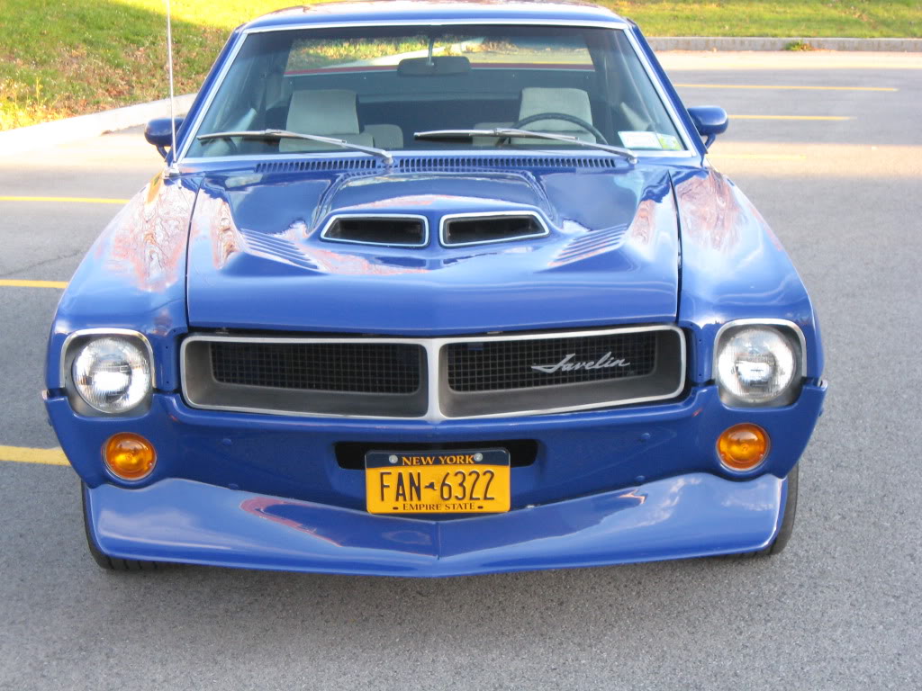

      The stance is looking great! Currently working on a stage2 kit for AMC's that will replace the strut rod and lower control arm.
      If you have seen a modern Trans-Am tube-chassis racer, you will notice that the basic configuration of the lower control arm and strut rod are very similar to the basic design concept of the AMC, however it's executed with much better hardware to say the least, ;)
      Also, One of my customers is using the ridetech TQ series remote reservoir triple adjustable shocks.
      Interestingly that car is getting built by a shop in Mesa Arizona, near you? for an owner in the UK.
      The wilwood master is a direct bolt-in on an AMC. You will need to fab up a rod-end and shaft to connect it to the stock pedal assembly.
      Also, for a front spoiler I used a '69 Camaro unit, then later added some carbon sheet to extend it down for an updated TransAM racer look. I expect to break it at some point so I wanted something easily replaced.

      Yes, I have seen that car, but not 'in person' yet. lots to like about it. I watched the build on-line and even watched the SEMA reveal. I actually prefer the smoother lines of the early Javelins to the humpsters. However with big wheels and tires those 1971 and later Javelins look good.
      I'm a huge fan of getting a car on the road, then evolving it from there if you can. Here in Wisconsin we have some long winters, so nearly every winter I would update the car.
      I got the car on the road in 2009 after a 2 year restoration. It was basically a stock-ish restoration with Automatic and the engine the car came with.
      I had some fun with the car which then gave me incentive to evolve the car to be better for the next season.
      Over the years I just made an update each winter. One year was the switch from Auto to 5-speed, another was an engine swap from stock 343 to road-race 401, Swap to a Moser rear axle assembly, and so on.
      I'm nearly done with this car, based on my definition of a 'Street Car' and the intent of the project. I'm to the point where all I need to do is a bunch of little things that I've not gotten to to, like getting the gas gauge to function, and a couple interior lights. I've learned so much on this that I've planned the 2.0 version of this car

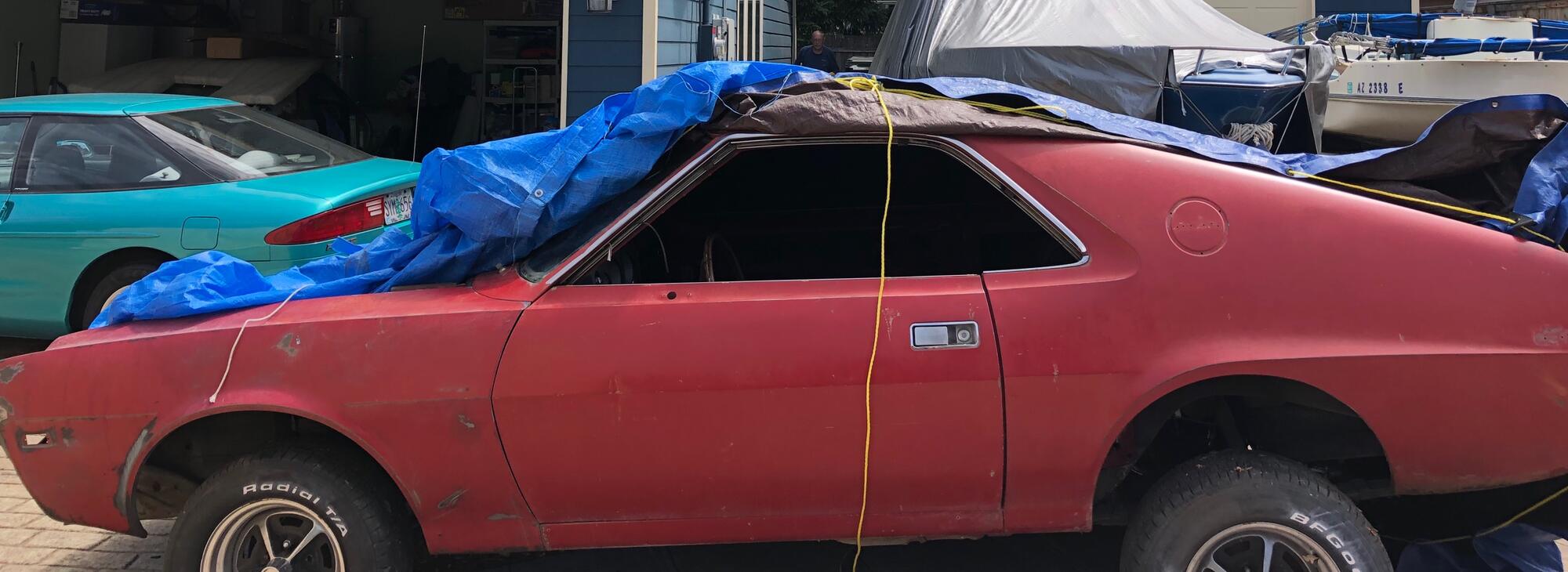

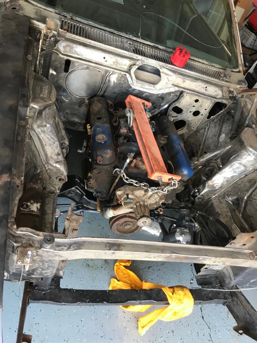

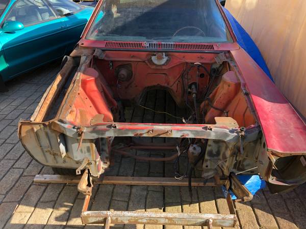

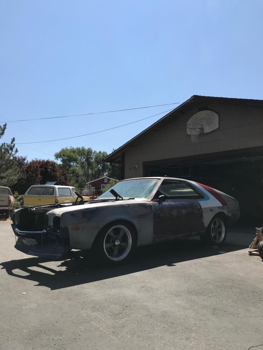

      Well, I apologize to everyone that was following this build thread, sometimes life has its own path for things. It hass been a few years and some things have changed. But I really like to see things get finished, so here I am.
      Quick version of my story: sold 68 AMX, sold 72 Demon and ALL of my extra parts, bought a 69 AMX, bought LS1 & T56 magnum, and have been collecting parts. Enter Kenosha Corncob 2.0
      Longer version. I realized my madness of putting a LA360 into the AMX would be a mistake. A friend came up with another friend to pick up a Duster I had and he made me an offer on the 68 AMX. After thinking about the offer for awhile I put together a plan that made sense (AT THE TIME) in order to get things done. I sold him the AMX and the extra parts I had for it, in order to get my 72 Demon finished. I had the car and almost all of the parts to finish it. I instantly regretting selling the AMX, but I know it has a good home. I finished up the Demon with all of the parts I had laying around, which helped to determine what extra parts I had to sell as well. My plan was to stick to my vision of the AMX I wanted to build. So I sold it ALL, the car, the parts, all of the extra Mopar stuff I have been holding onto for years. I made the decision to be completely done with Mopars and burn the boats, so to speak, to fund the AMX build. With the car and all of the parts gone I started searching for a replacement AMX. And in the summer of 2019 I found an ad for a 1970 AMX for sale in OR, that included a 69 parts car. Turns out the parts car was an almost rust free roller of a 69 390 car with original paint and a title to boot! He didn't want to cut it up for the 70 he had and was glad to sell it to somebody that was going to save it. It was perfect for what I wanted to do, so 2 weeks and $2300 later it was sitting in my driveway. It was missing many of the things that I wanted to replace anyways like the rear end, motor, trans, hood, side glass, etc. I found a good complete 2001 Camaro SS LS1/6spd takeout package on Ebay. Fast forward to today and have gathered up almost everything I need to get the car car going. All while sticking to a low budget and being patient waiting for parts deals to come up.Name:  Found2.jpg

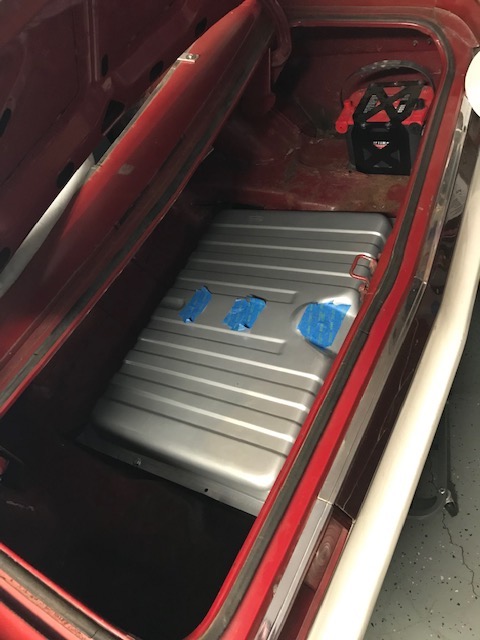

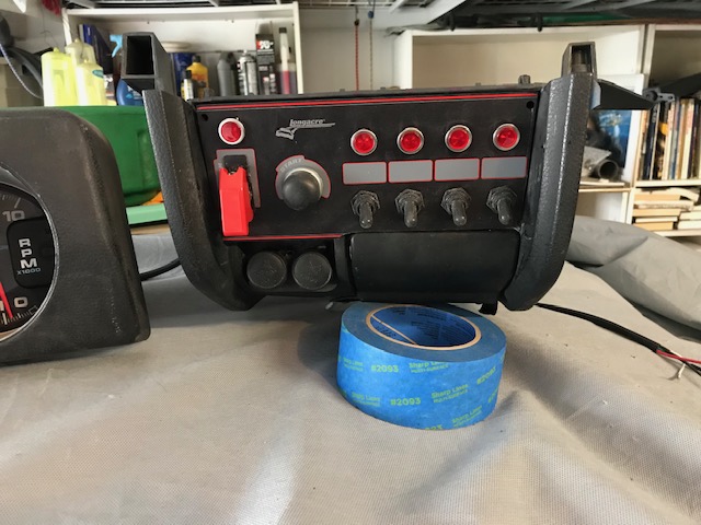

      Brief update: The gas tank is in and mounted in a steel frame, along with the battery. Dash cracks and breaks have all been reinforced and fixed. Gauges fitted into their prospective locations, the wiper and light switches will go on a plate where the original heater controls were. I'm getting rid of the stock heater/ defroster for smaller and lighter "hot rod" style, with a much smaller control switch. Radio pod has been modified to mount the ECU, switch panel, and now has 2 lighter sockets. The fuse panel will also be going behind the dash, so most of the wiring should be out of the way but easily accessible. I was also able to finally find a NOS front spoiler!Name:  AMXredtank.jpg
