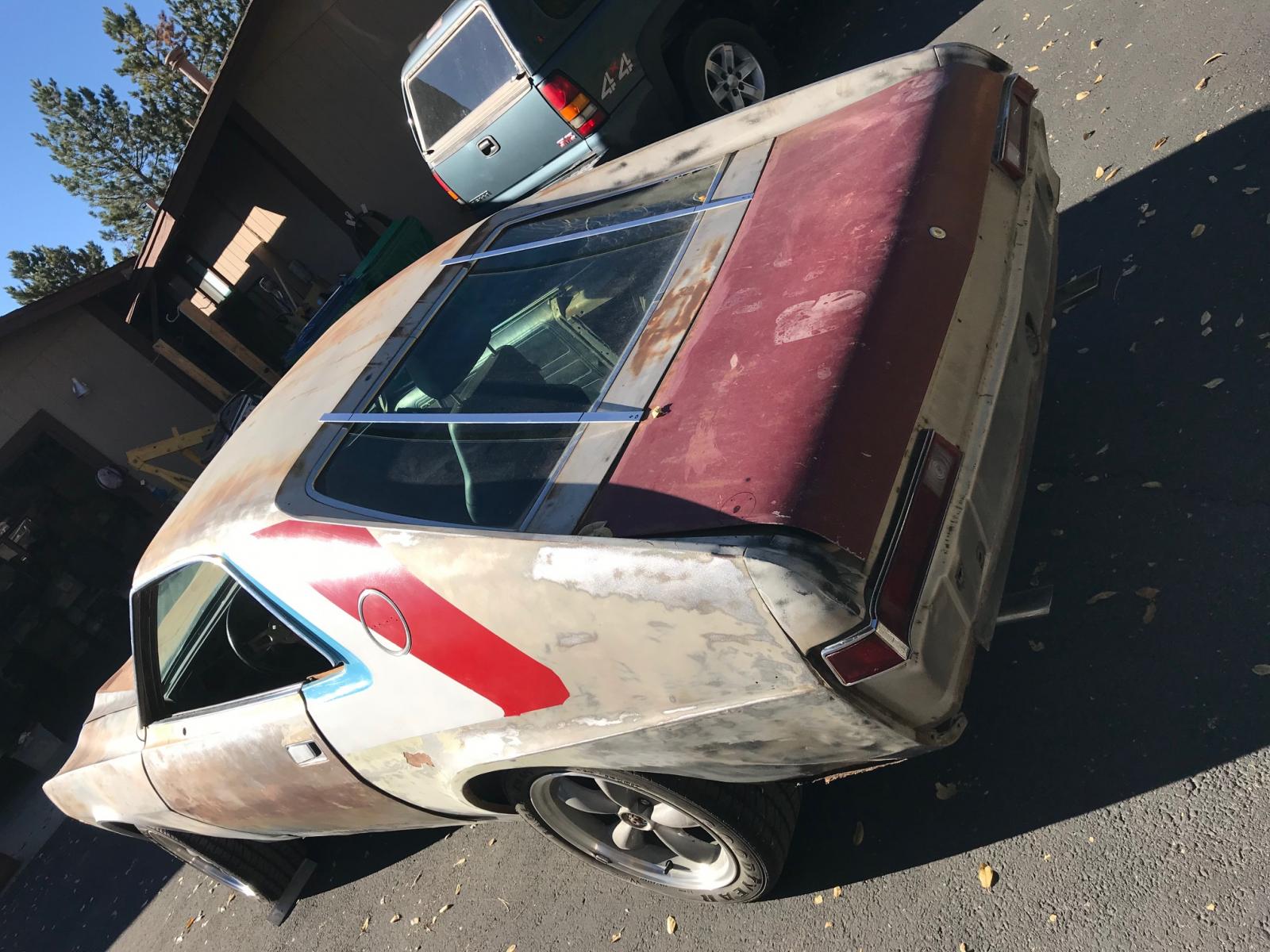

      In an effort for some inspiration I rattle canned the sail panel the red, white, and blue layout. Figured it couldn't hurt since it was 6 colors already, I mean whats 3 more at that point!

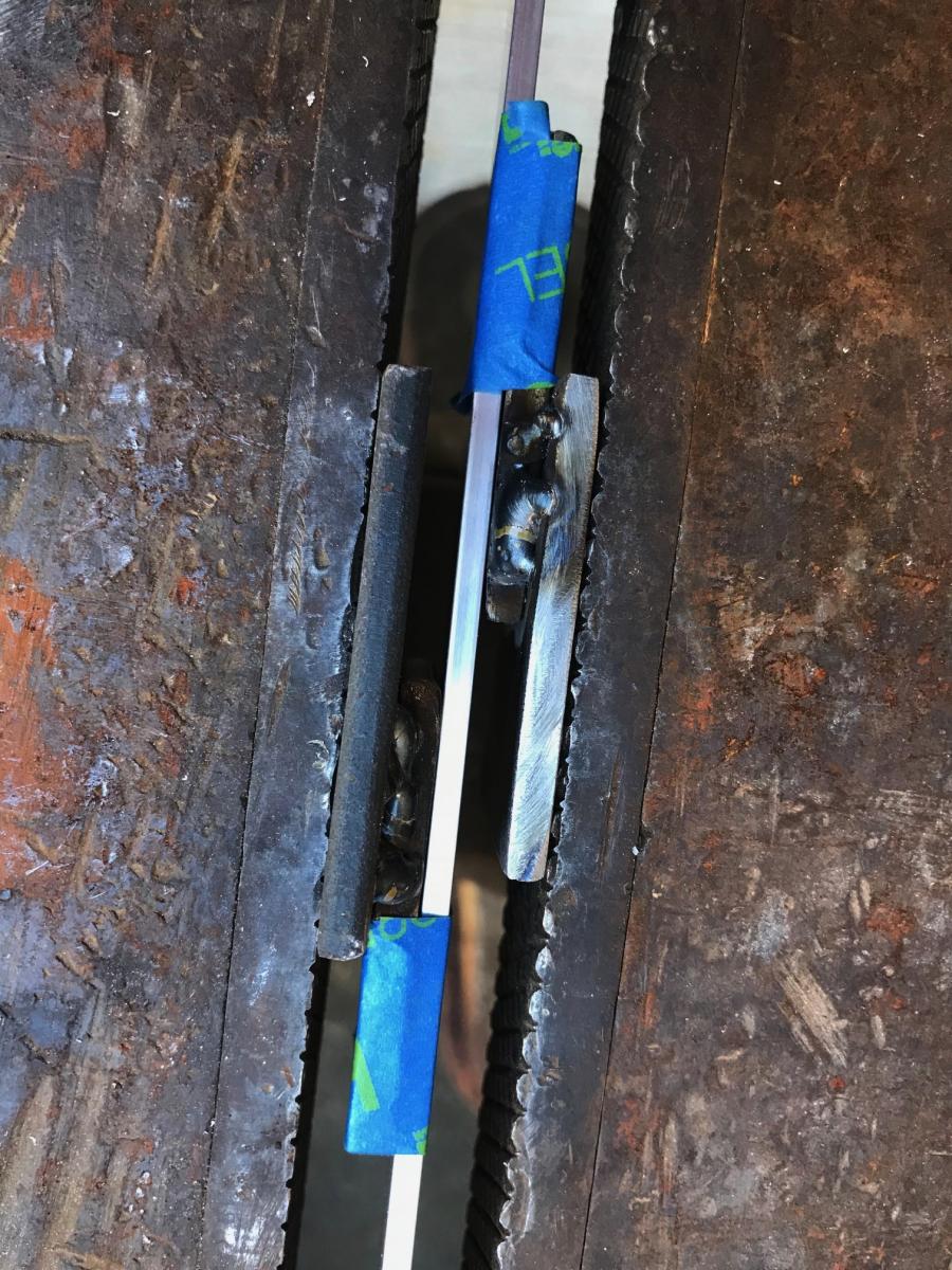

      Quick update, how to make window straps.
      Get a 4 pieces of scrap metal, cut 2 pieces roughly the width of the aluminum. Weld them to the other to pieces of scarp squaring them up and leave some over hanging off of the ends. Grind flush.
      Now you have the dies for your step.
      Put one on the line where you want the bend to start, tape it on to keep it tight. Put the other die on the opposite side, with a little gap between the dies to help form the bend, tape to secure.
      Take them to the vise and close it tight. Now your step is done.
      Take the tape off of one side first, turn it 180 then slide it down to the other end of the strap, this will keep you from having your step going the wrong way. Then repeat the other steps and you're done.

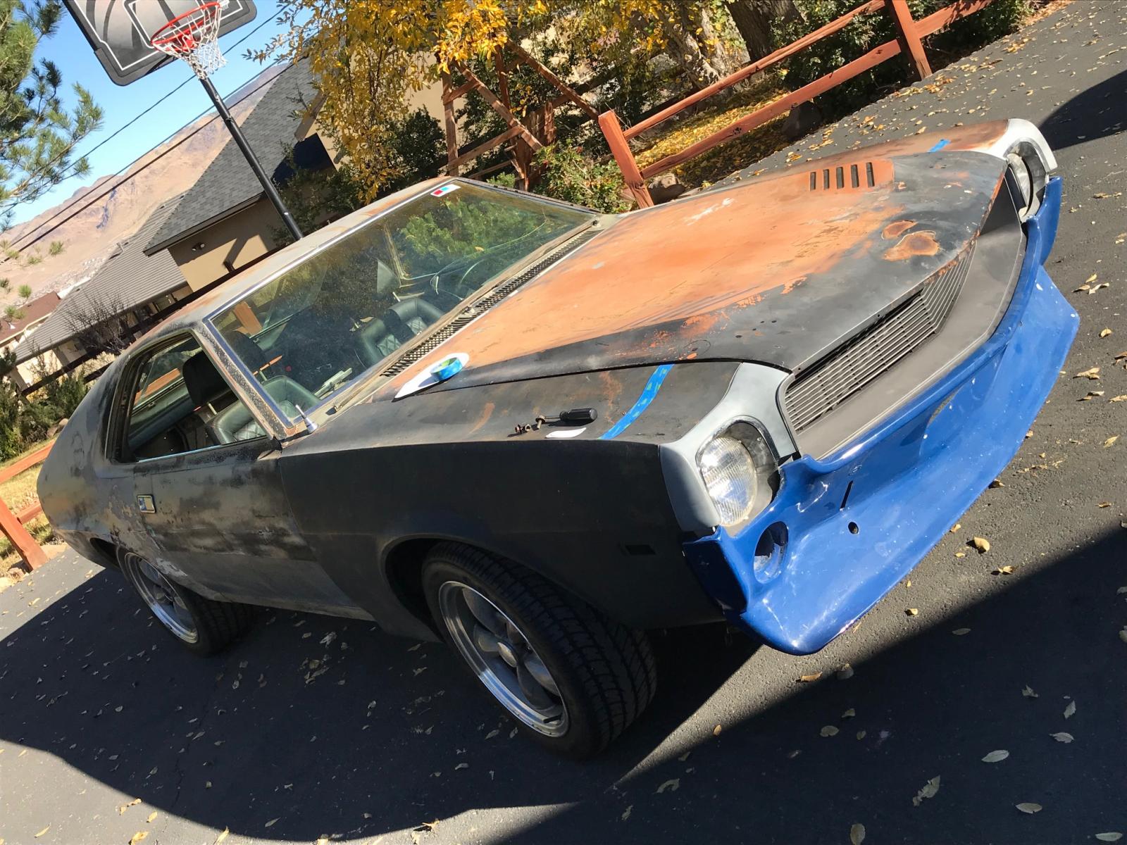

      Progress update: I got the car running and driving, trans was bad. I did drive it around the cul de sac in reverse with no brakes. I'm committed to the LS swap now that I found a buyer for the engine and my trans was toast. Glad to see the motor going into a nice 68 AMX that needed an engine. The front suspension should be here soon, disc brakes are waiting, rear suspension is going in this week. I got the crunched panel removed from the passenger side and welded in the replacement today.
      Short term list: cut out & replace drivers side lower rear 1/4. Remove trunnion set up and swap in new A arm set up. Mock up front brakes.

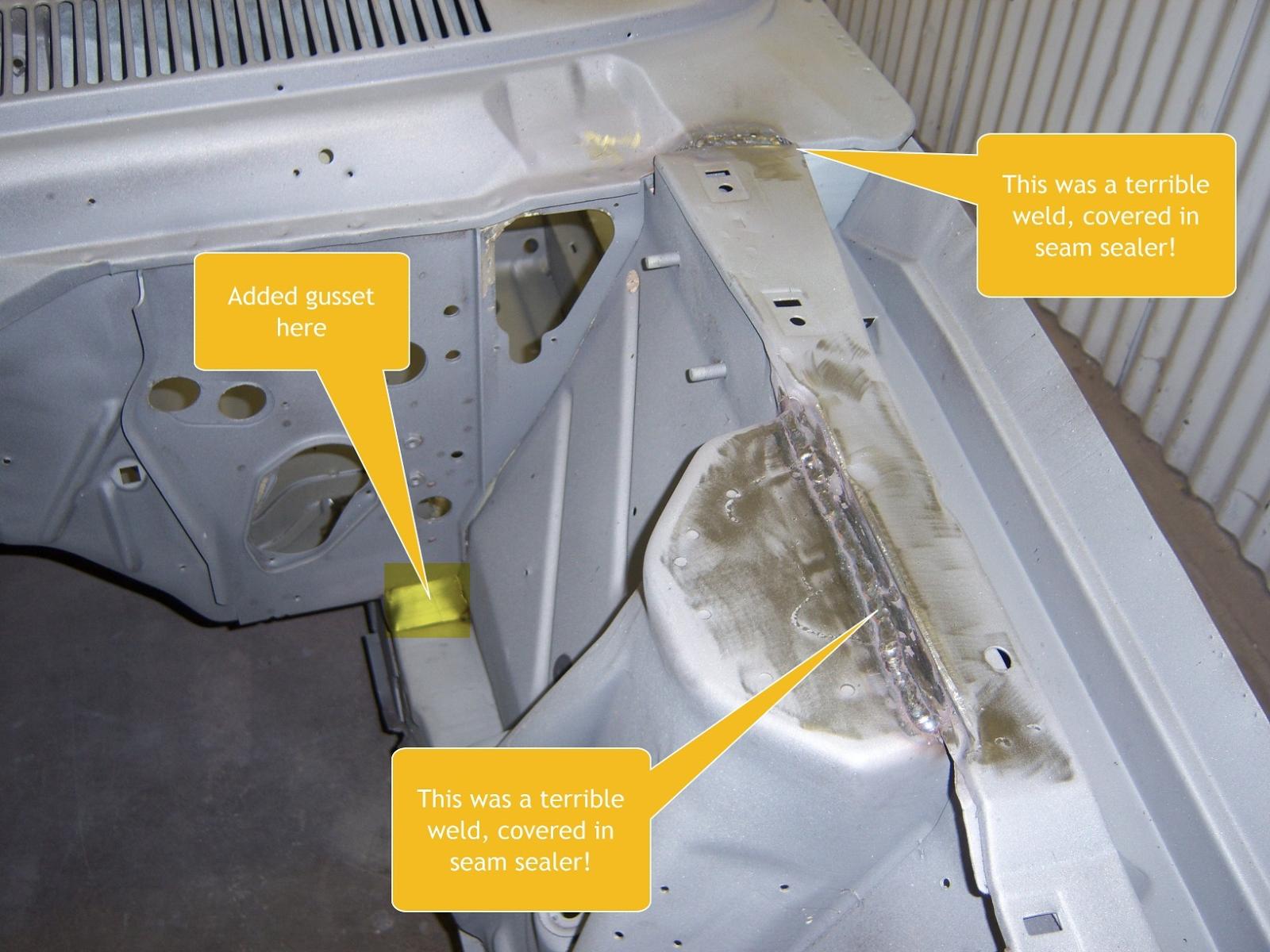

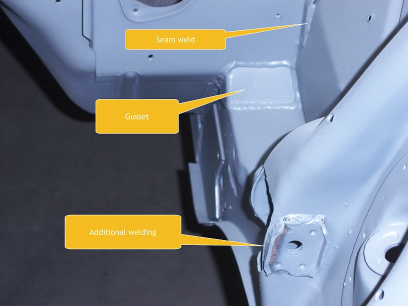

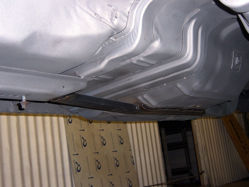

      As long as you're sitting there, welder in hand, may want to consider some seam welding, gussets, sub-frame connectors, etc.
      Some of the factory welds were, um, a bit less than ideal. At least quality control back then covered the visible bad welds in gobs of seam sealer.
      Here are a few pics of my junk way back when for some ideas, I worked with a welder friend and put more than 50 one to two inch seem welds all over my car where structural panels were joined together to supliment what was done at the factory.

      Home-made subframe connectors. Notched into the floor. Super simple design.

      It's coming along, you might want to turn the heat up on your welder though. Just a friendly tip

      Z06kiinSBF, thank you for the tip, I will try that. I have a lot to learn with welding so any tips like that are appreciated.
      Rod, I'll be using the best front set up made for AMC's from Mike343sharpstick!! He makes an A arm system that replaces the trunnion set up. They are the gray & black parts in the picture. I have a few other things to get before I tear out the trunnion set up. In the rear I'm using a custom 3 link system.
      Mike, I will be taking your and Z06's advice and adding some seam welds, once i fill up my empty bottle. I really like your subframe connectors and thats close to what I was thinking about doing.

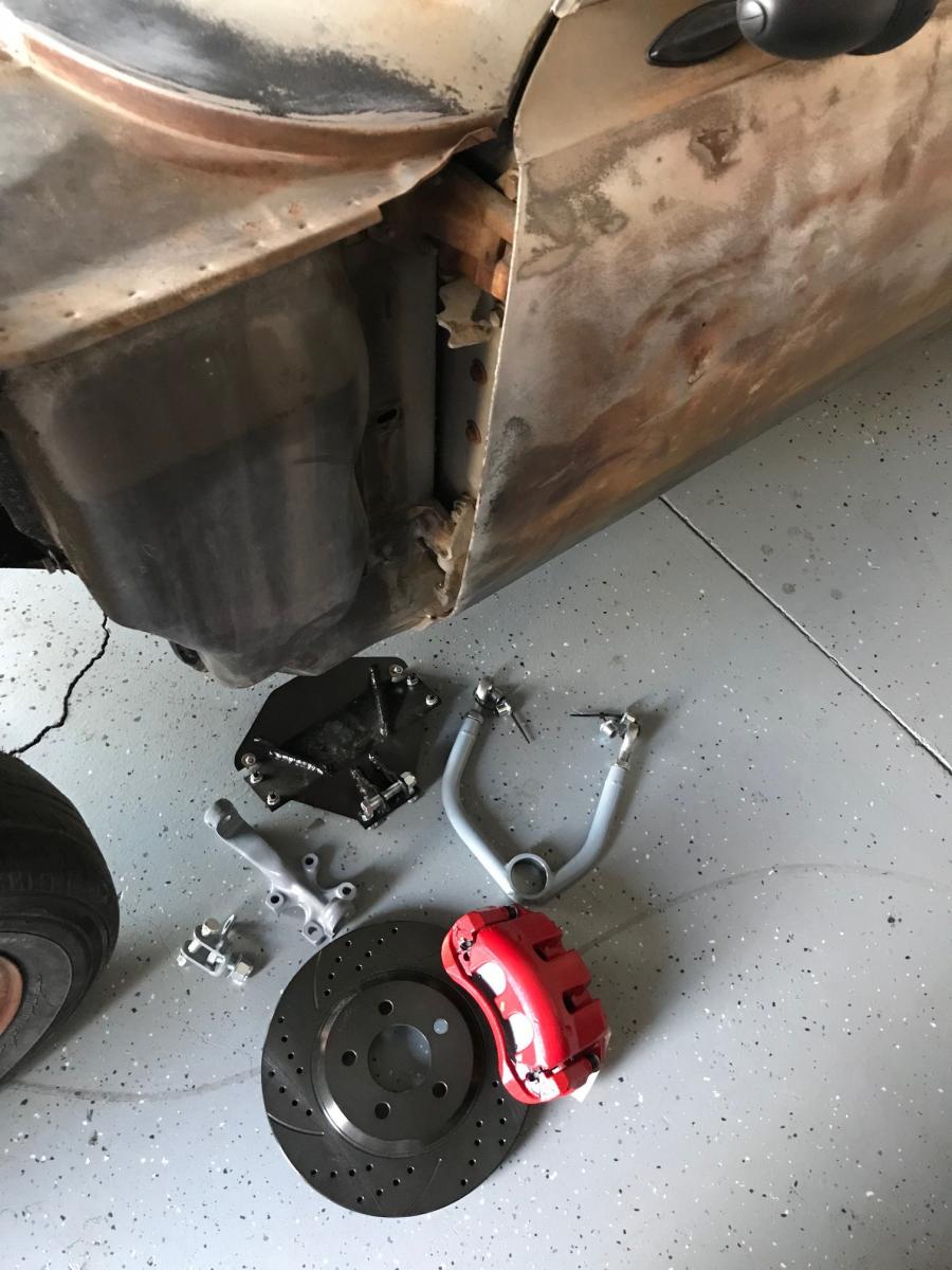

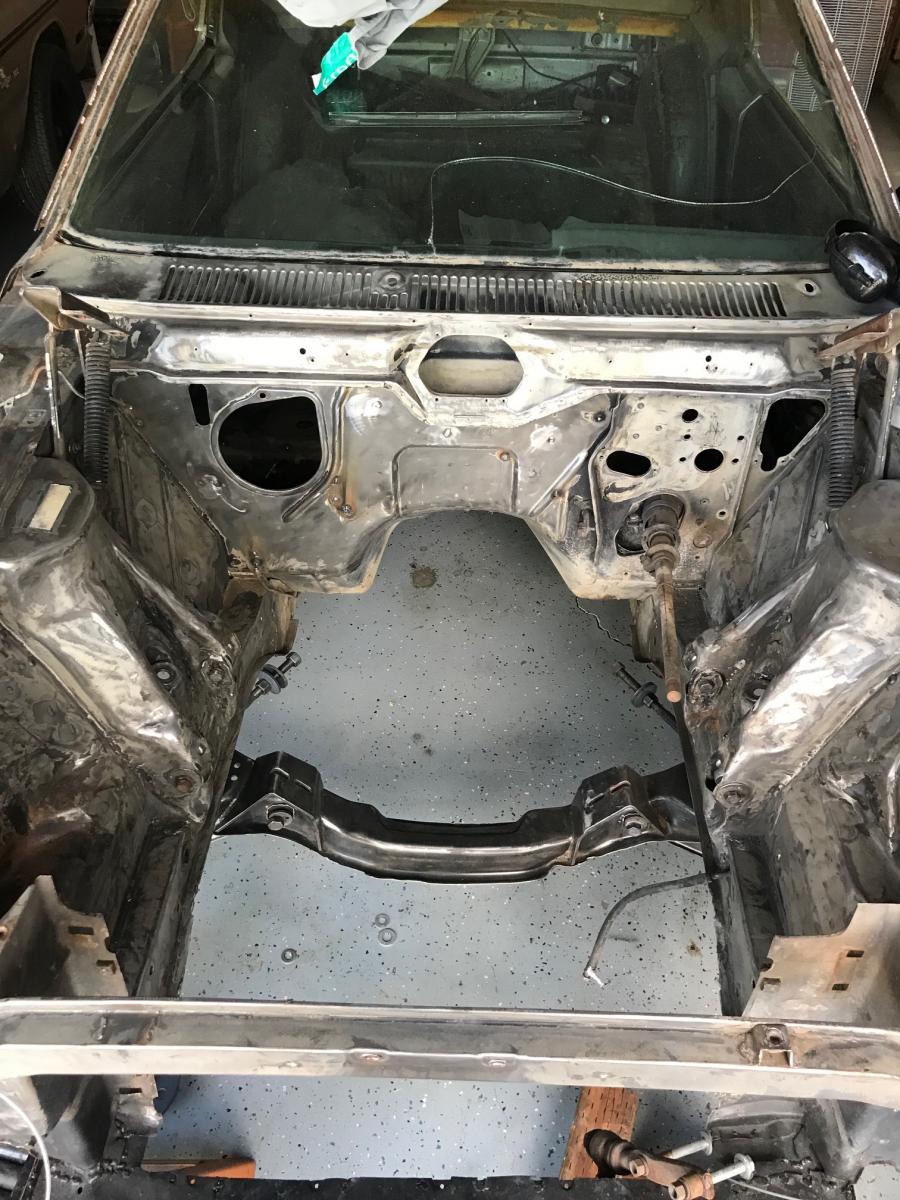

      ]Finally some progress to update. Sometimes in life things are more important than cars. I took a break for awhile, threw the cover on it and changed gears for a bit and enjoyed life. I recently went to the Shelby convention at Sonoma Raceway and came away motivated after some open track sessions in a very fast Boss 302 Laguna Seca, seeing some incredible Shelbys of all years, as well as one of the coolest AMX's I have ever seen.
      Now its time to get back after it. I got mike343sharpstick front suspension kit installed and it is a really impressive upgrade! I also got the rest of the suspension going back together. All new steering parts are coming too. Engine compartment is mostly bare metal and extra holes are being filled. More coming soon, here is the AMX I saw.

      I got the steering parts replaced with all new Moog parts and Proforged tierod sleeves.
      An AMC tip is to use a 70+ center link as they are beefier than the 69 and below (which you can see in the pic).
      I found out that I already had a quick ratio steering box which was a nice plus.
      The control arms are done and boxed, new bushings installed.
      I took the automatic pedal assembly and added a clutch pedal to it. I cut the brake pedal down and added some Sparco pedal pads I got with all the AMC stuff.
      I also got a lot of the undercoating and residue removed. I used a torch and a scraper to get the big stuff off. Then I used charcoal lighter fluid and scotchbrite pad to get residue off, which was really easy.
