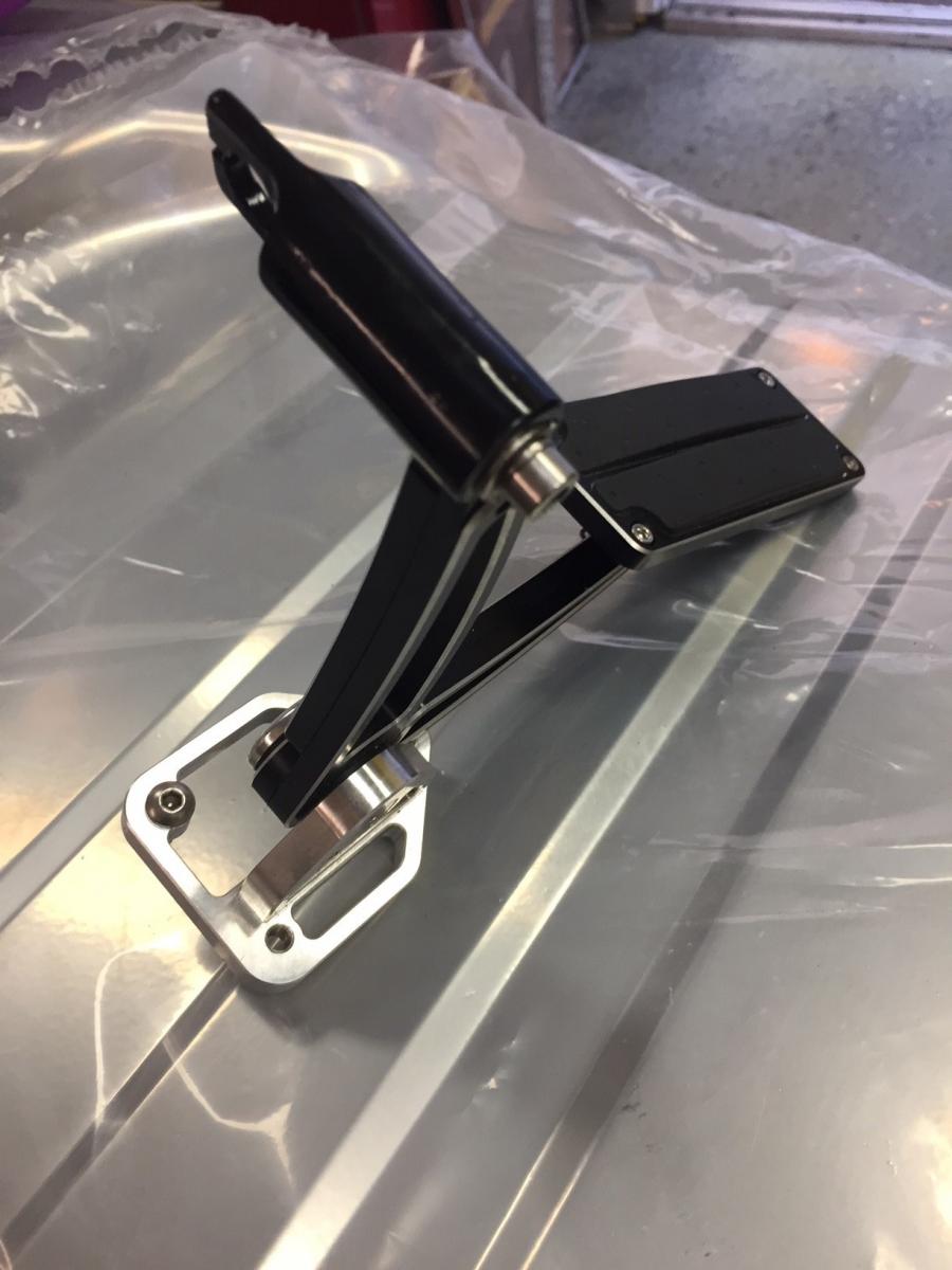

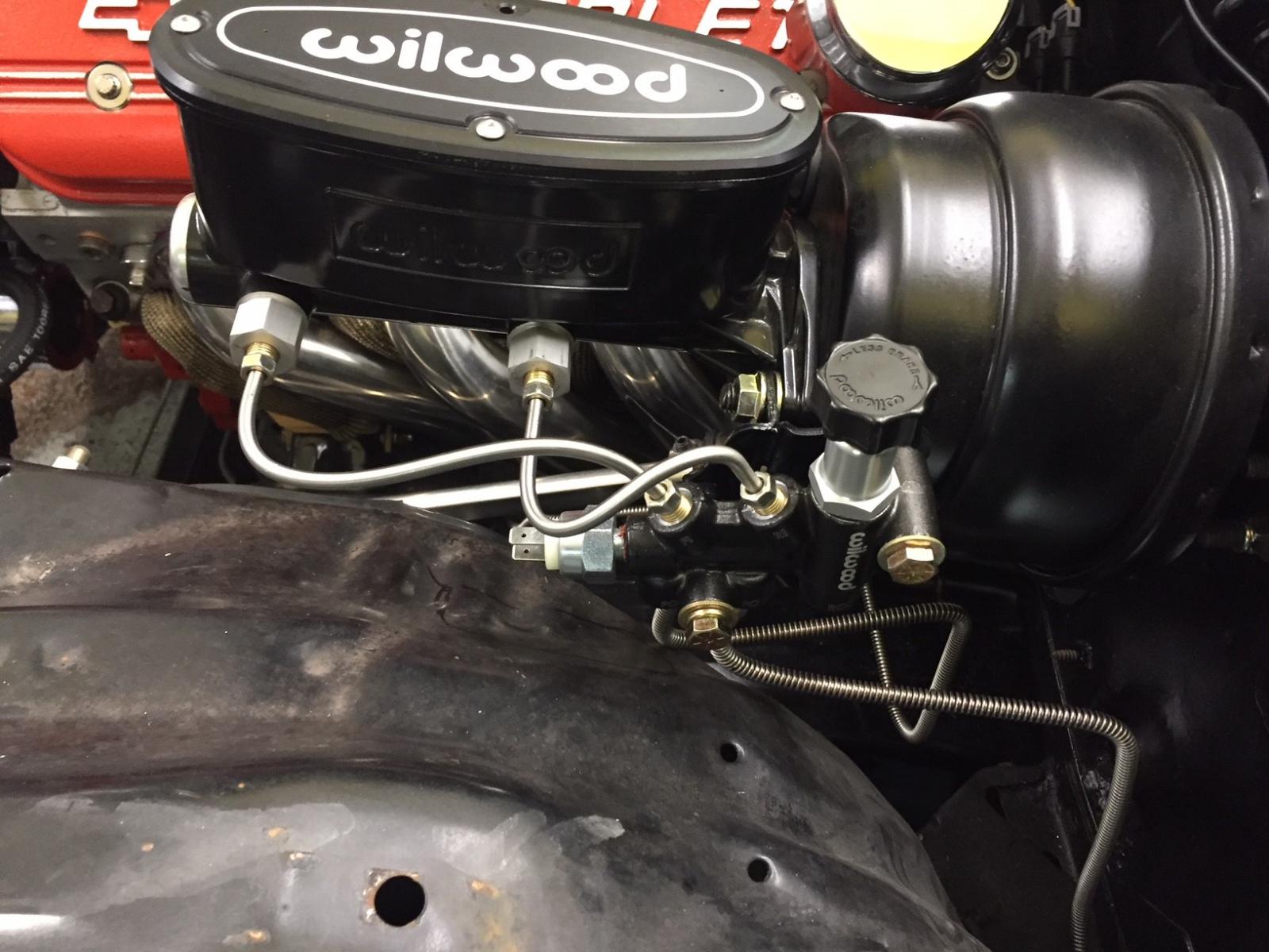

      Earlier I expressed my displease over the Clayton Machine Works throttle pedal assembly and the fact that it was marketed for my car but wasn’t engineered correctly to match up with the factory throttle cable. Don’t get me wrong it’s a beautiful piece but you shouldn’t have to pay that much for a part only to find it is under developed as far as I’m concerned. I had a buddy machine an adaptor that slides over cable arm from the side and bolts in place. It extends out to the stock cable locating and accepts the stock cable.

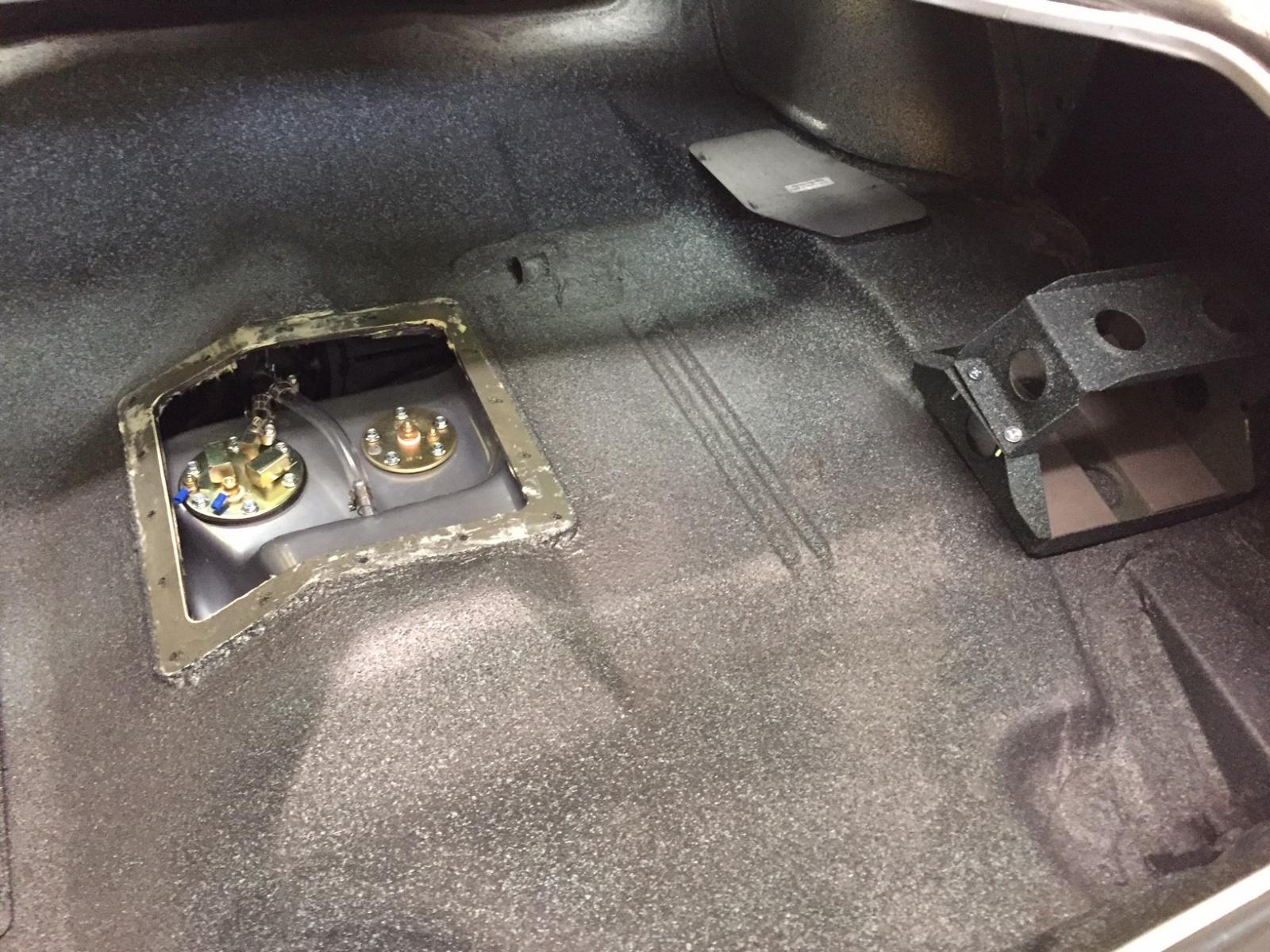

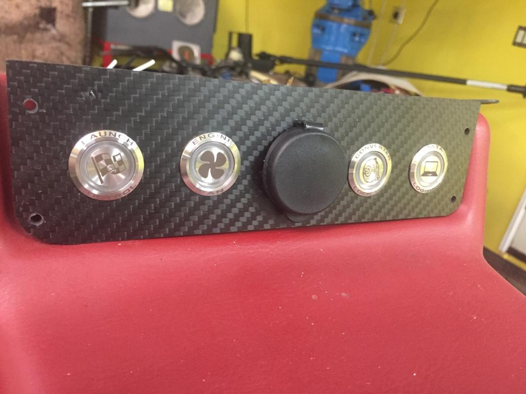

      One of the things I did a few weeks back was install a fuel pump panel in the truck. Ordered one from Detroit speed and after they sent me some Mustang parts I got the correct panel. Super nice people to work with took care of the problem ASAP. But as with a bunch of parts the panel is made for an early 2nd gen Camaro with a flat floor. That’s not the case with a late 2nd gen. I had to bend the mounting plate and cover to match and re-shape a couple of humps in the floor before I could weld it all together. A PITA but after it was welded, primed, seam sealed and painted it was well worth the effort.
Size:  648.0 KBName:  29313184_10208840255883048_1705944956917102751_nF.jpg
Size:  133.2 KBName:  29313184_10208840255883048_1705944956917102751_nD.jpg
Size:  319.8 KBName:  29313184_10208840255883048_1705944956917102751_nE.jpg
Size:  159.9 KBName:  29342279_10208840255843047_6651887402477959523_Q.jpg

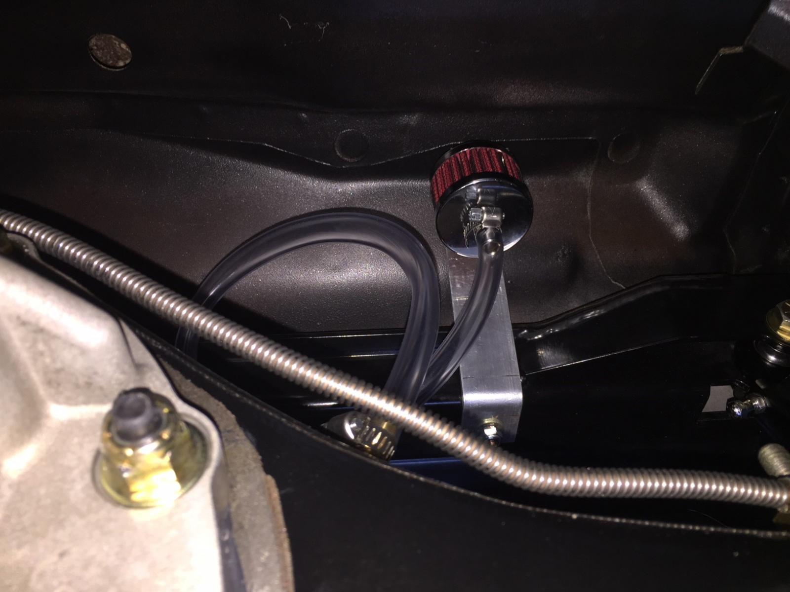

      I also added a diff vent and tank vent with check valve. Used the SpeedTech rear shock mount as an attachment point and got the vent as high as I could under the car.

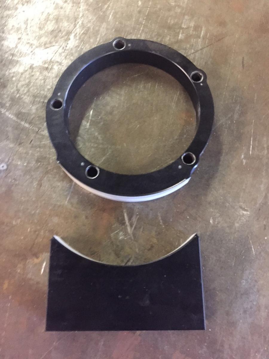

      Well I got my pinion block back from the EDM shop, re-clocked, welded and painted…….nice to have the rear buttoned up finally! Was able to get my driveshaft measurement and built, It will be in this weekend.

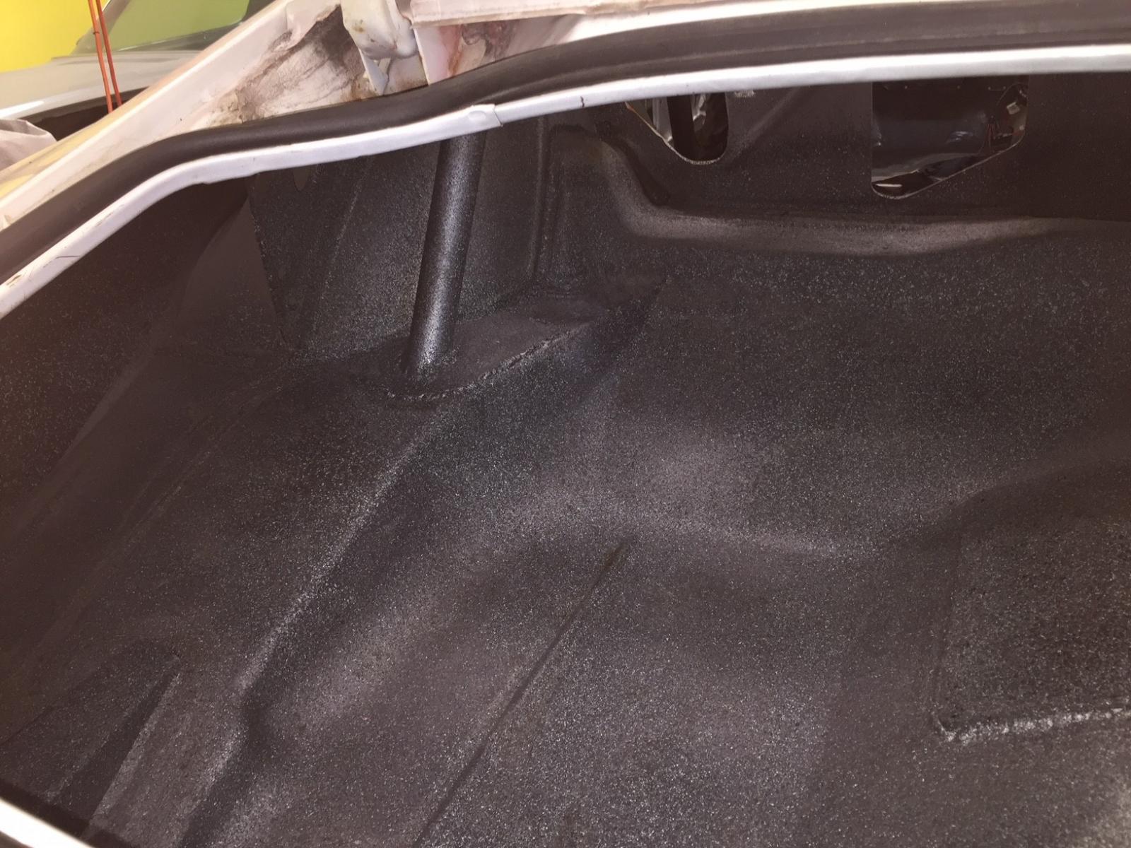

      Started on the Detroit speed roll bar. After reading the instructions I had a buddy come buy and help me remove the rear glass set in 40 year old rock hard Butyl tape. He knew the trick and we got the glass out intact. With the DS template I marked the package tray for both ends of the slots for the back bars. A 2” hole saw and a dimple die laid the foundation for the slots. The instructions said that with the glass out you could tack the back bars to the main hoop and roll the bar forward and take it out of the car for finish welding………..Fat Chance! No way the bar was coming out so we welded the back and cross bars in the car but not the assembly in place so I can tilt it forward to paint the top of the bar and install the headliner. Now the headliner move up the schedule…..but it all need to be done at some time.
Size:  135.7 KBName:  29342279_10208840255843047_6651887402477959524_F.jpg
Size:  118.0 KBName:  29342279_10208840255843047_6651887402477959524_H.jpg
Size:  86.9 KBName:  29342279_10208840255843047_6651887402477959524_J.jpg

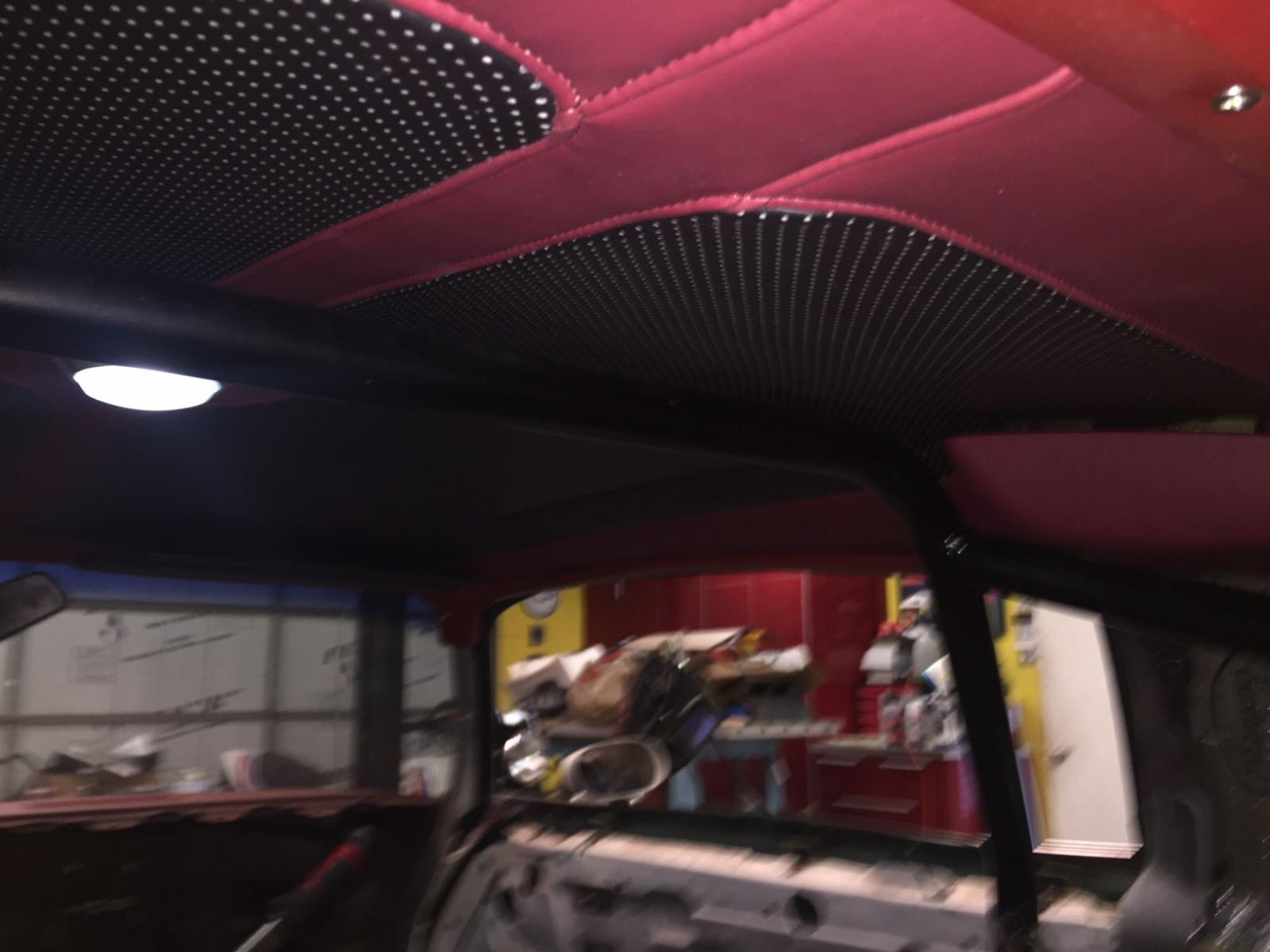

      I did get held up by my upholstery as my 2-week turn around on my headliner turned into 6 weeks and then a 2-week problem with a bad glue job. This held up my roll bar install as I had to install the Headlines before I could finish welding in the bar. At least that is behind me now, but the pattern of slow turn around has moved to the custom package tray. ☹

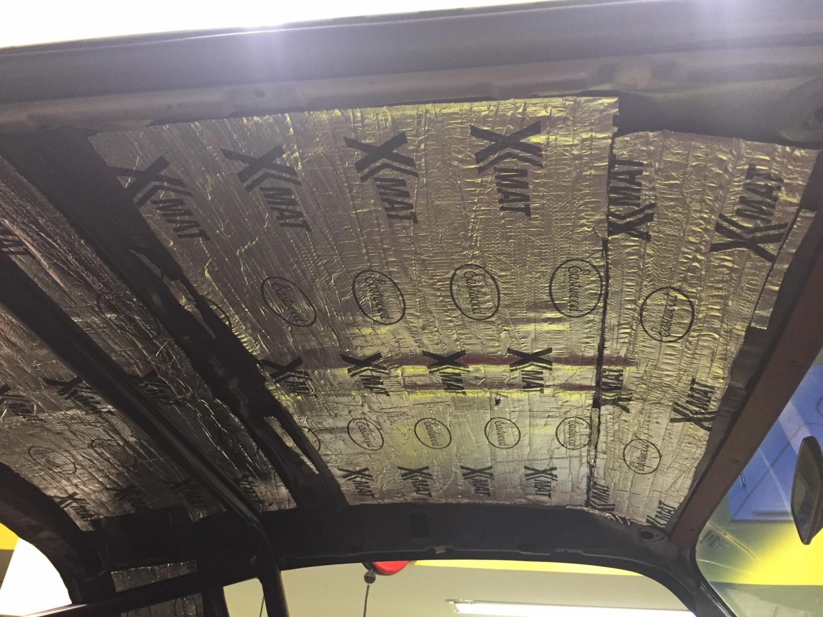

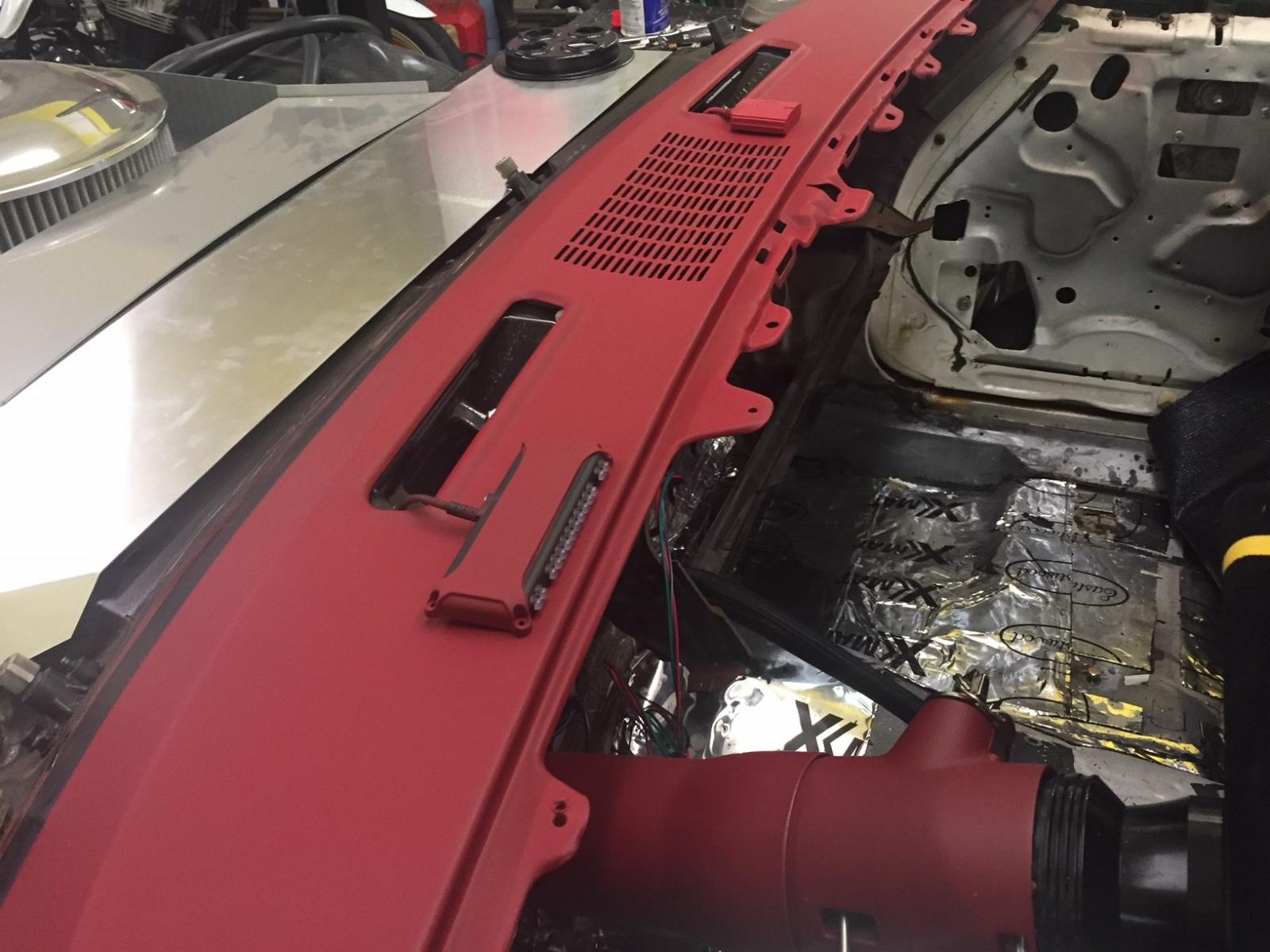

      After laying down my X-Mat on the floor I unrolled the new carpet to allow it to relax. I won’t install it till I get all my wiring run from the trunk. I did pull out the front windshield, it was cracked, so I had access to lay down a fresh coat of paint. I used this extra access to run my Holley shift light and GPS antenna through the Vintage Air defrost ducks.
Size:  315.3 KBName:  294Q.jpg
Size:  88.7 KBName:  294R.jpg
Size:  101.3 KBName:  294T.jpg

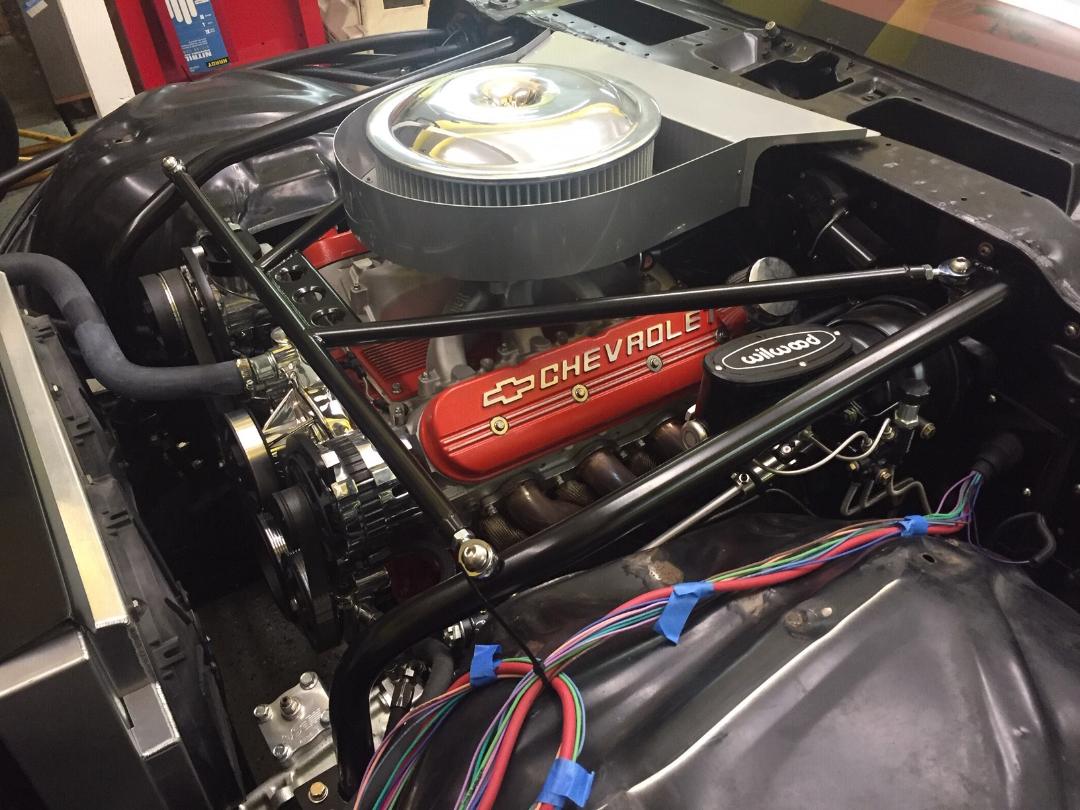

      Again, it’s been a while since I last posted my progress. Between being hammered at work and being a one man show during the majority of the build I’ve made a lot of little steps since the last update. I have been working towards staring the motor for the first time. As I have already had the fuel system up and running I turned to the power steering system.
      Attachment 159128

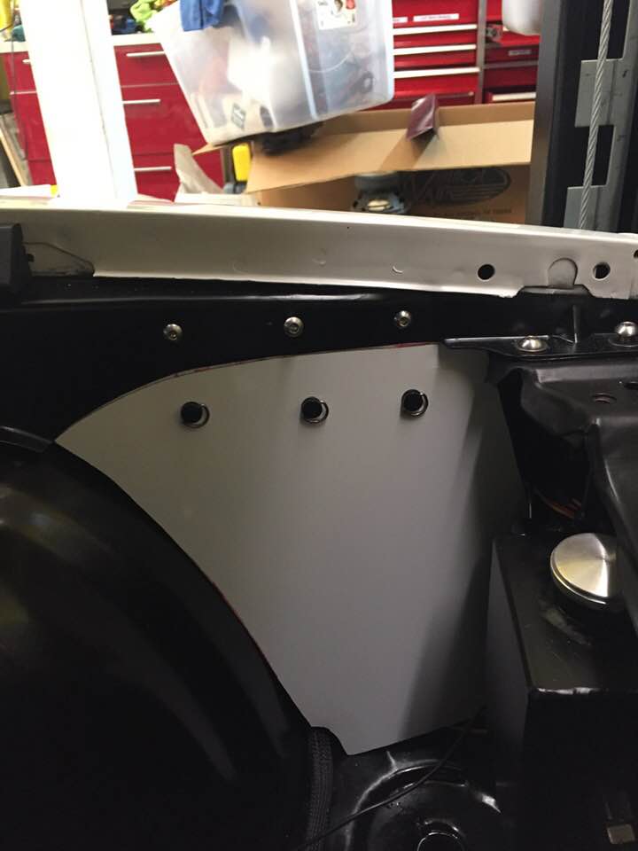

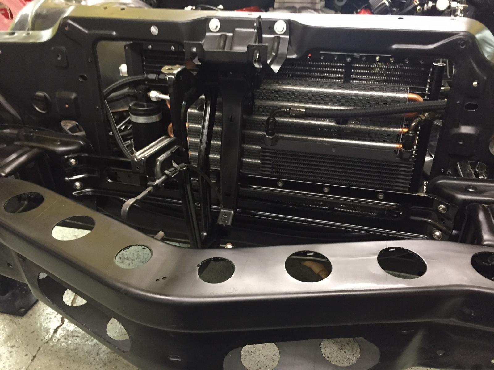

      After and mounting the tank tucking inside the core support I found a good spot tor the cooler. I made up the hoses and after they were installed, and fluid added I checked it off the list……until the next morning when I found a puddle of oil. This tank didn’t have a vented cap so I added a vent pipe in the bung opposite of the return……that bung leaked! I took it to my welded Randy who removed the bung patched the hole and welded the bung back moving it up and over. I never liked the vent being straight across from the return port anyway.
      Attachment 159119Attachment 159120Name:  295D.jpg

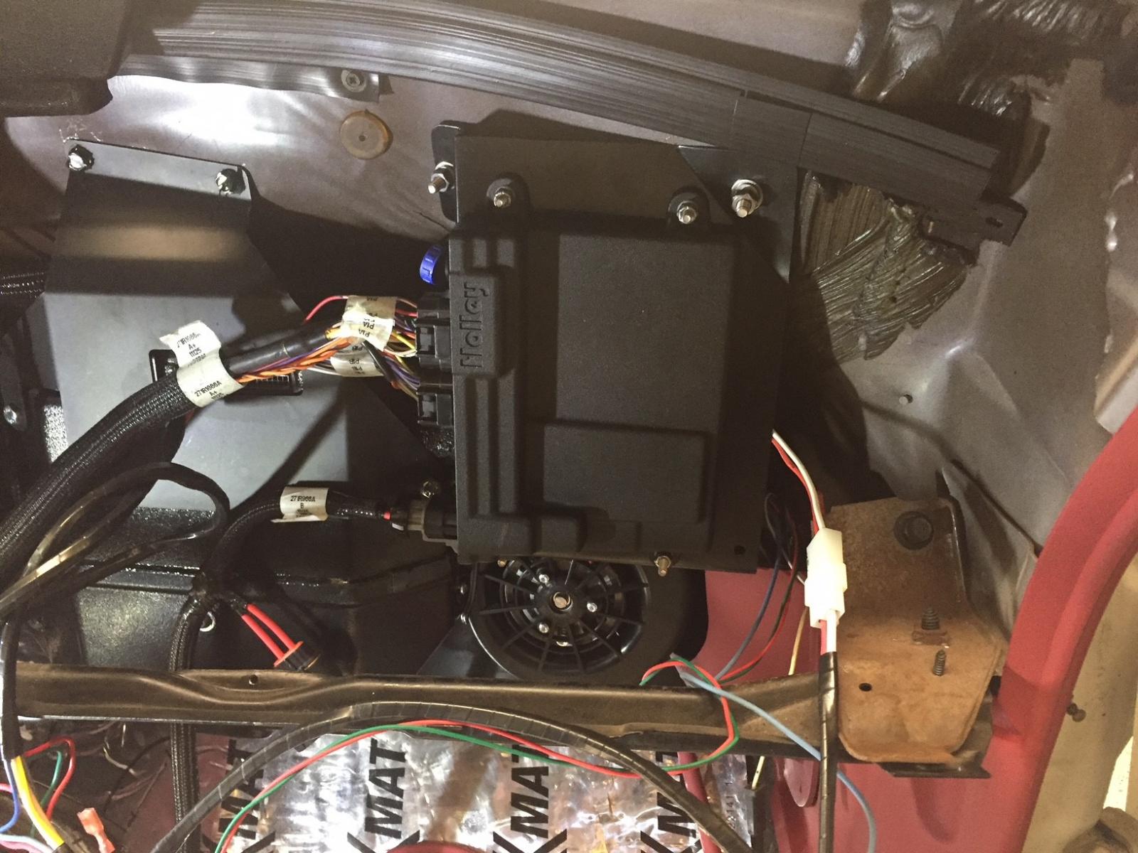

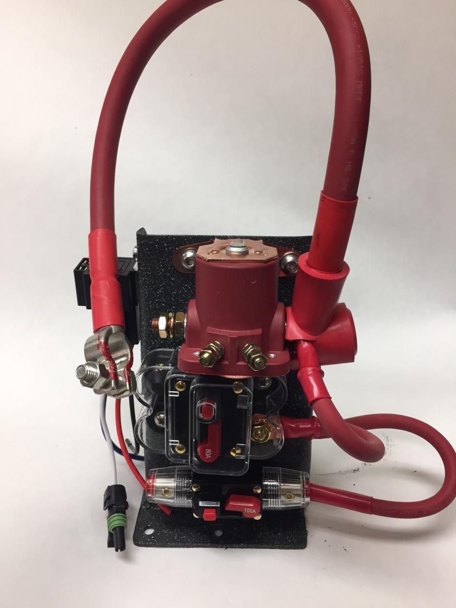

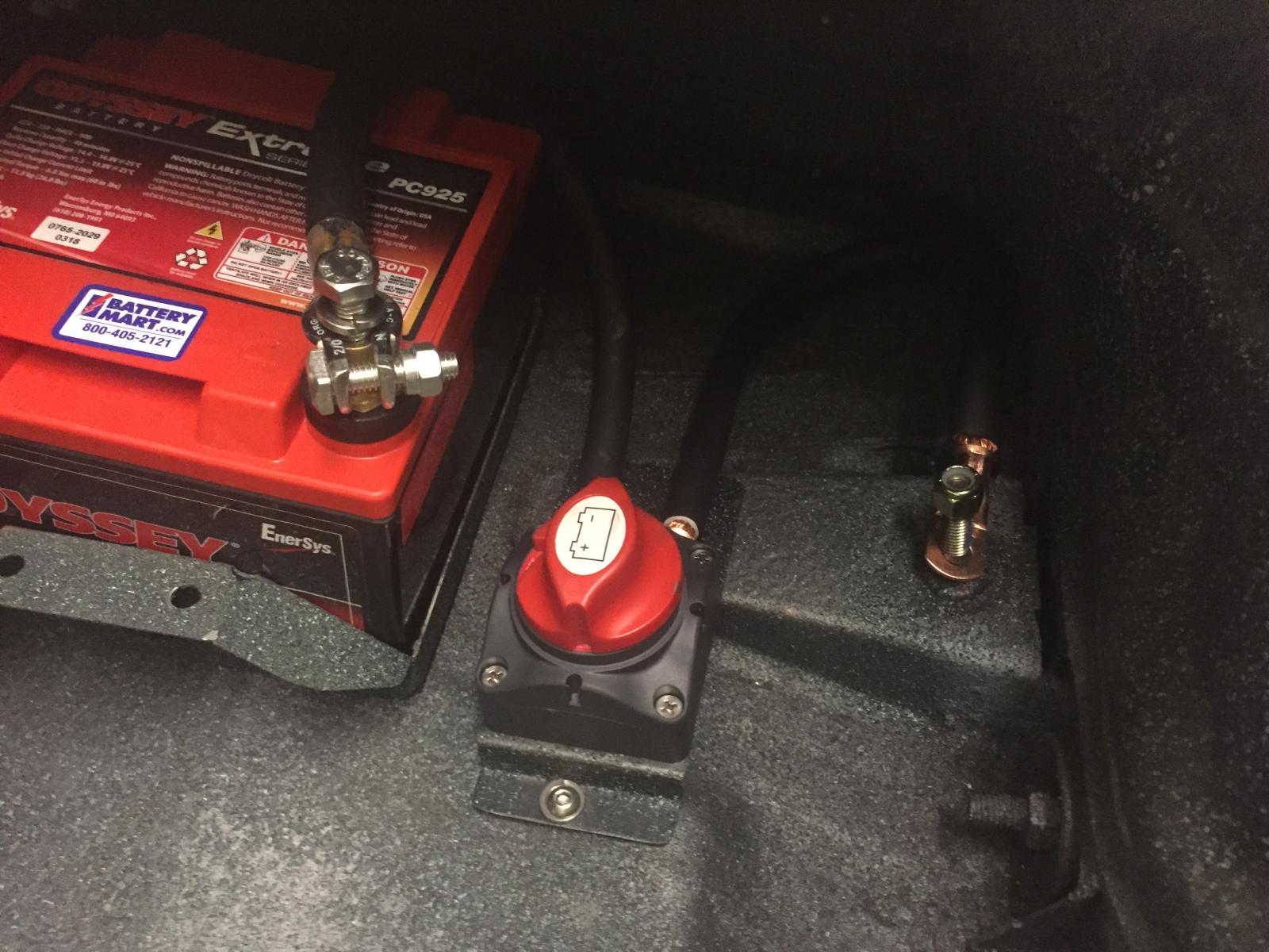

      Can’t start a motor without power so that was the next goal. I had already mounted the battery tray, so I just needed everything else in the trunk before moving to the dash area. First, I mounted a disconnect between the battery ground and the ground lug I welded to the body. I then made a bracket to hold a Ford solenoid, two circuit breakers and a fuel pump relay. One breaker supplies power to the dash and the other to the front of the car where I’ll power fans, lights, horn and tie into the alternator. All the brackets were splatter painted to match the trunk.
Size:  207.3 KBName:  295S.jpg

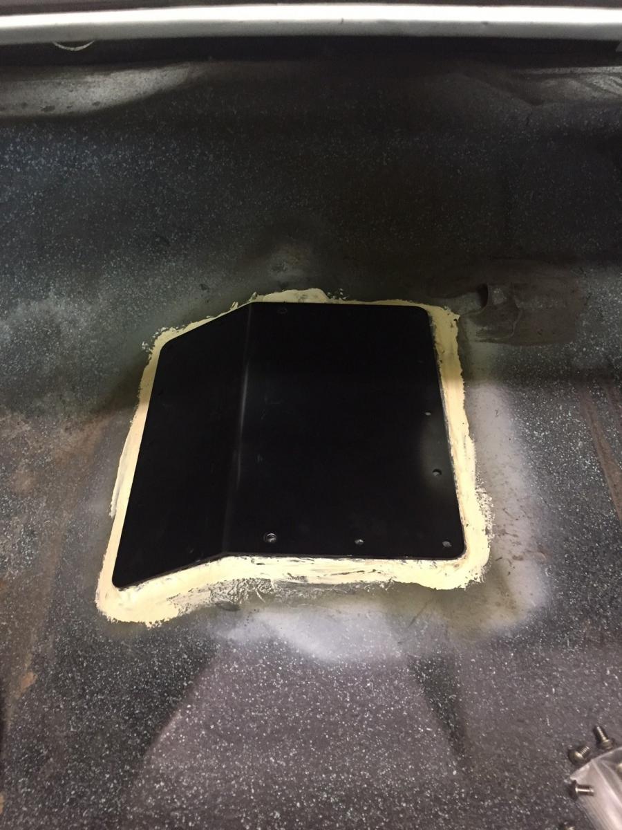

      One of the things I’ve had made that I haven’t shown yet is my package tray. Had to have it made to work with the roll bar and allow my tune without showing the speakers.

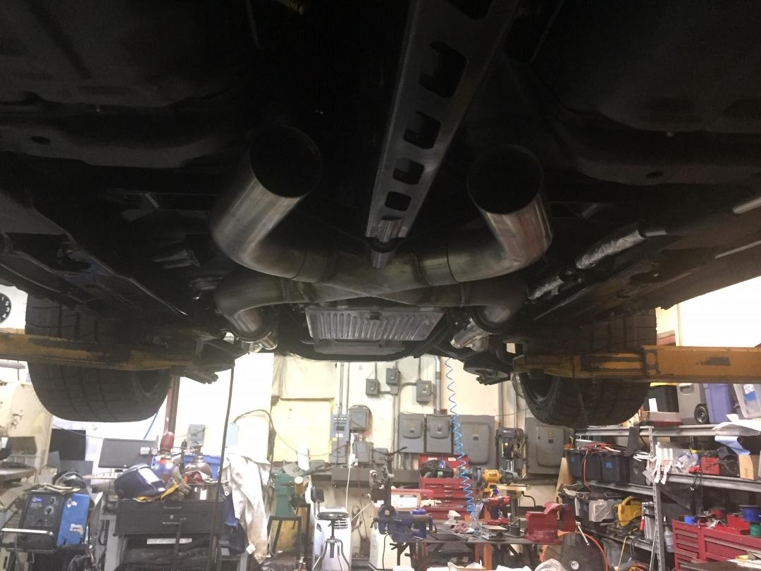

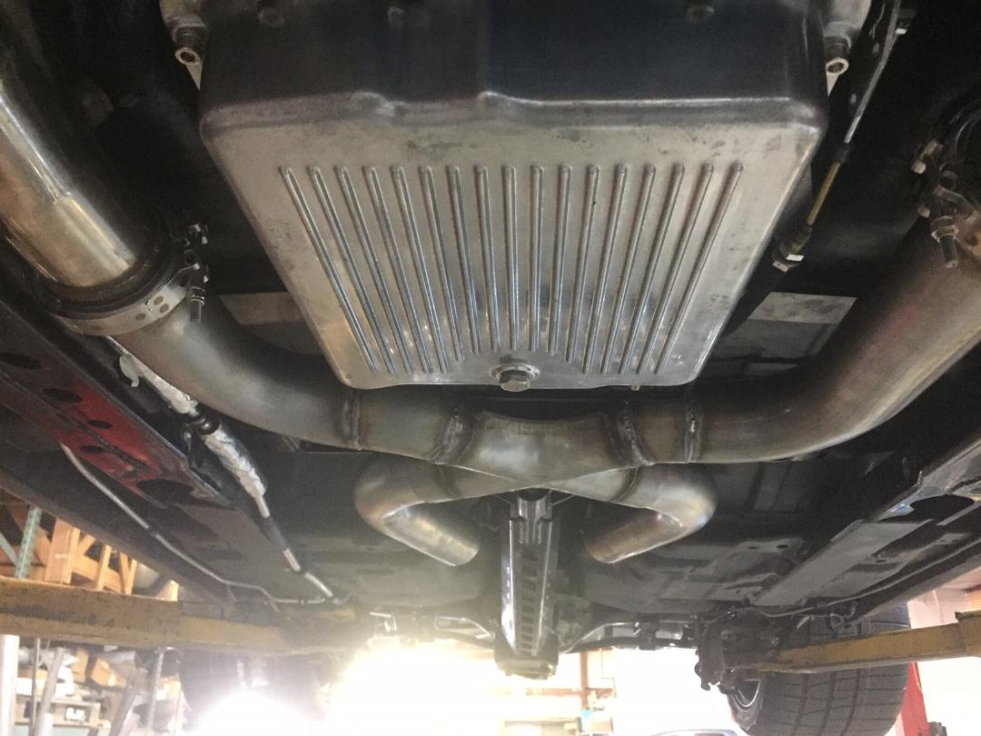

      I tried to do the exhaust system myself but started to look like crap so I took it to the shop that did the rear tubs as that is also up his alley. After looking under the car he said no problem and he could even add a crossover with the SpeedTech trailing arm suspension. He started working his way back until we found the 3” in/out 4” thick black widow mufflers I ordered were 4 5/8” thick so we stopped, as we felt it would hang to low. I ordered a set of 3” in/out 3” thick Spin Tech mufflers. Because they were stainless they had to be built to order this is not finished yet. At this point I have a time slot scheduled for next week to finish the exhaust.
Size:  95.6 KBName:  297B.jpg

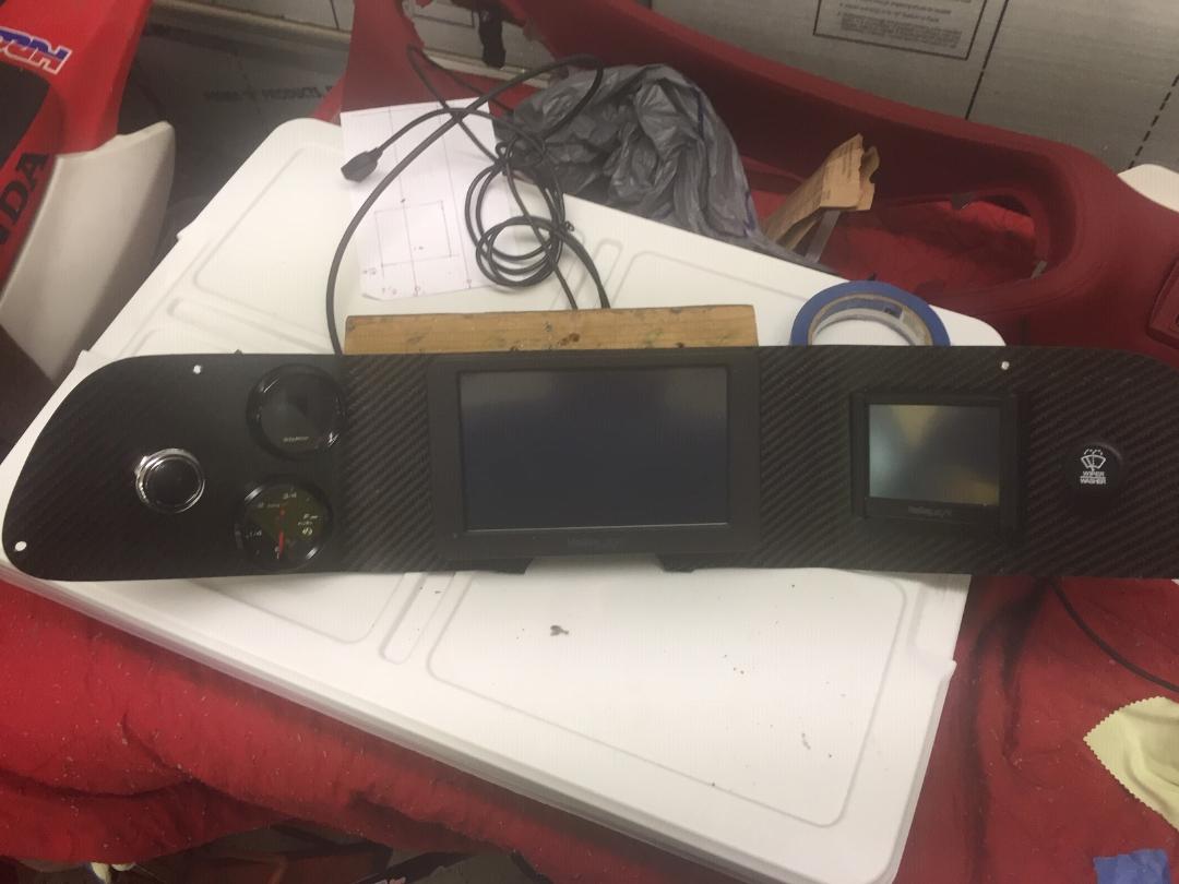

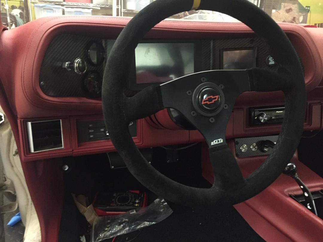

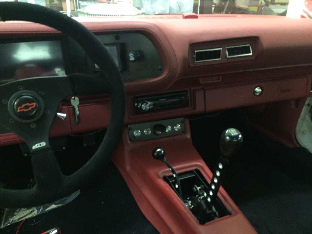

      Because I am running a Holley digital dash I needed to come up with a new gauge layout. I turned to Custom Works Performance for one of their carbon fiber dash panels and did my own thing. Along with the digital dash I added the touch screen tuner, light & wiper switches and a couple of gauges. One for fuel and the other a gear indicator. I also made a C/F switch panel for the console. In the console is a highly modified “Ratchet Bitch” shifter to operate my 700R4. I will cover the shift hole with another C/F plate.
Size:  69.9 KBName:  297J.jpg
Size:  87.0 KBName:  297M.jpg
Size:  79.1 KBName:  2970.jpg

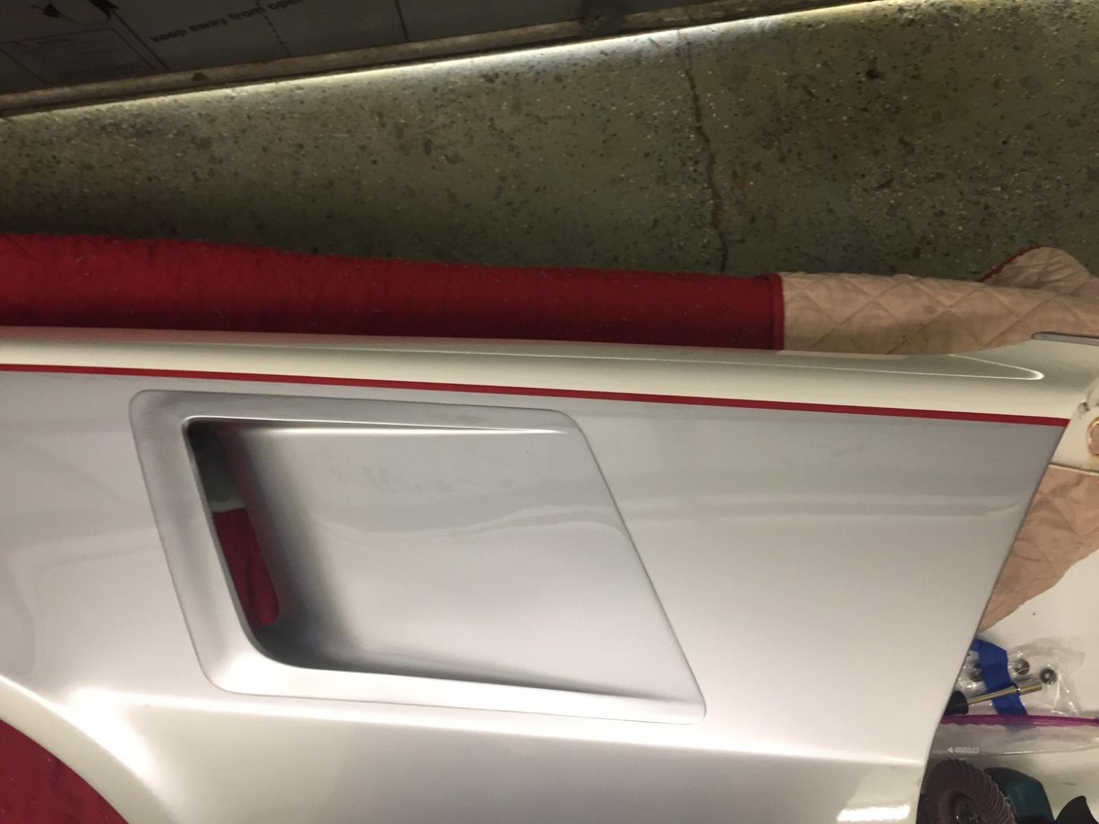

      I also added some dimple die detail to the inside of my fenders.

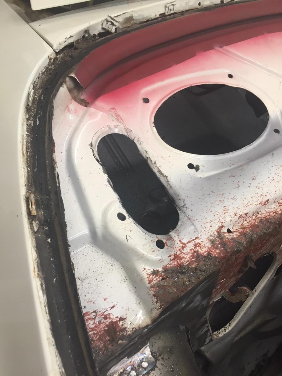

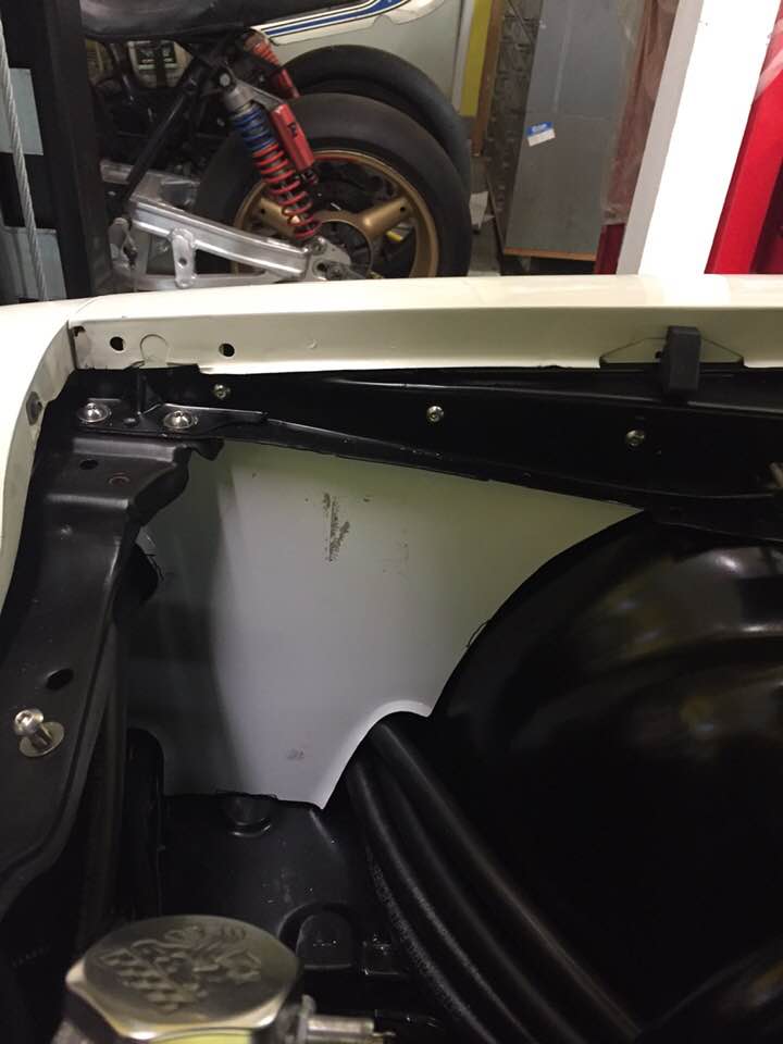

      Unfortunately as I was retrieving the nut to bolt on the passenger side vent the fender rolled off the work bench denting, chipping and scratching the hell out of it. That was a four week delay getting it fixed and painted. In the end I was able to get the fenders and nose fitted and aligned. Once fixed and installed I was able to fit the hood, unfortunately we cracked my new wind shield while adjusting it…..got to watch out for the sharp corners in the rear! The cowl induction air cleaner base I have needs to be trimmed to fit the hood now installed and I’m not sure how I am going to do that yet but I have some ideas. For now I bought a new standard drop base to run.
Size:  52.6 KBName:  97X.jpg
Size:  67.4 KBName:  97Y.jpg

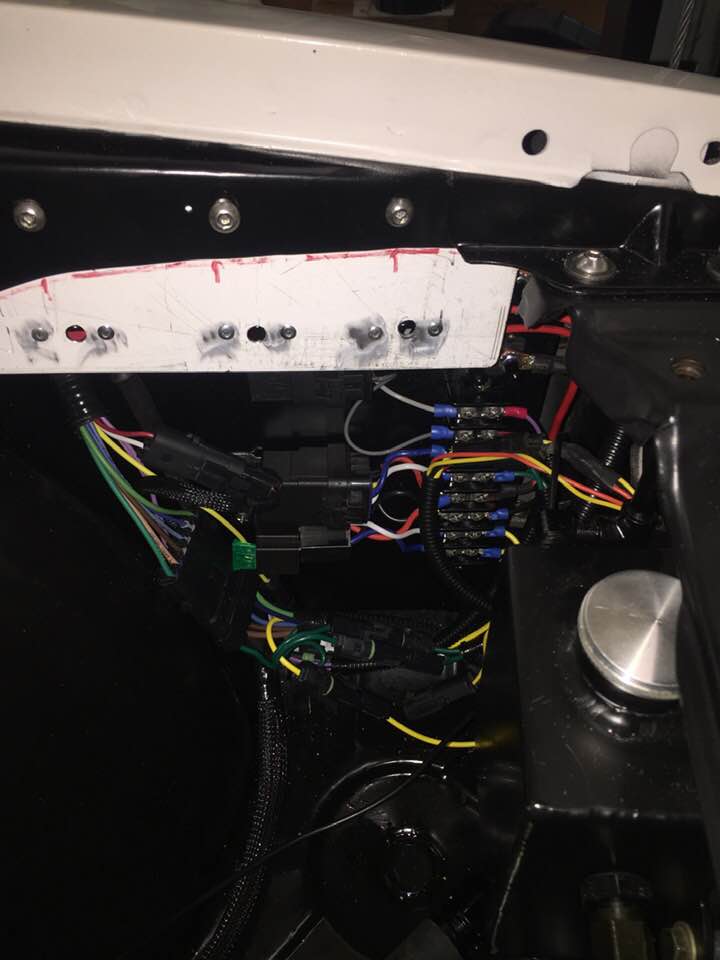

      I’ve spent a bunch of time on wiring as I bought a universal fuse block from AAW and fashioned most of the harness from scratch. I’m down to the last few wires to be done so I should be done this weekend. I have finished the relay panel and front light wiring harness along with some block-out panels. The relay panel and light wiring harness connector sits in front of the driver side inner fender. To cover this I made a removable cover that held in with ¼ turn fasteners. Although the panels are all white in the pictures I have had the powder coated matt black already. I also made a bolt in close out panel for the other side with a slot for AC/Heater hoses.
Size:  45.1 KBName:  98B.jpg
Size:  39.5 KBName:  98A.jpg
