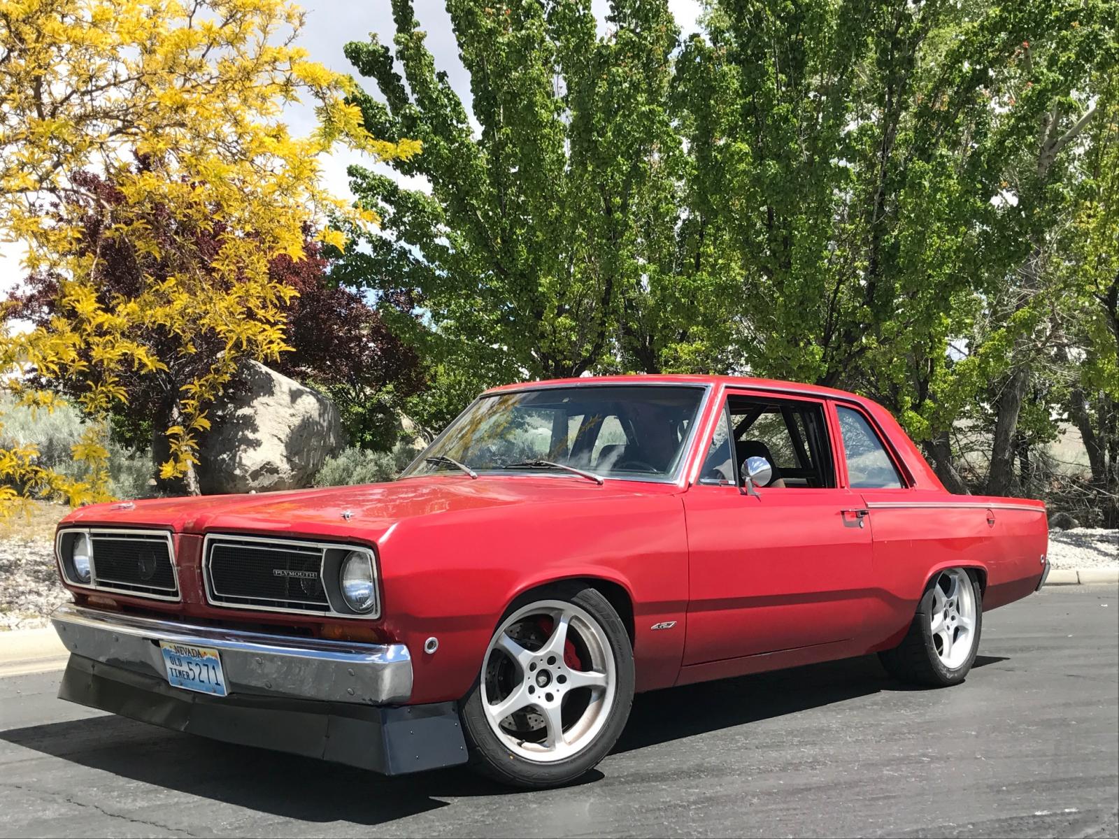

Size:  443.2 KBWhat you have is a great start, subframe connectors and torque boxes. You can add a lower radiator support that ties the front together (XV motorsports one is beefy, whereas the US Car tool one goes on top of the existing one. A cage really helps. You may also want to think about reinforcing the K member, Firm Feel sells a kit to weld on or you can send them yours. Also putting some big torsion bars in will make a HUGE difference
      I had Firm Feel 1:20's in my Valiant along with bilstein shocks and it rode really well.

      Many thanks!! This is a great help.
      By the way, what wheels are you running there? Your car looks fantastic.
