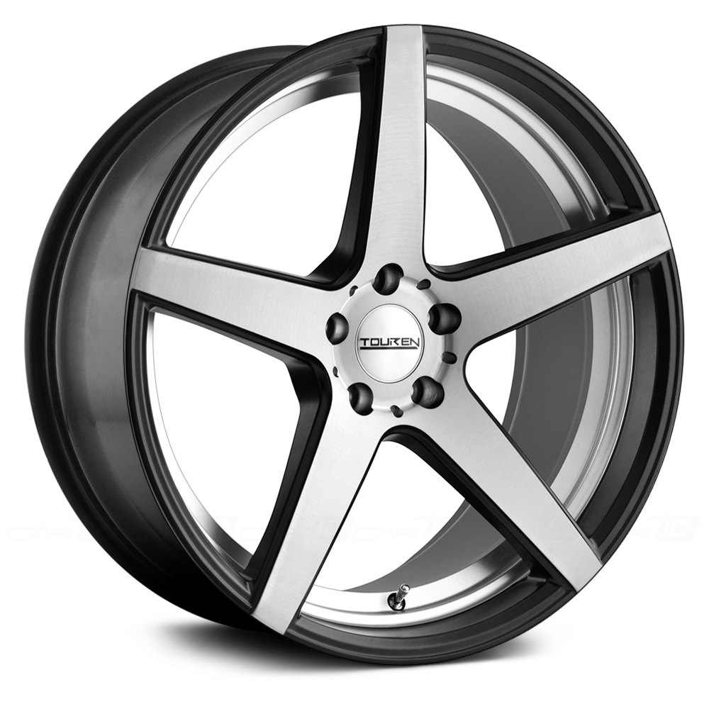

      Quote Originally Posted by 67rally View Post
      ebay options.
      Oh man, these are great! thanks!
      Just how terrible are these wheels? I'm not looking for high-end performance but I also don't want a wheel to break when I hit a pothole. I'm thinking I'd buy higher-end tires and lower-end wheels to save some money. I'm also not certain enough that I'll like the look of any wheels I get so spending less is very appealing.
      Has anyone had experience using these in an aggressive fashion? I'll be driving in a spirited manner, doing just-for-fun autoX. No real racing. Google reviews are good.
