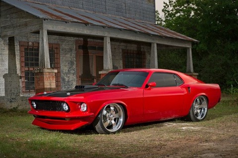

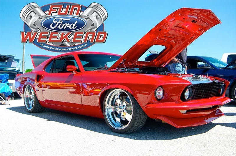

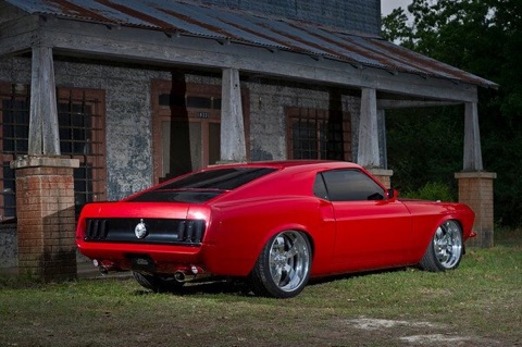

      Here is an example of what it will look like once finished. I used the same dimensions for this 69 GT I did a while back.

      Thank you very much. Can't wait to see more of this car!
