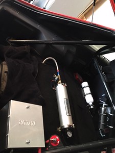

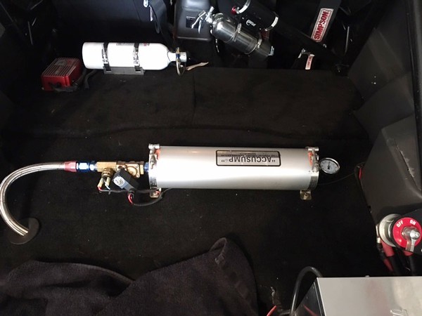

      Send me a PM with your email and Ill send you a pic. I have not figured out another hosting site since Photobucket puked. Edit: I went ahead and signed up with Smugmug for the free 14 day trial. Pics attached. I also included a picture of how the Accusump ties into the engine oiling system at the top of the remote oil filter. One can easily use a collar between the filter and block too.

      Thanks for sending me the pics and for posting them here!
      I think it's useful to show your engine compartment pic to understand the placement in the engine compartment. Would you mind adding it? It looks good too.
      I also have some questions about your engine compartment. What are the three aluminum looking cans on the right? What about the square can on the left? Are you running a crankcase vac pump?

      Thank you. No evacuation pump. The two breather cans on the right are my valve cover breathers / PCV system. Air enters the first breather (or vents to atmosphere) through the first unit and ties into the passenger side valve cover via 12 AN line. The second one has a PCV plumbed into the top and draws from the driver’s side valve cover. PC valves are good and keep things somewhat clean. This set up makes it really hard to suck oil into the engine via the PCV or spew oil out the breather given the road race nature of the car. The 3rd can with the decal KRC is the remote power steering reservoir. The power steering pump is right to the left of it. Lastly the square Canton can on the right serves as the radiator overflow catch can. The Accusump has been called the poor man’s dry sump system. Mine has served me well and you are right – dry sump systems are usually really pricey. I added some more pics of the car here: https://www.pro-touring.com/threads/...03#post1238703
