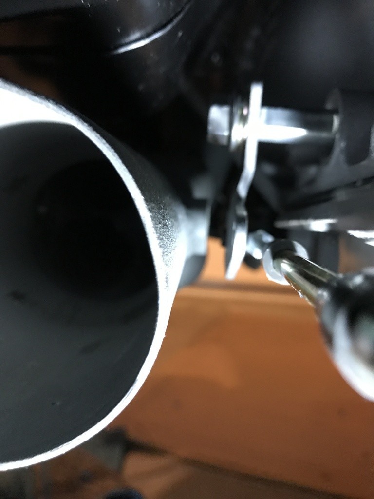

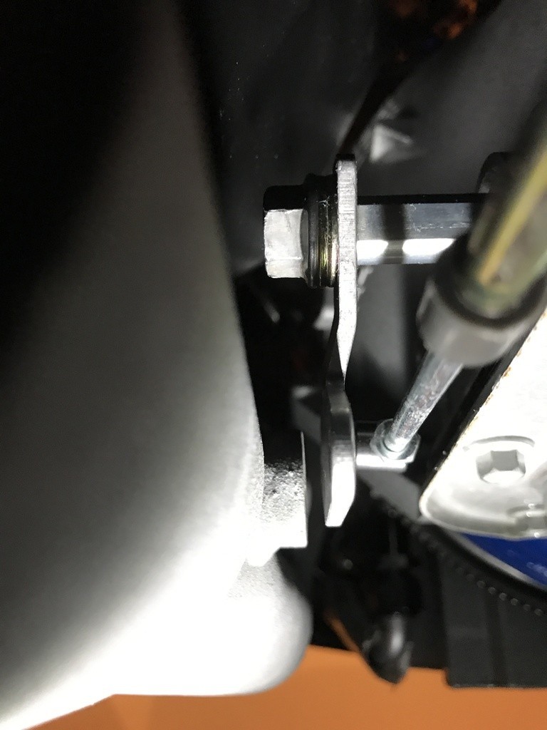

      Here is the shifter problem
      Here is with the header flange spaced a little over a 1/4"
      Here it's about 7/16" spaced

      And with the header spaced out.
      What do you think?

      Might look a little odd when looking at that side of the engine but if adding a 1/4" header flange works I would say try it. If it fails you won't be out much.
      I really dislike denting header tubes for clearance purposes.
      Old trick I've used in the past is on the header gaskets is coat each side with high temp RTV. Bolt everything together and leave them sit over night. I never had a leak doing that.

      I tried spacing it out with washers on two header bolts and it gives me quite a bit of room.
