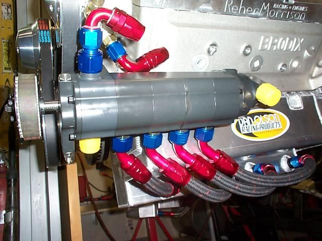

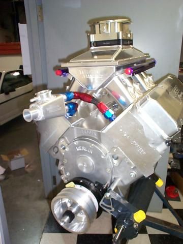

      Ok so it's not totally PT related but thought you would all like to drool a bit. Yes this guy is taking is "toy" to a whole new level.
      Neat lookin cam bearing isn't it
      wee bit of titanium
      Whaaaaa, look at the name on that box
      Ok so the breakdown. It's an all aluminum full roller 588ci Brodix BBC, 12 degree RM Pro Stock heads, Oliver Titanium rods, Wilson sheetmetal intake manifold, BS3 efi, 5 stage drysump, and all that fun stuff. Bob weight came out lighter than your average 350 sbc, made 1069hp @ 7k and 904ft/lbs @ 5k... Not a bad powerplant for a little dune buggy. Yeah I can think of a car or 3 I wouldn't mind droping that thing into, and chances are it wouldn't be a desert toy

      Well that CERTAINLY ain't no VW engine. Mercy.

      Thats nuts. :3gears: x10

      Will that thing even stay on the ground? Put the pedal to the floor and it would send the buggy into orbit!
      or a big trench dug up by the rear wheels

      That BBC is more my speed. 1,000 hp N/A beats 1,500 hp with a power adder any day in my book.
      Yeah that is one bad mofo, but personally i'd rather see it in a mid engine car. Rear engine 4-5 seat buggies will carry the front wheels with 1/2 the power he's making. Drop that in a mid 2 seater and it would be king of the dunes.
