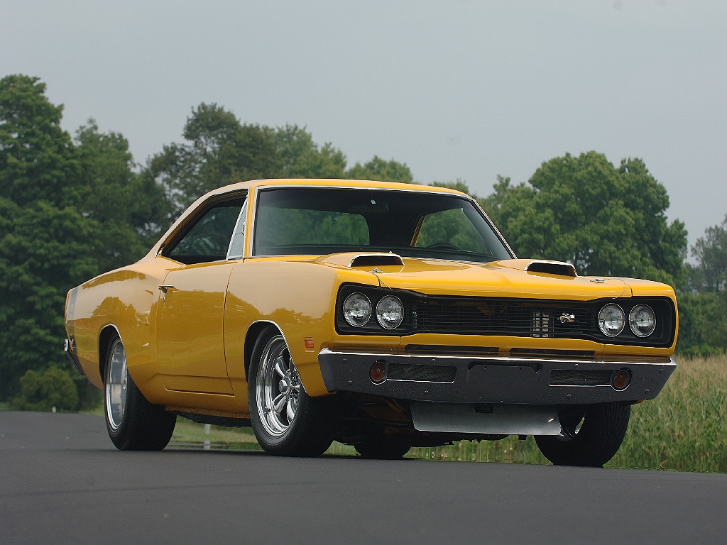

      Very cool car. What are the details?
      13
      Funded and owned by Jeff Adkins
      Designed and constructed at
      Retro Rides by Rich
      Which included full metal restoration, fabrication, body work, engineering, paint and assembly
      Engine
      R5-P7 V-8 Dodge Magnum 5.9-liter NASCAR Nextel Cup Petty Enterprises Dry Sump Engine
      Freshened by Eatmon Race Engines
      Horsepower: 800+
      Torque: 450 foot/pounds
      RPM: 9,000
      Block: MOPAR
      Heads:MOPAR
      Engine Plate: Evernham Racing
      Camshaft:Competition Roller
      Valves: Del West
      Valve springs: Isky
      Belt drive: Jesel
      Crankshaft:Bryant
      Pistons: CP
      Oilpan: Moroso
      Oil pump: Barnes
      fuel pump: CV Products
      Water pump: MOPAR
      Intake: MOPAR
      Drive system:CV Products
      Headers: Custom stainless steel by Billy Valitzsky
      Carburetor:Holley 750
      Ingition: MSD
      Hoses & fittings: Aeroquip
      Transmission: Tex's Racing Super T-10
      Clutch:Tilton
      Alternator:Power Master
      Power steering pump: CV Products
      Dry sump tank:Peterson
      battery: Decca
      Body
      Color: GM Millenium Yellow
      Brand: Dupont Urethane
      Body Mods:Shaved antennea, shaved mirrors, tucked rear bumper, louvered rear belly pan, rocker panel belly pans, mini wheel tubs, aluminum crush panels
      Louvers: Punchy Louver Company
      Chassis
      Unibody modified to accomodate NASCAR drivetrain
      Subrail connectors, reinforced rear clip, custom transmission crossmember, tranmission/driveshaft tunnel, tubular gussets,heavily modified K member
      Front suspension: Torsion bar
      Upper control arms: Tubular by Billy Valitzsky
      Brakes: Bicknell Racing Products 4 piston calipers with Wilwood rotors
      Rear suspension: Jegs ladder bar with Pro Shock coil overs w/ Eibach springs
      Rear housing: Ford 9 inch by Bicknell Racing Products
      Rear Axles: Mark Williams
      Center section: Locker by Tex's Racing
      Wheels: American Racing Torque Thrust, front:16x8 Rear:17x11
      Master cylinder: 1971 Dodge Coronet
      Interior
      Console: Custom steel
      Seats: 2000 Cavalier
      Power Windows: 1999 Ford Taurus
      Steering column: Ididit
      Steering wheel: Grant
      Instruments: Auto Meter Carbon fiber
      Shifter: Hurst
      Door handles: 2002 PT Cruiser
      Audio:JVC w/ Memphis Audio speakers (6) and power amplifier
      Miscellaneous
      Brake lines hidden inside car
      Firewall heat shield: Micro Louver Heat Shield by Thermo Tech
      Header wrap: Thermo Tech
      Powder coating: Unique Coatings
      Polishing: Moe's Polishing

      I like it alot as well! The Torque Thrust IIs look great on there as well especially the rears with such a deep dish...I wish they made em in bigger diameters with widths like that...or a 12 inch wide even...I wanna see a photoshop of it with Black centered wheels I bet it would look killer!

      Yeah I thought the same thing about black or raw finish on the spokes, but I couldn't talk Jeff (Car owner) in to it.
