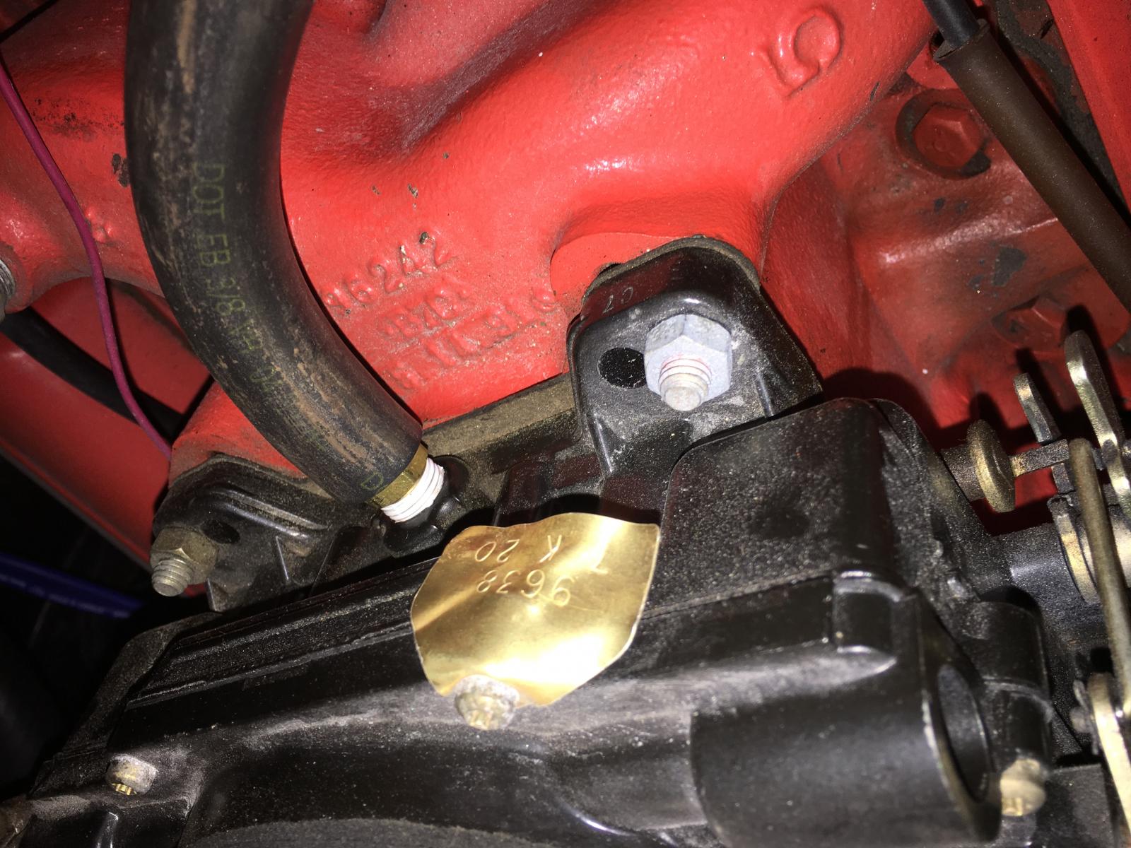

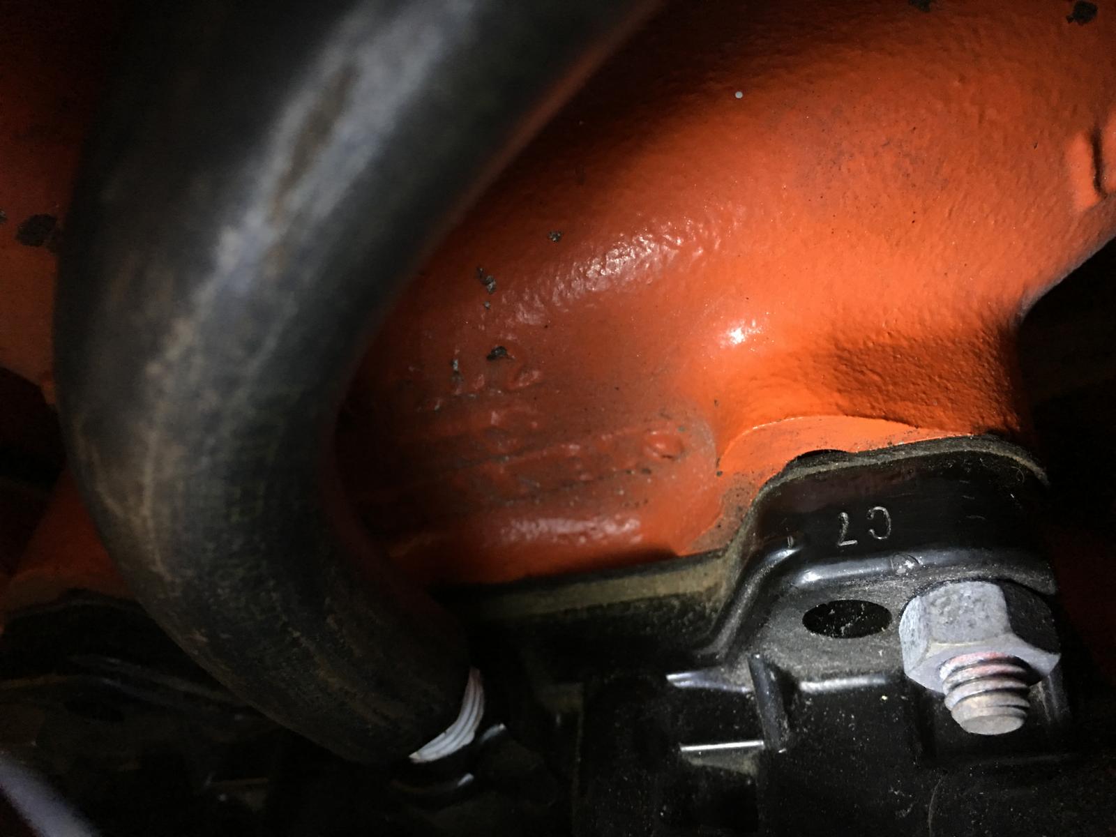

      I'm hoping someone can help me identify this carburetor so I can pick up a rebuild kit. It looks to be a Carter, or possibly an Edelbrock. I don't recall ever seeing one coated black like this, but it looks like the carb was build like this. I could not find any stampings on the base other than C7. The brass tag also has 9638 and K20 on it. I would have expected there to be an "S" after the 9638 for a Carter carb. Assuming it is a Carter, I haven't been able to find any information on a "9638" to tell me what CFM it is or any other details.
      Any help is much appreciated!
      (sorry for the upside down pics, not sure what happened there)

      625 cfm carter afb.

      The real # you need is on the front passenger side carb foot. Probably a 625 Carter, but looks like a factory one, not aftermarket. Post the number off the front foot and i can tell you what it is
