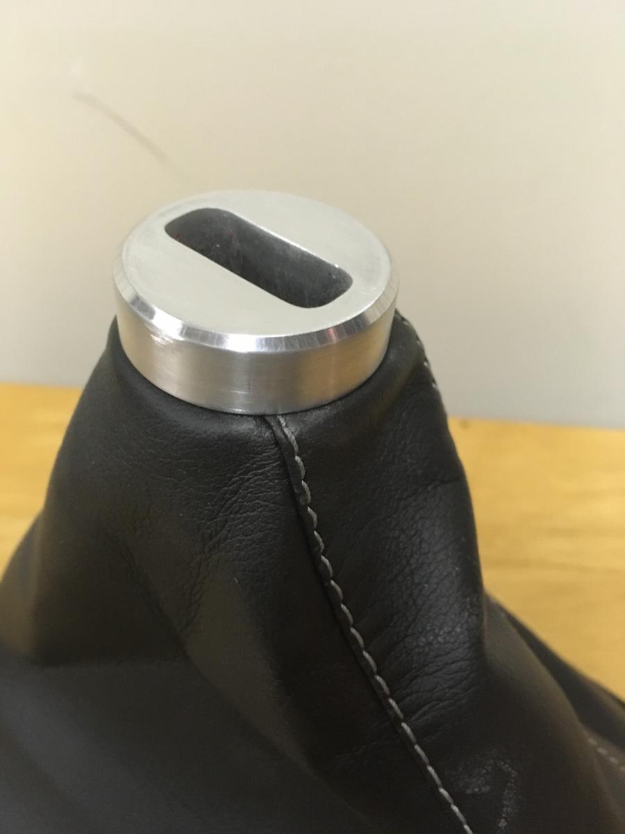

      One other project was to figure out something for the shifter boot going around my flat Hurst shifter handle. Crunching the leather around the handle didn't look good so I made this out of a piece of aluminum. The part has a groove machined into it underneath and the leather is held in place by an O-ring. Now I just have to polish it to a chrome like finish and cross another thing off the list.
      This console is going to work really nice. Having an armrest and cup holders is a good thing.Name:  IMG_0453.jpg
