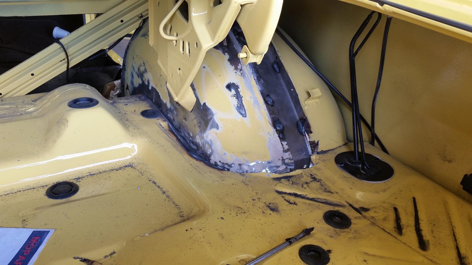

      I finally decided what the heck and brought the Cuda to the body shop and left it there. We have now taken all the black down, filled in the hood in shallow places and put some primer on it. It will be painted the correct AAR black in the next few weeks. We have also installed a mini-tub kit which I purchased from US Cartool and have just finished installing a 4-link system from Control Freak (very nice system). Just today we ordered the new rear wheels, RushForth Rated-X with matte black centers, cleared brushed loops and no hardware. I am going with a 20x12 rear with probably a 335/30/20. We are in the process of calculating the wheel tire combo for the front. I do not want to alter the fender or fender trim so if my thinking is correct we will probably play it safe and go with a 19x8 and a 255 up front. This should avoid any possibilities of rubbing. If I can fit a 19x9 275 up front I would much prefer to go with that but we will see.
      So that is it for now. The tubs are done, the 4-link is installed, the wheels are are ordered which is delaying my ability to narrow the rear end. The paint should be coming next along with undercoating the under carriage and trunk. I have also changed the stock gauges to some Autometer Pro Comp gauges which was definitely the right move. I will do my best to keep you guys updated on my progress. I am hoping to have everything completed in 90-120 days so I can get back on the road. I miss having this thing in my garage and being able to hit the road whenever I want but I firmly believe that everything i am doing will make the car so much more appealing and fun to drive when it is done.

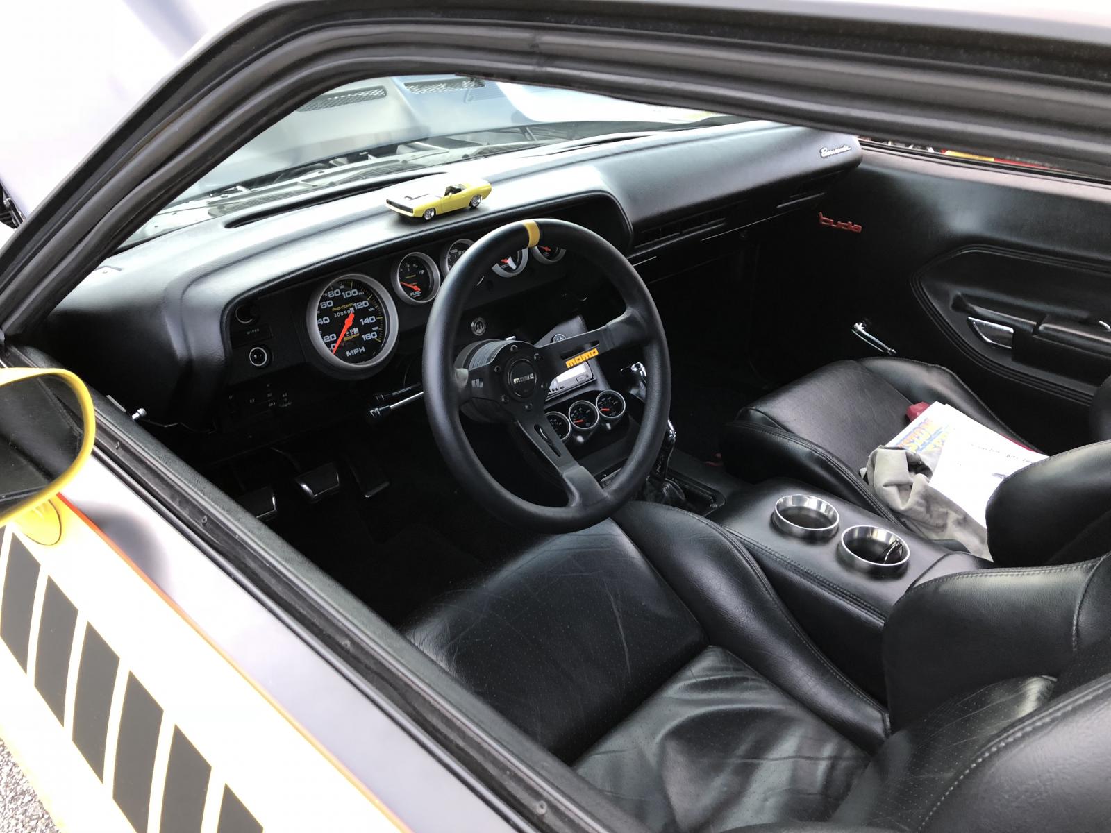

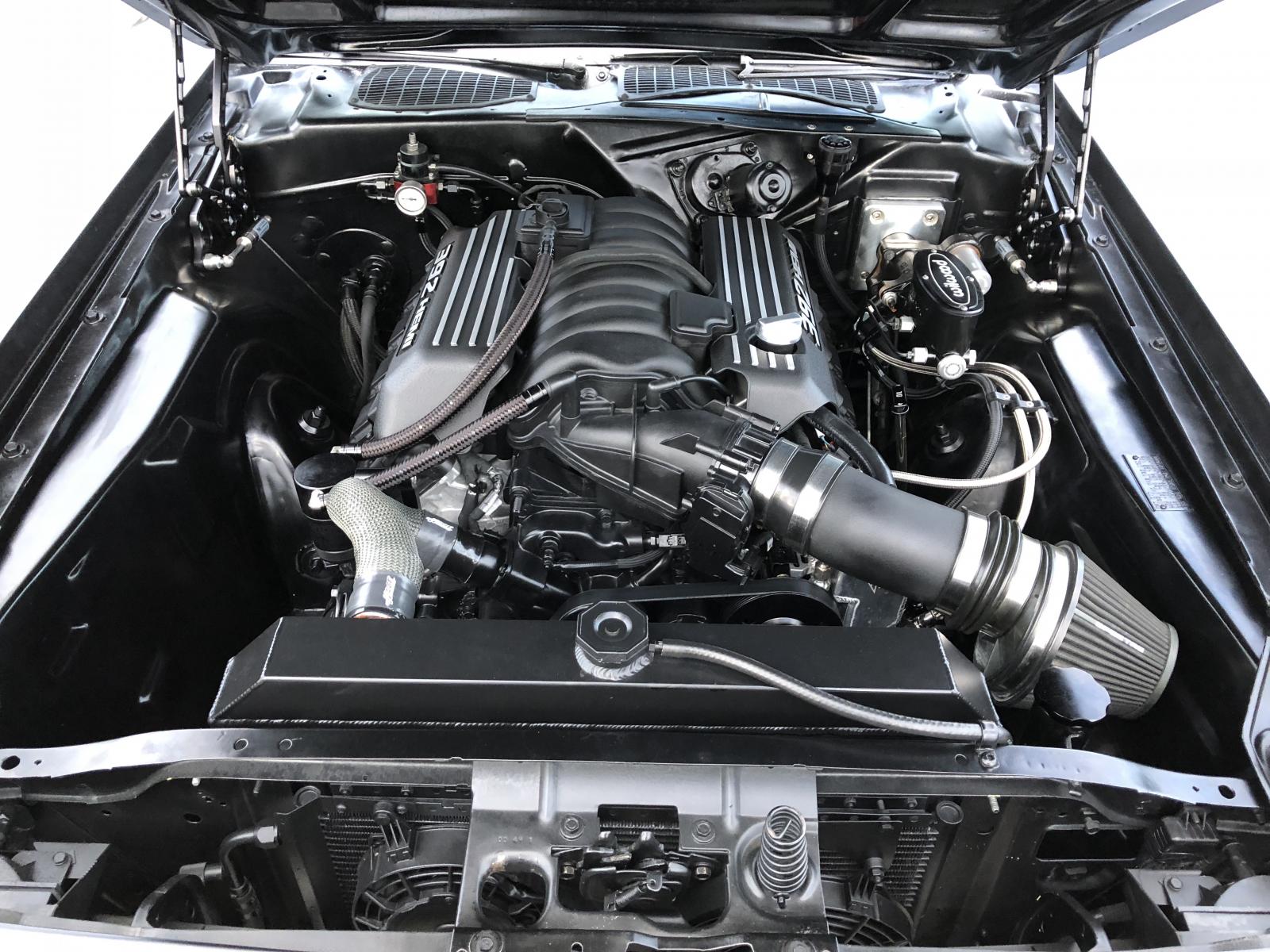

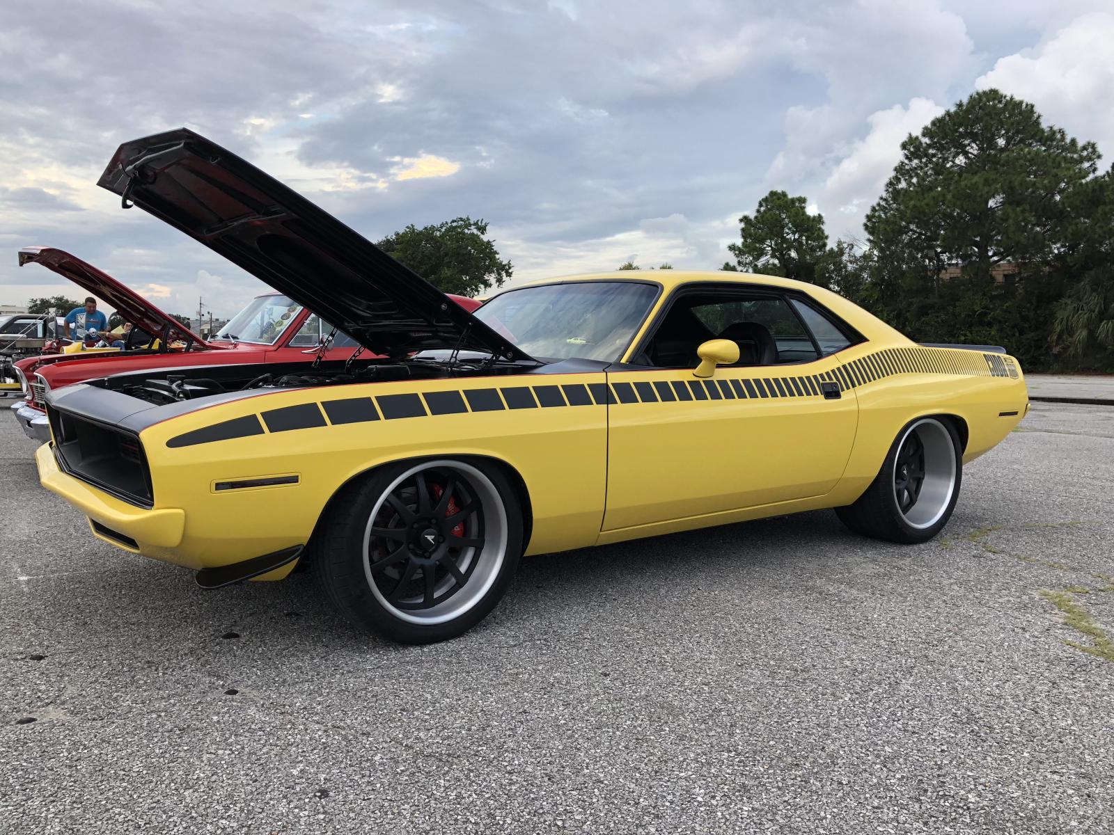

      Thanks for the compliments. Took it out tonight to a small cruise night and got a lot of good feedback. Nice to see the hard work paid off. Took s few more pucs. Name:  C2F86B7E-4A7D-4FBB-8FA2-D3614BC94C93.jpg
Size:  290.8 KBName:  345BA99F-440A-423A-9661-308D763B92C0.jpg
Size:  375.3 KBName:  71B8F4AB-5716-4AE2-A9F2-55EBD7173CD7.jpg
Size:  203.3 KBName:  17A0EA23-76B2-42A3-8A1F-88391DB08E38.jpg
Size:  249.9 KBName:  FEEC1ACC-6BA6-48C0-8724-26D8C22F7789.jpg

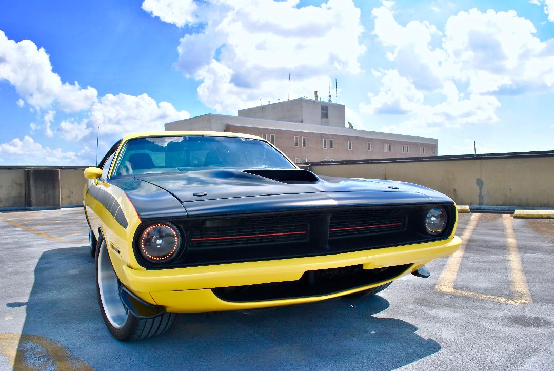

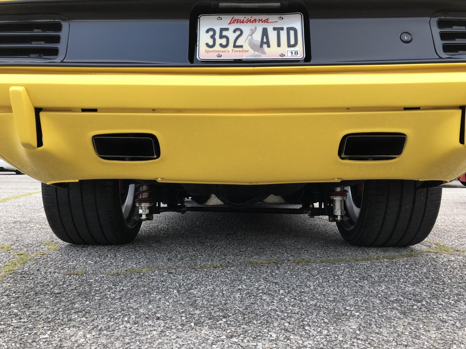

      So the Cuda is pretty much finished with some small changes still to come but thought I would share some updated pics from the past weekend. Hope this motivates some of you not to give up on your builds. They are so much fun when they are done.
