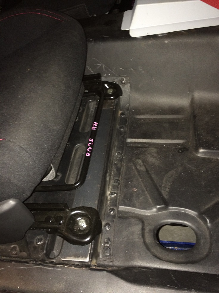

      Nov 2014
      243
      we adjusted the positions of the existing mounts to get the lowest mounting points. has held up well with 3 years of hard driving.

      Btmatt: good stuff! Looks like I’ll do the same. Anything you would do differently if you were doing it again?
      On another note, did you remove the airbag inflators from the seats?

      Nov 2014
      243
      Quote Originally Posted by Flawless View Post
      - - - Updated - - -
      Sorry, just saw this. Seats have worked flawlessly. Only change would be to lose some weight so I fit better
      We did not remove the air bags; didn't want to risk tearing the cover
