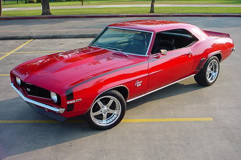

      I saw this car and I just love the color and I was wondering who own's it. I want to know what color red that is.

      That '69 was built by one of our moderators and LS1tech owner, Tony Whatley (nine ball). www.extremeg.net is the website, I believe. I'm pretty sure the car is Viper Red, he actually just sold it.
      Tony is in the Bahamas right now, but I'm sure he'll answer any questions when he gets back.

      In those pictures the car looks like its sitting way to high, I could have swore the car sat better that that.

      I'm pretty sure those pictures are pre suspension mods. I think they were taken right after Tony bought the car, and had just put the wheels on.

      The color is 1995 Viper Red. It was an awesome color, very bright without looking too tomato colored. Nice deep bright red.
      Those pics were taken while the car was still stock. Just had wheels bolted onto it. Notice the drum brakes
