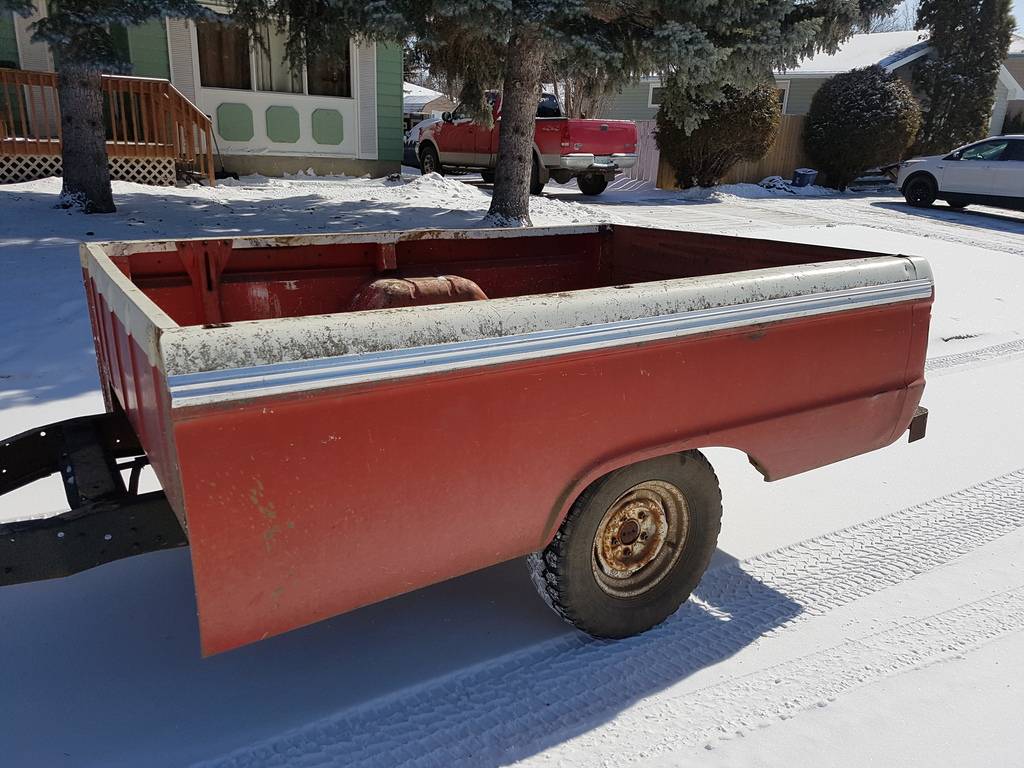

      So haven't really had any time to work on the truck. I have been looking for the box trim for a while and ended up finding a truck box trailer that had it for a really good deal. Will probably just sell the trailer once I take them trim off, or maybe paint it to match.
      Jan 2017
      4
      Nice score on the trailer, looks like it's in good shape! That would be cool to slam it down and paint it to match, maybe add a period correct canopy?...Would make a good tailgater, or a cool add on if you took it to car shows etc. Either way really like this build!
