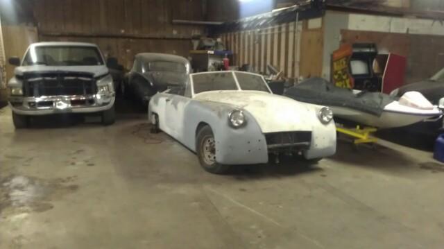

      I bought this Muntz Jet back in 2013 sight unseen. It was found in a warehouse in Biloxi, Mississippi after the previous owner had passed away. Talking to some local contacts, and using lots of cell phone pictures, I knew the car wasn't stock but the extent of the modifications to it remained a bit of a mystery. Adding to the unknown is that this is a Muntz Jet, one of only about 250 cars built, there's simply not all that much information available on what the structure looked like originally.
      I had the Muntz shipped up to my humble 2 car garage in the Seattle area along with the original engine and transmission. The original engine was no longer in the car but was found in some back corner of the same warehouse. I had hope it could get incorporated back into the Jet. For a couple months I poured over the car, taking it apart and trying to figure out what was original and what wasn't. It soon became clear to me that extensive modifications had been made to the cars structure. The front clip and rear was taken from a G-body car - possibly a mid-80's Buick Regal - and welded in to mate with the Muntz mid section. Nothing mechanical was original - the original engine was now a SBC 350 with a TH350 transmission. The interior had been replaced by something from a late 80's to early 90's Cadillac. After all that my mind changed from a restoration to more of a resto-mod build. On top of that, because I didn't know the pedigree of anything previously done to the car, I decided it was best to tear this car down as much as feasible and build it back up how I wanted.

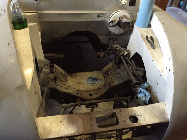

      Everything is covered in a thick layer of dust and rat droppings.

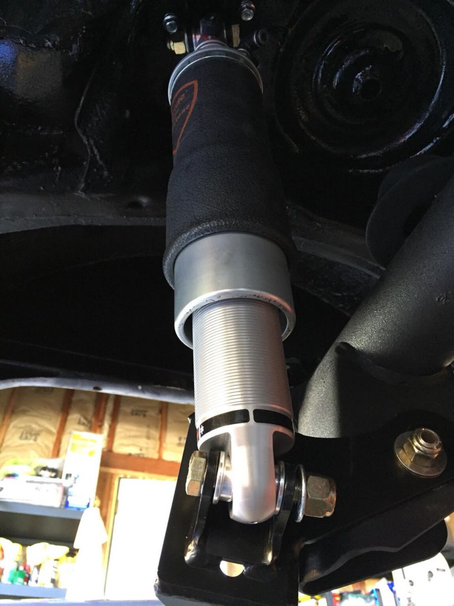

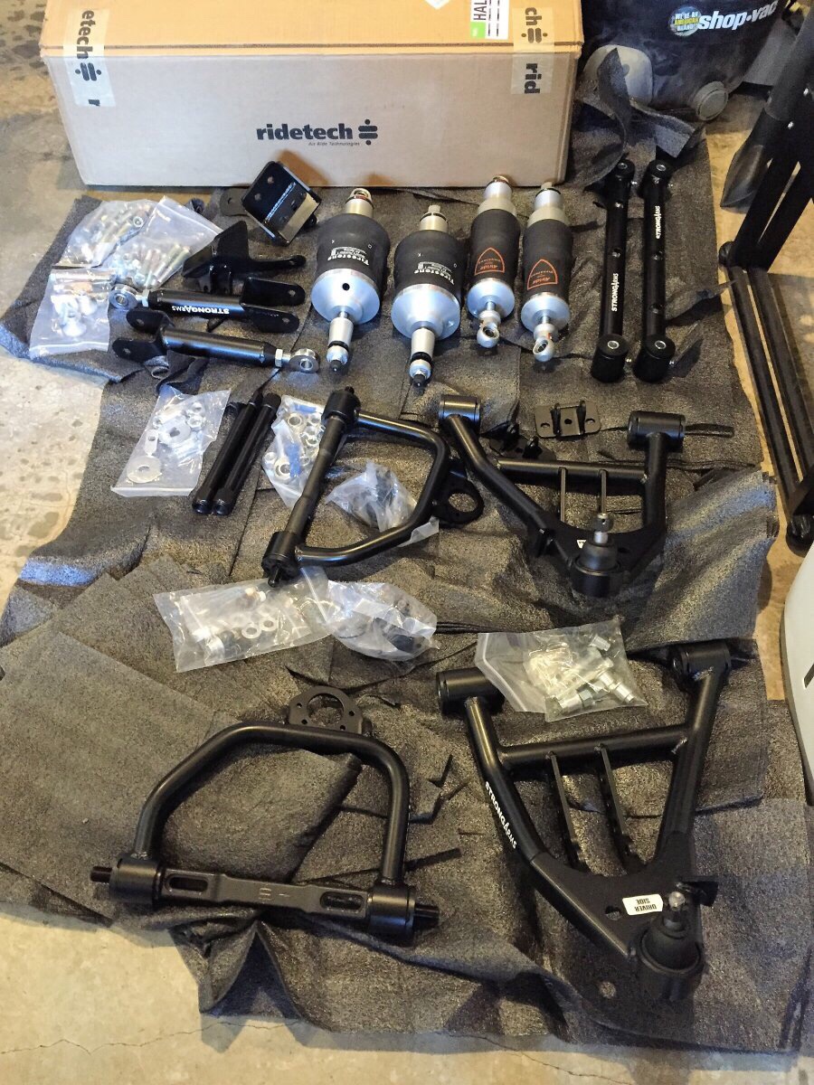

      Unfortunately an unlimited budget is something that I don't have. Therefore, to get the major components to make my resto-mod, I had to buy them piece-meal as my budget allowed. The first major purchase was going to be the suspension. Why? Well I figured the old Buick suspension was one of the first items to come off when I disassembled the car, and to get the Jet off the jack stands and back on tires a new suspension was going to be needed sooner rather than later.
      With that decided, I needed to figure out what suspension to get. As mentioned in a previous post, the front and rear framework from the Buick allowed me to purchase one of the many available off the shelf g-body designed suspension systems. Ultimately what suspension system is used comes down to the intended use of the car. In my case I had decided that I wanted this car to be a cruiser - something that would be just at home flying down the highway as it would going slow through town. I'm not looking for a 1/4 mile car or track car. I wanted a suspension system that offered comfortable cruising but also versatility. To say I did a lot of research would be an understatement. I looked at air ride, and coil over, and the stock g-body setup and all the iterations contained therein. I looked at several manufacturers and read reviews wherever I could find them on the internet. As I kept looking I couldn't help but notice that the brand RideTech continued to pop up with mostly positive feedback.
      So, I started focusing on RideTech suspensions. For the g-body they offer several levels and kits - everything from just coil overs to full computer controlled air ride kits. Honestly, I didn't know what to get. It would be one thing if I knew what the car looked like before - like if I was putting a new suspension on a car I already knew well. But when all you have is a shell of a car sitting on jack stands, a car that came to you with different sized tires on each corner and a suspension not originally built for that particular car, it's hard to know if you'll get the ride height you desire when it's all done. It would be a major bummer if you find you bought the wrong ride height suspension and you hated the look. It was that unknown is what ultimately drove my decision to the more complicated, yet more versatile, air ride suspension. I had heard the positives and negatives of air ride but in the end the decision really came down simple fact of wanting to be able to control the ride height of the car without first knowing exactly what that car was going to look like. It was as simple as that.
      Now to decide the type of air ride within RideTech's inventory. That wasn't too difficult a decision either. The g-body suspension on the car was flat out tired. The bushings were old and cracked. The different components were covered in a light surface rust. Could they be brought back to life? Sure, but at what expense of time and overall functionality to the completed Jet. In the end I chose the Level II kit that included the air ride components as well as new control arms, ball joints, rear links, etc. Obviously the car is not yet running but I believe in the end it'll be the right decision and it'll give me the functionality I was searching for.

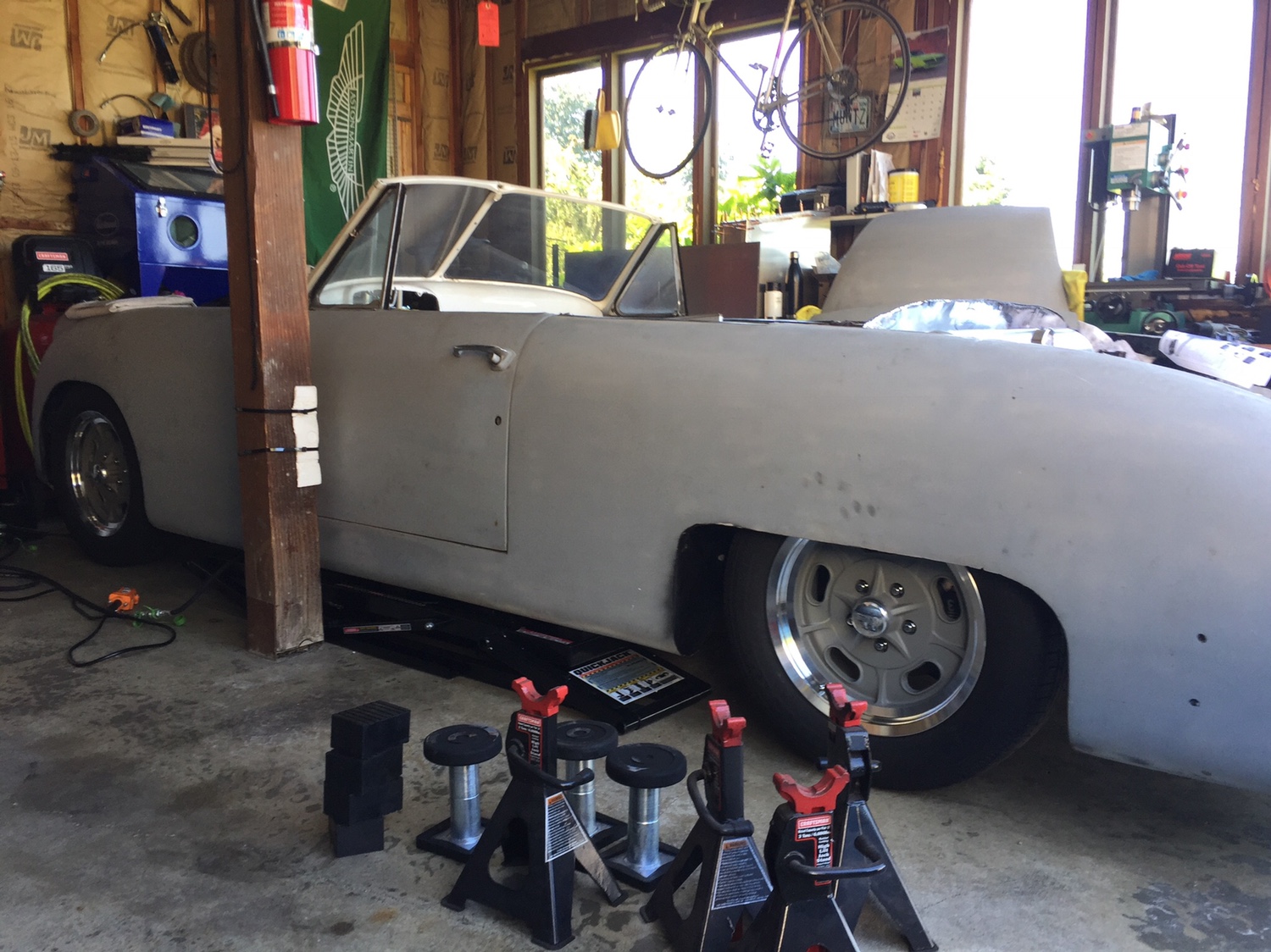

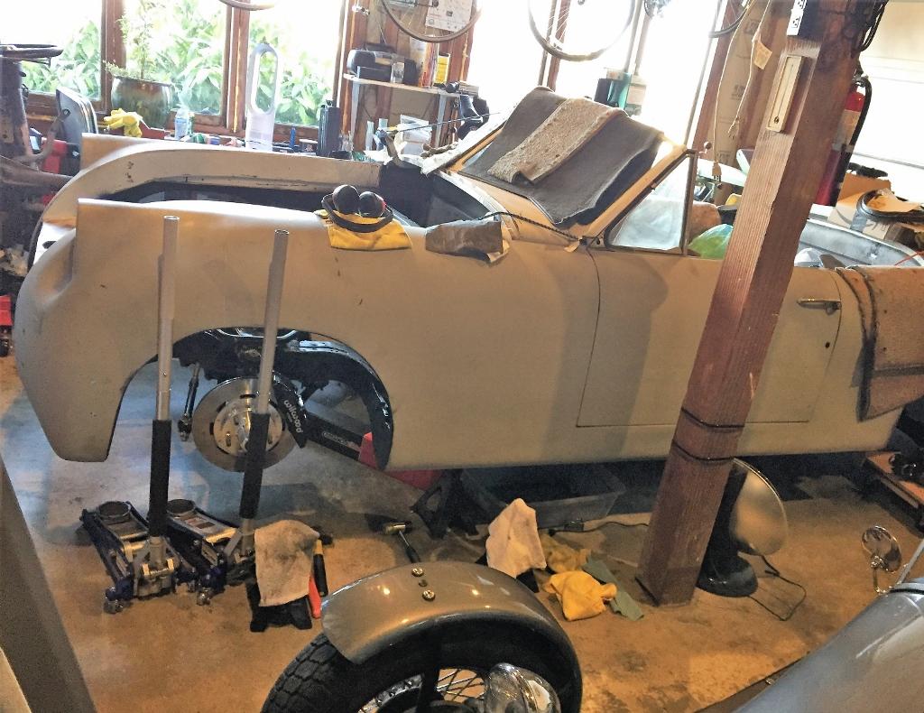

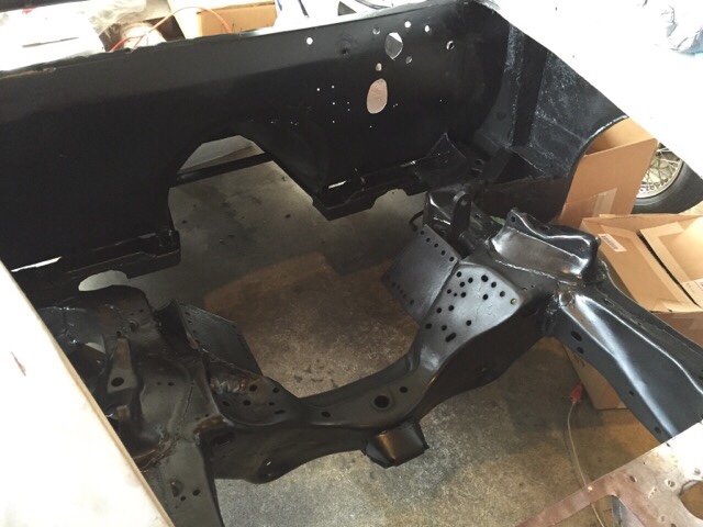

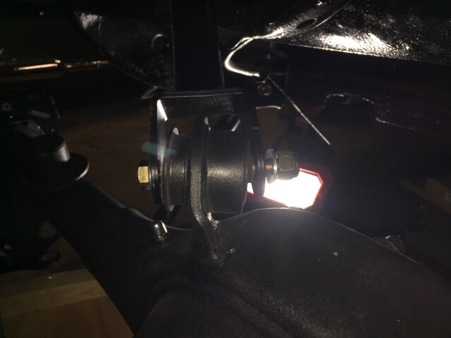

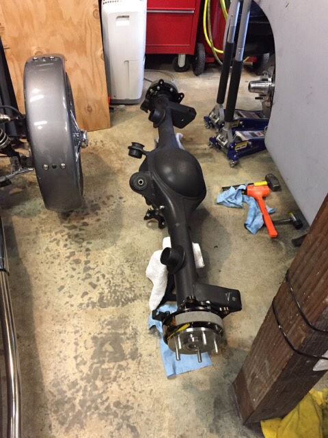

      Like any project, even the jobs that are expected to be simple turn out to be a challenge. The Muntz is no different. As I previously mentioned, this particular car is not stock with its front and rear frame work replaced by that of a g-body car. So I knew the rear axle housing, and where it mounts into the car were not original Muntz. Knowing the g-body history, and since the existing axle housing is rusty with unknown pedigree, I took some measurements of the axle housing and ordered a new one to match the g-body configuration. Both are the same measurements - couldn't be more simple.
      With a new housing in hand, and a new 3rd member all bolted into it, the time had come to bolt all of that new goodness into the car. What I did not realize at the time was that the previous owner did not change the length of the suspension components, or the axle housing itself, but bent the suspension parts and thereby changed the angle of them between the car and housing. Why? - Because unbeknownst to me until now the g-body frame has been narrowed by about 3" from stock, but the axle housing was not. That's the kind of stuff I imagine you learn to look out for if you've done this a time or two. I have not. Whoops.
      So now I have a new housing, and new suspension components, all made for a g-body that aren't fitting together because the frame isn't where it's supposed to be. The lower suspension arms bolt to a bracket welded to the inboard box of the frame, so I don't see an easy way of widening that distance without moving the frame back to stock. It seems the easiest course of action at this time is to tear down the axle housing, and take it to have the top and lower suspension housing brackets removed and welded at new angles. I'm going pro with this welding job because hopefully it can be done without warping the housing. I guess we'll see.

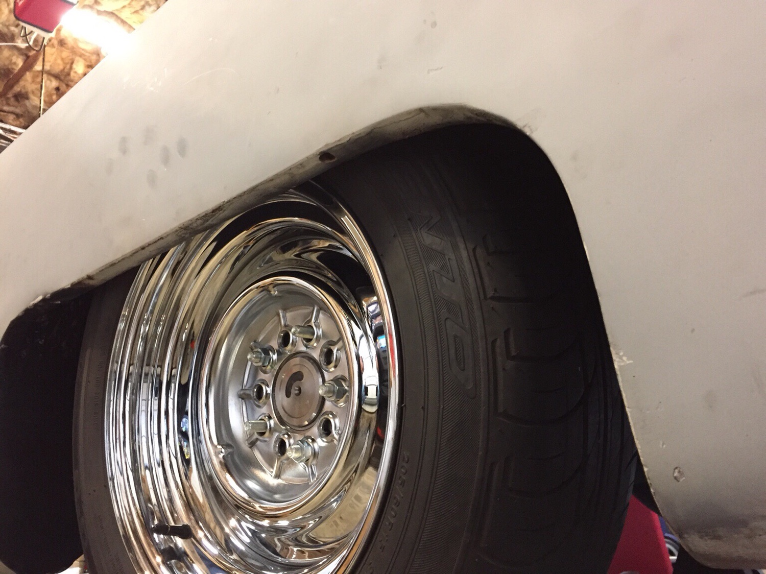

      While the 15x7 wheels I bought as an initial fit check cleared, the chrome 15x7 baby moon style wheels I bought off craigslist didn’t fit over the front brakes. That must be what they mean when they say the brakes fitting “most” 15” wheels. In addition the tires on the rears, just barely, rubbed on the ID of the fender. Not wanting to risk trying another 15” rim I decided to shift to 16x6 rims in an attempt to both clear the brakes and alleviate any rubbing. I also made myself a lame sketch to visualize how much space I’d be gaining in relation to the 7” wide wheels with a 4.25” backspace.
      I always liked the mag racing wheel look and felt that it fit the vintage of the Muntz, so I rolled the dice on fitment and purchased a set of Rocket Igniter wheels in 16x6. It took nearly 9 months since I ordered them for them to arrive (I think they had to mine the aluminum), but now that I got them I think they look pretty good, but more importantly, they clear everything without rubbing.

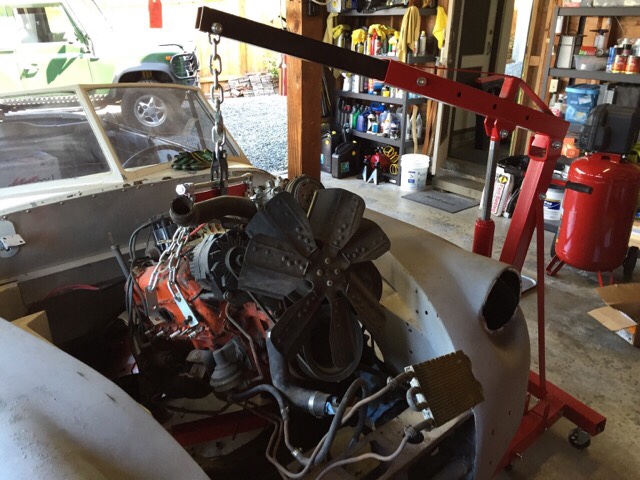

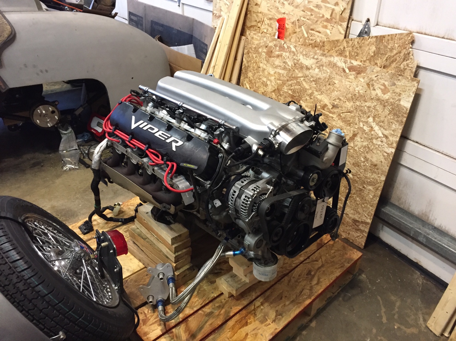

      It’s said that the engine is the heart of the car. The Muntz Jet, being a unique American car, I felt deserves a unique American engine. The flathead 337 Lincoln that came with the car originally, for a number of reasons, just wouldn’t do. Why go through the trouble of using the original engine when the framework of the car has been extensively modified? I’ve read that the Lincoln had problems with overheating. I know it’s too under powered and too heavy. My plan all along was to make this car a reliable and exciting driver – all new underneath but look close to original on the outside. The ubiquitous Chevy 350 that came with the car was an unknown. Overall a great engine but in this case completely unknown pedigree. That engine may have a millions miles on it for all I know. And, frankly, for whatever reason, I just didn’t like it. I wanted something better.
      I looked hard at Chevy Performance and the LS motors. Their “connect and cruise” package would more or less bolt right in where in the old Chevy 350 was pulled from the car. It is the engine that would just make sense. Then that all changed when I went to a local car show. Taking particular notice of what engine folks were running I started to notice a trend – I’d guess 9 out of 10 cars there were running some form of the small block Chevy. It attests to how good of an engine it is, but it was just too common for me.
      I looked at Ford Coyote engines. Ford’s biggest problem, in my opinion, is that they simply don’t make their crate motors as accessible to hot rodding as Chevy. For example, they don’t offer (at least at this time) any type of connect and cruise package. They also don’t offer anything with the option of running a Coyote with a newer automatic transmission. I wanted to run an auto because that’s what the original Muntz had and I wanted to keep it looking as close to original as possible on the interior.
      Then one day while cruising ebay I stumbled onto an engine I knew of but hadn’t thought about – a Dodge Viper V10. Extensive research ensued. Would it fit? Tape measure shows it should, in fact, it’s not much larger than the original Lincoln 337 flathead. Before I knew it I had a Viper engine out of a wrecked SRT truck sitting on a pallet in my garage. A unique American engine to go in a unique American car.

      Why such a small engine? This is going to be amazing!
