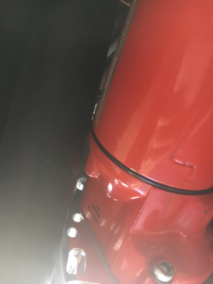

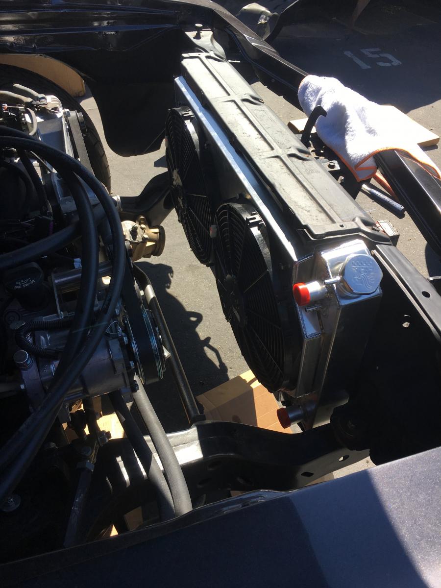

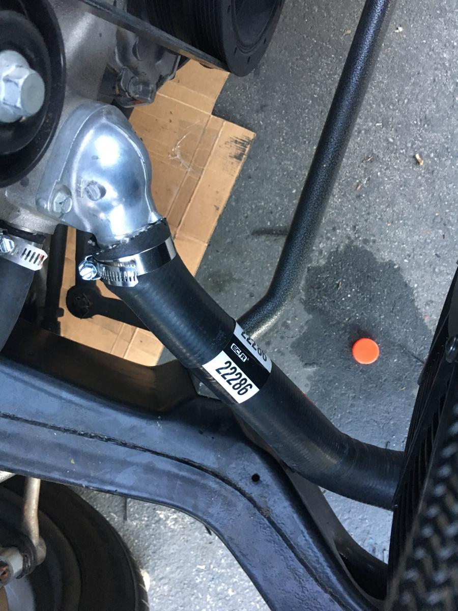

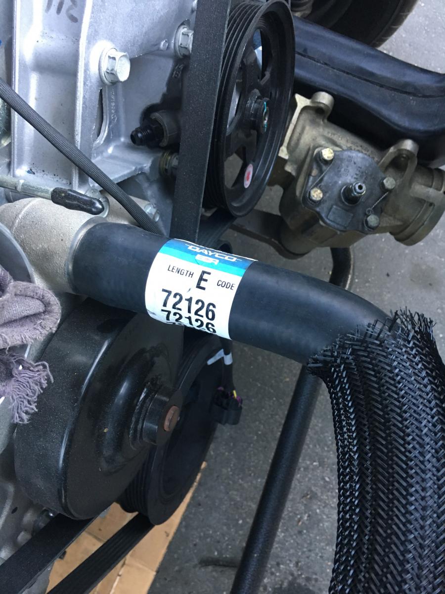

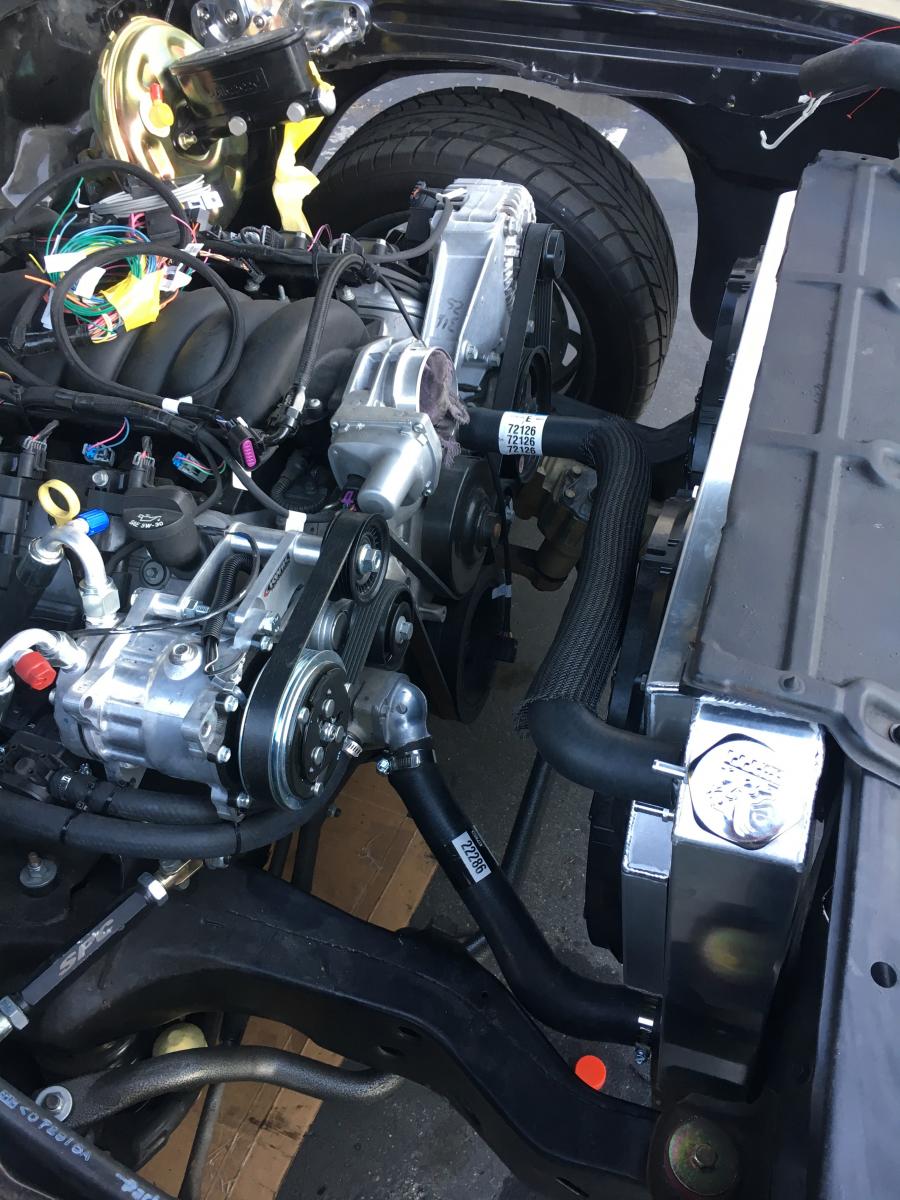

      status update. got the radiator and front end on recently. also are pictures of the parts #s for the radiator hoses. Name:  IMG_6037.jpg
Size:  125.9 KBName:  IMG_6039.jpg
Size:  159.5 KBName:  IMG_6042.jpg
Size:  145.9 KBName:  IMG_6043.jpg
Size:  154.0 KBName:  IMG_6044.jpg

      Does that drive belt actually rest again the throttle body in final assembly?

      Quote Originally Posted by csouth View Post
      no, but its damn close. it wont hit but there are some problems in the vintage air instructions. the vintage kit is easy to install if you have done one before because their instructions suck ass. measure out your hoses before you pass them through the firewall and have them crimped. because once they are in they wont come out easy. also the vintage kit mounts the compressor on the pass side like a 68. so you install like a 69 only to realize you did like 40 min of BS work you didnt have to do and now take it apart. triple check your condenser is the right way 1st time. and then as far as the belt and throttle body you need to swap the tensioner pulley for the idler pulley so the smooth one is on the bottom. vintage air wont say this, you have to call the nice guy @ KWIK to get that answer. i would say once you install 1 kit your an expert on it because its frustrating as all hell. it could also be that i dont read directions, but then again im a dude.

      Quote Originally Posted by pt2285 View Post
      I think it has to do with the way Kwik performance does it vs Vintage Air with the pulleys. My Holley accessory brackets state the tensioner is smooth and the idler is grooved. Or it could be you didn't read the directions...lol
      You got off easy with 4 straight hose runs. I have the firewall bulkhead with requires 2 separate sets of the 4 hoses being measured, clocked and crimped. One set from bulkhead to compressor/water pump, other set from bulkhead to evaporator. The VA instructions could use a little help, but for the most part I figured them out after reading at least twice.

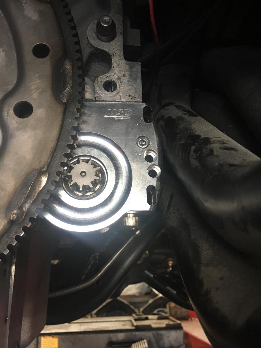

      project update.. the msd starter is right up on the header.. i think it should be.. when i pull it back off im gonna pound the header a little for clearance. Name:  IMG_6159.jpg
Size:  95.3 KBName:  IMG_6160.jpg
Size:  54.3 KBName:  IMG_6161.jpg
Size:  150.5 KBName:  IMG_6162.jpg
Size:  73.6 KBName:  IMG_6163.jpg

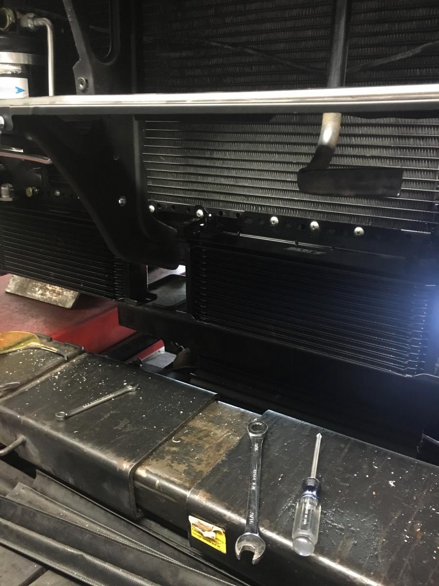

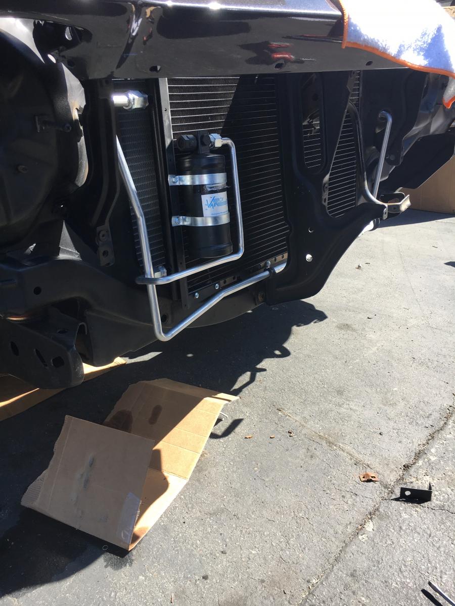

      mounting the oil and power steering coolers off the vintage air condenser. these should sit right below the openings on the chevelle bumper for air flow and the ends over hang just enough to drill/tap the radiator support to sink a bolt with spacer right into. this also adds support to the condenser. when the bumper goes on i should be able to get some angle iron or some metal to make a bracket to support the bottom of the coolers to the bumper for additional support.

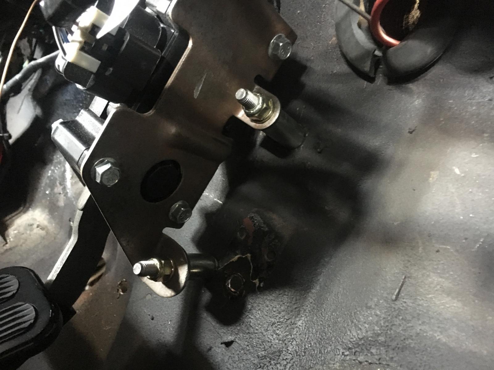

      went back and forth on bracket for the DBW pedal, ended up using some button head bolts with a larger beauty washer and a 1 1/2 spacer directly to the fire wall. pedal is super solid and where it should be. Name:  IMG_6197.jpg
Size:  108.8 KBName:  IMG_6199.jpg
