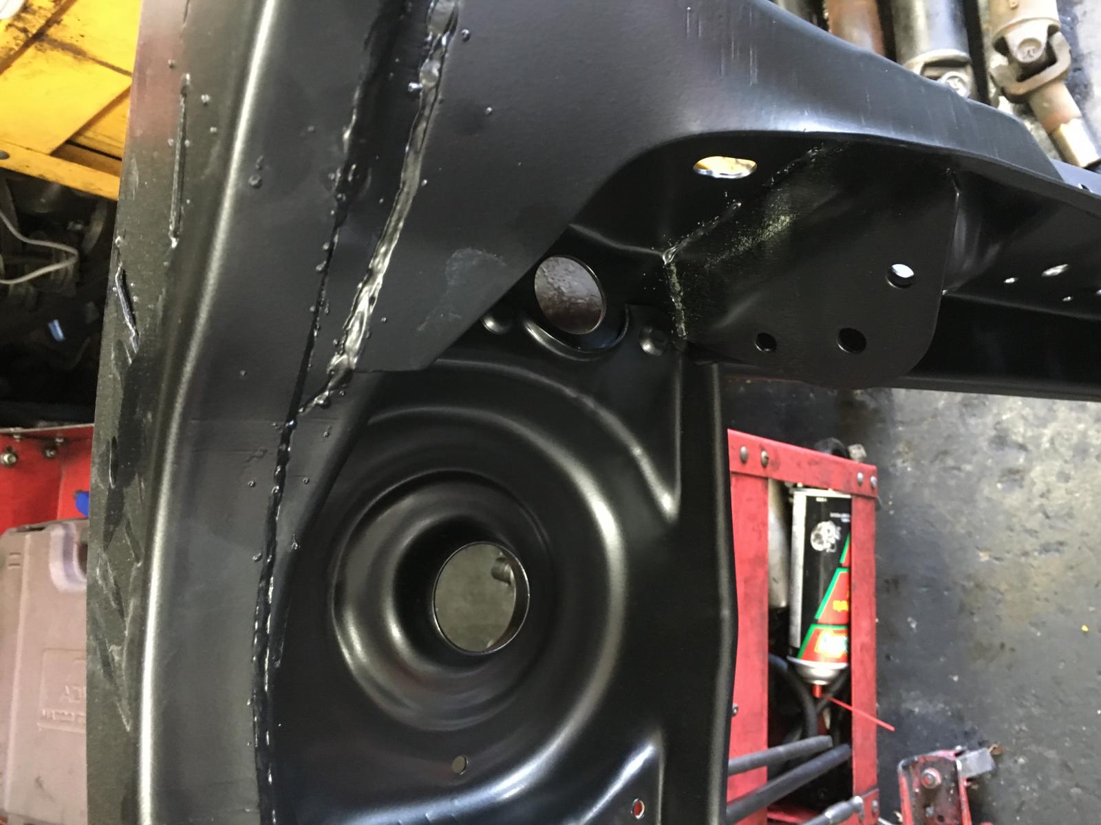

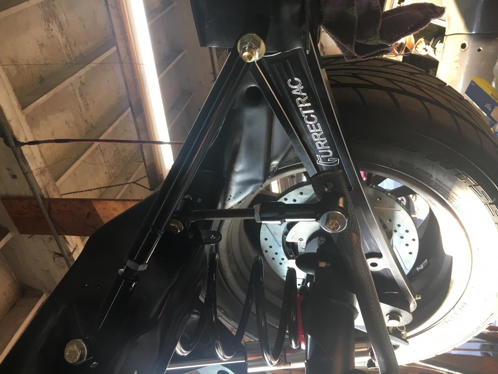

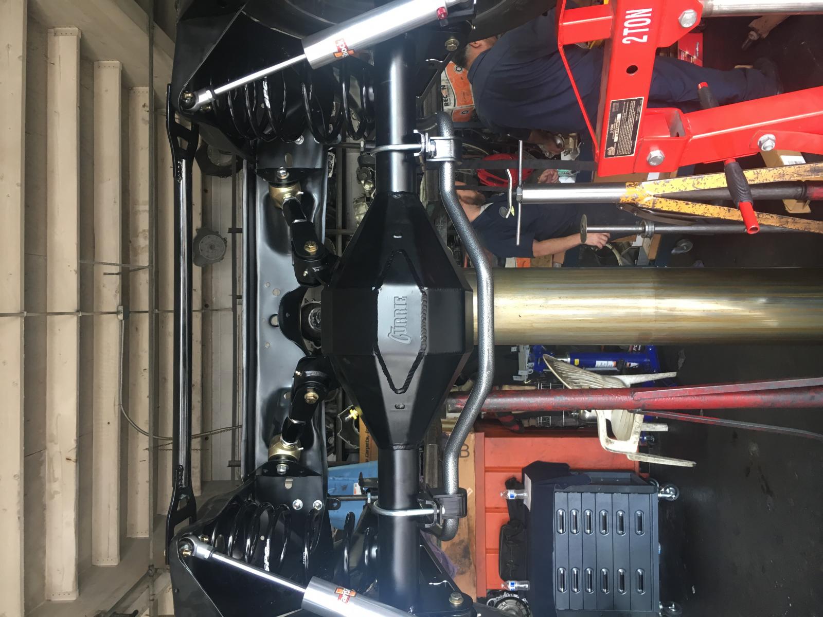

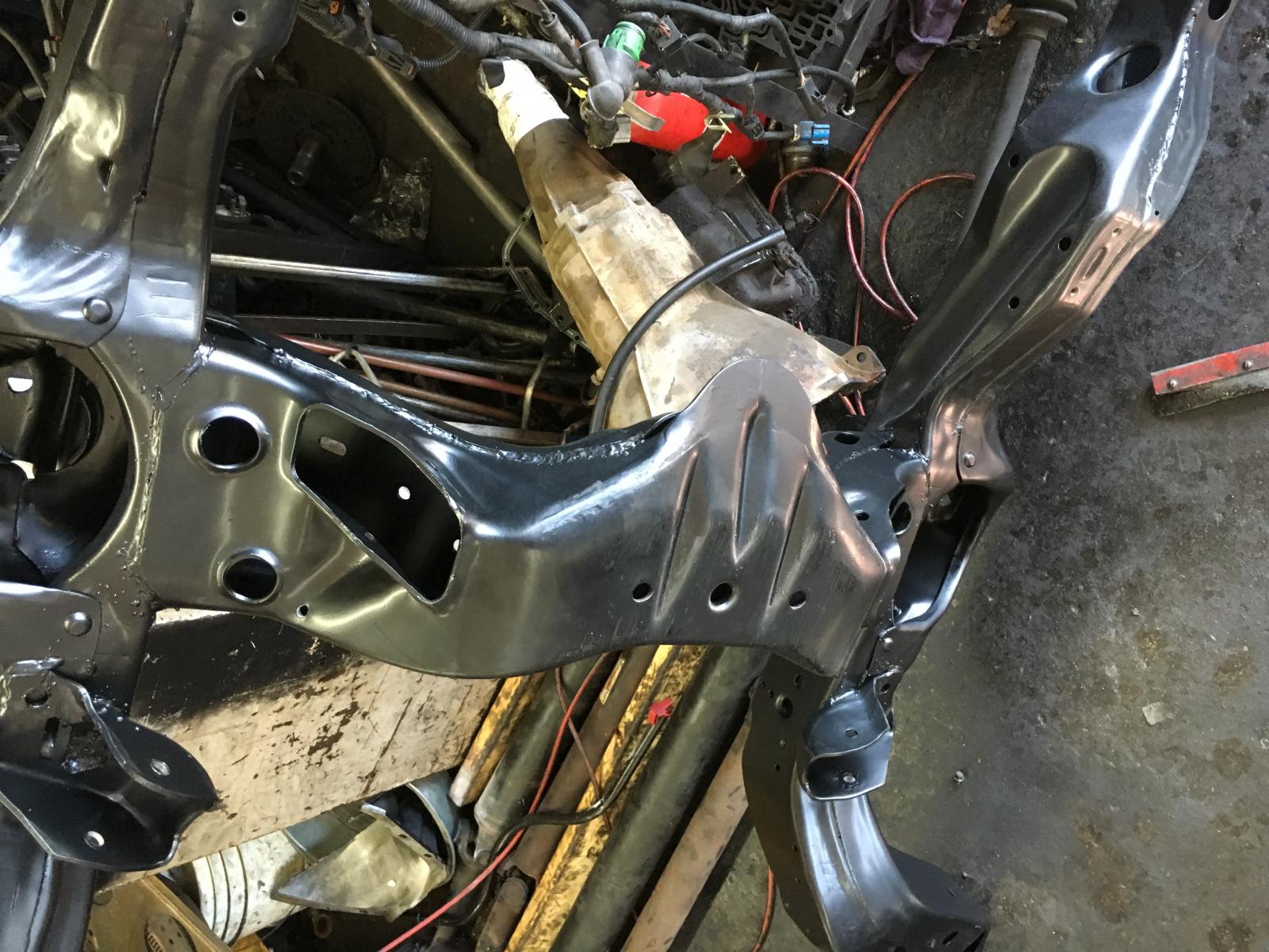

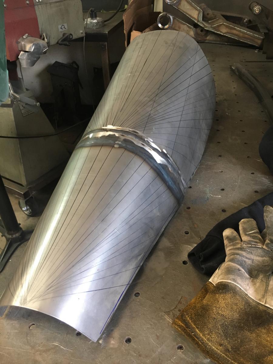

      69 chevelle track/autocross build

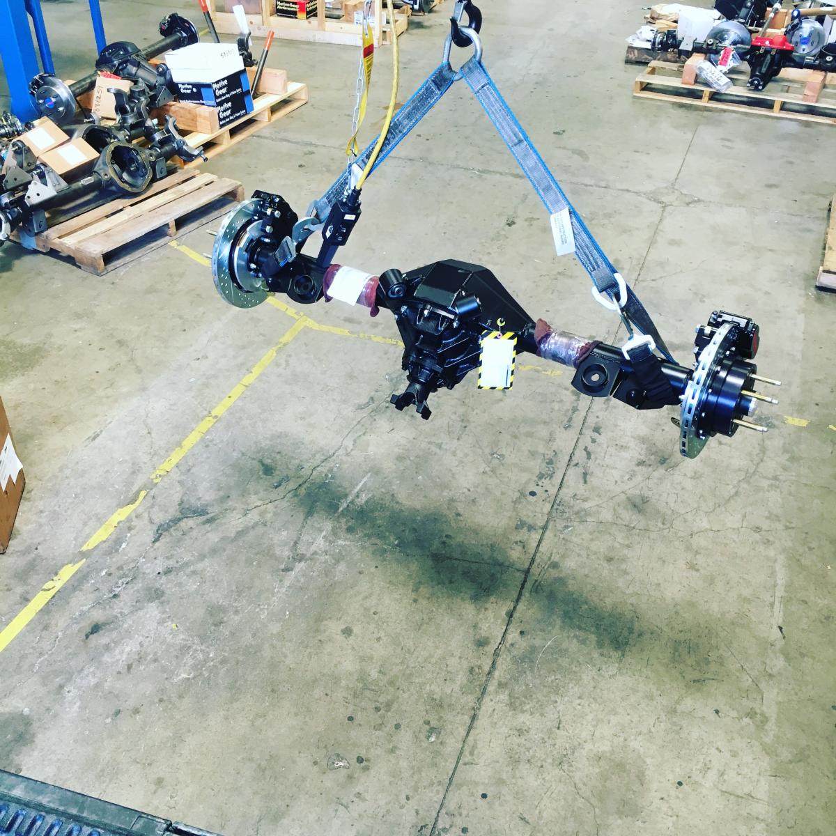

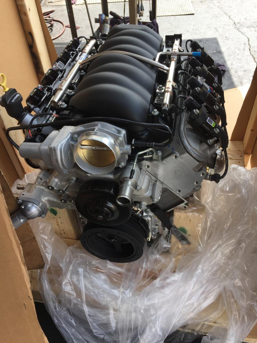

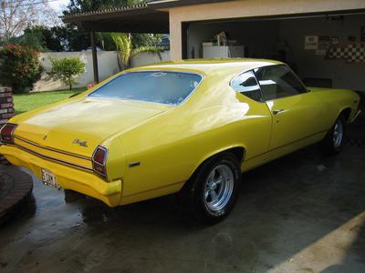

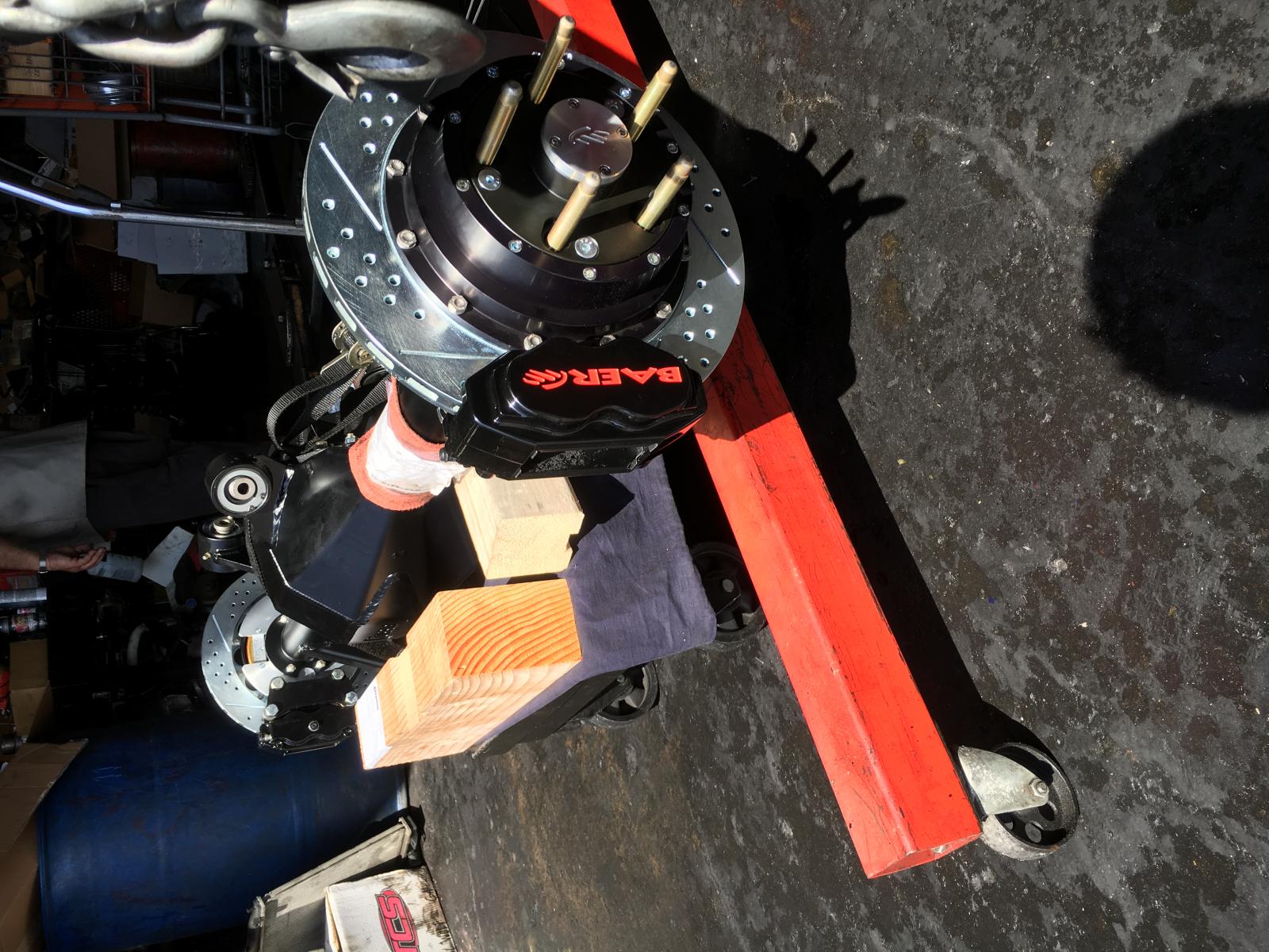

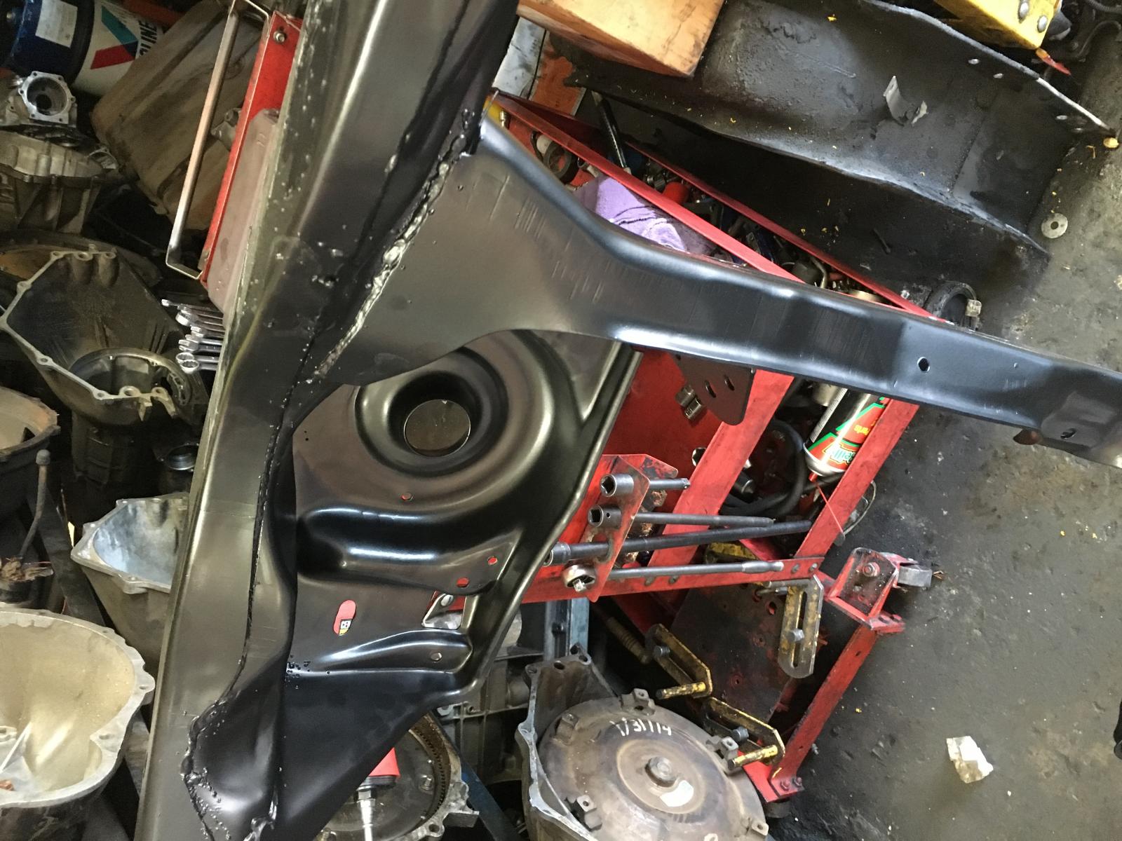

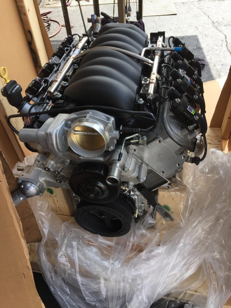

      starting this thread for other looking to do a 68-72 gm a body. i got this car when i was 14 in 1998. i worked all summer to buy parts and got some items as giofts along the way. i drove it all senior year until it caught on fire on the engine bay. flash forward 4 years to when i finally re did the wiring and drove it for a few years until the tree in front of dads house fell on top of it (chidley vs the city of covina turned out to be a loss and cities are not responsible in a storm). i patched it up and drove it until one superbowl i won some $$ in a pool and wanted to do a 700r4 swap with my winnings. that 700r4 swap turned into a full tear down and full build. so here are some pictures and i can answer some questions and update along the way.
      69 chevelle

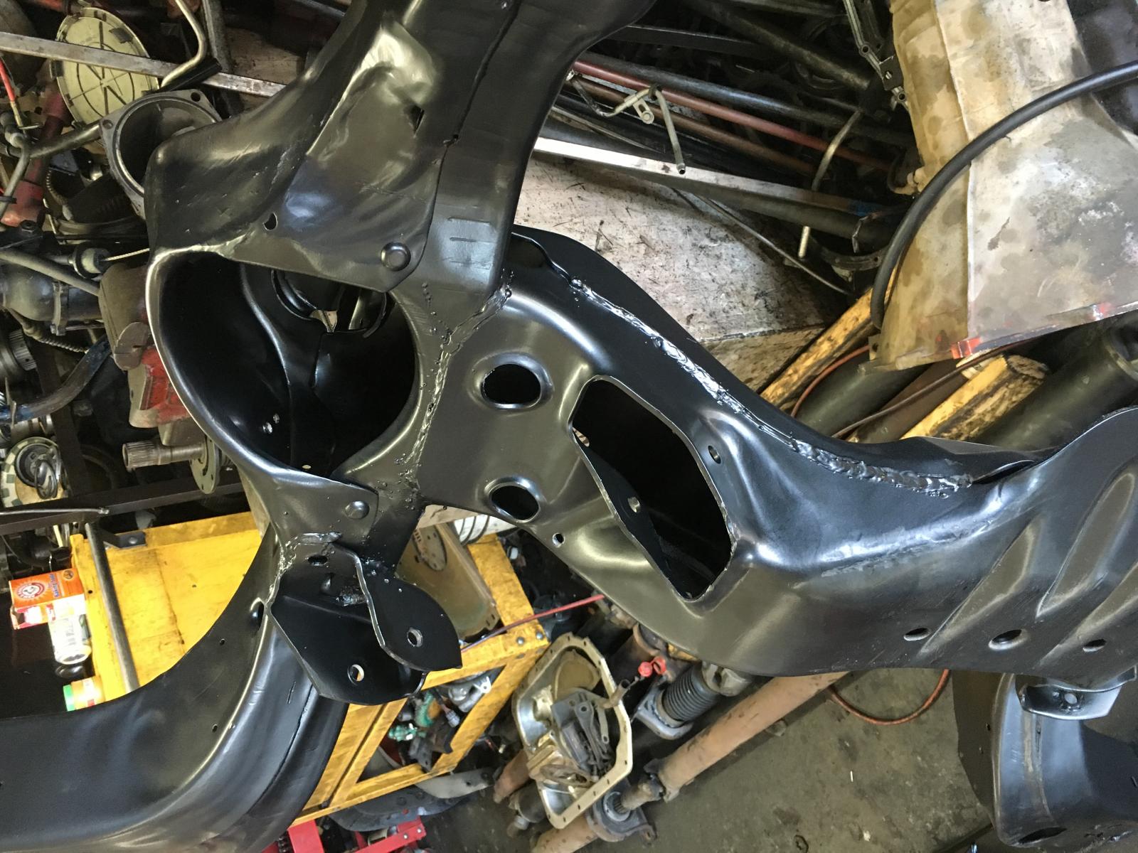

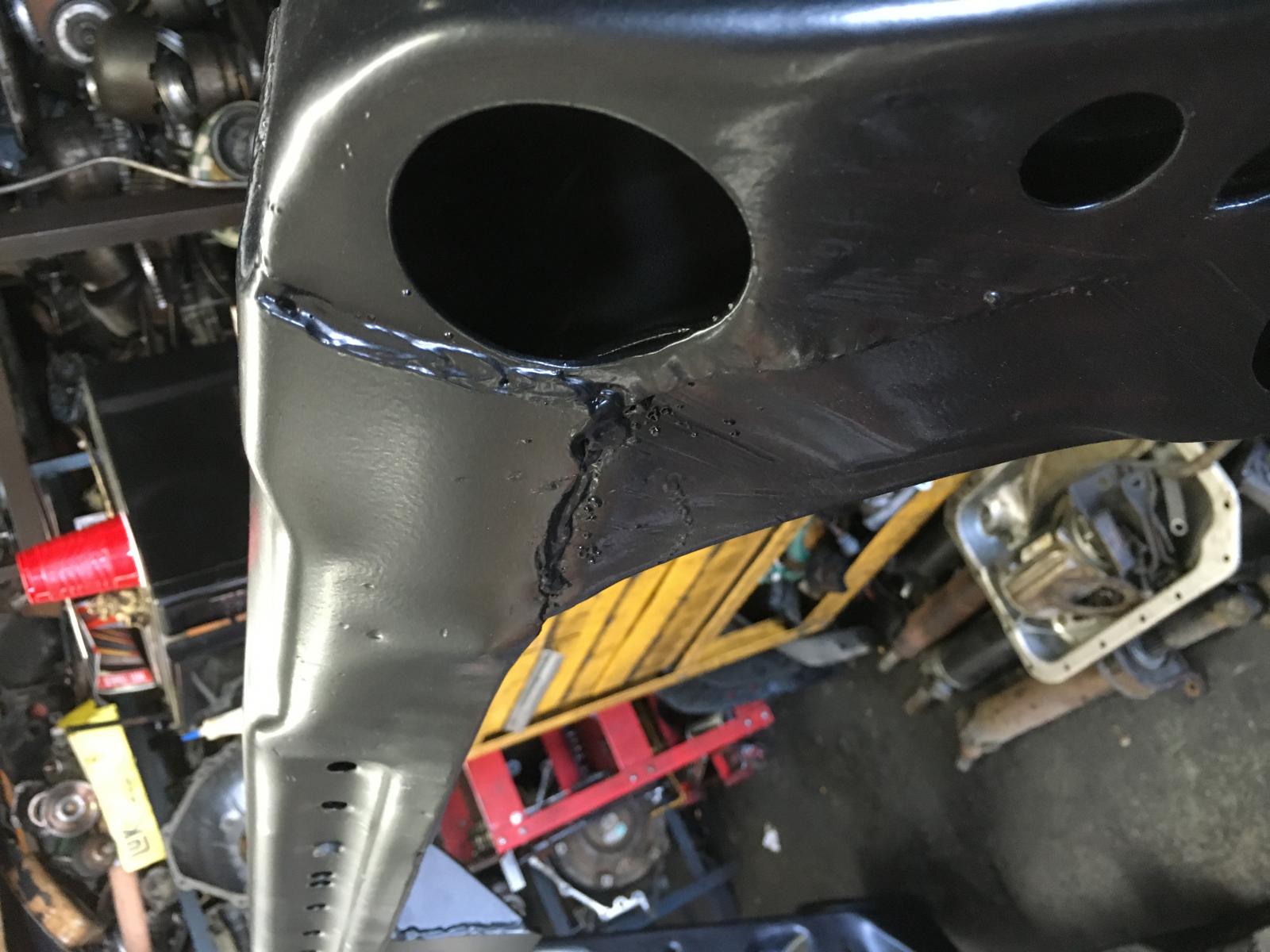

      boxed and powdered frame

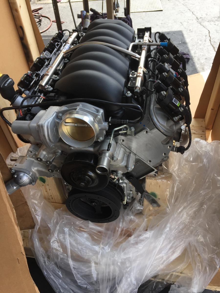

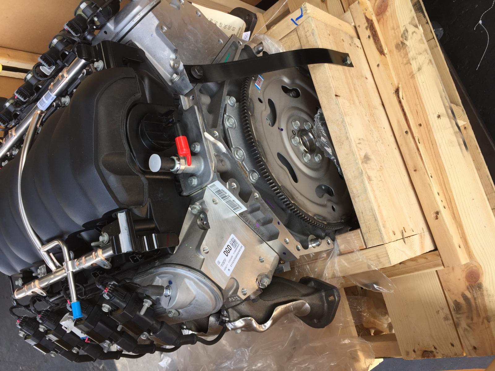

      LS3 525/376 crate engine
      6l80 e trans
      currie full floater rear end
      tanks efi fuel tank
      SC&C full suspension package with ATS/AFX spindles
      Baer brakes
      custom wheels by hot rod by boyd w/ nitto 555 (255/40 front 295/45 rear). side not chris coddington is SUPER cool.
      currently building trans tunnel

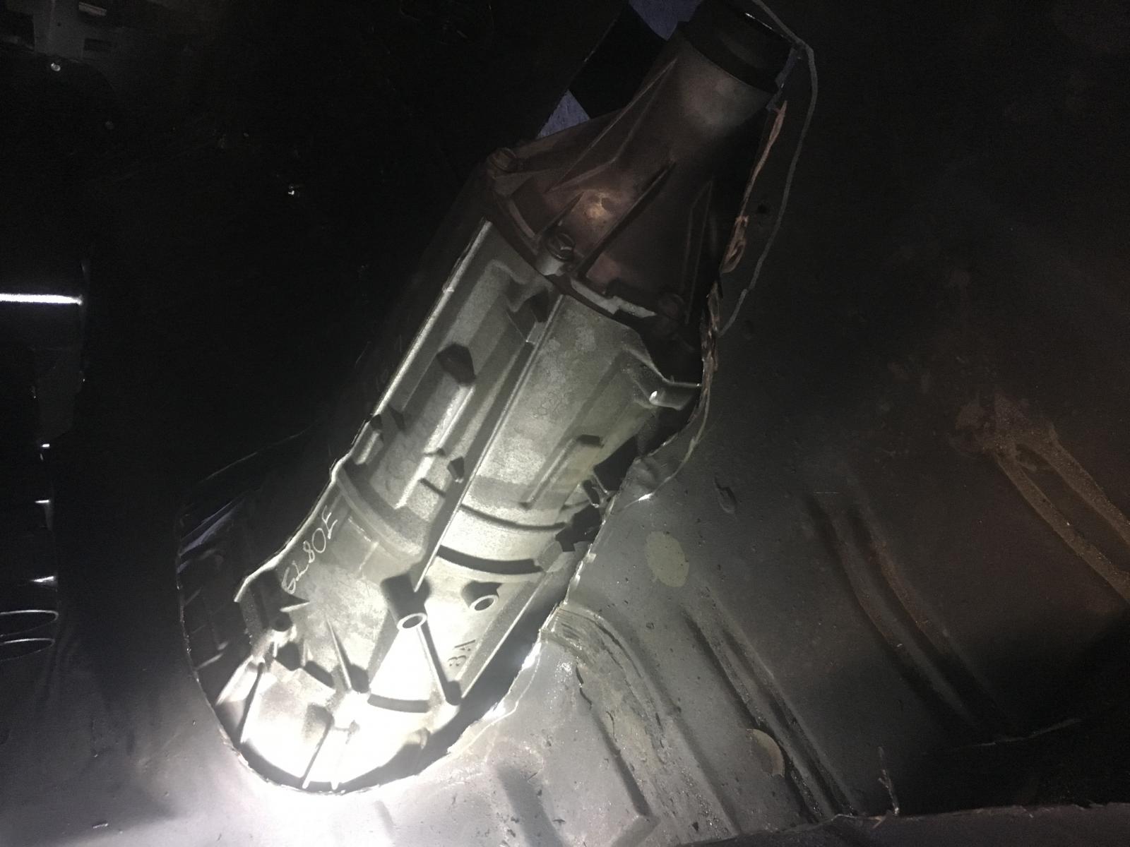

      What engine mounts and trans crossmember did you use.
      Jul 2015
      149
      holley stock location mounts and i had an F body after market trans mount laying around so when we boxed the frame we welded tabs for that. i bough the LS before the 6l80 idea. and i dont want to re buy mounts, but if i did it over i would prob move the engine forward 1in with the dirty dingo or holley mounts.
      Jul 2015
      149

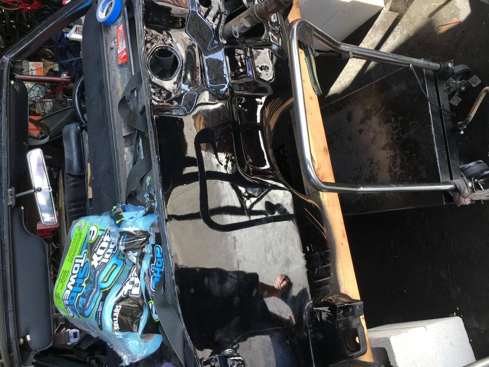

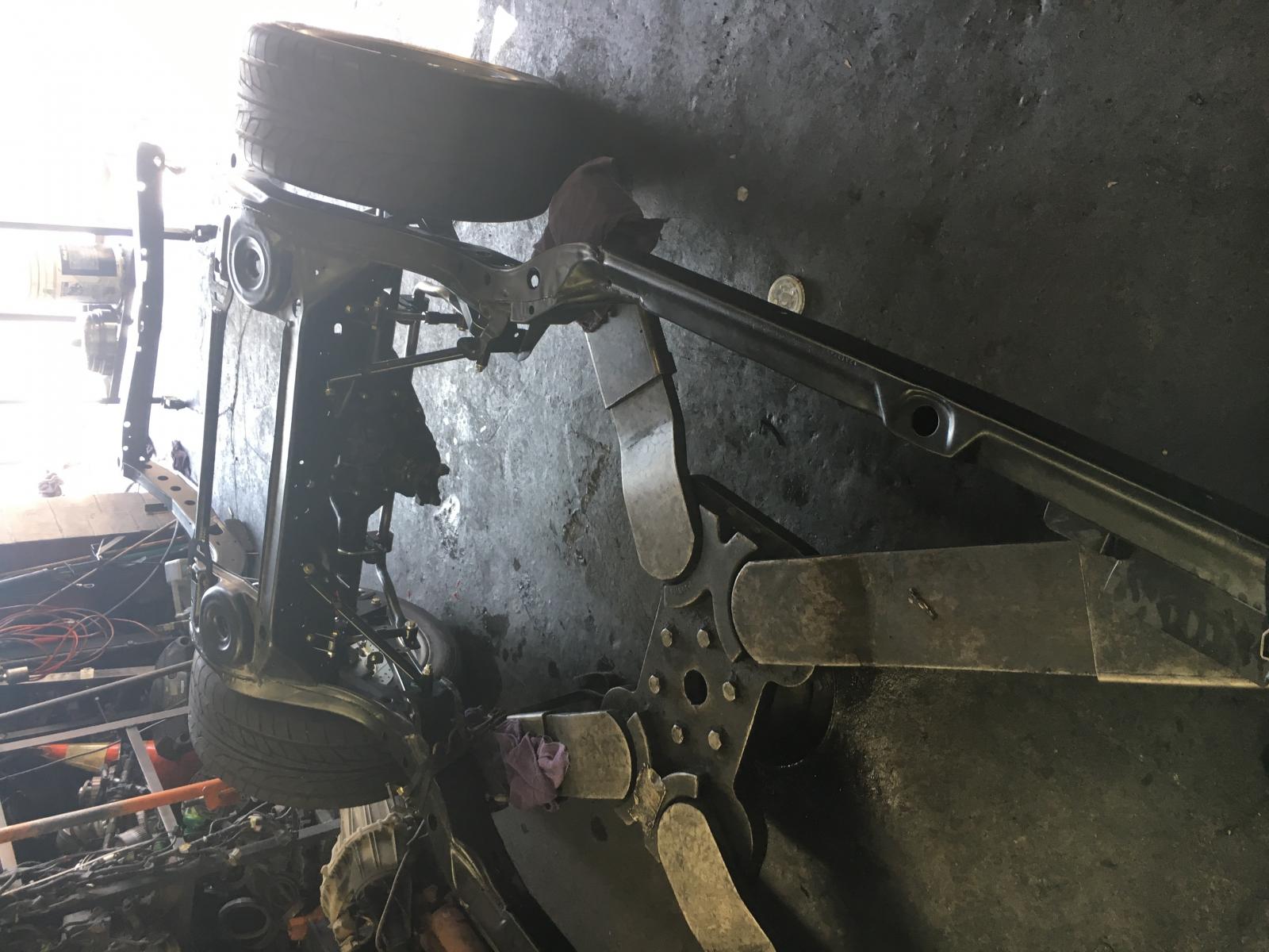

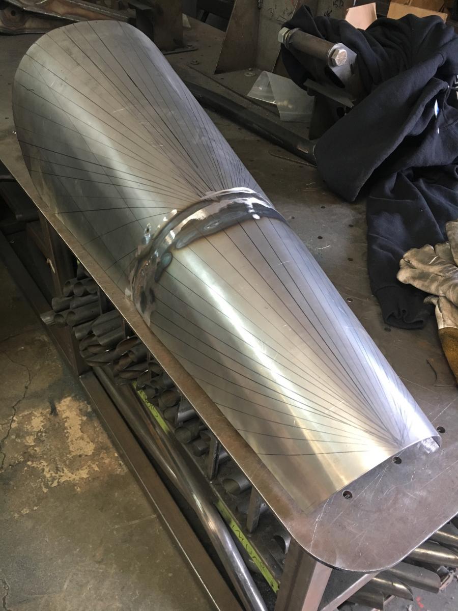

      built trans tunnel today. Name:  IMG_5828.jpg
Size:  131.6 KBName:  IMG_5829.jpg
Size:  114.8 KBName:  IMG_5830.jpg
      5,560
      Nice Project! Looking good.
      Jan 2017
      8

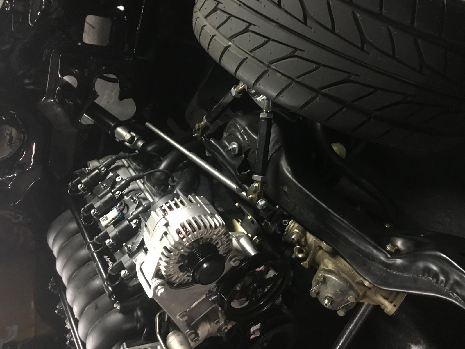

      Even with the dirty dingo or Holley mounts the tunnel has to be cut correct? I'm doing his same trans in my 68, what shifter are you using,sorry for all the questions but I haven't seen anyone else doing this,and I only want to do it once
      Jan 2017
      8
      will you still have to cut the tunnel if you move the engine forward 1"? And what shifter are you using,sorry for all the questions but I'm doing the same set up,
      Jan 2017
      8
      Didn't know it posted twice,lol
      Oct 2016
      Springdale, AR
      9
      Count me as subscribed. I am putting a LS/6L80 into a 68 GTO. Why would you want to move the engine forward with different mounts? My thought is to use the same mounts (Hooker/Holley) in stock location to keep the engine back and improve the weight bias.
      Jul 2015
      149
      i pretty sure i didnt cut my tunnel wrong, but the 6l80 hugs the drivers side more than the passenger. and there is a budge in the casing you have to hook around in the back toward the rear. also the bell housing a bit closer on the drivers side. all this cuts into the area for the gas pedal so im gonna have to build a bracket for it. but i did just find a gear on here and ls1tech who makes the pedal brackets. so by moving the engine forward 1in it looks like you wont have to cut toward the driver as much to make room for the bell housing. one huge thing im learning quick welding in the tunnel is that #1. search ebay for the guy who makes the T56 tunnels because the t56 and the 6l80 are not far off in size. and #2 make sure all the paint/ rubber backing/glue/ etc is grinded/sanded off the entire area. welding this tunnel in and that **** smokes like crazy when it gets hot. even the under coating.
      shifter i have from speartech, its a stock piece from a gto i think.. or cts-v... speartech has been the **** and they are amazing people. they know me by name for all the crazy questions ive asked them....
      Jul 2015
      149
      i dont think moving forward 1 in with an LS engine would change the weight that much.. i see your idea on this but with all the weight your losing out of the front maybe that 1 in might help.... i kept my stock location.
      Jul 2015
      149
      Jan 2017
      8
      Thanks man I'm following you closely, this trans seems like a b@#$% to get in, I'm kinda thinking of the 4l80 and not worry about all this cutting,
      Jul 2015
      149
      Its not that bad, it's just a lot of hacking . I finished up the tunnel today. I ended up making little side skirts to cover the sides and welded them in. Then I went underneath and cut the floor pan material overhangs long ways like strips and hammered them up against the tunnel. Pretty much the same way as the t56 tunnel guys. welded that all in and use the metal infused bondo smooth it out and fill in any cracks. On the top side at the rear of the tunnel, I fiberglassed the rear of tunnel to the floor pan to seal it.. and grinder and flap disc are your friend, also I've never welded before ever but I taught my self on this..... 2 cans of 3m rubberized under coating and boom it's done. There is a Giant transmission and carpet. No one is gonna see your short comings.

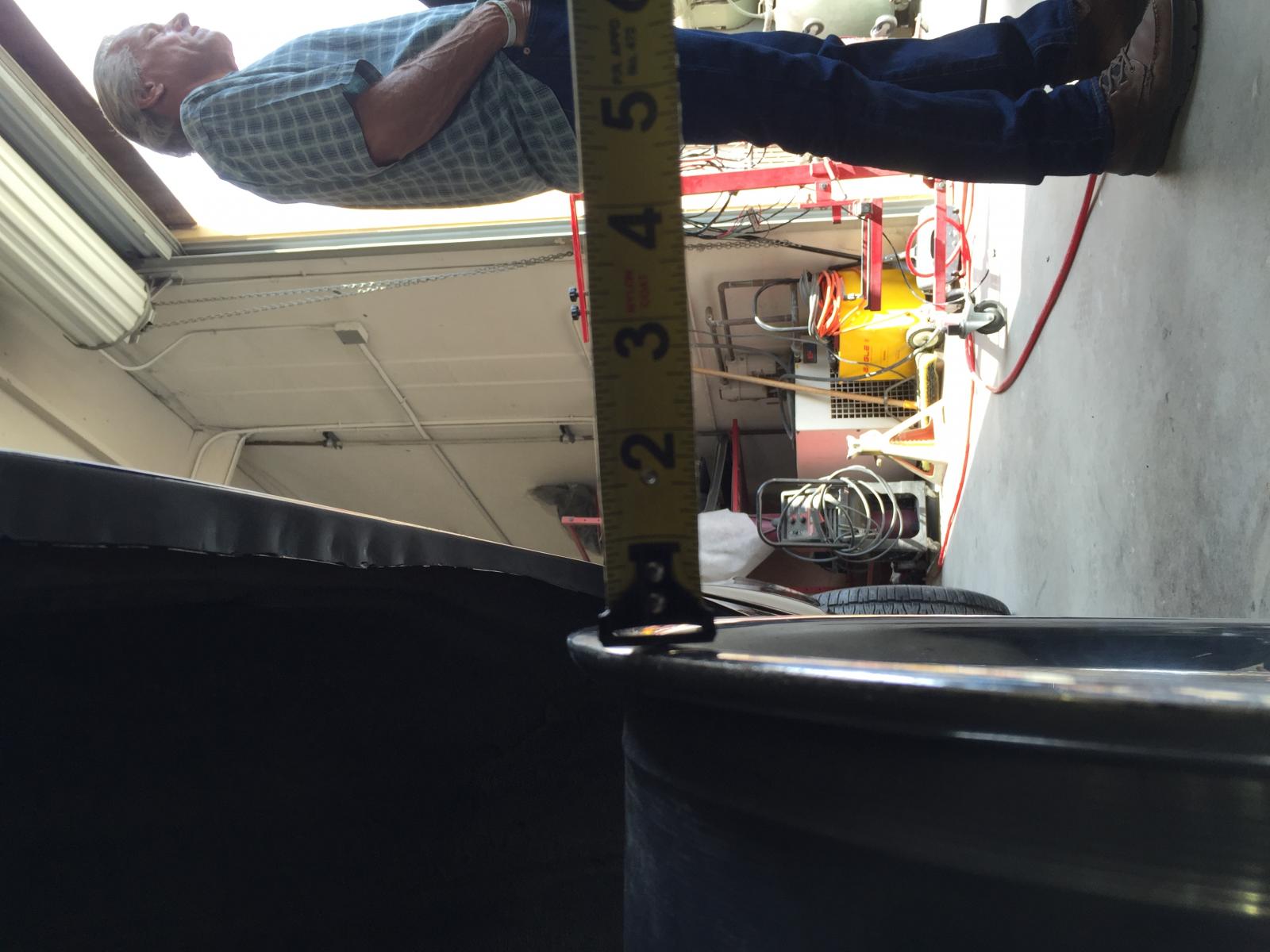

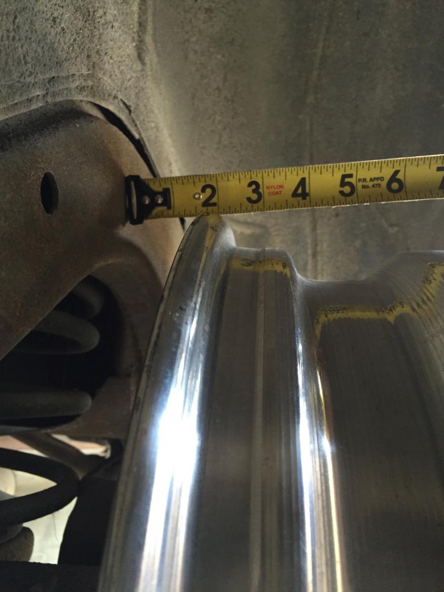

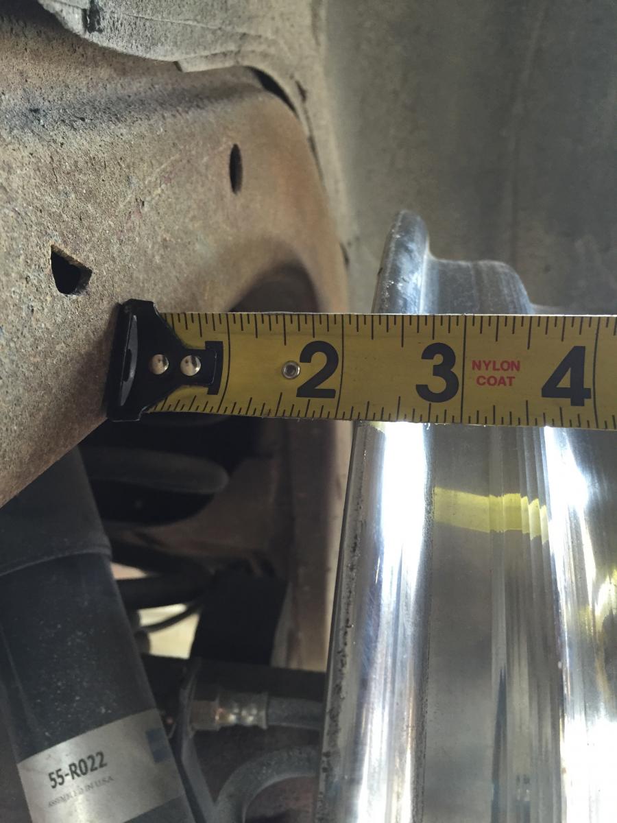

      Great Build, have you ever thought about mini tubbing the rear while you can still get the body on and off??

      Spent so much time measuring the offset I'm fine. Plus I'm tired of welding.
