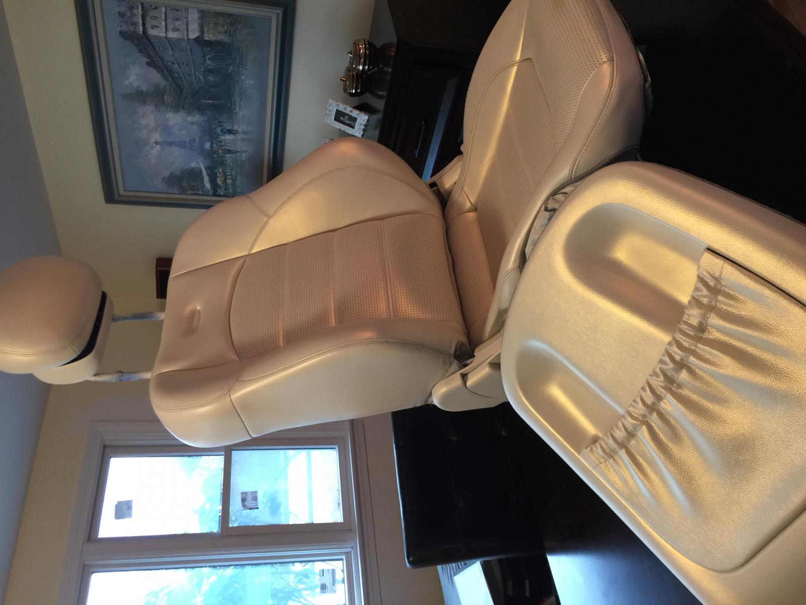

      well, I have to admit, you guys got me thinking and I do want to stay planted in my seat, and access to the rear does make sense. I found a rare set of seats from a Mercedes. And it's from a convertible. Can't wait to mess with them. Not sure if I'll have Jerry recover my existing rear seat or try to stuff these in there. The other thing is they'll be getting sprayed the factory parchment with the gold metallic. I also have the console coming.

      One thing to keep in mind, that I don't think most people think of...
      When installing late model seats with build in seat belts, you MUST significantly strengthen the mounting points for the seats. During an accident a traditional seat is really only holding its own weight in place, and the seat belt mounting points do the much more difficult job of holding the (much heavier) driver in place.
      When you install different seats with built in seat belts, during an accident the four seat mounting points are now tasked with holding the weight of the seat and you in place.

      Great point. I was going to mention it, but unless I don't see it, the seat belts aren't attached to the seat? But yeah, that's what I deal with in my main job, as I design seats for military ground vehicles. The test you're referring to is the FMVSS 207/210 anchorage test. To reach compliance is a difficult task, something the original bolts certainly are not capable of. A typical seat test is a slow pull forward of about 8,000 lbs. Yes, 2X the vehicle weight pulling on the seat... you'd be surprised at what happens to things that "look plenty strong" at that force. 3/8" bolts and heavy plates under the floor at a minimum.

      Wow. That's another good point. Mercedes doesn't use the seat to restrain the occupants. Well, maybe on one side, the other is mounted to the chassis. It seems BMW does seat only? So your consenplating a human/seat misile. BMW Set up looks and retrofits easier but I see how the safety comes into question. I would like to modify the current system some how. I currently have lap belts in a rag top. I found this site on belts upgrades. Not sure how to do it on a convertible. https://www.retrobelt.com/collection...shoulder-belts https://www.retrobelt.com/collection...69+pontiac+gto
      Here's another good one http://www.wescoperformance.com/i-32...e-install.html

      I'd read that some Mercs route power seat functions through the bcm, might be worth double checking.
      The floor brace part of the conversation won't be as important with those seats since they don't have the seatbelt built in. I was thinking about trying to work those extender arms into the shoulder belts in my back seat. Pretty cool.

      You are correct on some years/ models. My first selection with the switches mounted to the seats out of. 2011 worked easy with a jump- all functions. I have a video with the testing.
      The new selection is out of a 2008 And does involve the can system- with some low voltage switching- however, the seat motors are all the same, there fore, if you were to wire a 1995 seat switch and override the module under the seat... Your good to go. Now it's a bit more work but the resale of 2 good seat modules with memory and the 2 low voltage switches should more than fund the operation. In fact ... A few dollars may land in my pocket (well not really). But should pay for the retro fit Lol
      If it's DPDT switching I'll need to experiment a bit. This is the fun part as long as I don't fry something

      I dicked around with the seat control module for about 10 minutes. Ripped it out in about 5 minutes. Ran the seat function with jumpers and works like a charm. Very basic DPDT switching. I'm amped!!
      Did a little more research and.......my heated seat are nice and toasty hot.
