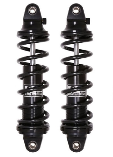

      love these from Aldan American - black Regulator Series, single adjustable, made in USA
