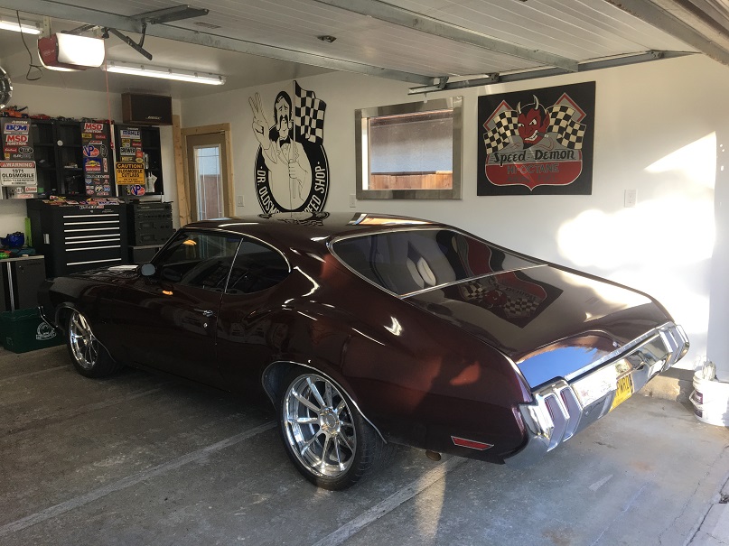

      So after the better part of 2 years or saving/ordering/waiting (repeat) I finally got a major suspension/brake/wheel done on my car. The motor and trans was done about 4 years ago and I had the motor build on here at some point but it seems to have been deleted. Anyway its a 488.
      I dealt with Mark from SC&C on all the parts minus the torque converter. Mark was beyond helpful and great to deal with so big shout out to SC&C.
      I've owned the car for about 5 years now and have been driving it less and less since the motor got done because I felt unsafe driving me and my family around in it... The car just has way to much power for the suspension and brakes to handle. So after countless hours talking to and emailing SC&C and a mountain of money later heres what I ended up with... I also realize this isn't eveyones cup of tea but its exactly what I wanted in terms of handling... SO BE NICE!
      Heres a list of goodies that went into it. I won't bother listing everything in the suspension kit:
      Oh yeah, and before anyone picks it out, yes, its a 70 bumper on a 71... Previous owner did it and its grown on me for now.
      Coan torque converter

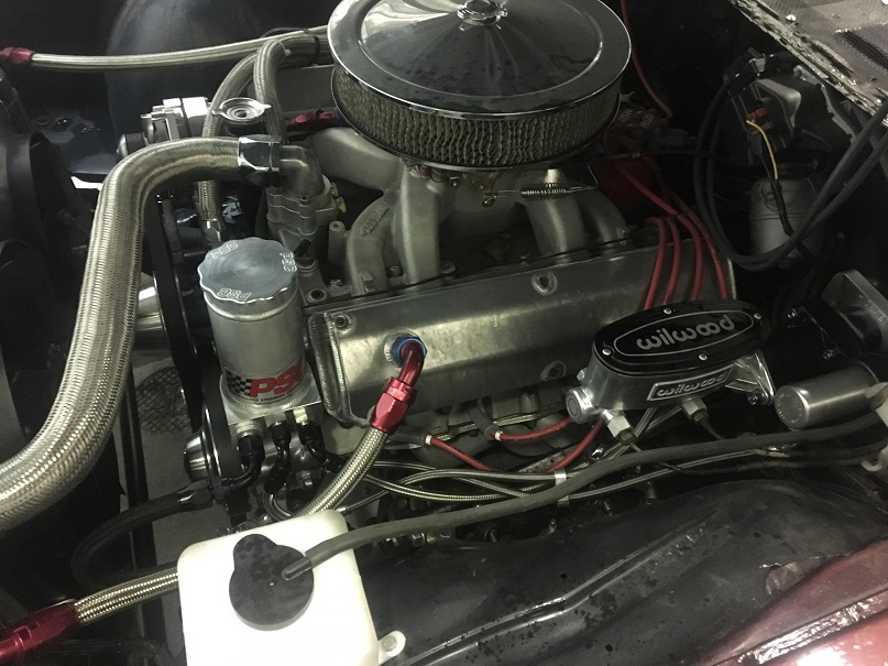

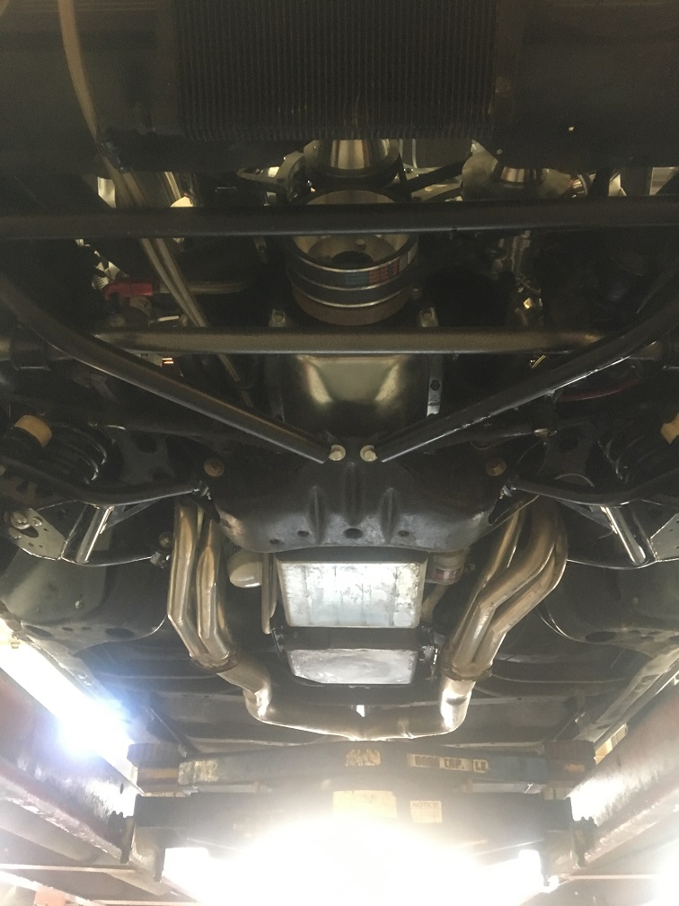

      And I think thats about it... The car still has a long road ahead of it in terms of looks (it needs work) but aside from headers that actually fit and a fuel system upgrade I can check "mechanical" off the list of things to do.

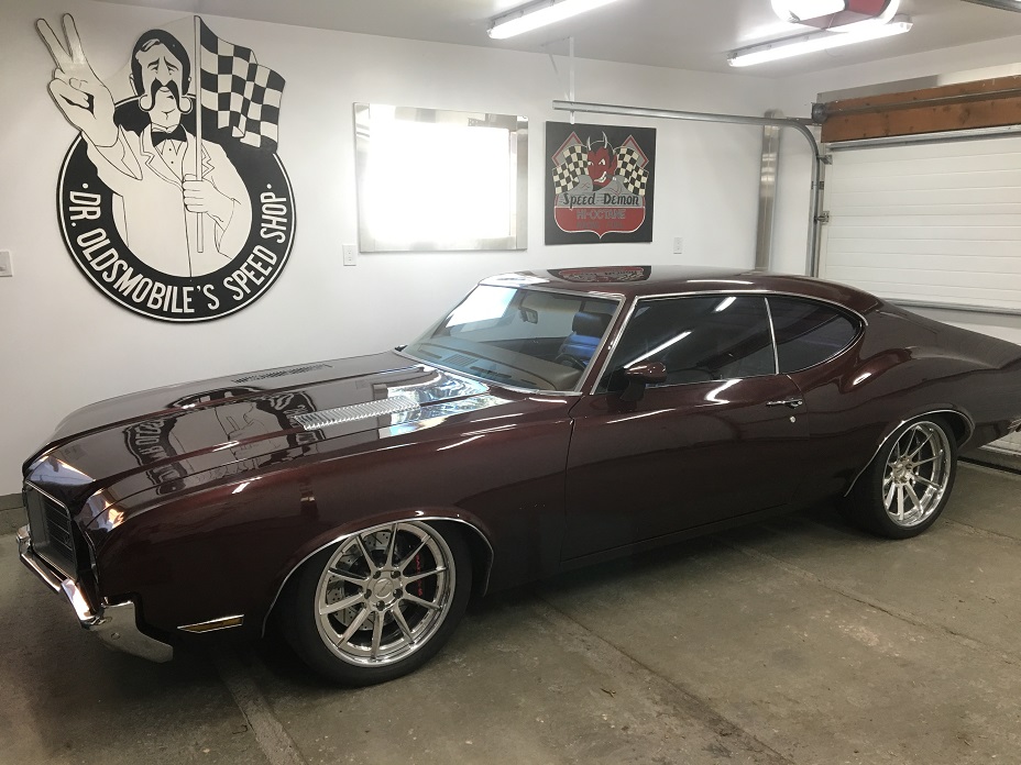

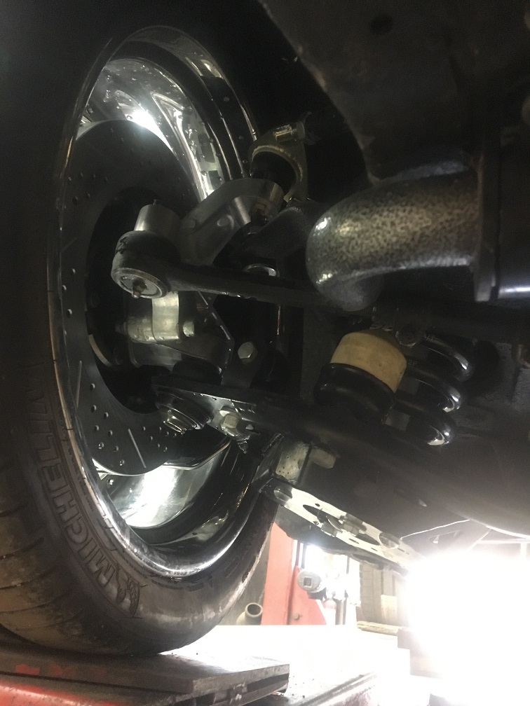

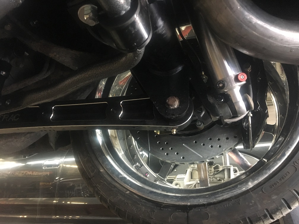

      Heres some before and afters... I took some pics of the suspension while it was on the hoist but they didn't turn out so good.

      very nice I like the plain jain looks of the car vs a 442 clone or some kind of crazy paint.

      Drooling over the car and paint color, love it. Great choice of wheels and upgrades as well

      Quote Originally Posted by Monte_ExpreSS View Post
      Thanks...I'm actually not crazy about the color, the previous owner painted it and although its been growing on me over the past 5 years but I still don't think it would be my first color choice when it gets painted again...eventually.

      I was originally looking at a 17/18 or 18/19 combo as I thought the 19/20 would look to tunerish but Forgeline suggested no smaller than a 19 for the size of rotors/calipers I have. I was also pleasantly surprised with how well they look on the car.

      Quote Originally Posted by csouth View Post
      18's will fit with 14" rotors, I have c6 Z06 brakes on my car which is a 14" rotor of front. .... Once again, very clean....
      I think it was because of the rolled lip on the inner part of the rim. It was a rim specific recommendation. They didn't guarantee it wouldn't fit but they wouldn't guarantee it would either. In the end I was glad I took their advice.

      Quote Originally Posted by alocker View Post
      Very nice Olds. How do you like the Turn One steering box?
      I had someone else ask the same question... Its hard for me to tell what the steering box alone did for the car since the car went from completely stock suspension/steering to all new. I can say in general the steering is now very tight and firm, rack and pinion like. The guy from the shop test drove it and said it felt similar to a Corvette. I've never driven one so I cant agree or disagree. The best comparison I can give it is it feels like a go-cart. lol
