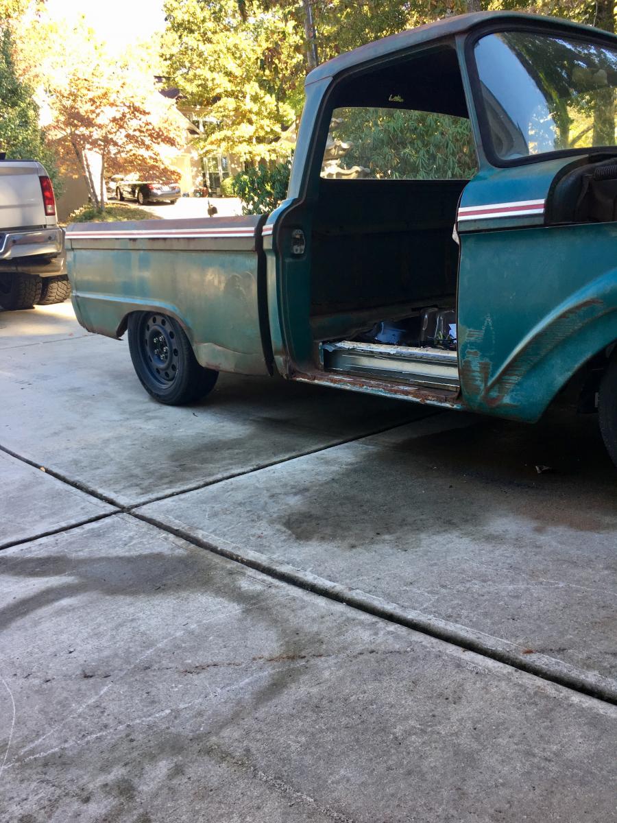

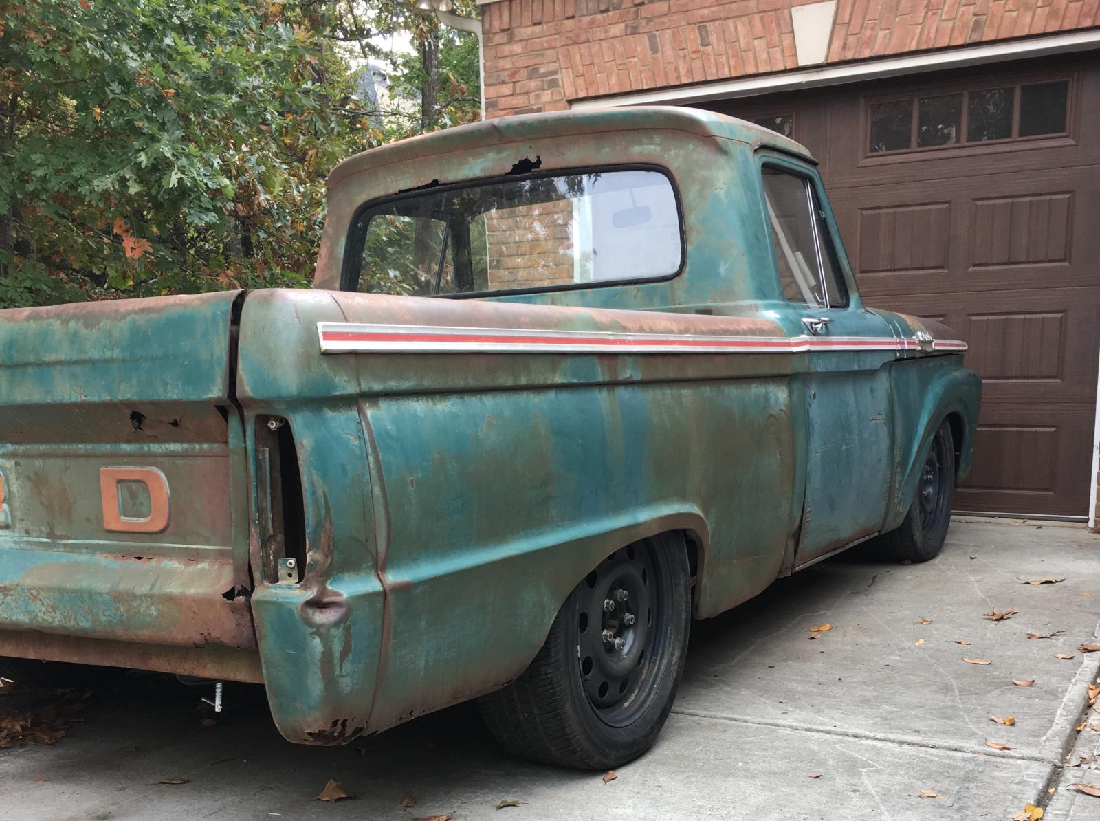

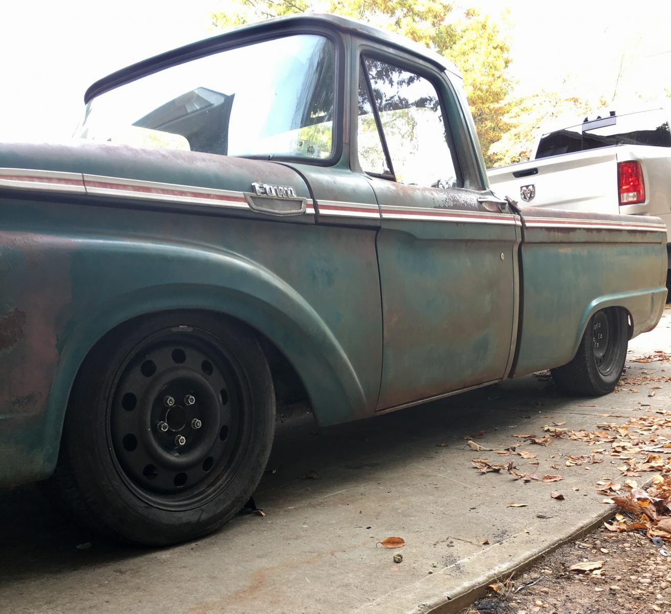

      It's been fun so far! I'm looking forward to ripping this thing around that's for sure! Just out of curiosity do you have any up close pictures of the firewall alignment with one another and the gap between the Vic floor and the truck step? Also any pictures and measurements of fender spacing on the front? I've run into some issues with squaring everything up properly due to both the Vic and the F100 were in accidents.

      When doing my buddies 66 f100 We set the ride height, by lowering the cab until we got the ride height desired. It looks like you are at about the same height. We used a digital level and made sure the crown vic floor was level was level with the trucks flat portion at the bottom of the doorjamb.
      You will need to unbolt the core support from the frame and remount it about 1-1/2 inches closer to the engine (there is room). Even when you do this the A/C condenser ends up right next to the grille.
      I'd measure for you, but he sold it.
Size:  187.1 KBName:  IMG_1239.jpg
      Oct 2016
      Woodstock, GA
      11
      I appreciate it! I've made some more progress over the last couple of days. I've enjoyed the problem solving part of this build. Looking forward to driving it as soon as possible!

      Looking great!
      Stance is awesome.

      Looks great!! You are moving fast!!
      You will need to finesse your front fenders out in order to drive....if you want to turn, but that's the beauty of having a patina truck!
      Be really careful to keep everything level. We saw another guy with a 66 f100 on a crown vic. The back of the cab was low and so was the front of the bed. it ended up looking V shaped, and the side trim really amplified it.
      Keep up the awesome work!!

      Thank you! I'm a Firefighter/EMT and have a decent amount of time off so that's helping move this along. Everything is just tacked in place right now in order for me to ensure everything was straight since both vehicles were in accidents. I've still got some tweaking to do on everything before I'm happy with it. As far as fender flaring goes I'm holding off on that until I get my wheels and possibly a new rear axle or narrow this one. Thank you for all the advice and compliments!
