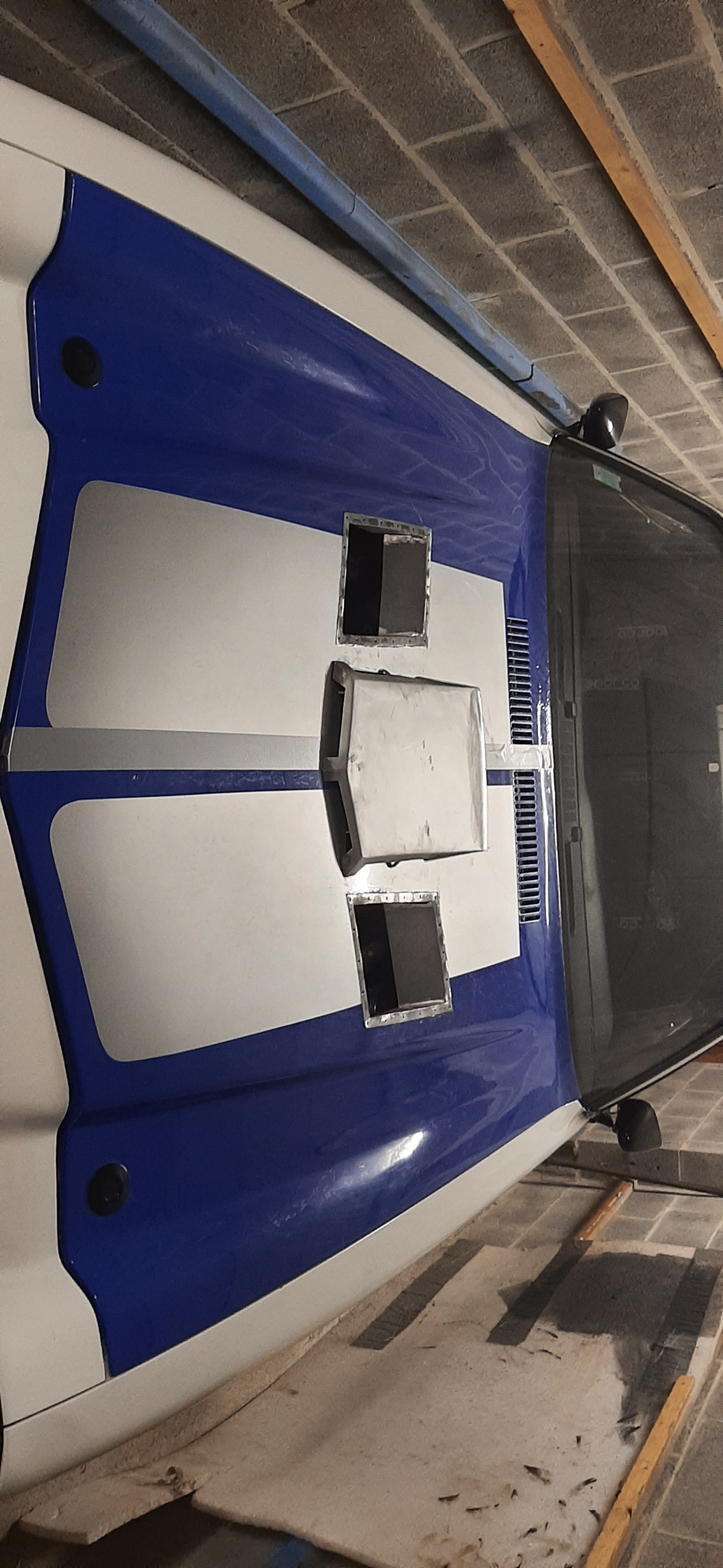

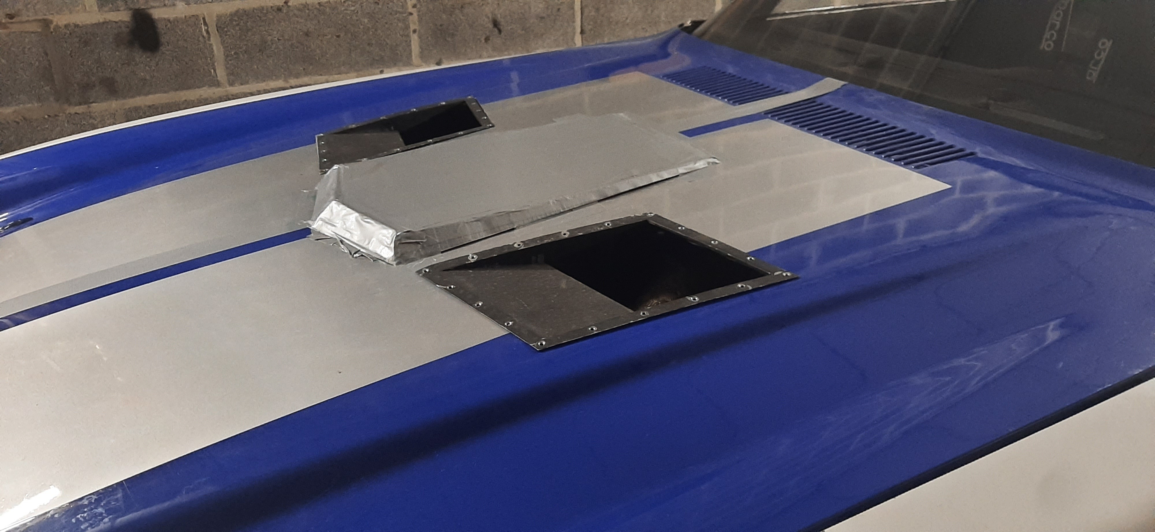

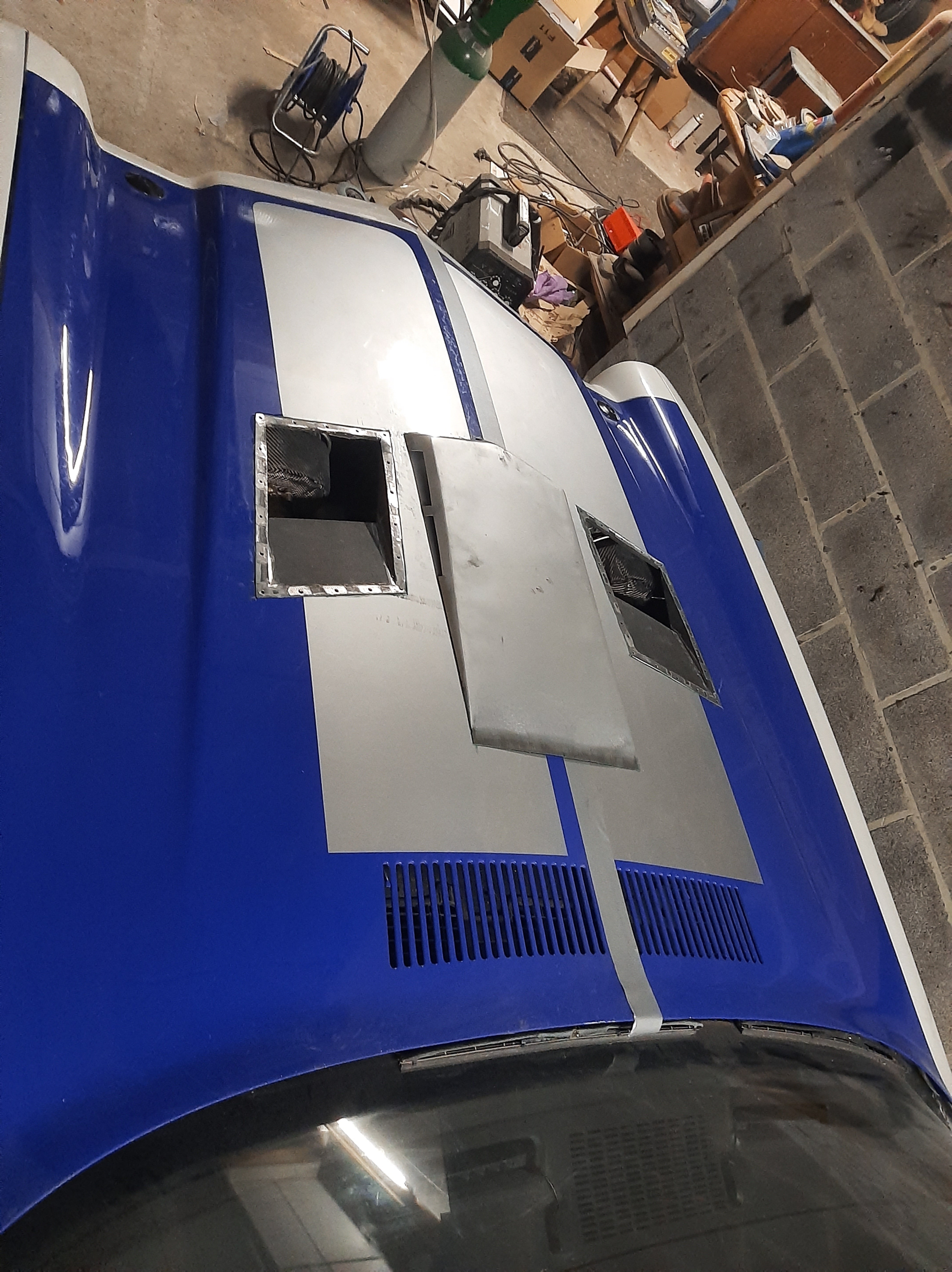

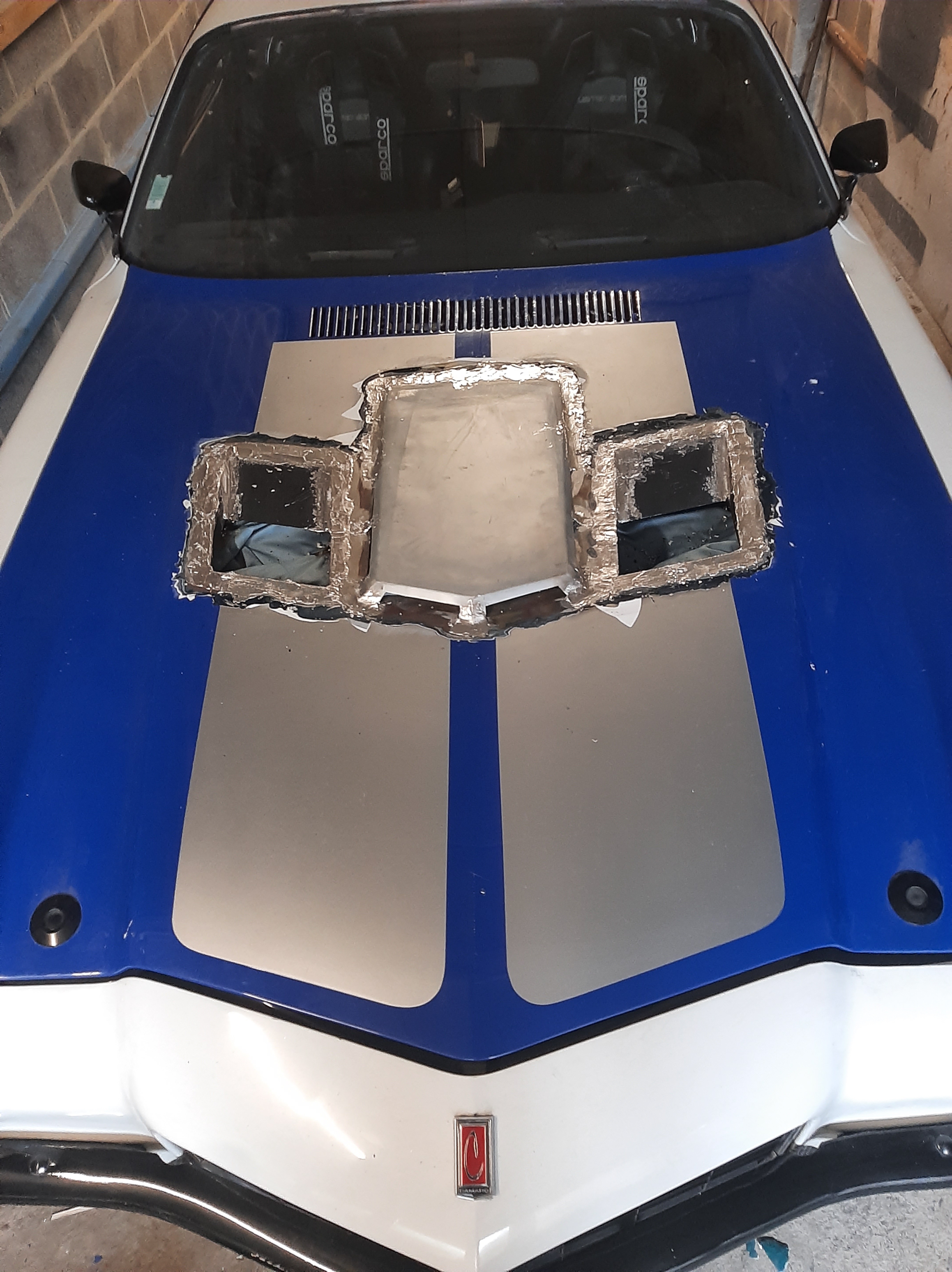

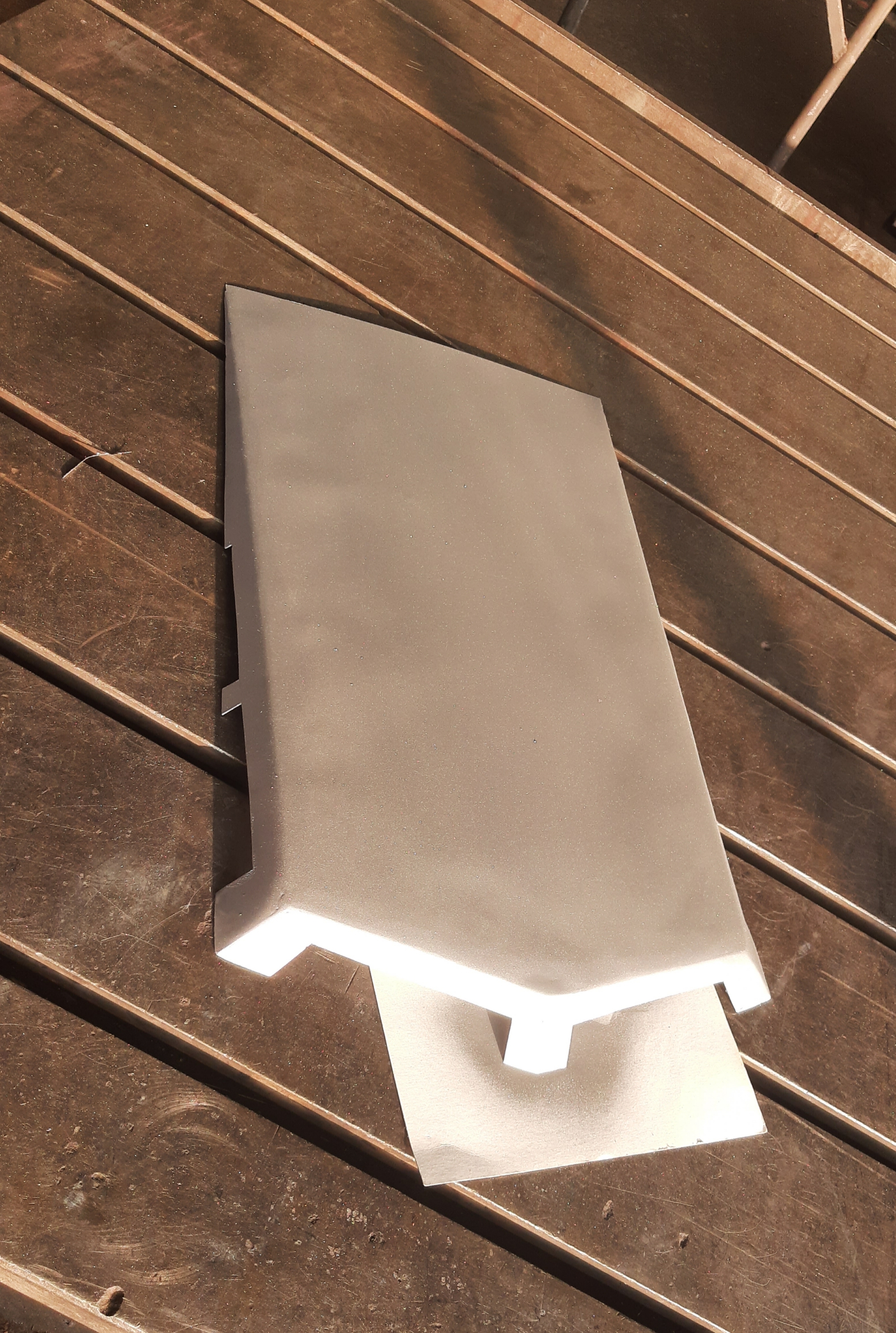

      Hood scoop build to hide and cool the bank's box, colder air in the intake is always better !

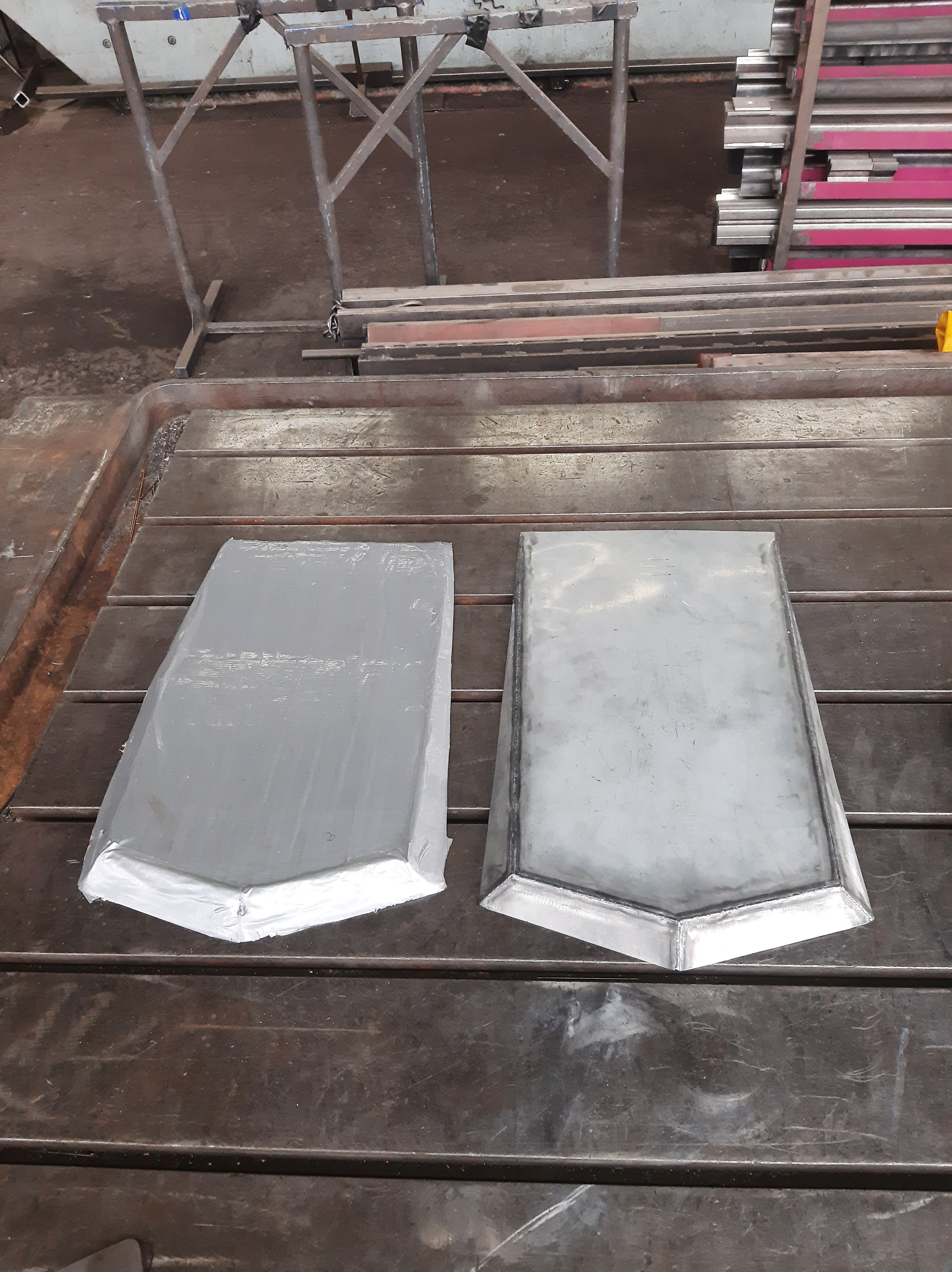

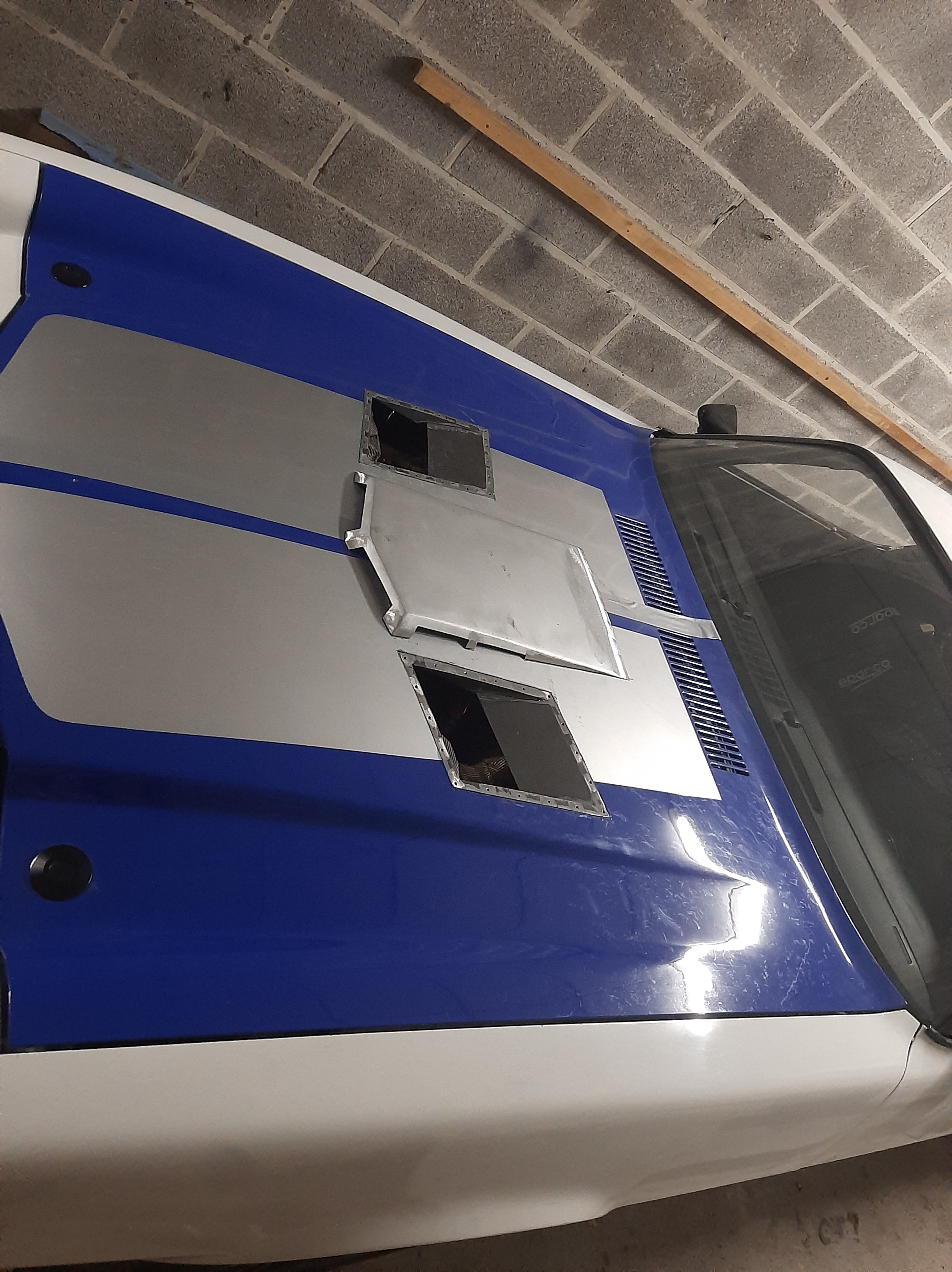

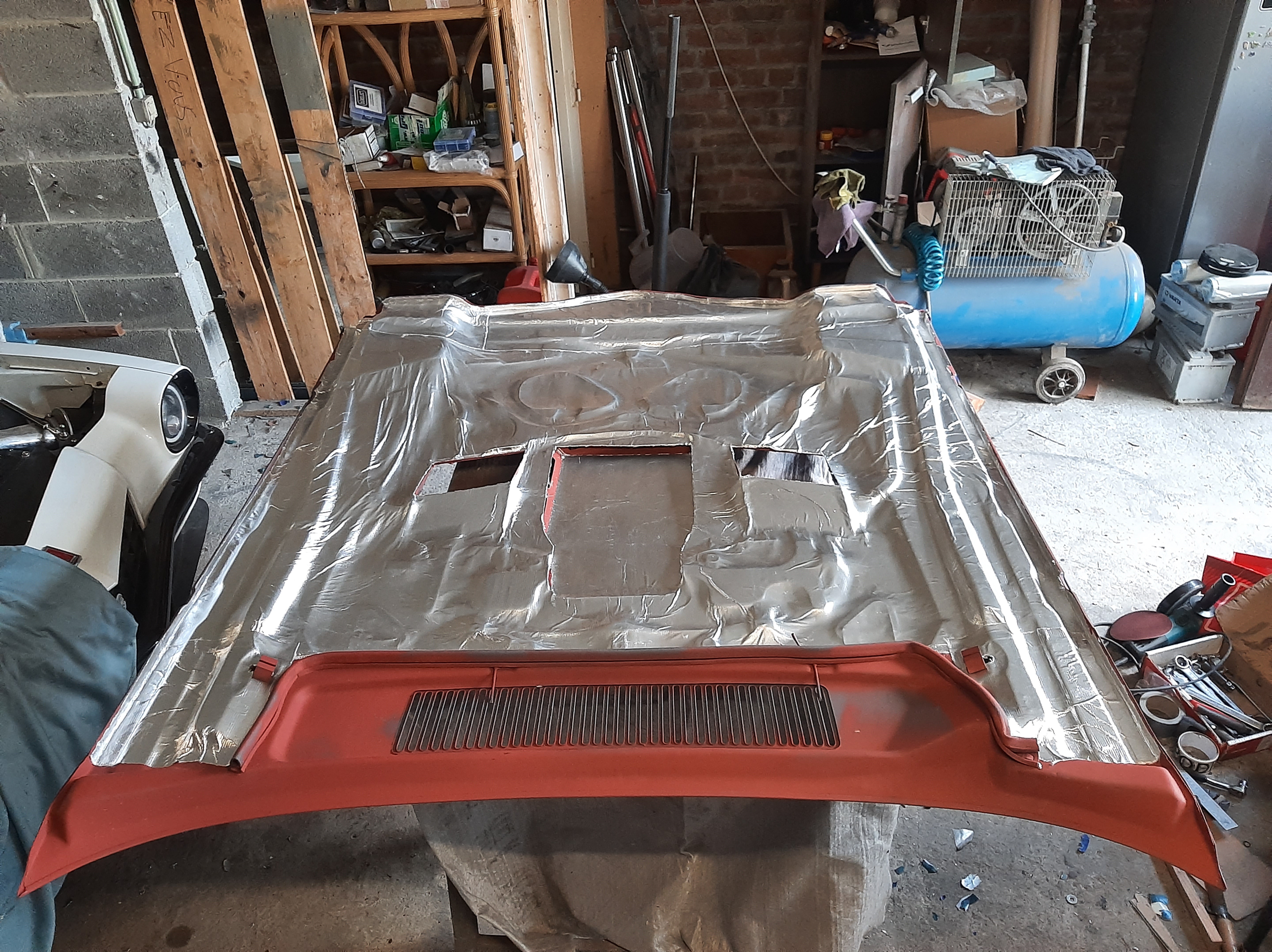

      Welded and tin coated, next step will be for the painter

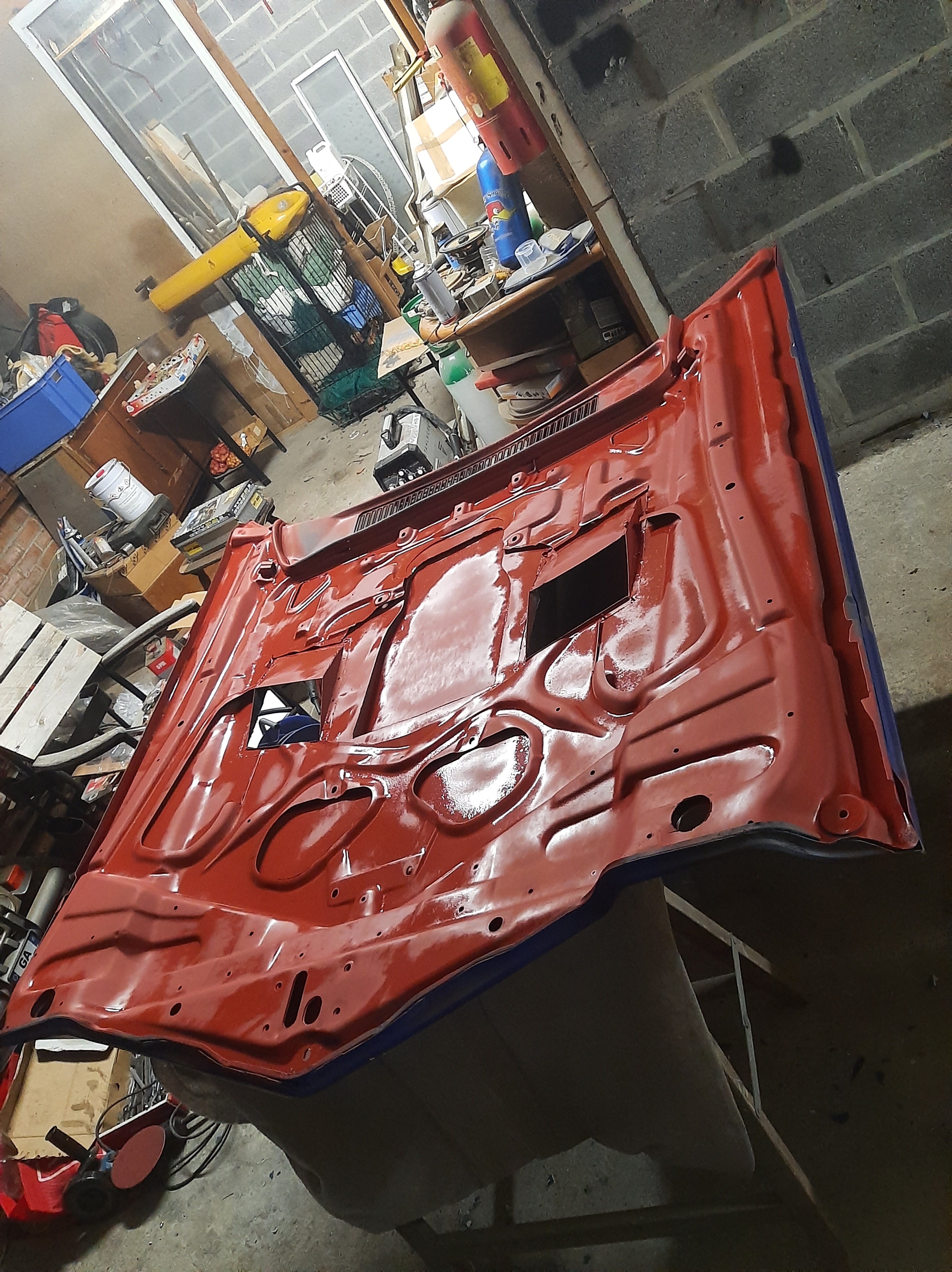

      2 coats of anti-rust primer before applying a thermal protection

      Are you working with metal filler?
    17. #597
      Oct 2016
      586
      I ve used 60/40 tin Lead bar like I used several years ago to repair all mastic **** that was done by the previous owner
      And tig welded the loover and vents
    18. #598
      Feb 2013
      South Carolina
      935
      The only reason I ask is because it is uncommon to see these days. Very nice work.
    19. #599
      Oct 2016
      586
      Thx a lot !
      I don't like mastic it does not hold in time, tin is lifetime warranty !

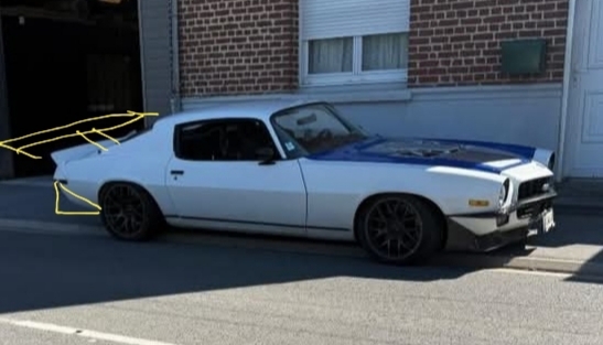

      Looks killer with a 65 inch rear spoiler and diffuser ...
