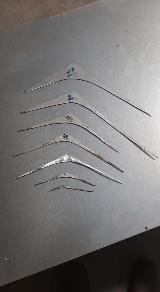

      Let the Z-tune fenders project begin !

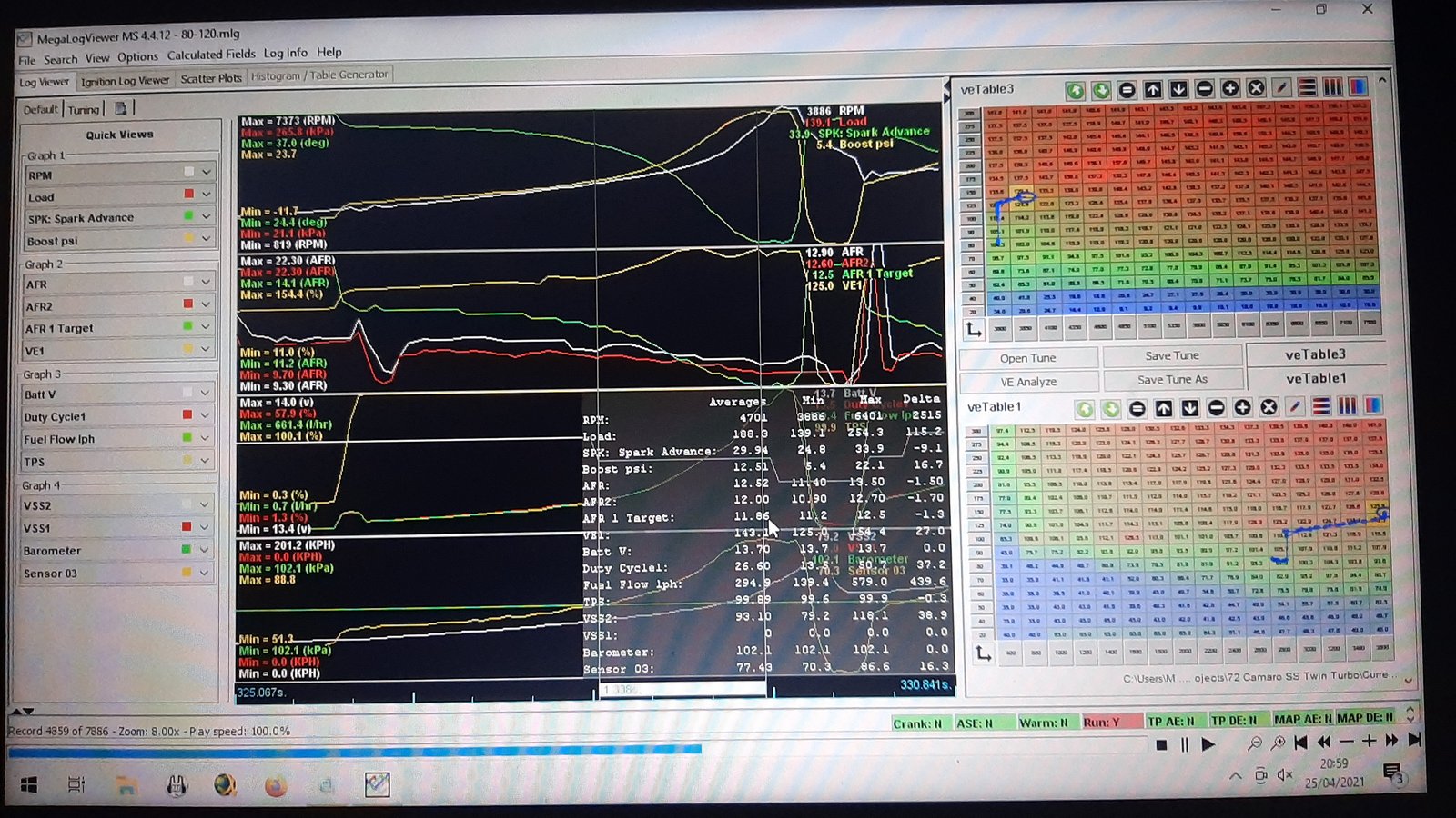

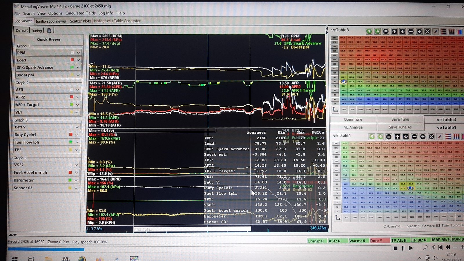

      Hello everyone, some news yesterday 1st test of closed loop boost control, this is only the beginning, there will be changes in the tables. As a reminder, my goal is to control the boost compared to engaged gear to have a certain amount and avoid tire slipping. And it works! In 2nd gear at 19psi of boost it slowly starts to lose traction. For the moment it is the simplest way in closed loop control. As soon as I reached the max 30psi boost, I could only tweak it using the advanced method with the PID control. On the 80-180 kph curve in 5.5s (too slow and I will explain why later) we see the green curve at the bottom for the boost and the red curve for the gear engaged. If you look closely at 2nd gear the boost oscillates while in 3rd gear it is quite flat as soon as it reaches 24 psi cause it has not reached the max target of 300kpa It is because it tries to keep the limit of 19 psi but it exceeds then it goes down again ... etc this is where the PID comes in, the Proportional gain will make it possible to reach the target faster, the Derivative gain will make it possible not to exceed the target and the Integral gain will prevent it from oscillating. About the 80-180kph in 5.5s, the 2 curves next to it are the shift time of 0.6s and the time between the moment I let go of the throttle pedal at 151.9kph and the moment when in 3rd I go back to this same speed, loss of 20kph and more than 2s which is enormous! It is possible to reduce this time with the flatshift function and the top would be a sequential transmission where the loss of time when changing gear and in kph is minimal. By removing this loss of more than 2s, that makes an 80-180 in 3.4s, as fast as a 1200hp bugatti veyron super sport
      Last pict a 80-120kph 1,335s.

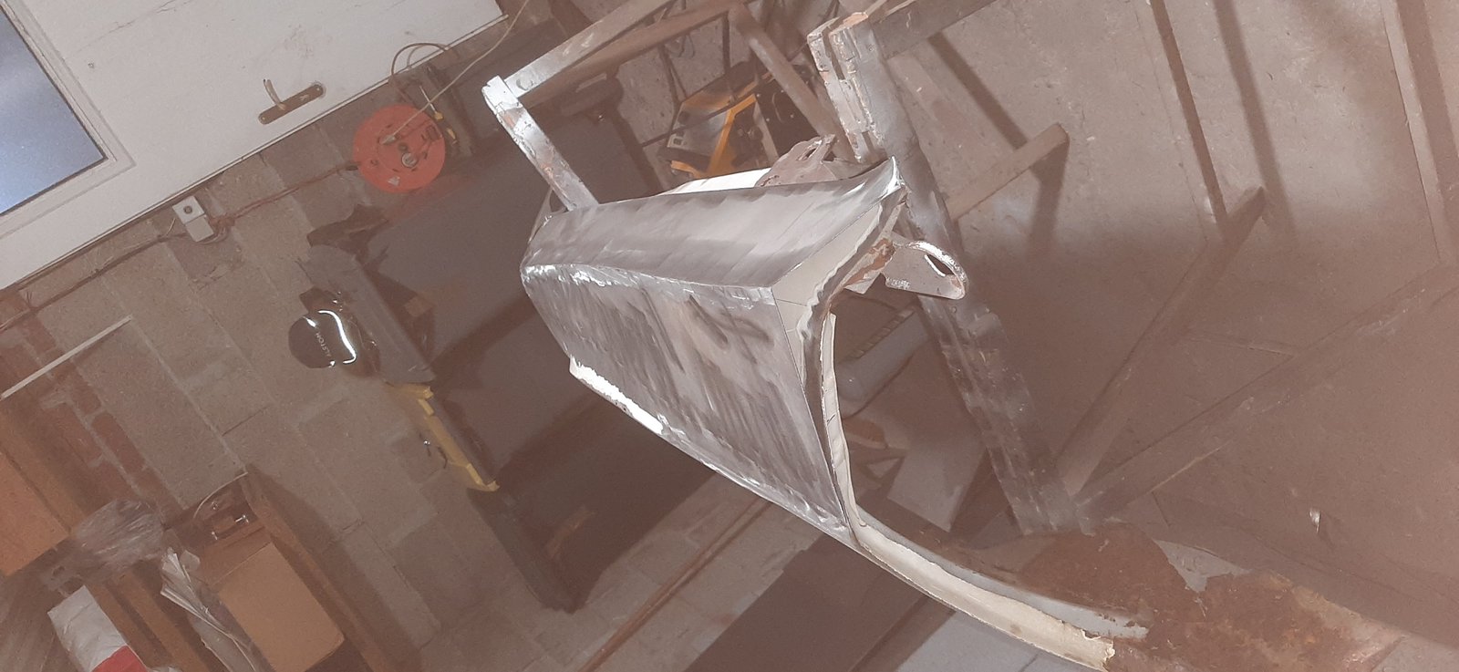

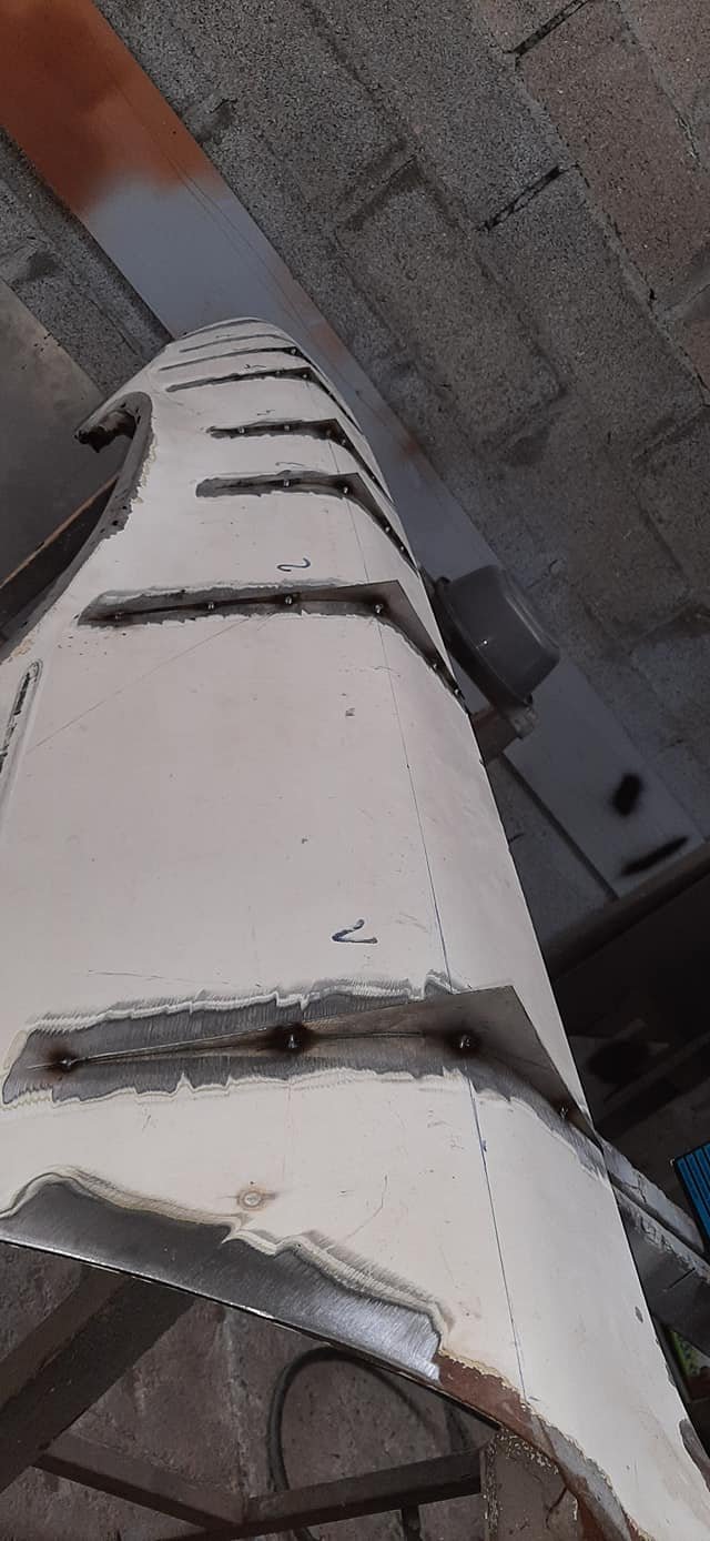

      z-tune fenders project in progress

      Delighted to see a completely different approach to a project! And great photos, it certainly makes one want to drive that unit hard, very, very hard.
    20. #440
      Oct 2016
      586
      Thx a lot, just 2 things to adjust and I ll make the swap to see how it looks
