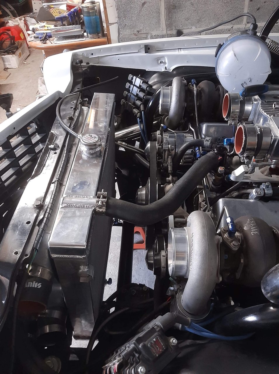

      I've just seen a Frostbite radiator that looks good but bigger than a 70-81 camaro radiator, just need to modify the raditor support bracket and a 4600cfm flex-a-lite dual fan
    9. #369
      Oct 2016
      586
      rocker arm received, lunati vs howard....howard wins ! lol
      about the radiator, the Frostbite I've seen earlier is too wide then I've found a Champion Monster 4 row that is able to adle 1200hp+, I need to check if the height is good, by modifying the radiator support, I could probably fit the following one if I can close the hood without tootching the cap.

      and a Champion monster core 4 row downflow radiator build to fit 74 dodge charger but for my setup it will fit perfectly, better than 70-81 camaro. To install it I will modify the radiator support, cut the bottom to insert the new radiator cause it's deeper than a camaro radiator and create an air duct directly to the radiator without loosing ground clearance
    13. #373
      Oct 2016
      586
      finally installed the new 4 row radiator, needed to modify the outlet cause it was just in front of the sway bar. installed some Speedtech Performance stickers and new Howard rocker arms, awaiting for a pair fo new stud girdles from the same brand.
