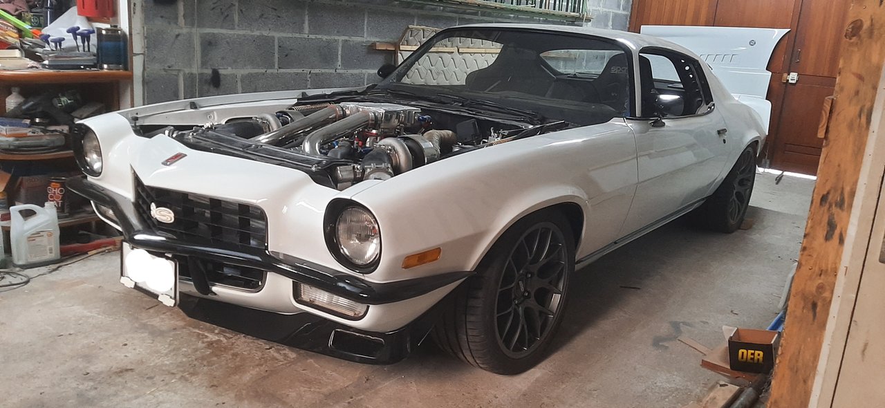

      back on the road soon !
    15. #355
      Oct 2016
      586
      Oil pan ok hope there will have no leaks anymore.
      The big question now is : do I need stripes ? I think yes on the hood but on the front fenders and doors I don't know
      Any suggestions ?

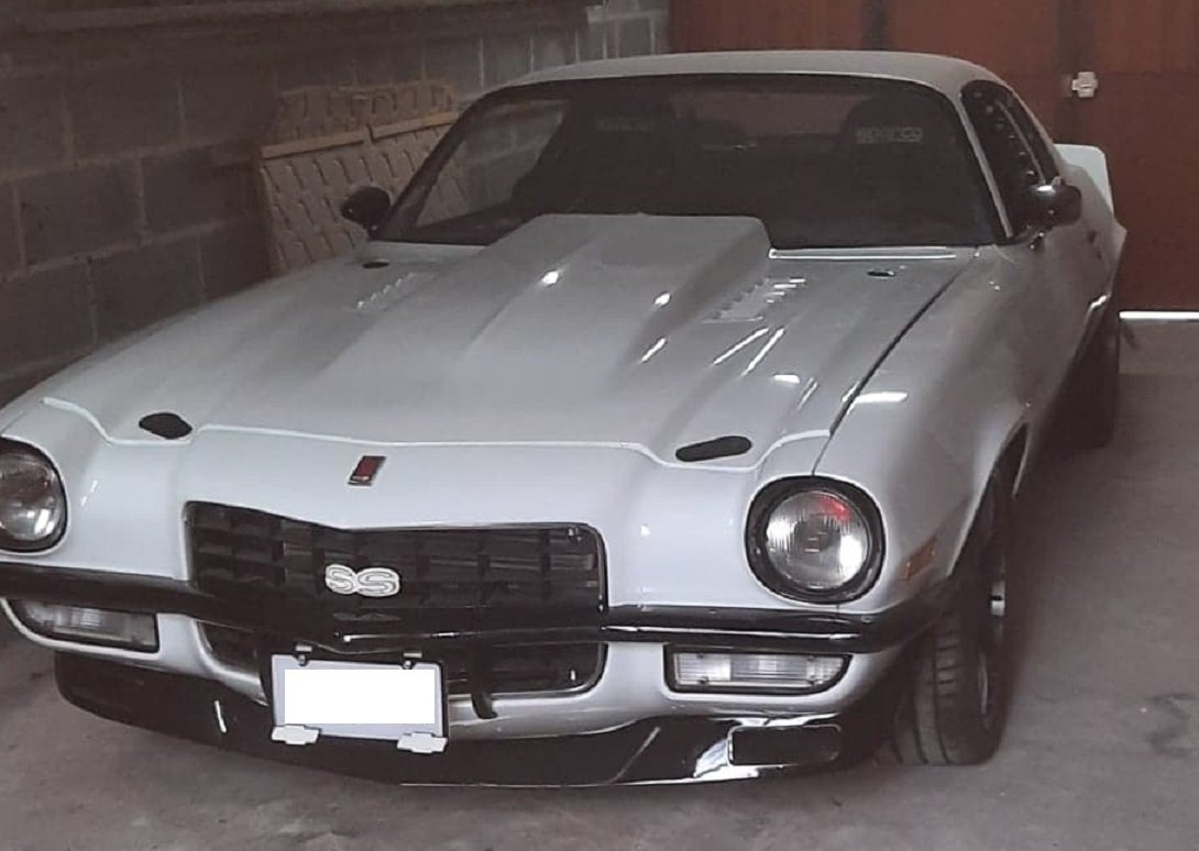

      About the stripes as shown bellow on the rendering, I don't know....
      I like the Speedtech Performance sticker too....on the rear fender
