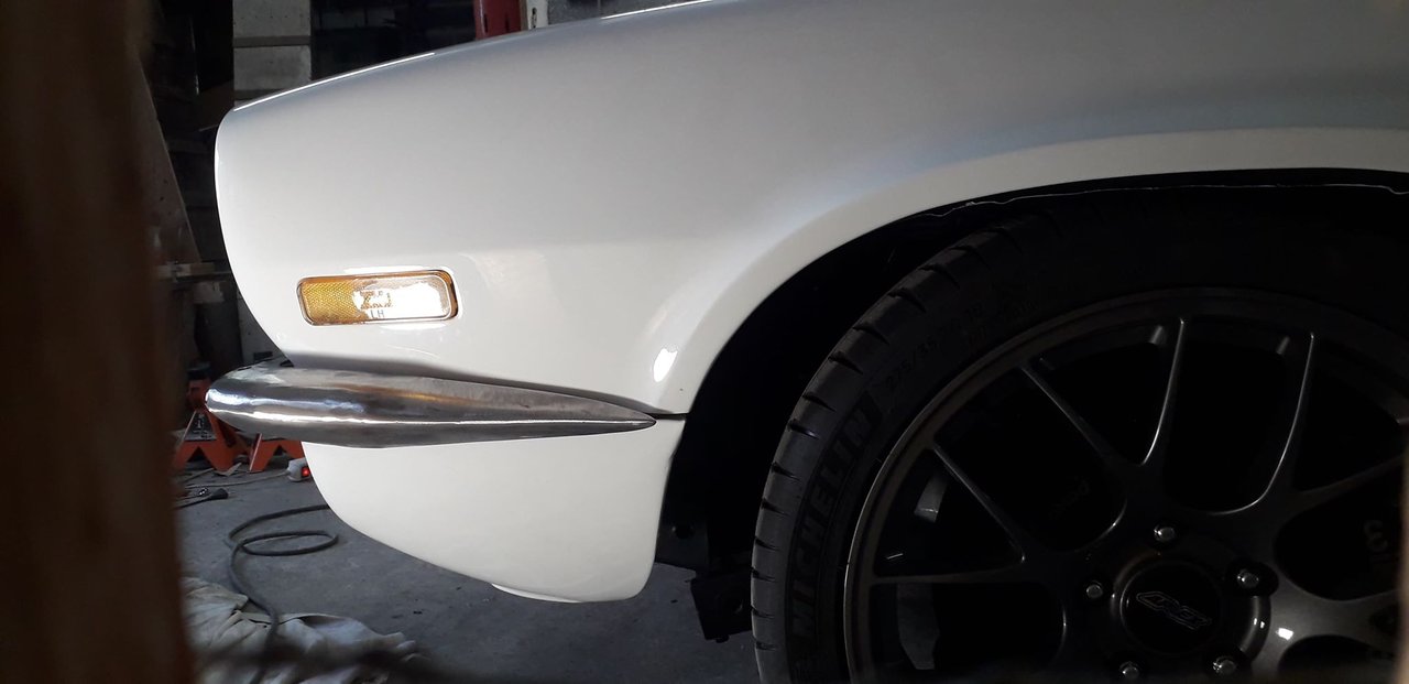

      original power window wiring boots not avaible anywhere so I've replaced it by a rack and pinion boot, it works.

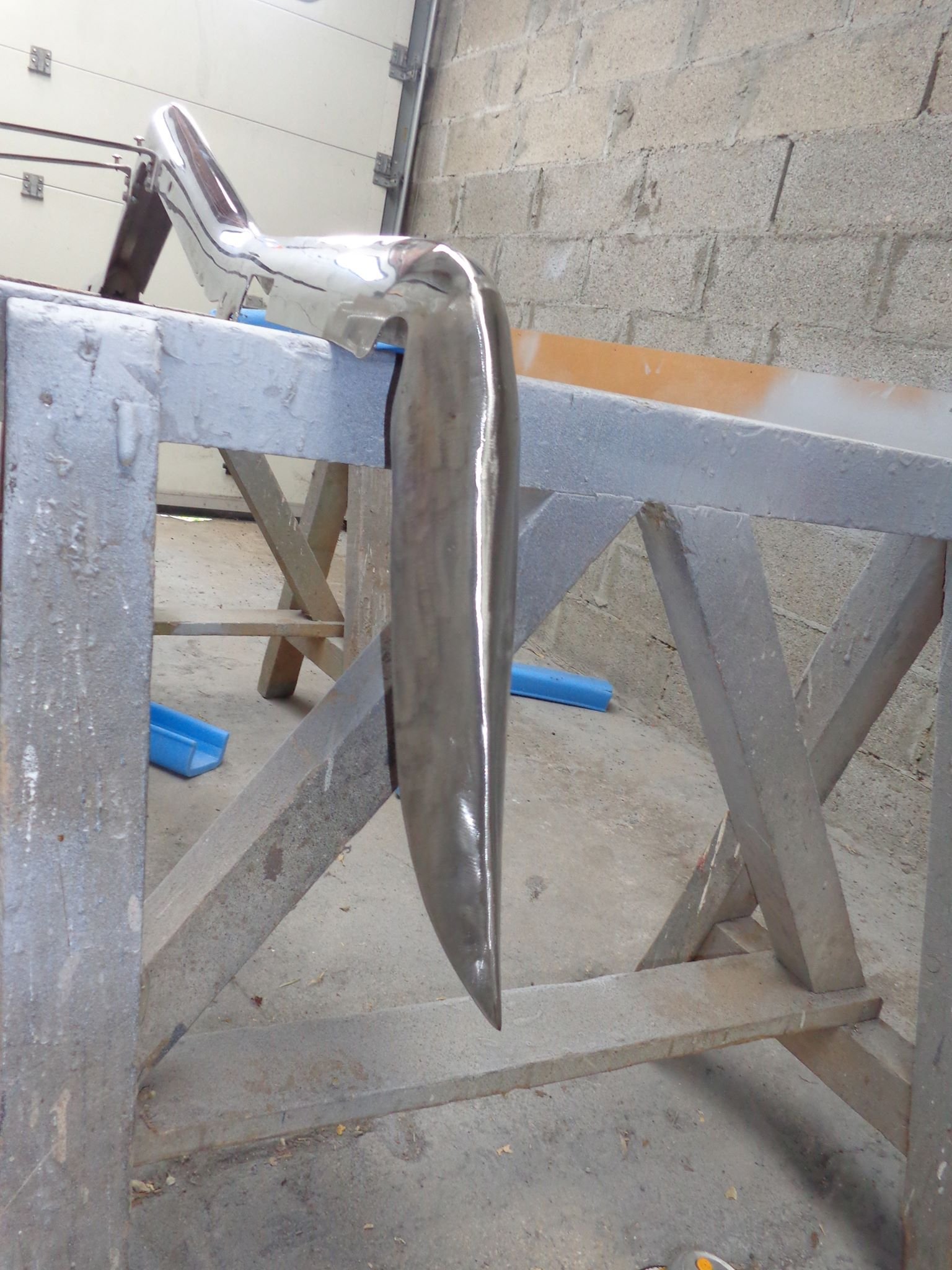

      I love the anvil auto front RS bumperettes so I'm trying to modify the front bumper to look more agressive and cool ! it's a try for the moment, if I don't like it after painting it black maybe I'll modify it again later

      I'll modify the bumper again I don't like the way it looks below even far from the car

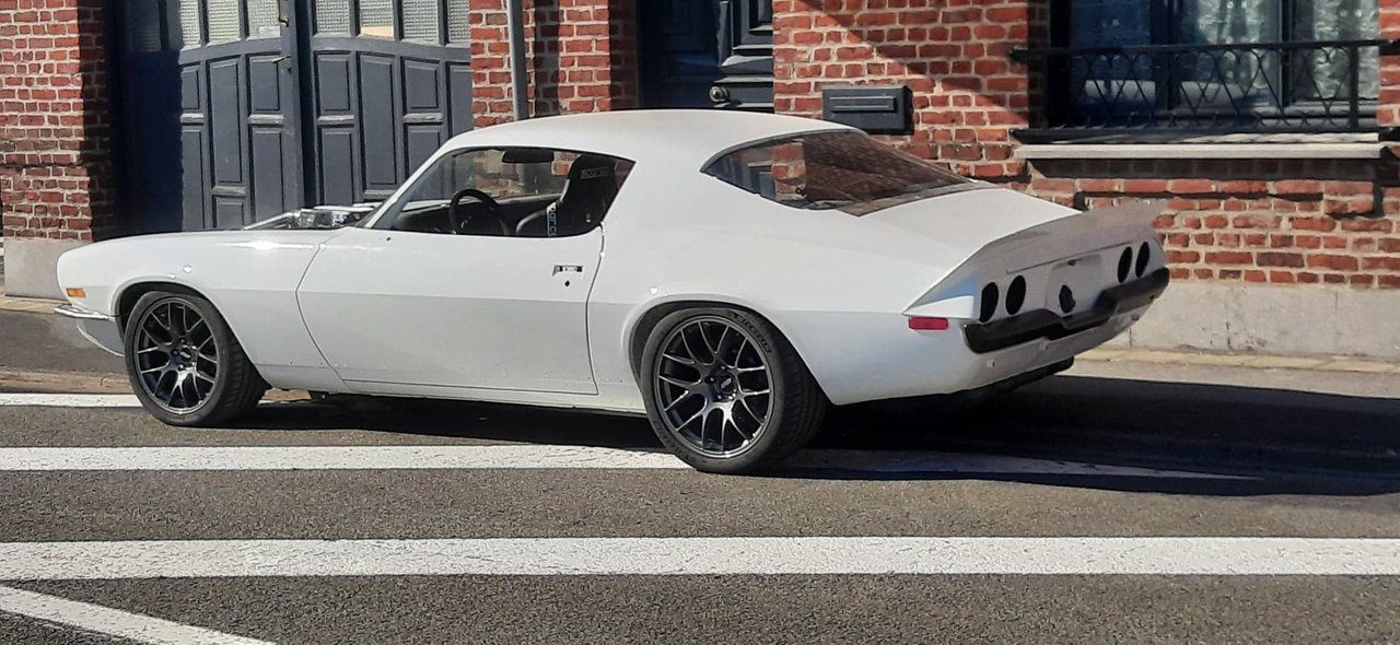

      Did you have to machine the apex wheels bolt pattern to fit the hubs?
    7. #327
      Oct 2016
      586
      No even with the Et ultra lug nuts from gorilla, it fits without machining anything, the bolt hole is 16mm diameter

      better now !
    9. #329
      Oct 2016
      586
      this is better like that, for passenger side I'll try 1" longer to see how it looks
    10. #330
      Oct 2016
      586
      this is way better like that !
    11. #331
      Oct 2016
      586
      front bumper allmost finished, still a bit of hammer shots and it will be good for sanding and paint.
