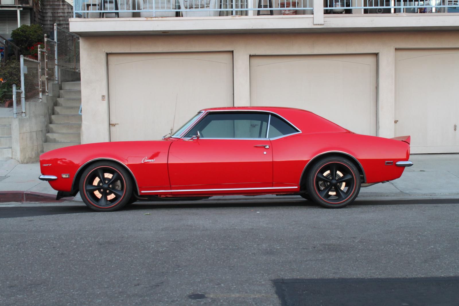

      The good thing is if u run those tire/wheel sizes your car will have the exact same size as this one, which is badass IMO ; )
      Name:  Camaro L 003.jpg

      Thanks for all the help gents!
Size:  175.0 KB[/QUOTE]
      Sep 2016
      5
      Nice ride...
