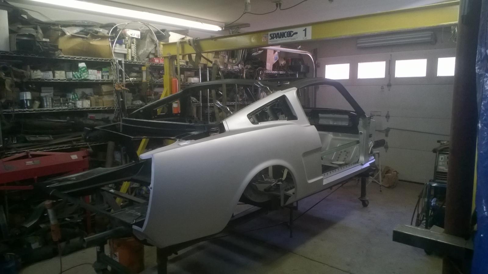

      More progress
    4. #44
      Sep 2013
      sw Kansas
      1,661
      Just like a model car kit. 1 part at a time.

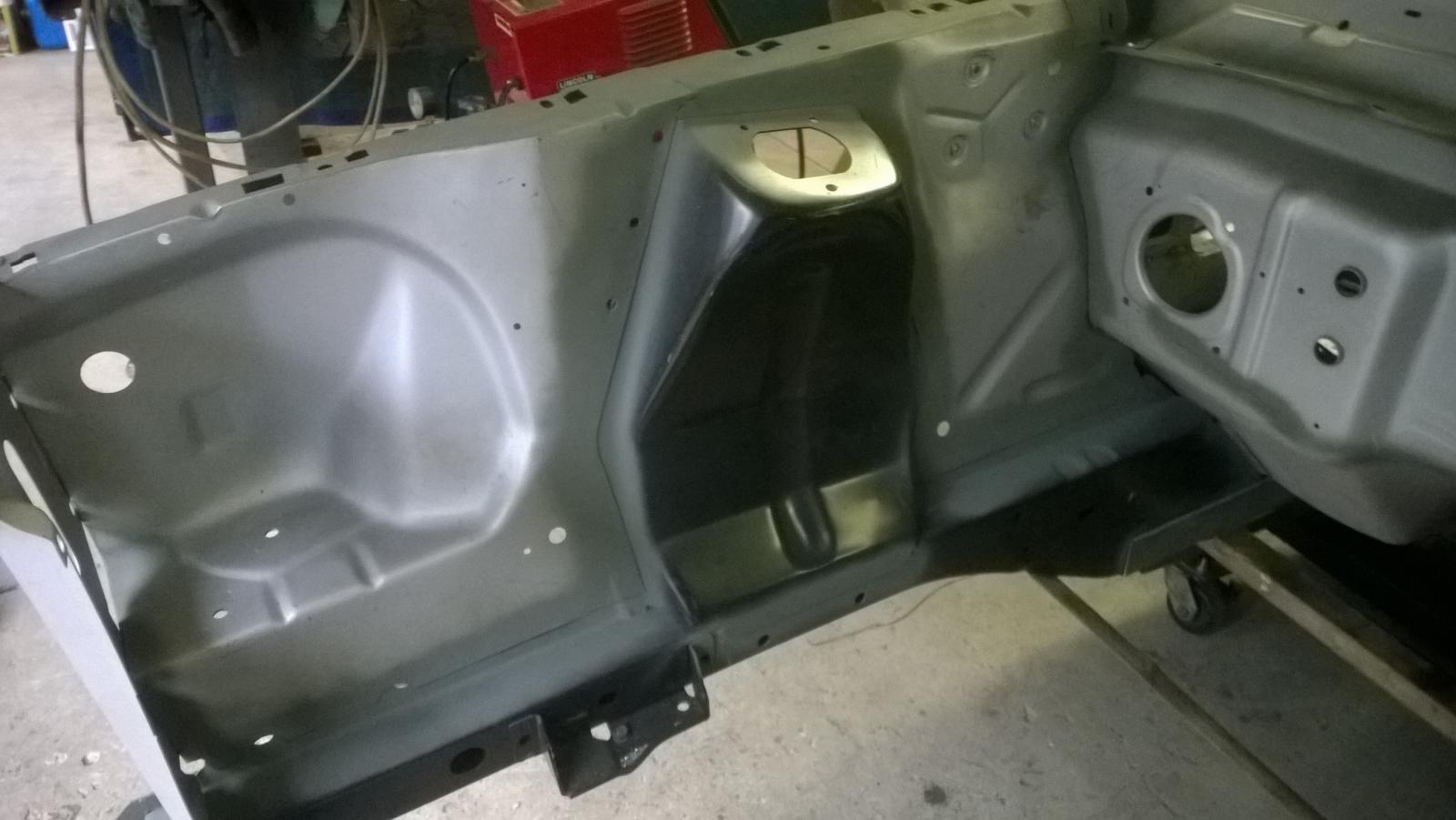

      More progress
    6. #46
      May 2010
      Livermore CA
      131
      This is pretty awesome. Cool seeing it come together.

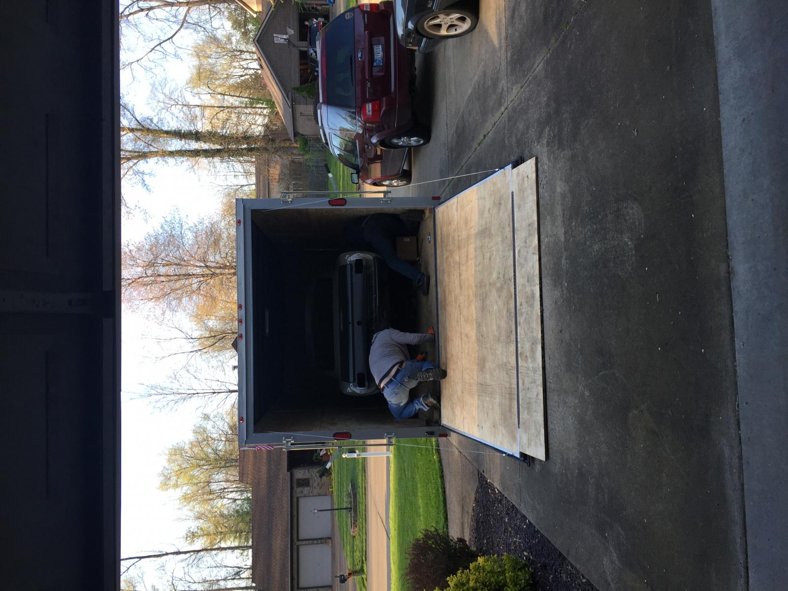

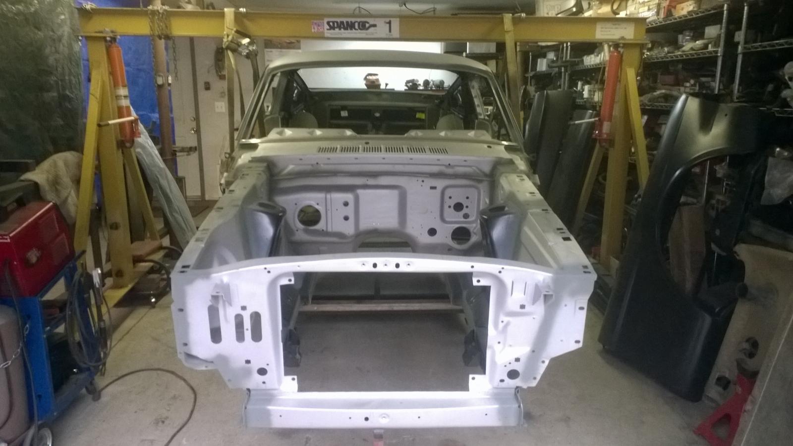

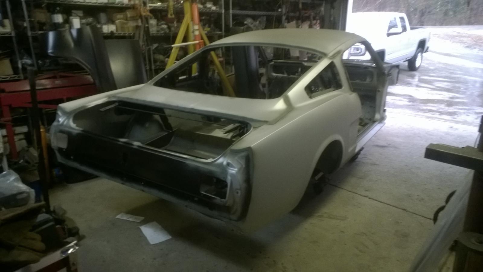

      Car is being delivered today. Here are some pics sent to me prior to being delivered. Pretty excited to see it in person
    10. #50
      Sep 2013
      sw Kansas
      1,661
      Whoo Hoo !
    11. #51
      Jun 2016
      Evansville IN
      49
      It's here

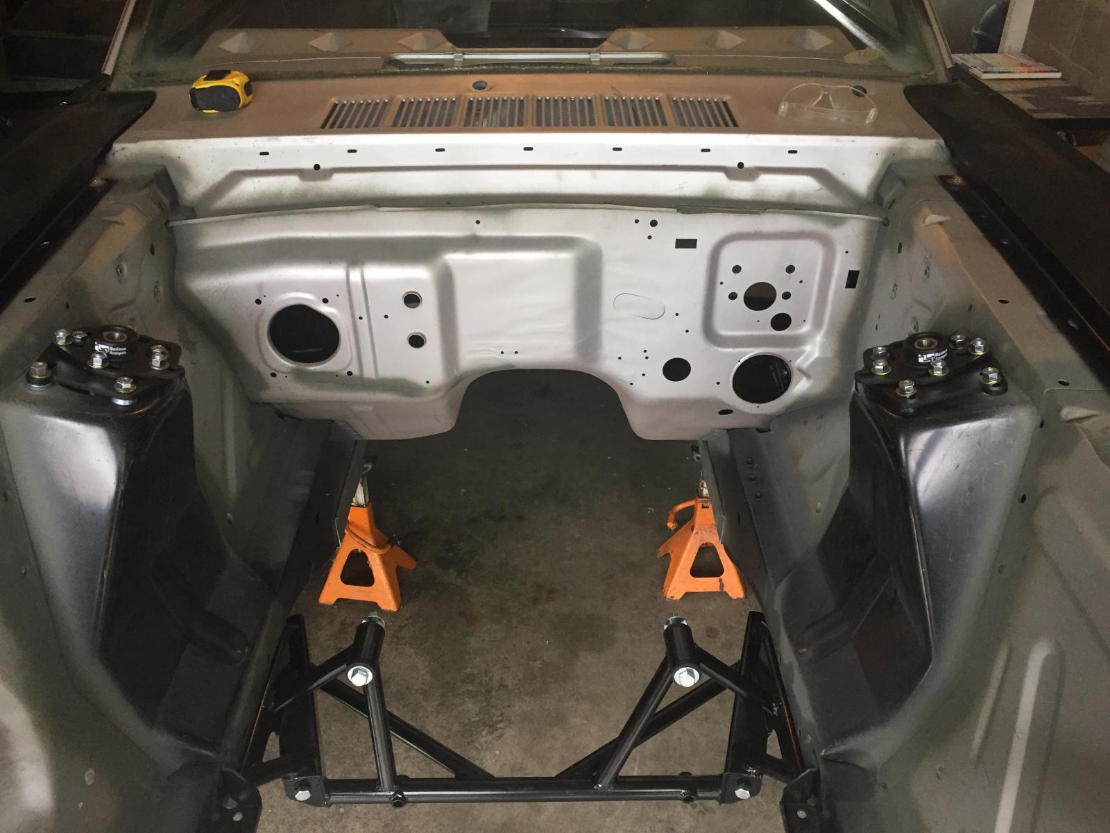

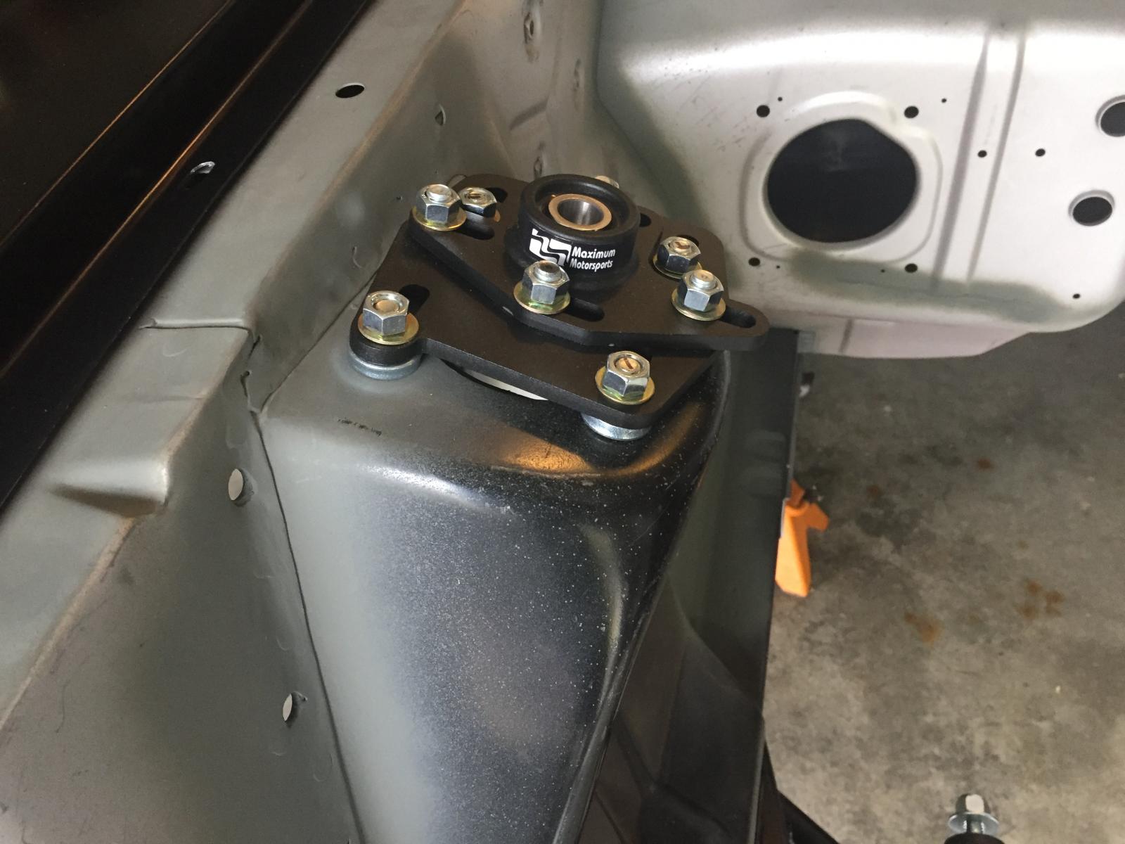

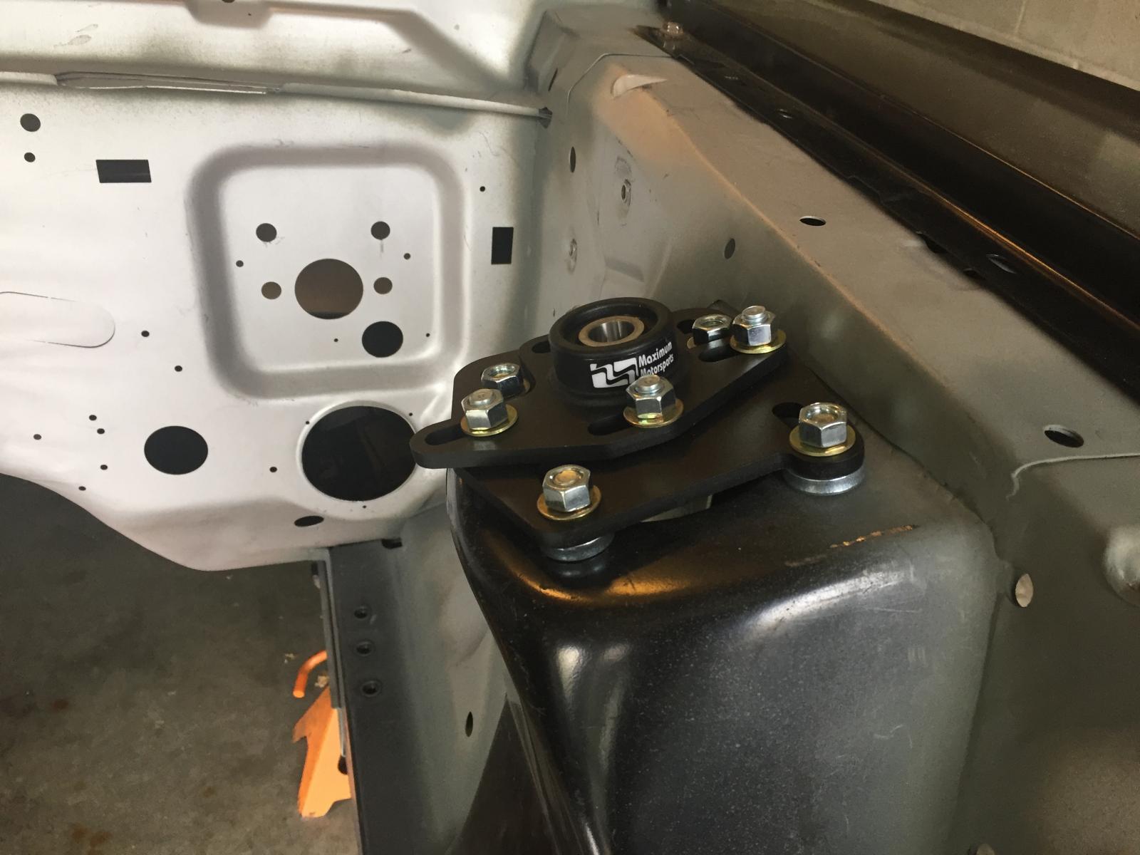

      Now that tony is done with his part, time for me to start.
      Installed AJE kmember and 94-04 maximum motor sports caster camber plates.

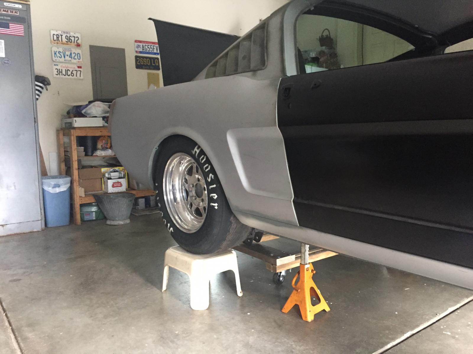

      Also played with the looks of the bogart d10's. This might be a nice strip look.

    15. #55
      10
      Anymore info on what you did to install the Maximum Motorsports CC plates? Looking to do the same with my AJE setup
    16. #56
      Jun 2016
      Evansville IN
      49
      Quote Originally Posted by sj9ers View Post
      I just made a template, centered it on the strut opening, marked the mounting holes, drilled and installed.
