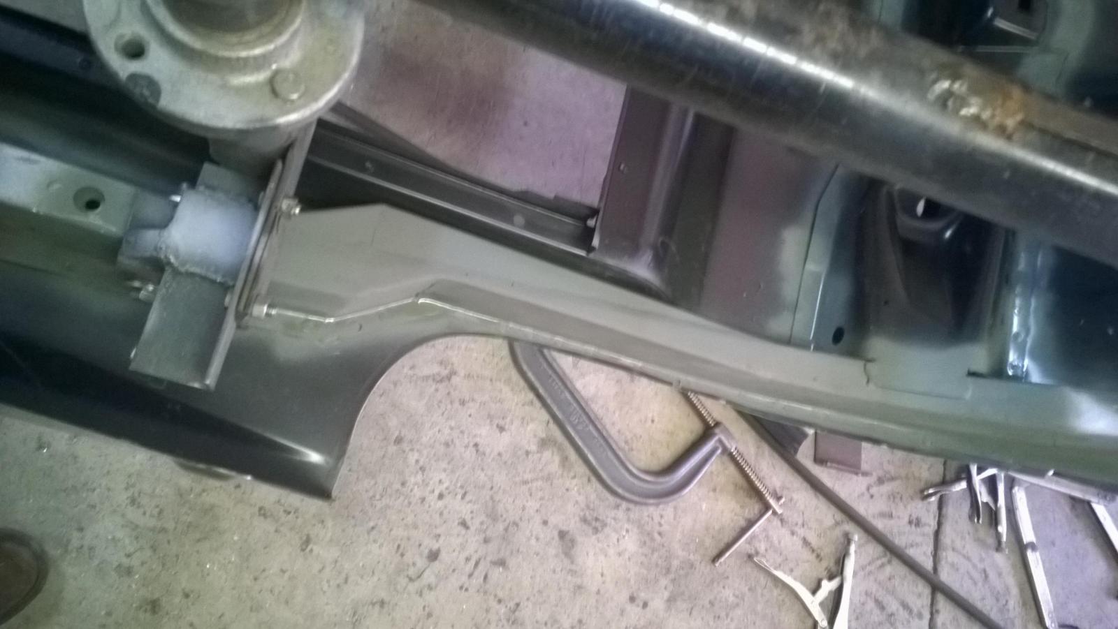

      Evansville IN
      49

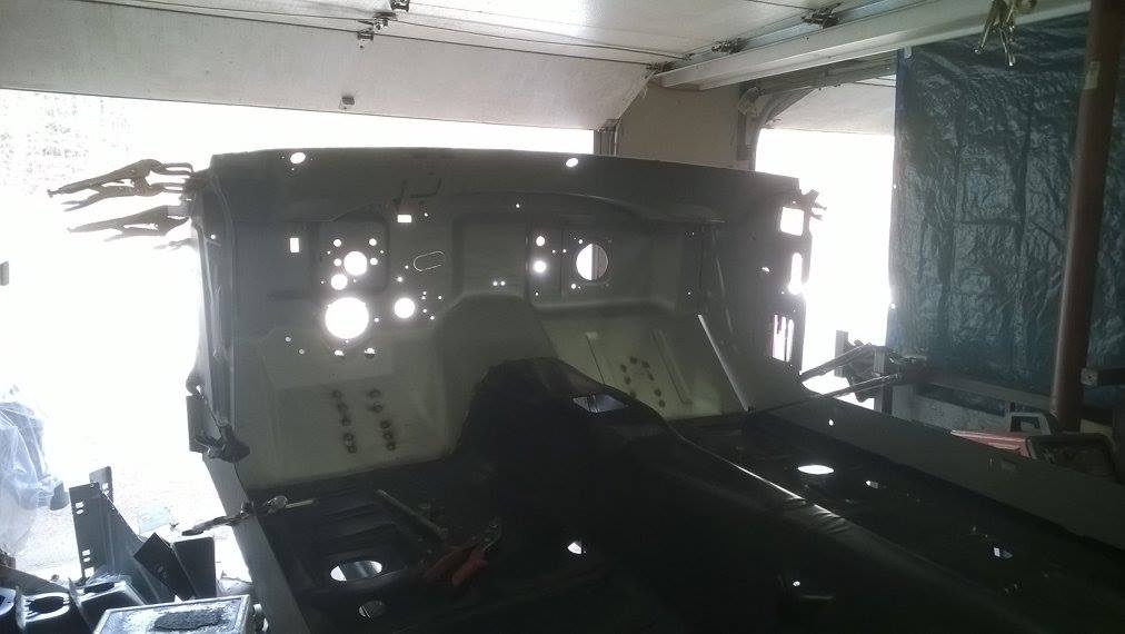

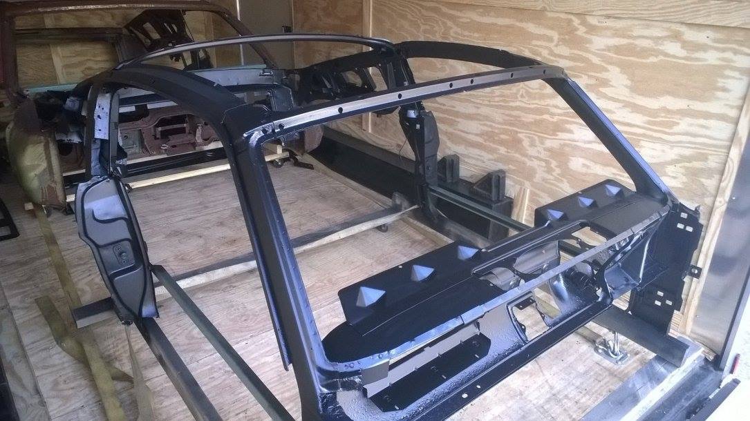

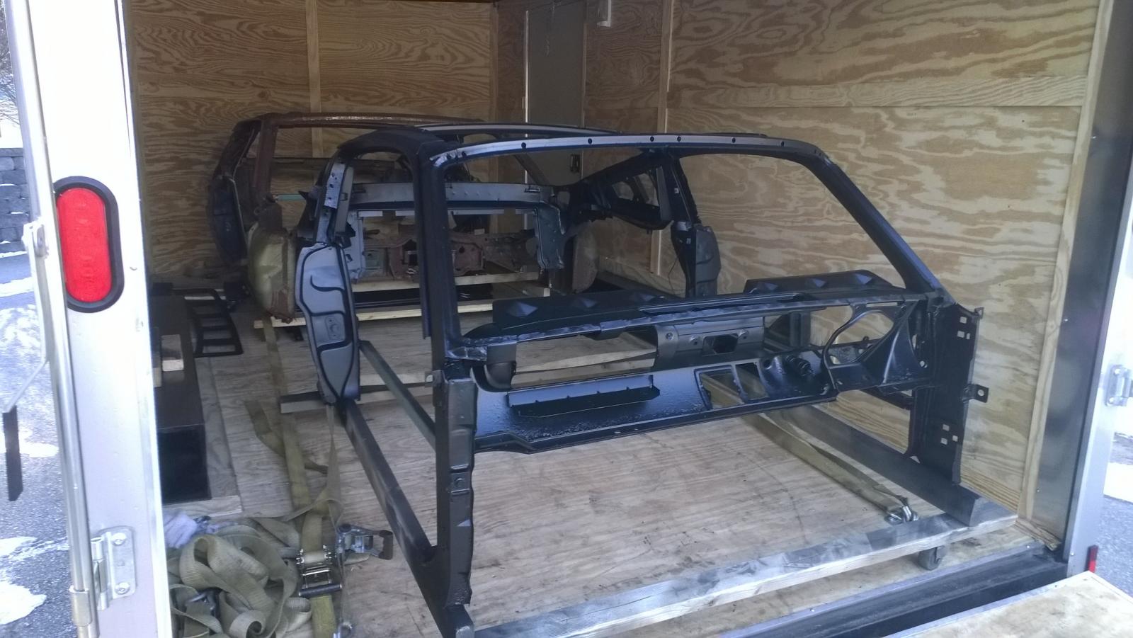

      Tony got it back from media blast and primer.

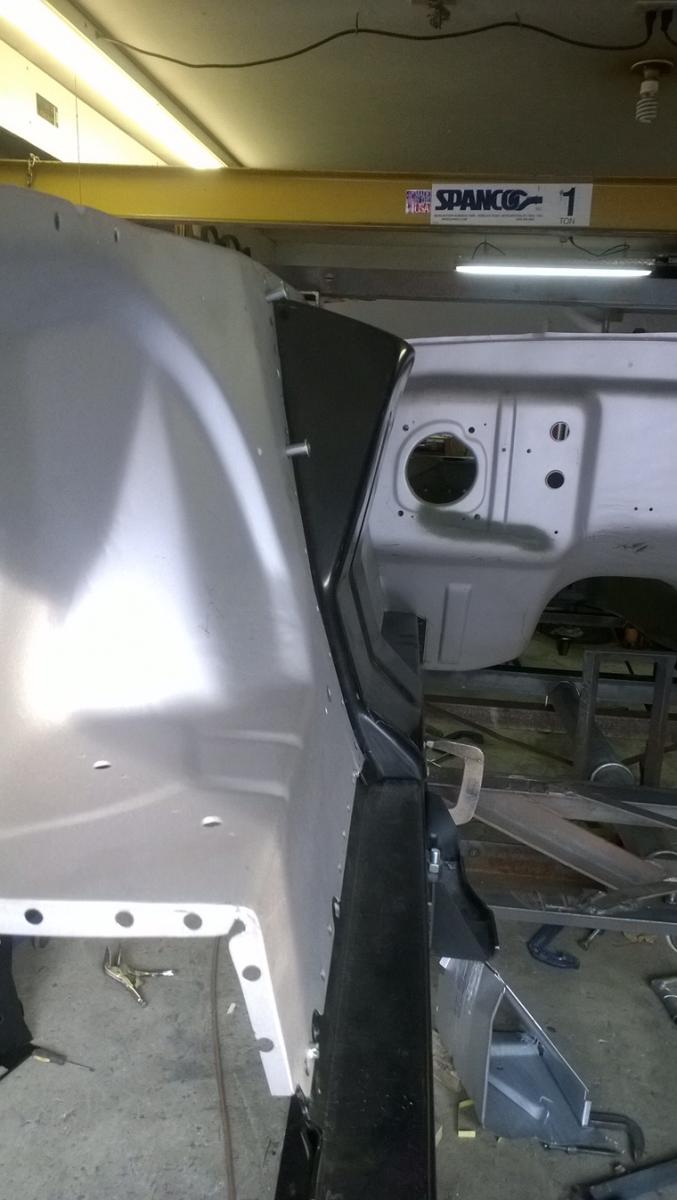

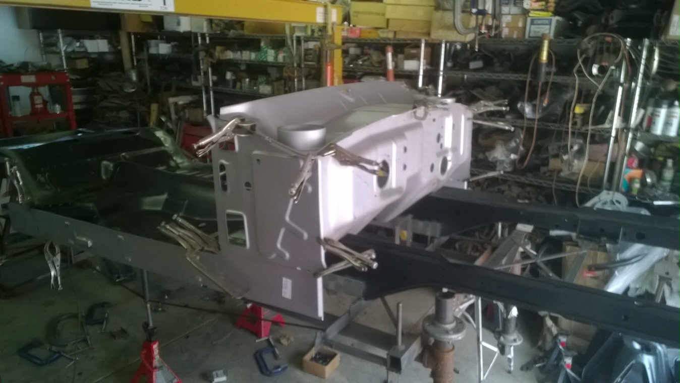

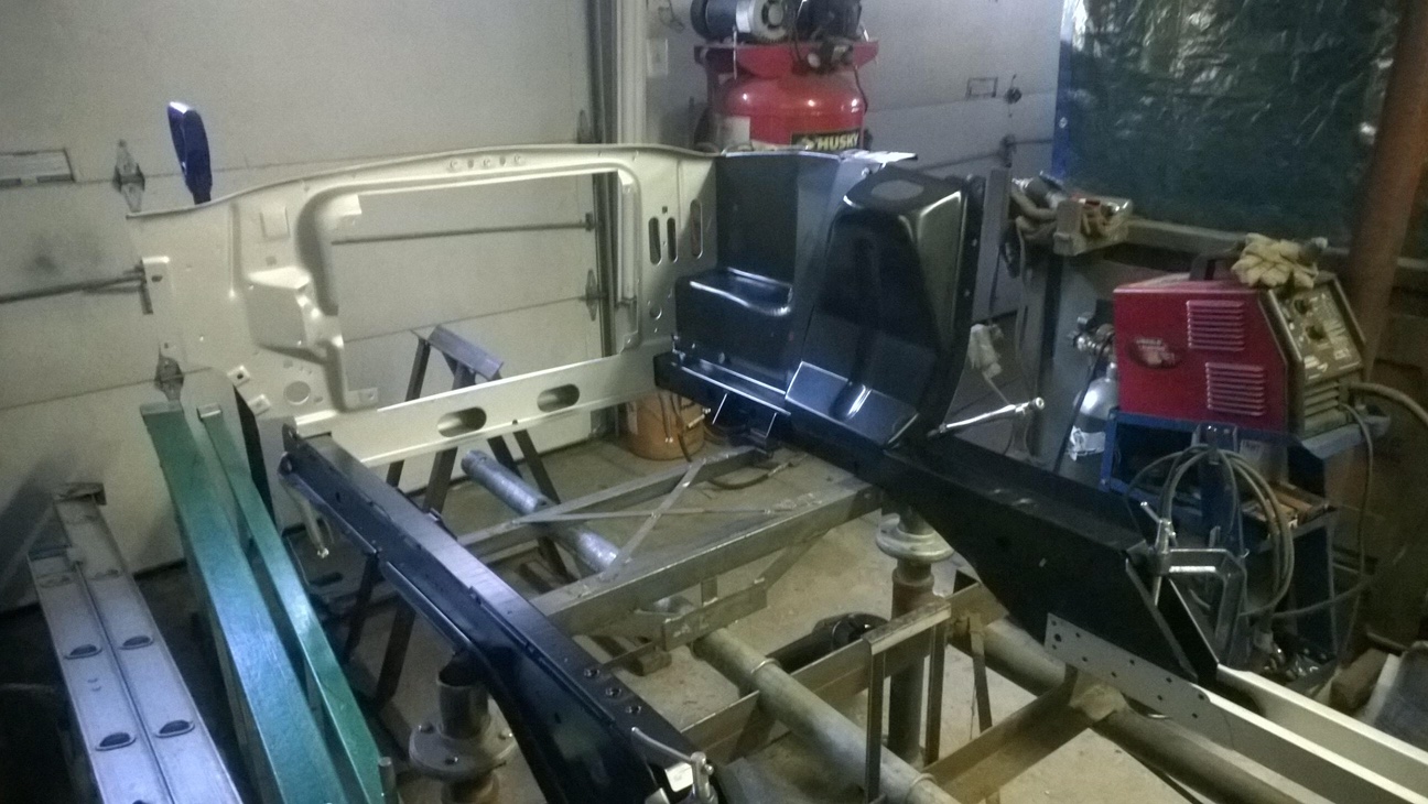

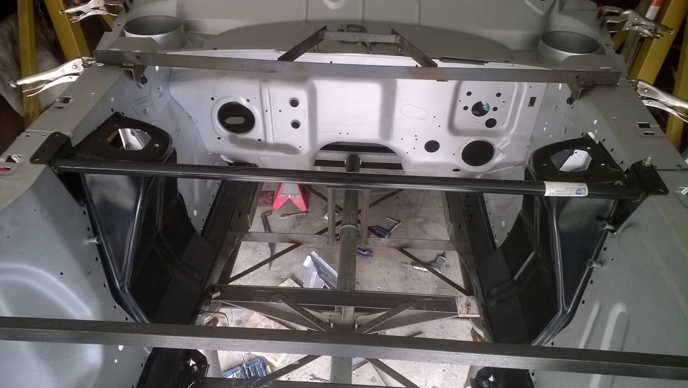

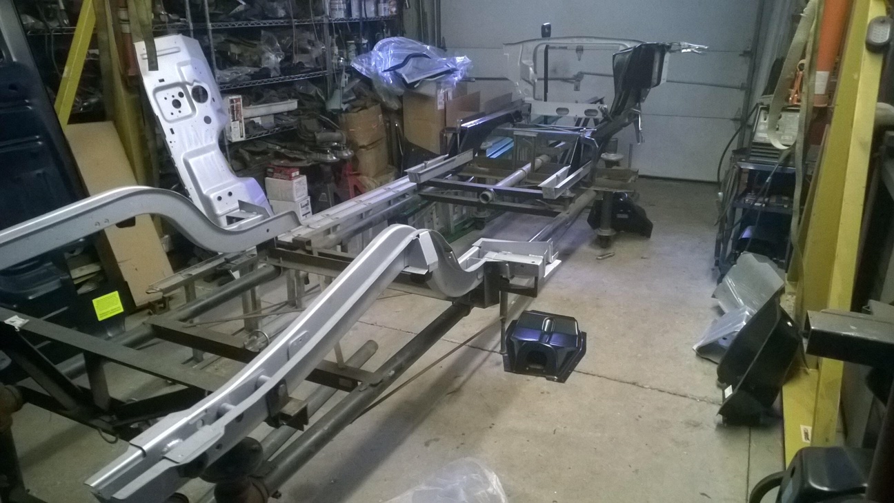

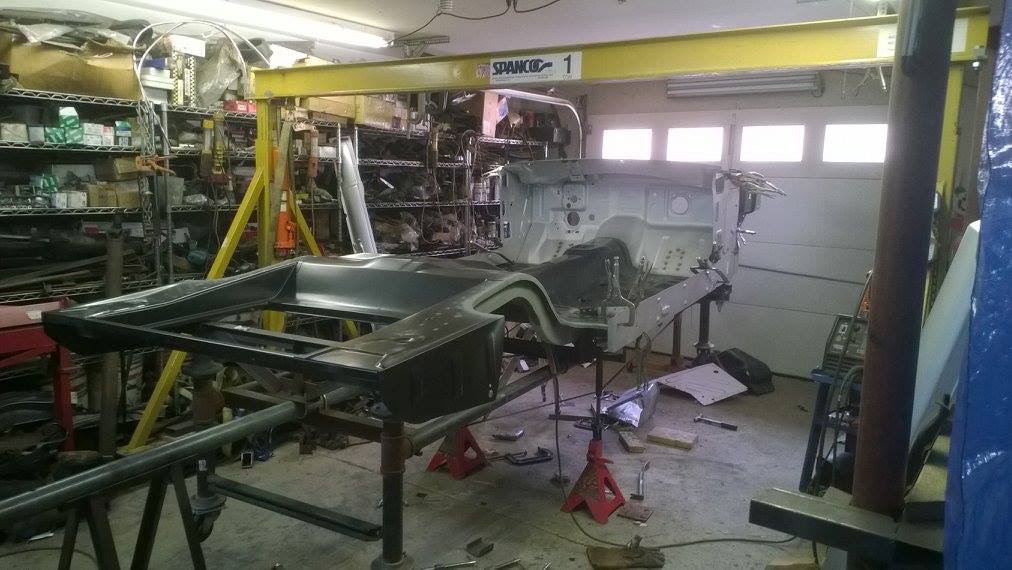

      Tony started putting together the frame rails. You can see the 68 notched shock towers and core support with the wider radiator opening.
      Hopefully see more progress this week.

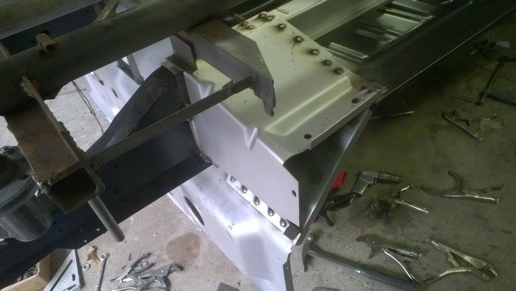

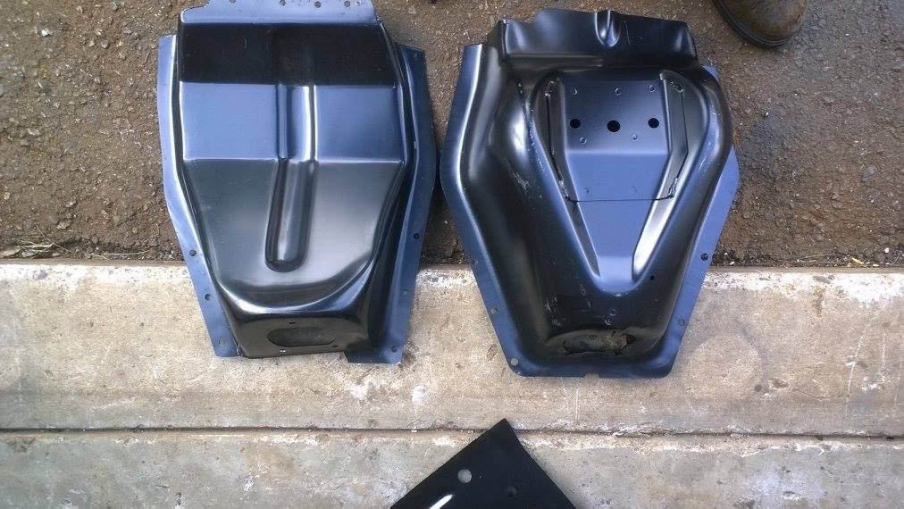

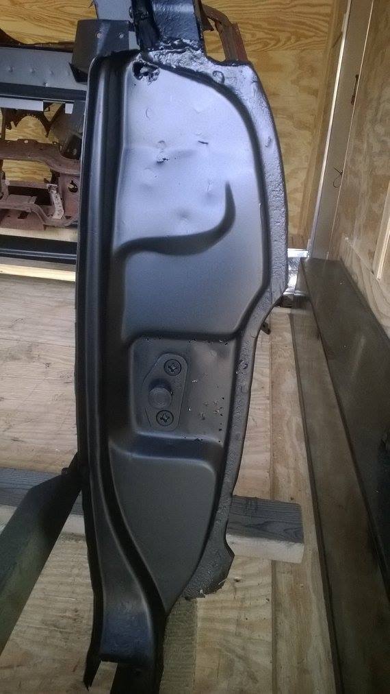

      Tony is making progress. Sent me pics of the DSE mini tub frame sections installed. Hope this allows for a 315 tire to fit like DSE says it will.

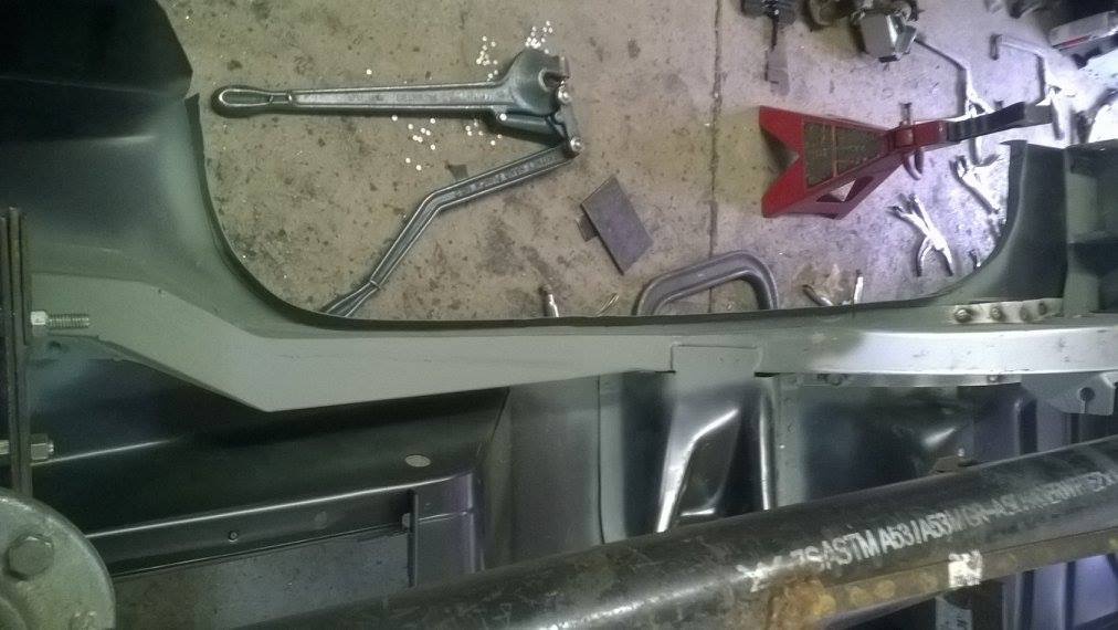

      Jun 2016
      Evansville IN
      49

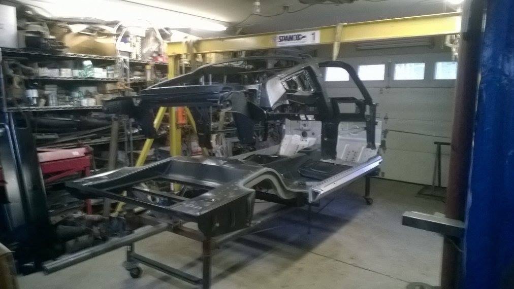

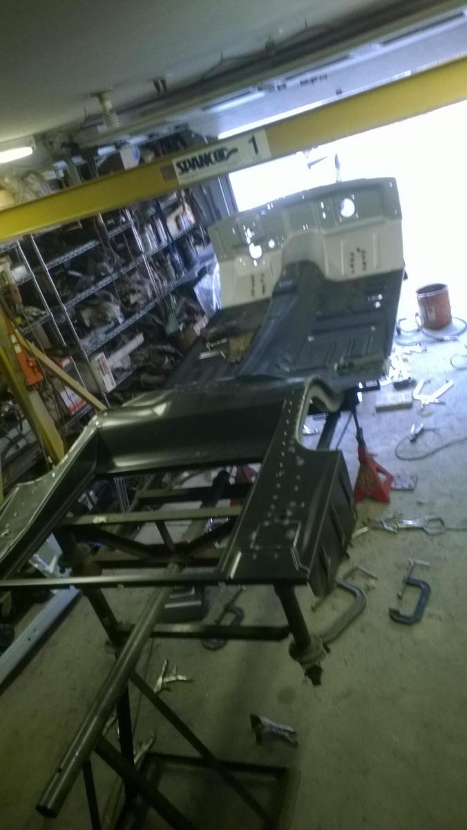

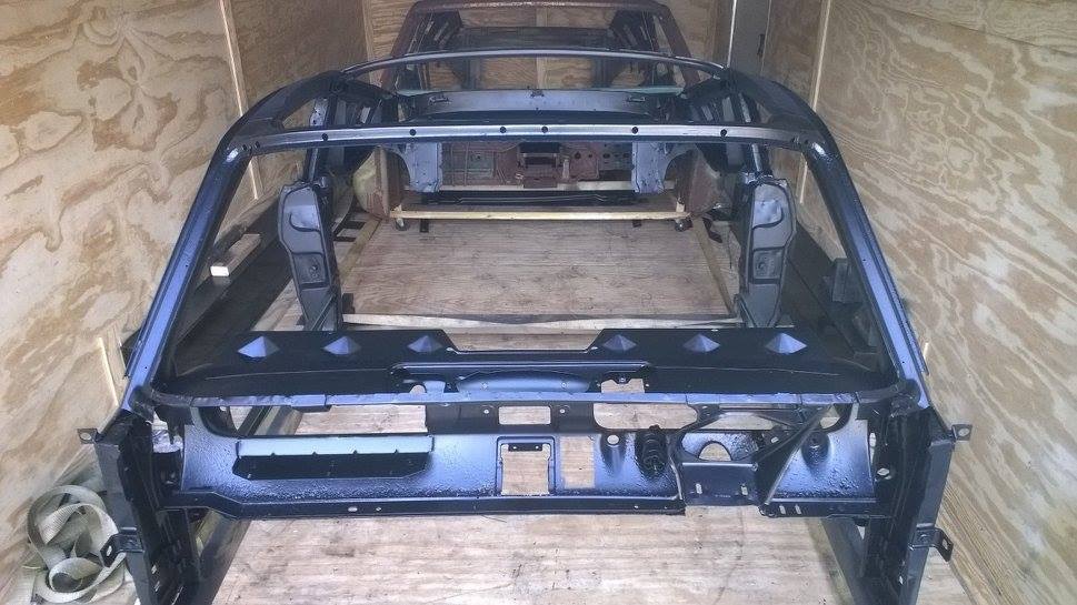

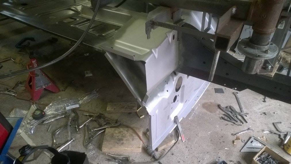

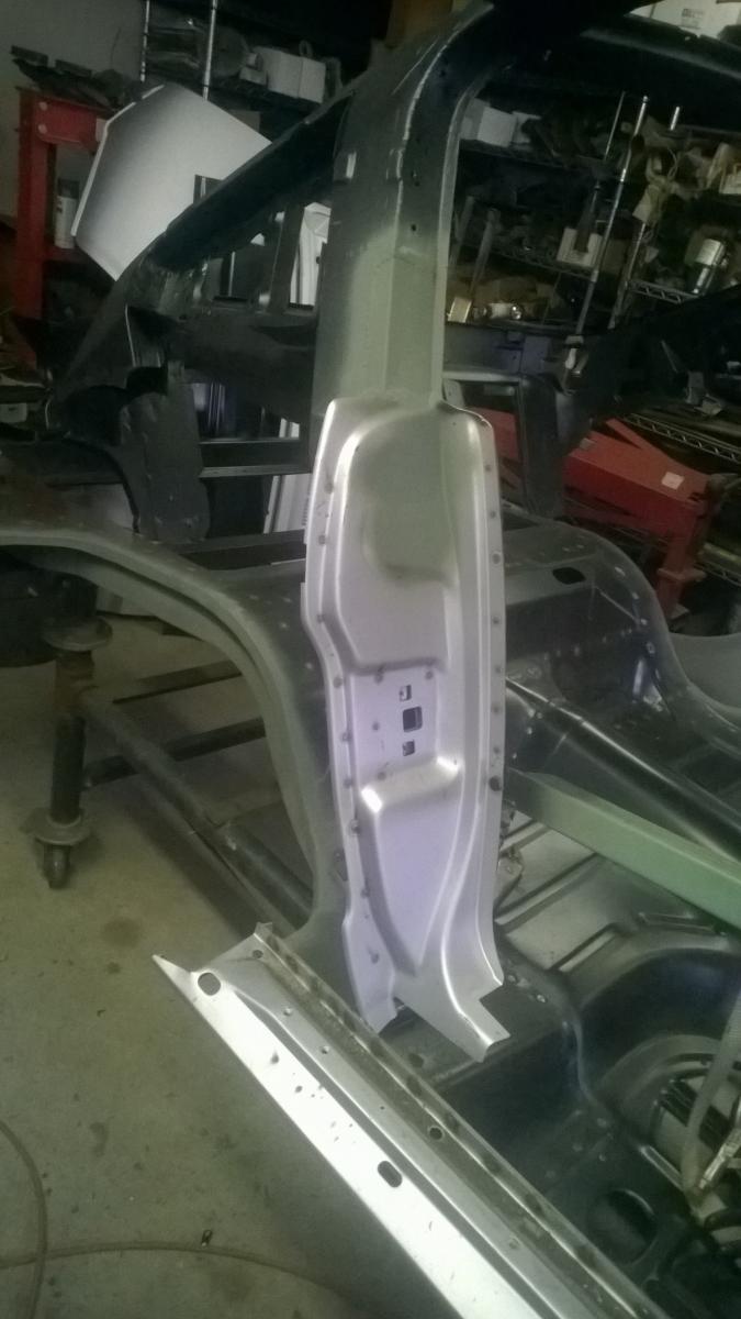

      Most of the floor is done

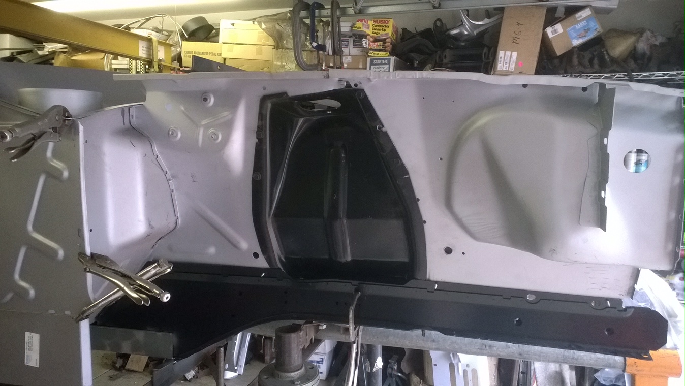

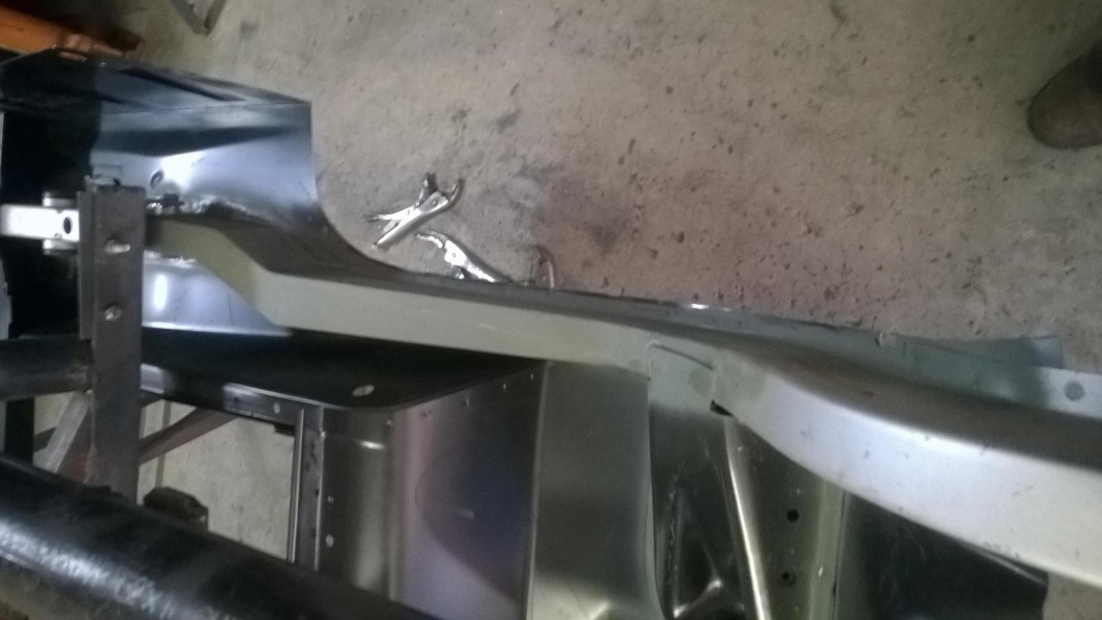

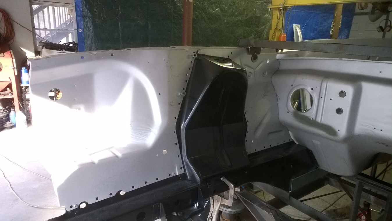

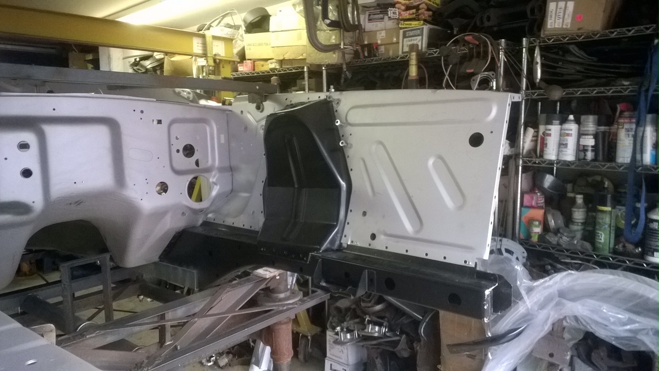

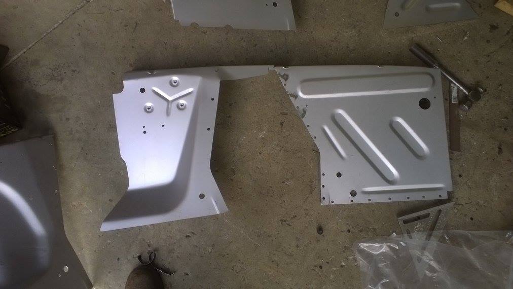

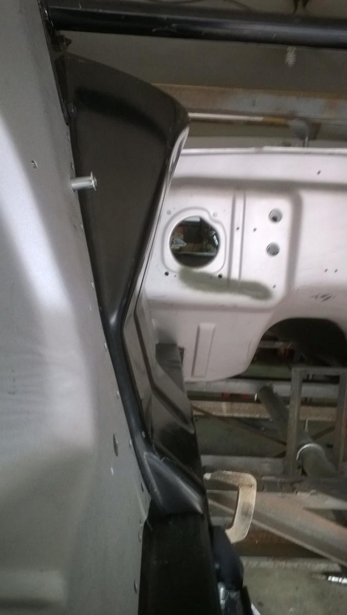

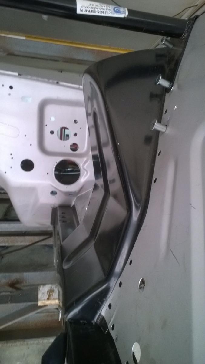

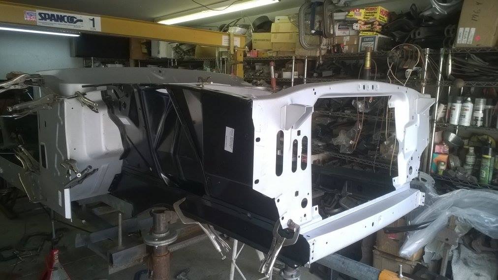

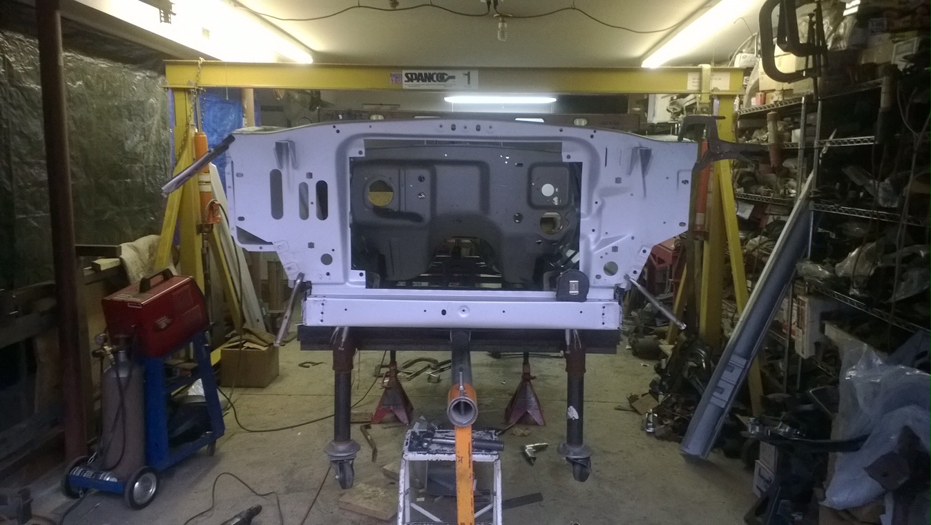

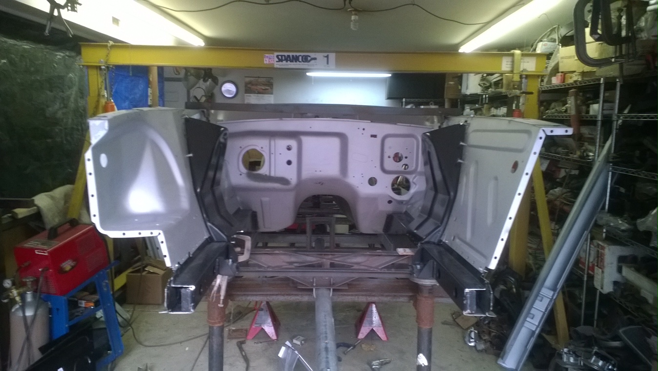

      Progress today. More pics from tony.
      He started test fitting the 68 towers.
      He had to use the 68 aprons (pictured in black) to get the alignment correct on the towers. We couldn't use the 68 aprons due to the 65 fender bolt holes not being the same. Once he got the alignment right, he installed the 65 aprons.
      Look at the clearance the 68 towers will give.
      Also the large opening of the 68 radiator opening.

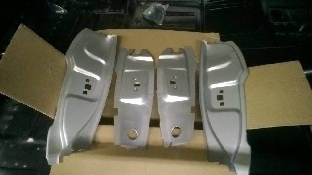

      Looking really good man. Are those the Dynacorn shock towers?
      Ridetech Suspsension
      Tech Specialist
      Phone: 812.481.4734
      Project Fox
      1979 Trans Am
    17. #37
      Jun 2016
      Evansville IN
      49
      Quote Originally Posted by Godbolt View Post
      Great job. You going to take the opportunity to connect the front and rear sub-frames?
      I will once I get it back. Thinking of using the DSE subframes that go thru the floor. May try to tie the rear lower control arms into the subframes
      - - - Updated - - -
      Quote Originally Posted by Josh@ridetech View Post
      Yea

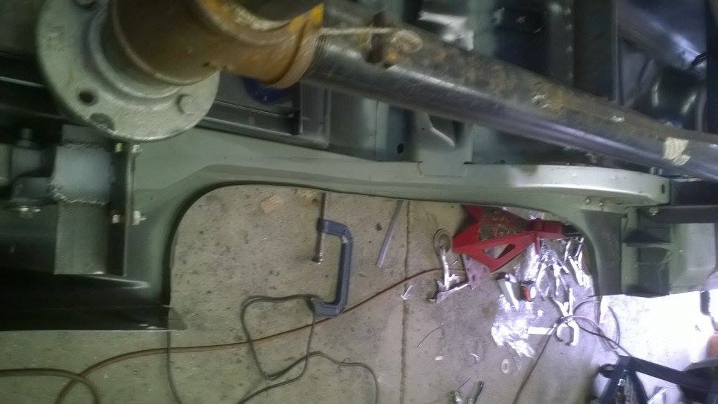

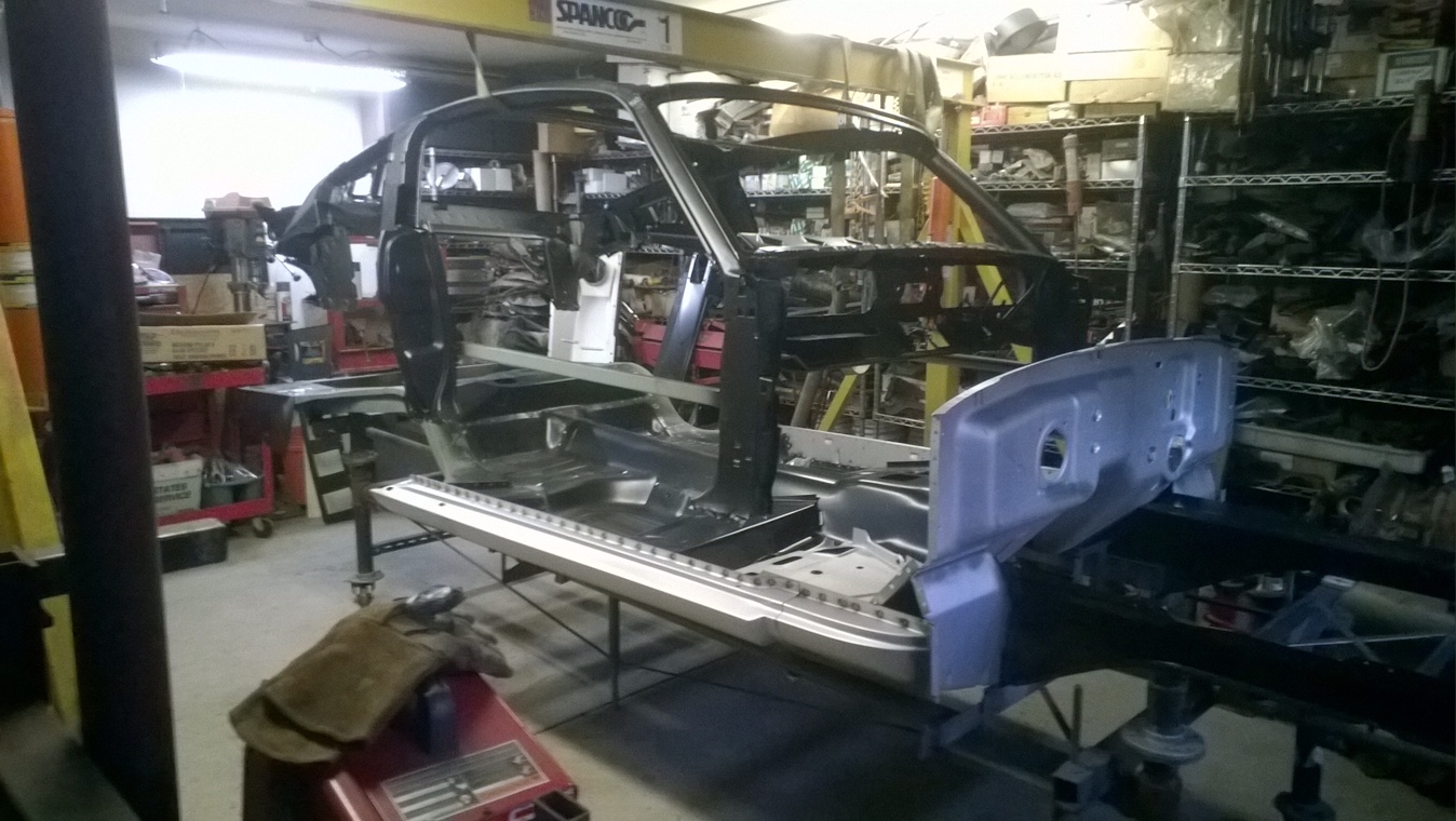

      A few more pics

      More progress

      A few more pics
