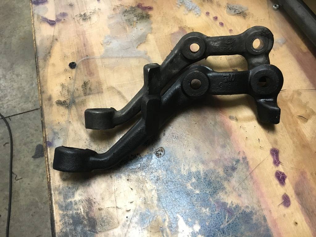

      It's pretty obvious by this picture the differences............Here's a picture of the difference in the spindle steering arms....

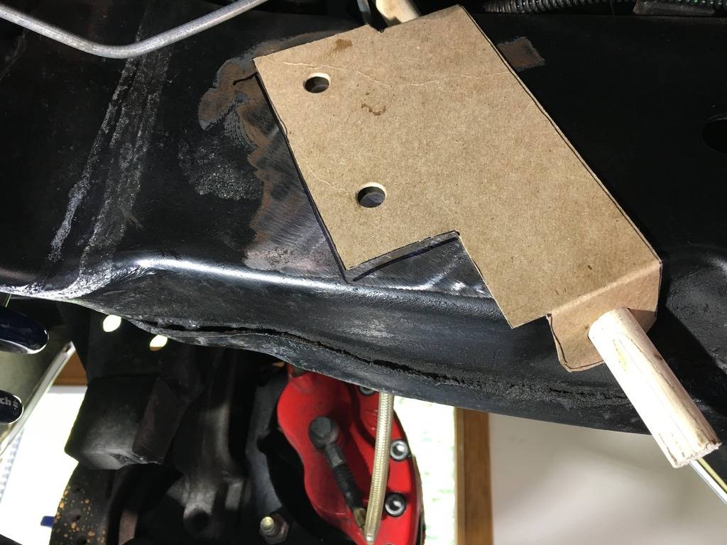

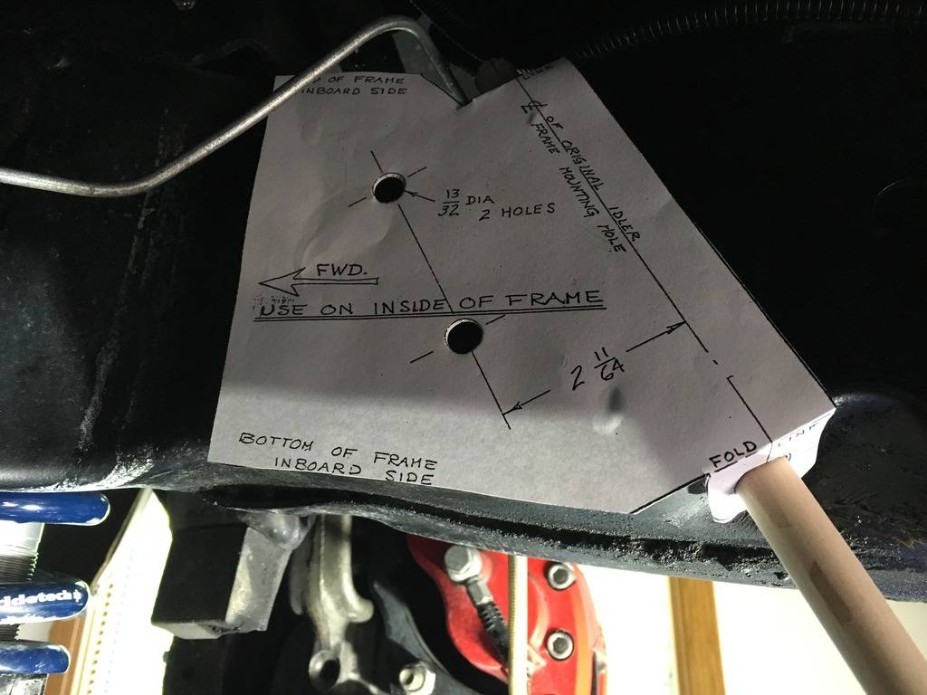

      Pictures of the supplied templates provided in the 1966 Service Bulletin.......

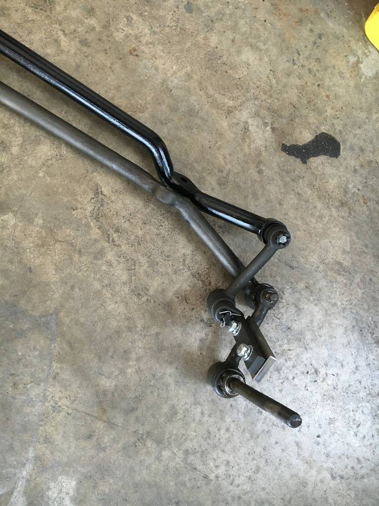

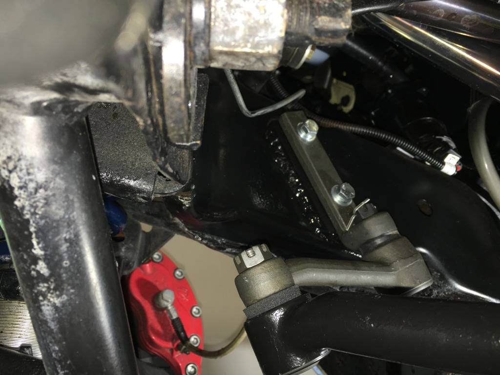

      So........What I did was make the required steering arm spacer with tapped holes......got it in position .....and welded it in......
      After installing the new Pitman Arm , centerlink, and Idler Arm.......It was apparent that there was something wrong as the centerlink went up on an angle and back towards the rear of the car........Hummmm!!!!..........After thinking about it and looking at what could be the problem.....I noticed that the 67 Pitman arm was about a 1/2" lower than the 66.........The Template must have been made with the 66 arm...........I made the centerlink parallel to the frame and the front crossmember.........Drilled new holes for the Idler arm (which corresponded to the lower 67 arm...........Makes perfect sense now ) and bolted everything in........Installed new Tie Rod ends.........Now everything is new.......Adjusted the toe roughly and when I pulled out of the garage to go to the alignment shop..........I knew right away there was a major difference as there wasn't any tire squeeling or scrubbing...........after alignment.........It is now the complete package.....Ackermann issue solved.........drives and steer's perfectly...............
