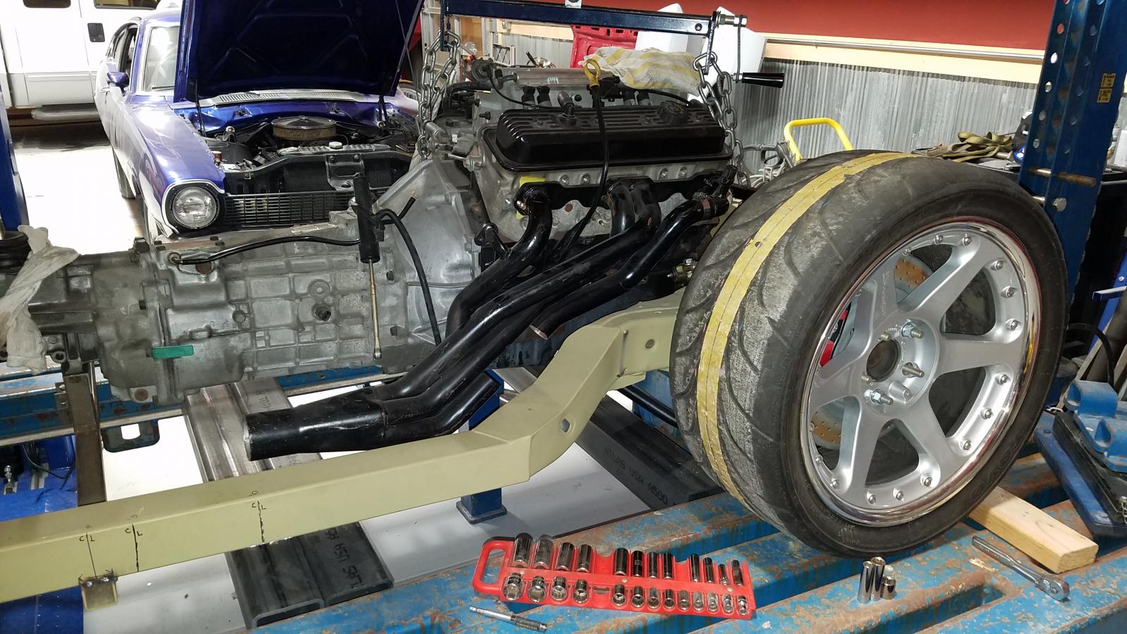

      Another "close, but not quite" shot: Need about the height of that 2x4 under the cab to get the top of the tire even with the fender lip.

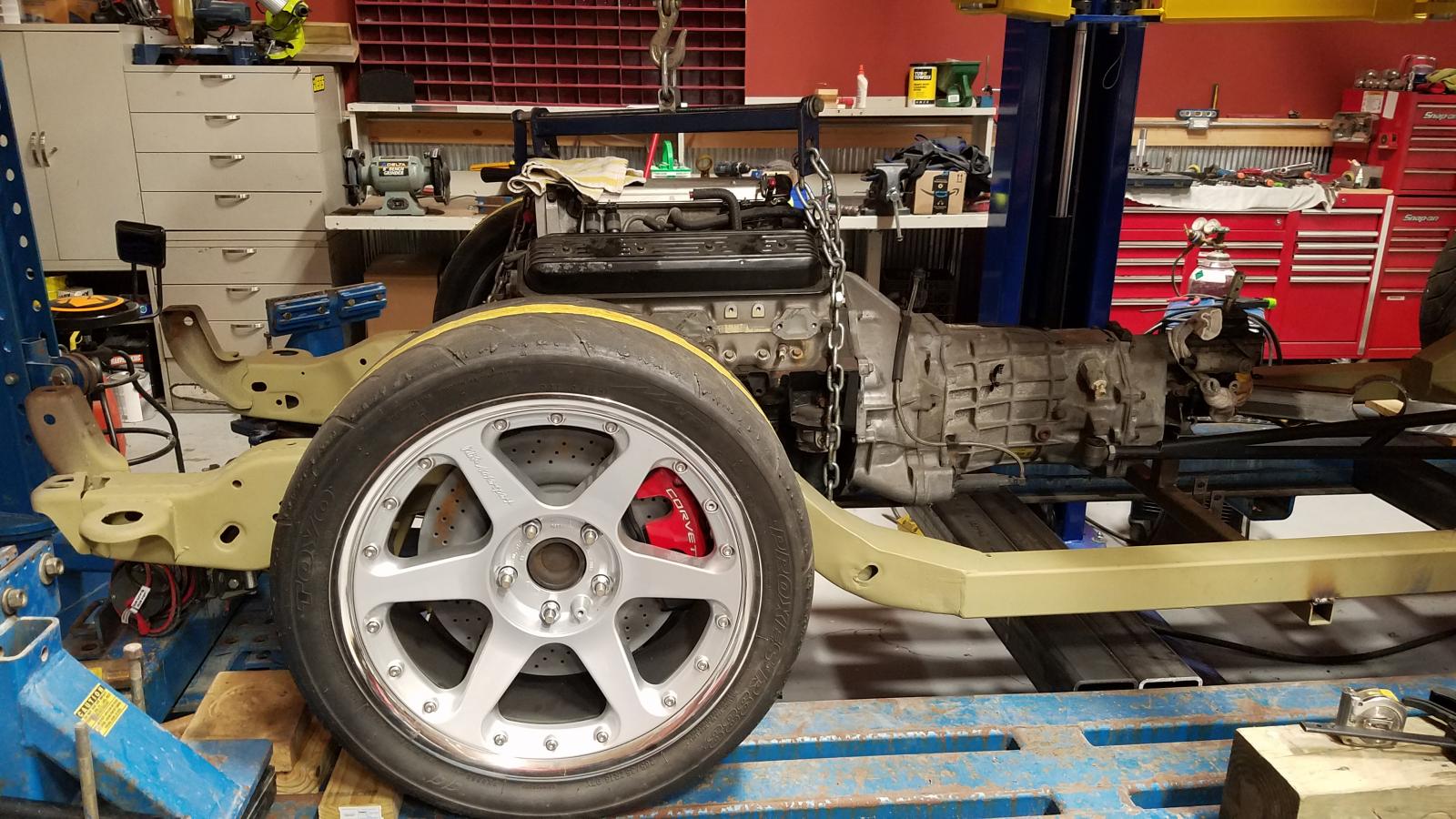

      Up and down, up and down...repeat ad nauseum. Don't hit the roof!
      This picture is an early shot (axle ends still bare and no engine setback) and out of order but I thought I'd throw it in here.
      I don't know how many times the body went up and down, but needless to say, the lift got a workout.
      Name:  up and down dont hit the roof.jpg
