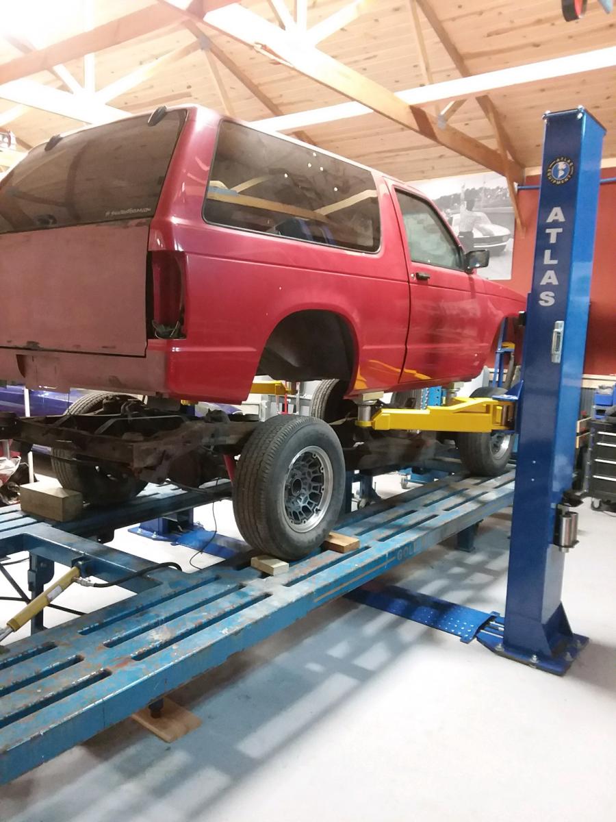

      As of Memorial weekend, the truck now resides at my BIL Dave's place, from here on referred to as Somewhere In Iowa Fabrication.
      It was either give the place a name, or refer to it as "Dave's big-ass shed in the middle of nowhere."
      We essentially hauled down what amounted to a vehicle and a half in a relatively small trailer.
      I can now refer to it as just "the truck" instead of the roller and the new chassis.
      The body has been separated from the original rolling frame. The only thing we kept was the Monte SS steering box. Probably replace that with a Turn One box later.
      The roller has been sold off to a guy to use as the foundation for his next Hobby Stock build.
      I just got back from dropping off a small pile of suspension parts that didn't make the original trip down. While I was down there we busted out the air chisel and sawzall and did some cutting on the rear floor and wheelwells and also did some general brainstorming / decision making.
      We might have had a few beers as well.
      There has actually been some reverse scope creep going on. I suppose you just call that scaling back to reality due to minimal benefit from maximum effort.
      The 8" engine setback was first to go. We've determined 4" is the max we can go without a wholesale revamping of firewall, dash and HVAC. So 4" it is.
      The change I'm actually happy about is that we're determined to fit a 10" rim with a 285 tire on the front without flaring the fenders.
      Keeping the body looking stock-ish will go a long way to upping the wow factor when people realize just how much rubber is under there.
      Picture dump to follow a little later.

      Body separating from original roller chassis
      Buh-bye original frame.
      C-channel, leaf springs, torsional rigidity of an over-cooked noodle, 4x4 driveline angles and clearances in a 2WD truck, you will not be missed.
    17. #57

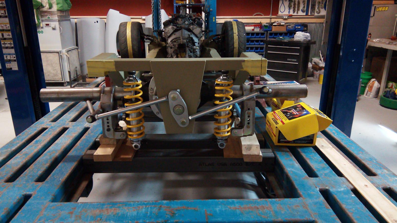

      As low as it would go on new chassis without cutting
      MAYBE if it was a 4x4. Otherwise, no way!
      Compare to later picture after cutting floor and shifter hole.

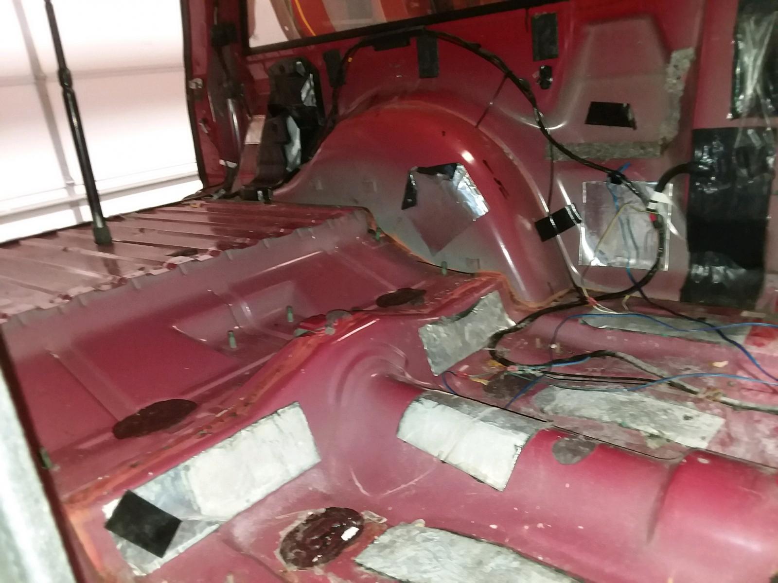

      Rear floor and wheel housings
      Don't get used to this view, it will change.

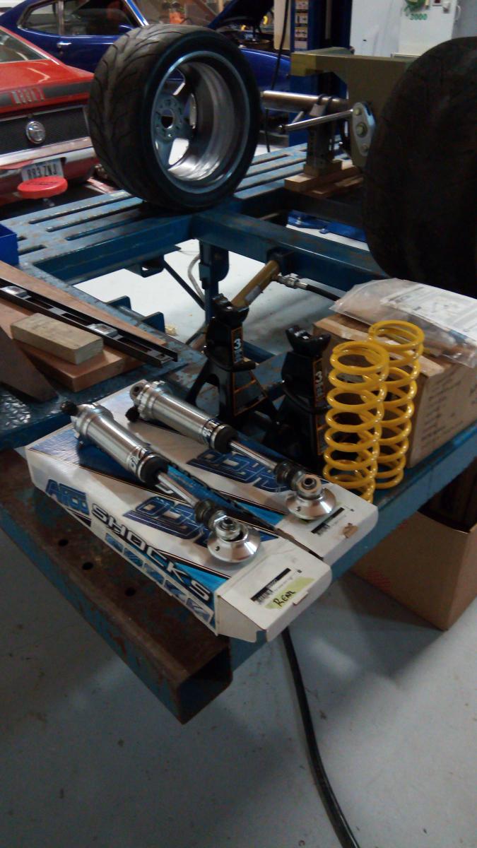

      pile-o-parts
      AFCO double adjustables and 200#/in. rear springs.

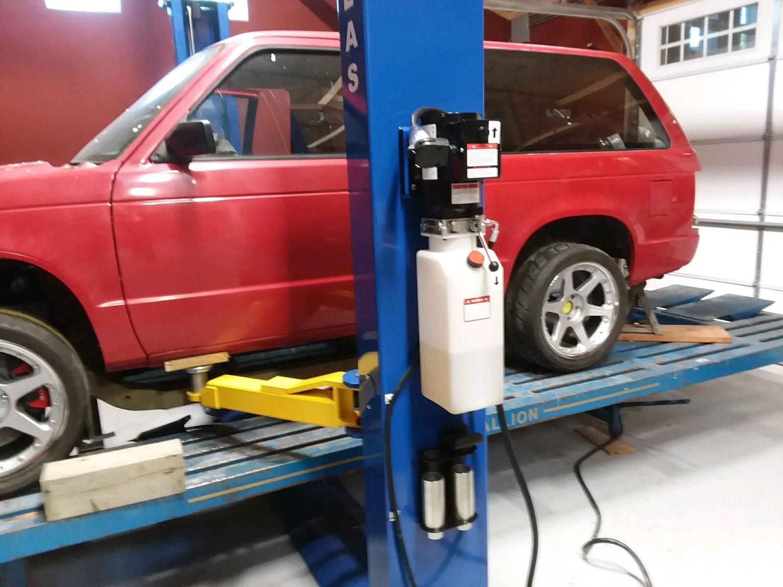

      Rear suspension
      Note that the axle ends are bare, no ends.
      An expensive order from Millerbuilt is in my near future.
