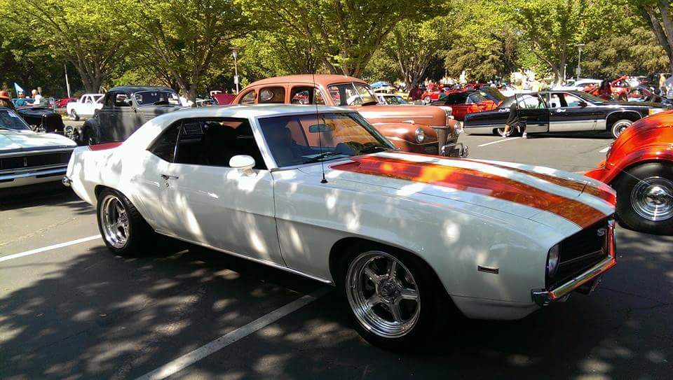

      The only trim on mine is the bottom rocker spear.Name:  FB_IMG_1458427870136.jpg
