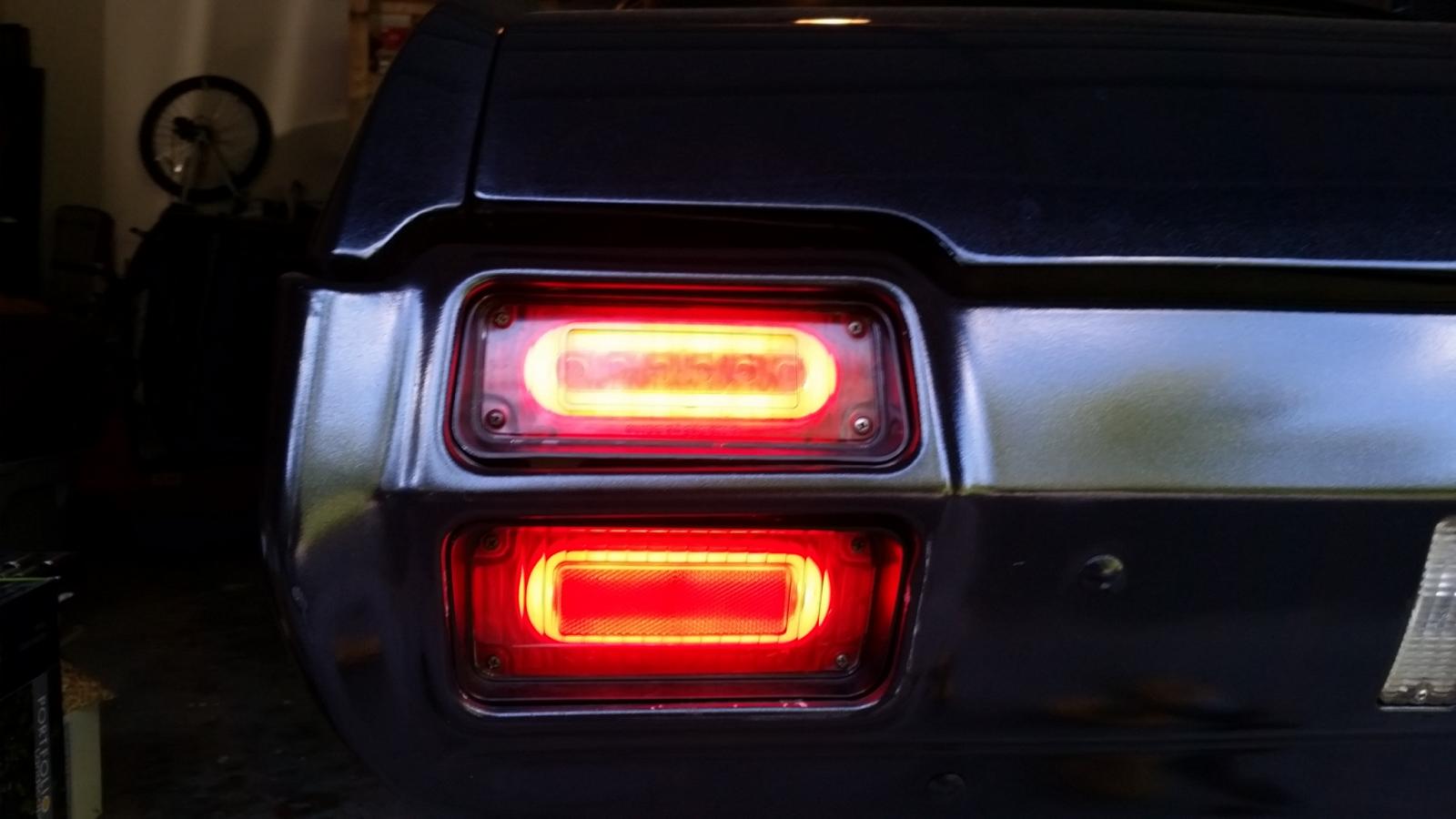

      Here's the custom LED tails lights if anyone is interested. Could be replicated on a similar year cutlass or maybe some other makes/models. I'll do a write up if anyone is interested.

      Can you take a pic of the taillight internals? I'd like to do something similar with 65 Skylark taillights

      Unfortunately I don't have any pics of when I put them together, and the lights are actually houses semi-permanently inside the lens portion and not the actual headlight bucket. I utilized a set of new "glow" trailer LED tail/stop/turn lights and cut, plastic welded, etc. to make them fit. Wiring was a simple matter of splicing into existing tail wires and grounding on the bucket itself. Really was very simple, but I have to stress that these lights fit PERFECTLY into the lens housing for this year Cutlass. A 1/4" off and it wouldn't have worked without major modification to the lend or bucket or both. I did have to drill and hammer out the inside of the lower buckets to make room for the wiring. The upper fit without mods.
      The difference is night and day, no pun intended. In the pictures above the passenger side is original and fully lit. That shows the output difference. This was midday sun. At night they are super cool looking. They do require an LED capable flasher or you won't get turn signals.
      Let me know if you have any other questions. I am going to do a similar mod to the front parking lights next.
