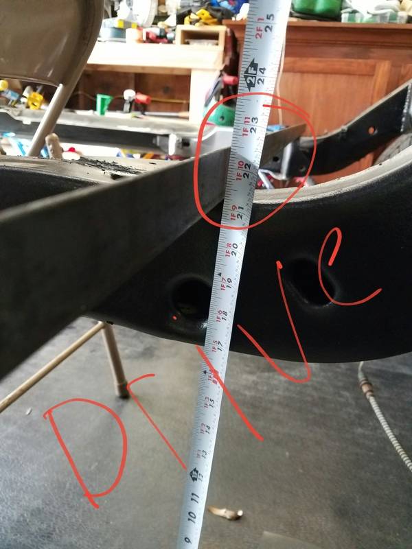

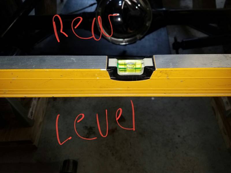

      I have some quick questions for the masses out there. I am wondering if I should be concerned or if I have a problem, might just be my floor. As some saw in the previous posts, I am putting in an ABC frame boxing kit. Before doing any welding I made sure to check the frame was level and it was. I have not been running any long beads when welding in the frame boxing kit, just doing tack welds as to not build up heat and warp anything. I even checked my measurements using the picture from this link and they are dead on.
      http://www.chevelles.com/forums/45-c...66-malibu.html
      But I noticed some stuff that has me worried.
      In the first set of pictures, you can see how un even my floor is, it has a slope to the passenger side.
      Here in the next two pictures, I show the measurements right by where the lower control arm connects to the chassis. There is a half inch difference in height. I want to assume this is due to the floor being lower on the other side, but I am not convinced.
      The series of next pictures show the chassis is level from drive side to passenger side. The driver side measures to the top of the angle iron at 22.5", the passenger side measure to 22". I would think this should throw my level readings off, but as you can see in the rest of my pictures the frame is sitting level.
