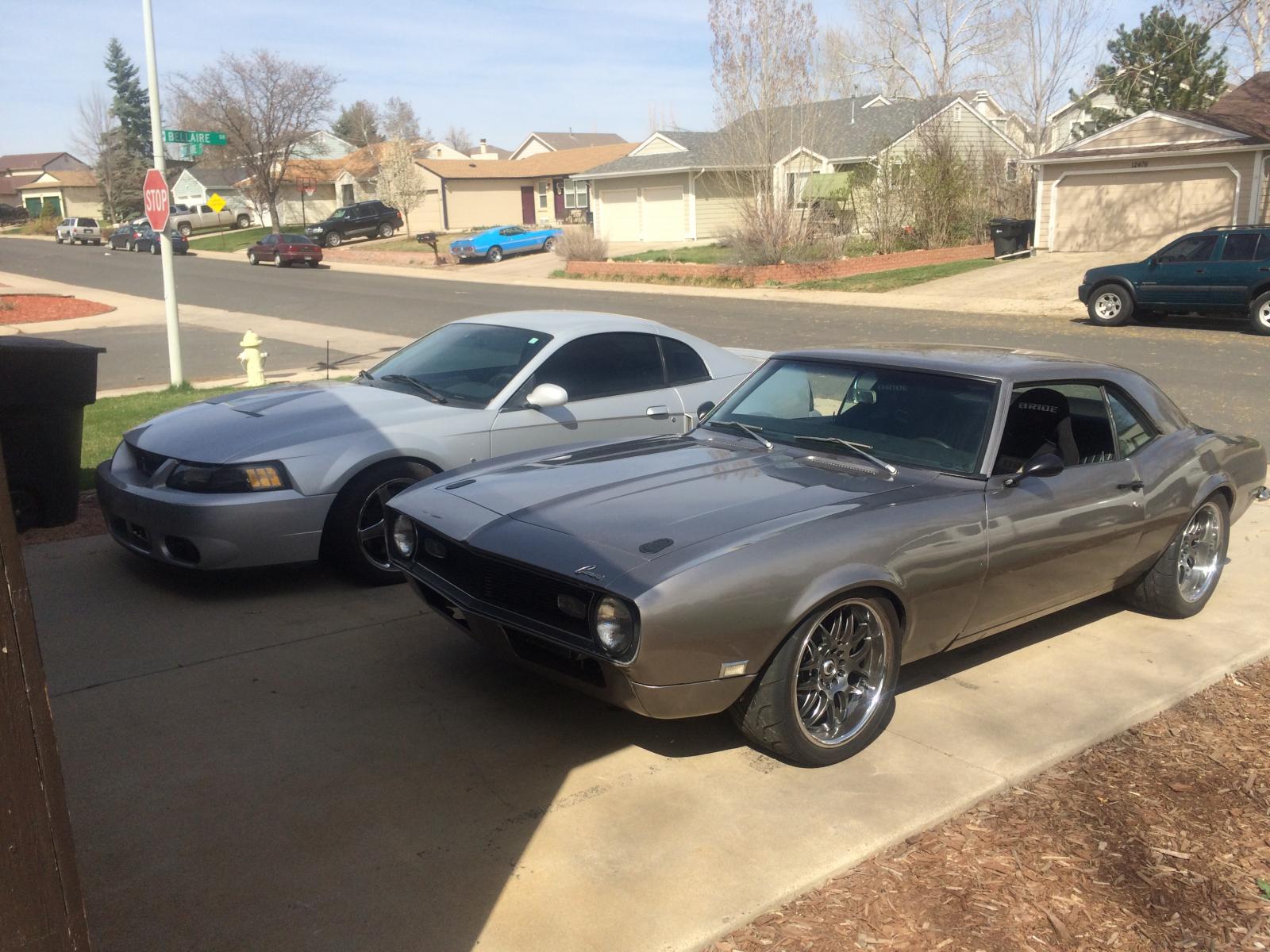

      Here are some quick pics that I have.... Not front tire specific but you can get an idea. If you want some specific pictures let me know. As far as the tire rubbing I am using a Jeep steering box and ride tech tru turn, so that may be part of it as well, I just fabbed some quick bump stops so it doesn't rub when racing or sliding around in empty parking lots haha. Another thing to mention is I do not have inner fender wells due to my hotside pipes which eliminates a lot of inner rubbing concerns but I can take some pictures of under the hood so you can see there too just let me know.

      2,624
      Quote Originally Posted by the owl View Post
      That setup looks nice. Are the fronts 35 series? What are the rear sizes?

      Thanks for the complements guys. I will post up a build thread on my car here soon to have all the specifics.
      My tires are 265/35/18 front and in that picture I have 315/35/18 drag radials on. The rear wheels are only 10.5 wide so 335's would look a tad goofy. My rear end is narrowed 1" on each side. and its a stock subframe with truturn but speedtech everything else including the chicane kit. I can't say enough great things about speedtech, they have been awesome products, awesome service and great prices in my opinion.
