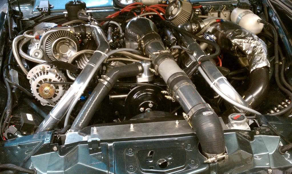

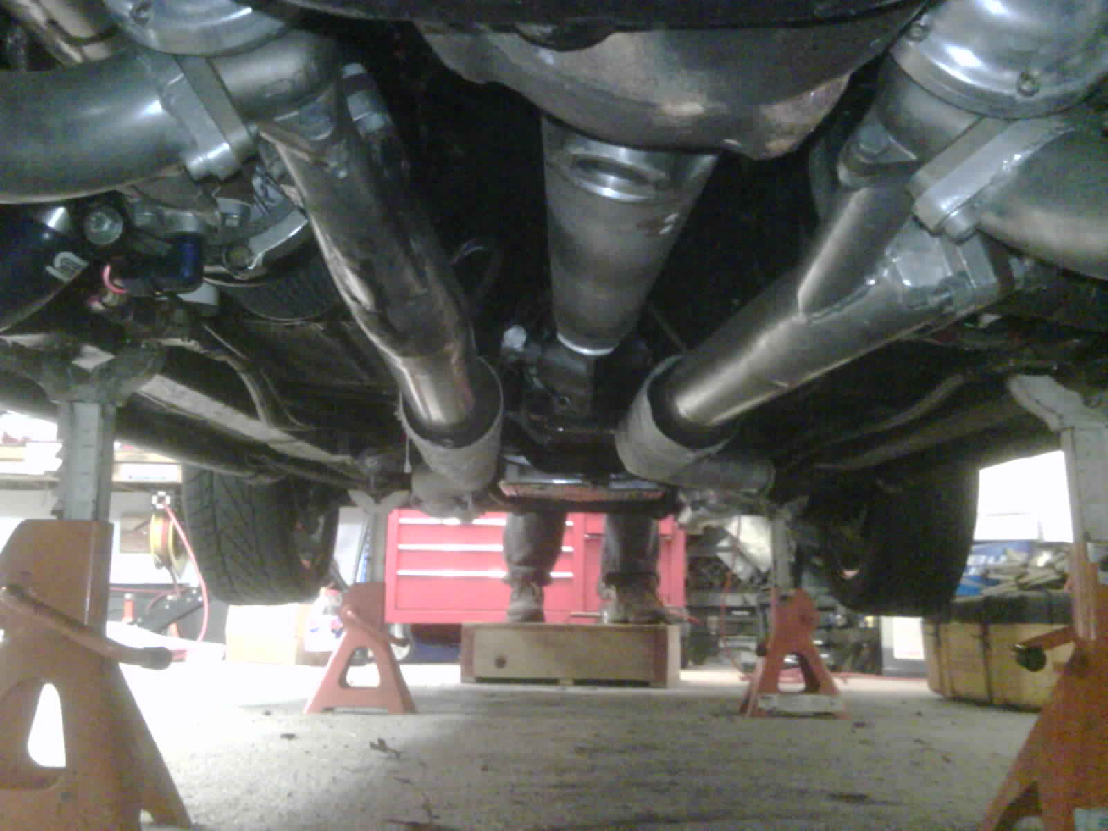

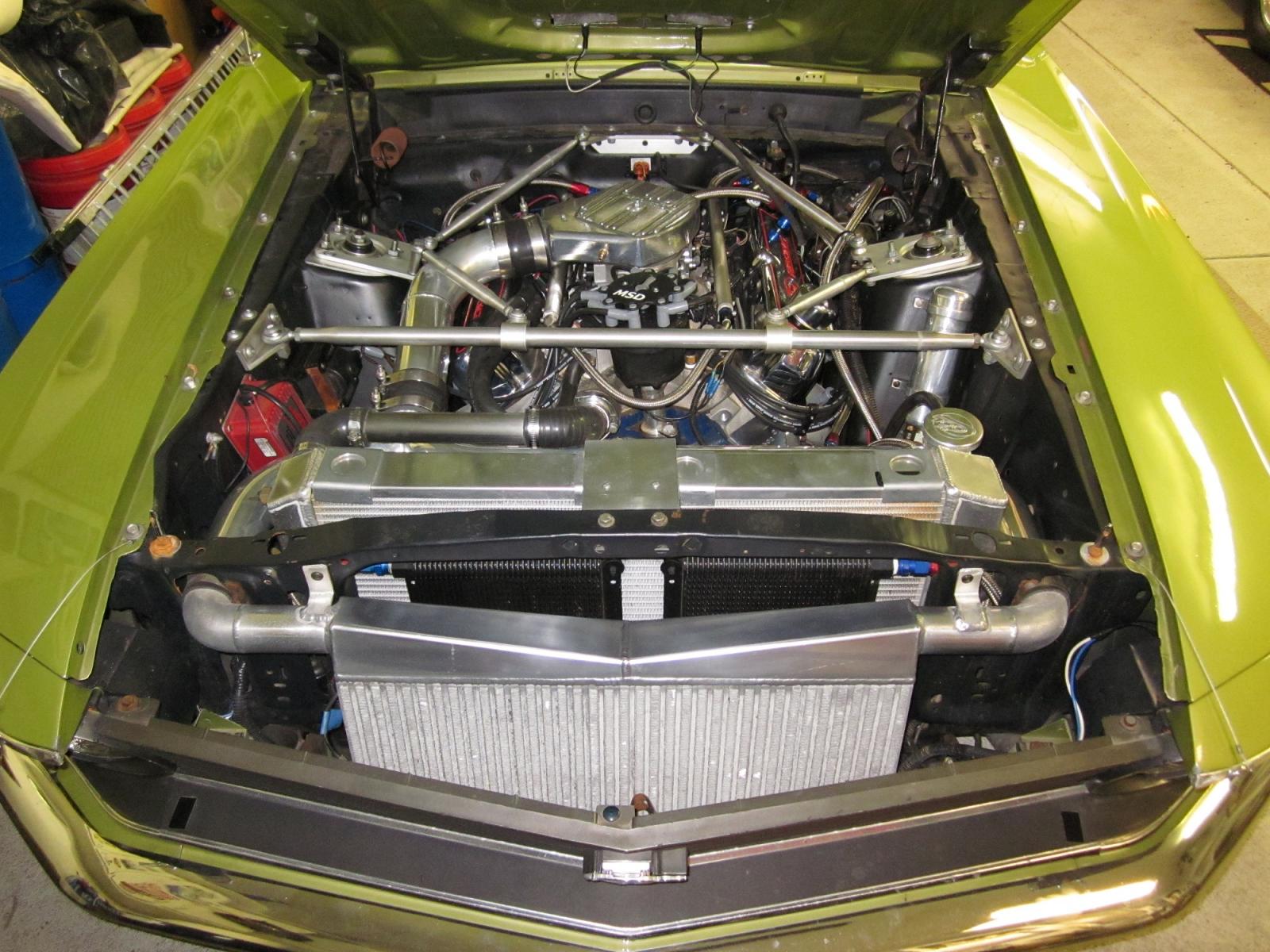

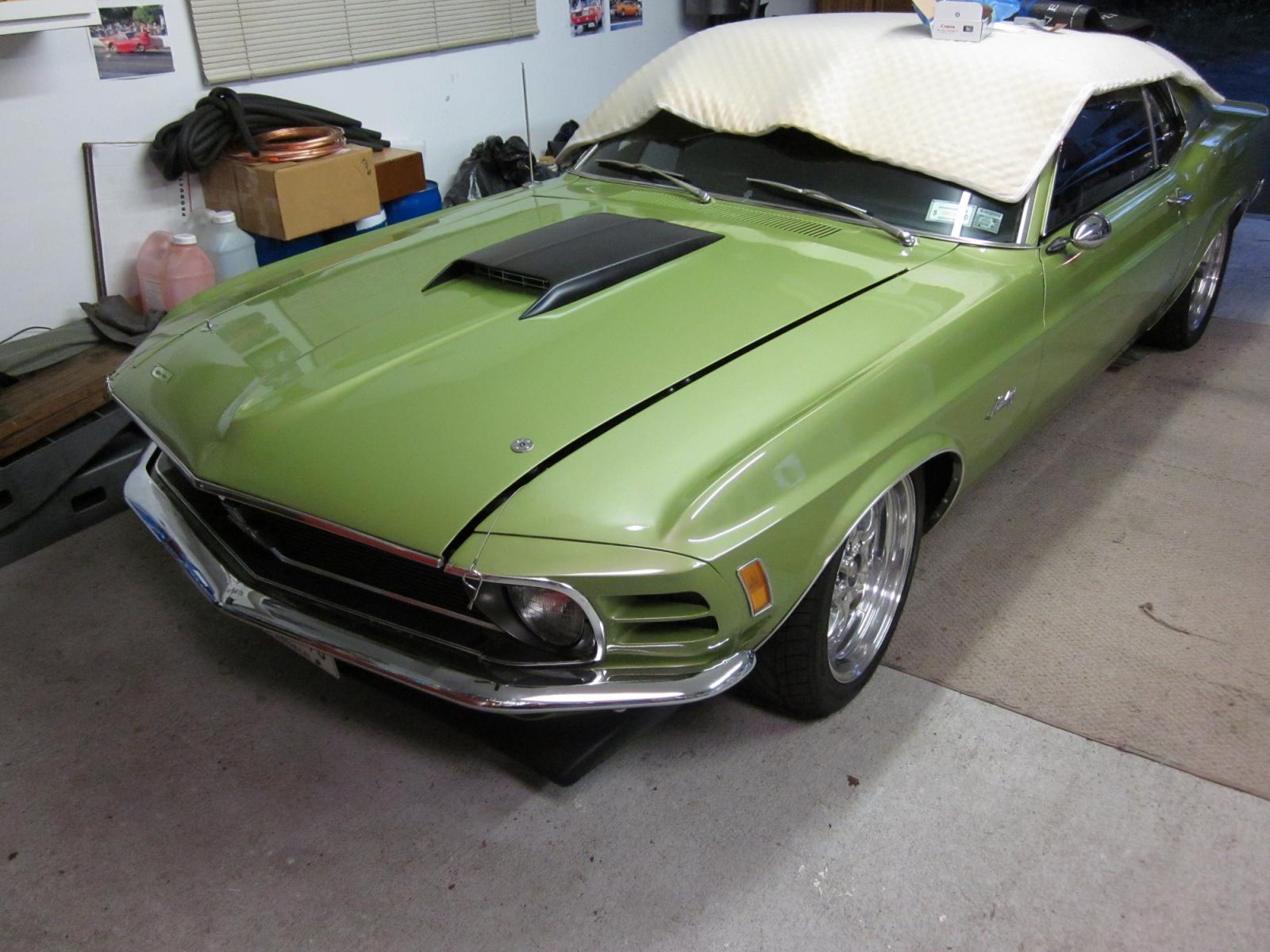

      Hi guys iam running a bill mitchell 427 with twin rear mounted 60 trims iam currently redoing the wireing and putting in an accel dfi. Iam hopeing for 580 rwhp with my setup i might do e85.

      [QUOTE]70 mustang fastback 427 bill mitchell twin 60 trim turbos remote mount. Currie rear air ride gear vendors tranny ssbc brakes 4link and accel dfi.[QUOTE]
      Is that one of the STS systems? How easy was the install? How do you like it? I want to run twin turbos but just don't know if i want front or rear mount on my 72 Nova...
