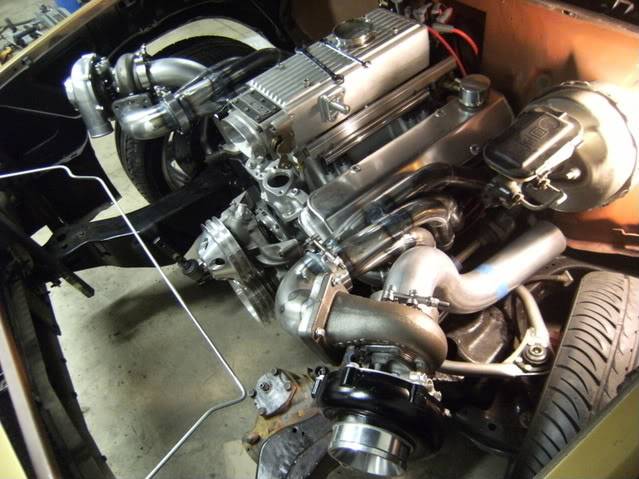

      Here's my turbo project.. 1969 GTO clone with stroked 400 engine and T88 single turbo all stainless piping..
      The pics are old... It will be finished next month!
      69 "GTO".. 18" custom ET wheels with 305 nittos/Dude built 464 Injun/round port heads/turbocharged-Single 88mm hybrid/316 stainless headers & exhaust/gunmetal gray/complete LS1 f-body brake swap/12 bolt/built 400 tranny/fiberglass street frontend etc.

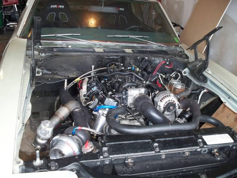

      Lot's of sweet setups. My Wagon will be getting twin T61's to feed the 355 through an HSR intake. This will hopefully commence soon after the rack and pinion is setup, and the 3-link rear is complete.
      Some info:
      .030 over "010" 350 block (355ci)
      Forged pistons, rods, and crank.
      ~9.0:1 Compression ratio
      224/224 .488/.488 114lsa cam
      Holley Stealth Ram
      Syclone ECM
      40ish# injectors
      Innovate WB02
      Twin T61 turbos, w/ antisurge housings, .96 A/R
      3" DPs into oval exhaust, dumped Super 44's

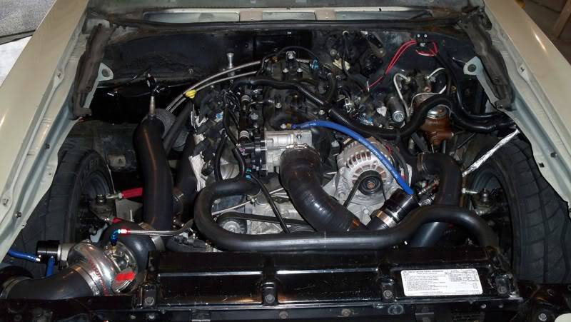

      Work in progress...
      Here's my wagon so far... Hopin' to get around 700hp to the ground. We'll see.
