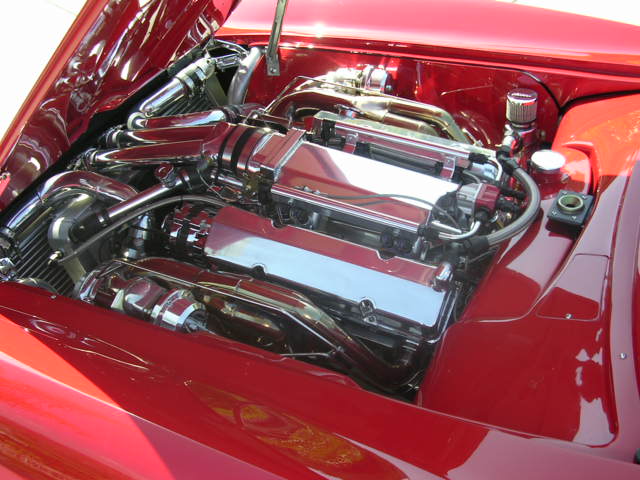

      hi just a 355 TT w/ 4 dellortos..soon to be replaced by a 598 that someday may receive 2 turbos also.
