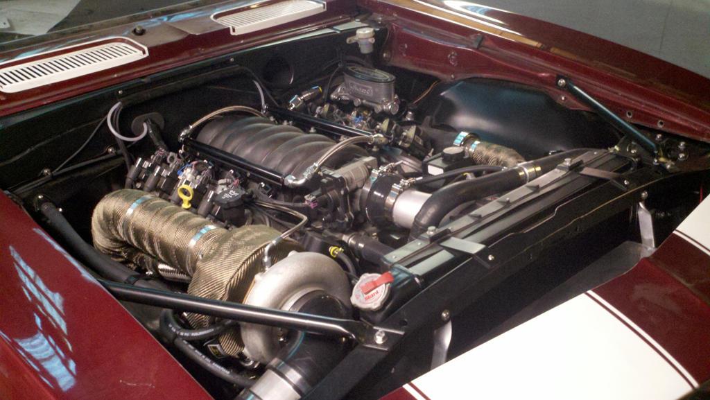

      LQ4, T56 and a Precision 7675. It's 99% done.
      Attachment 52536
      Can you give some more details and/or pictures on the air filter and inlet duct. Your turbo placement is very similar to my twins in '69 Nova, and I want to pull fresh air from somewhere behind the headlights.

      Quote Originally Posted by Chevy406 View Post
      I am going to hold off posting any pictures of my home built junk until it is a little more presentable. It's a pretty high bar set in this thread...
      It's nothing fancy, just a 4" 90 degree silicone bend into a 4" piece of stainless pipe aprox 4" in length, going into a generic K&N cone style filter. If you look at the turbo from the top, it's clocked about 10 degrees clockwise. This was done so the elbow would clear the radiator. My tuner wasn't thrilled with the silicone elbow - he thinks a thicker rubber piece is better because the thin silicone style can suck themselves shut if the filter doesn't flow well enough. I didn't have that problem at 12psi.
