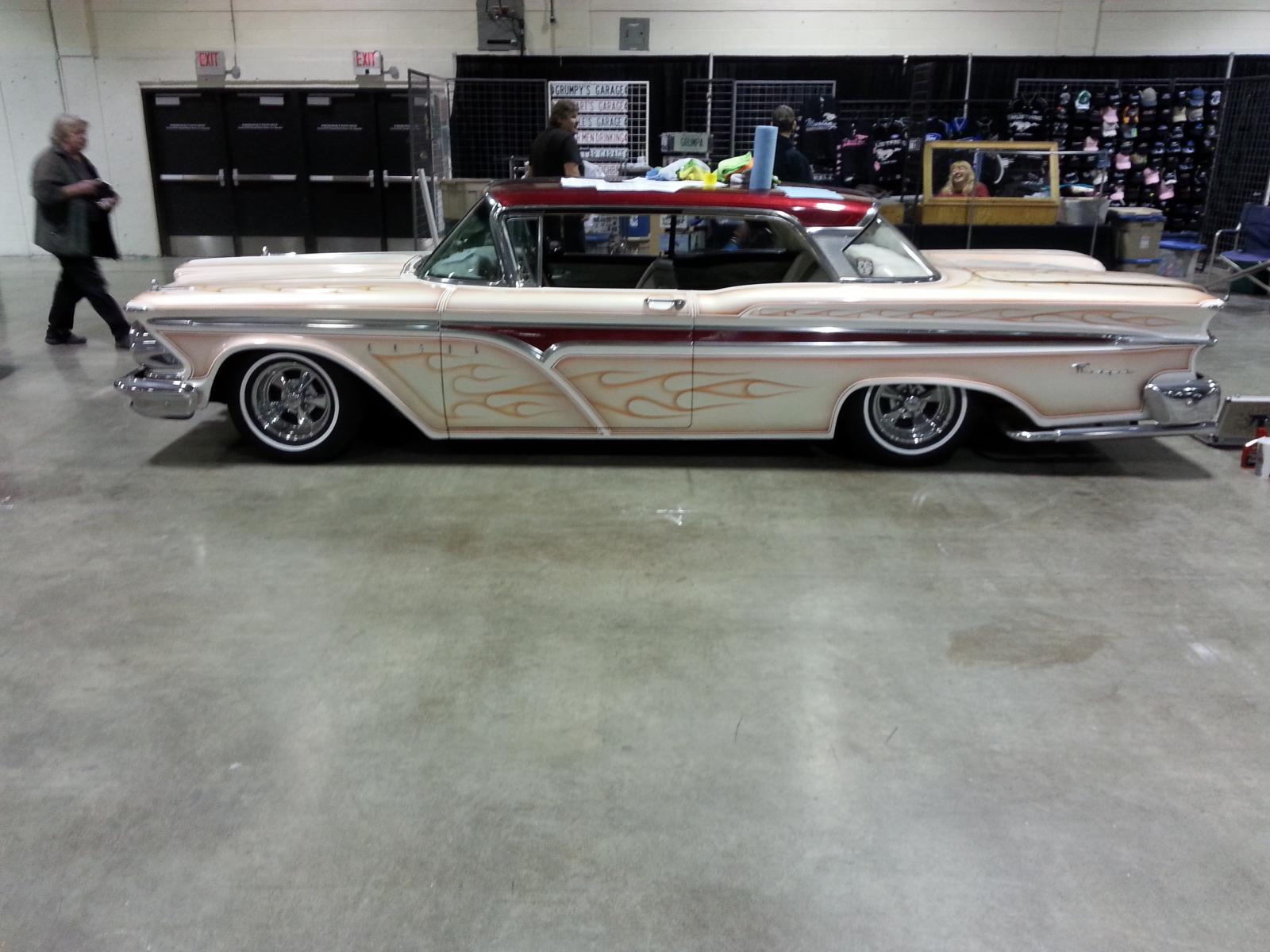

      The stance of my Edsel. This is at the 2015 World of Wheels in Calgary

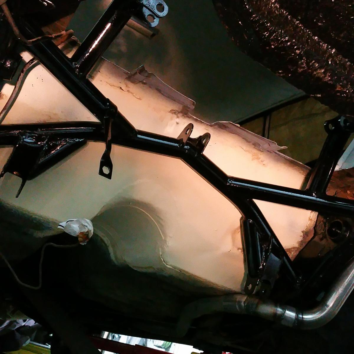

      Here's a better view from the top. The exhaust runs on the outside of the frame rail, since I removed the leaf springs, there is alot of room for the 2" pipes, I wrapped them for extra protection from heat.

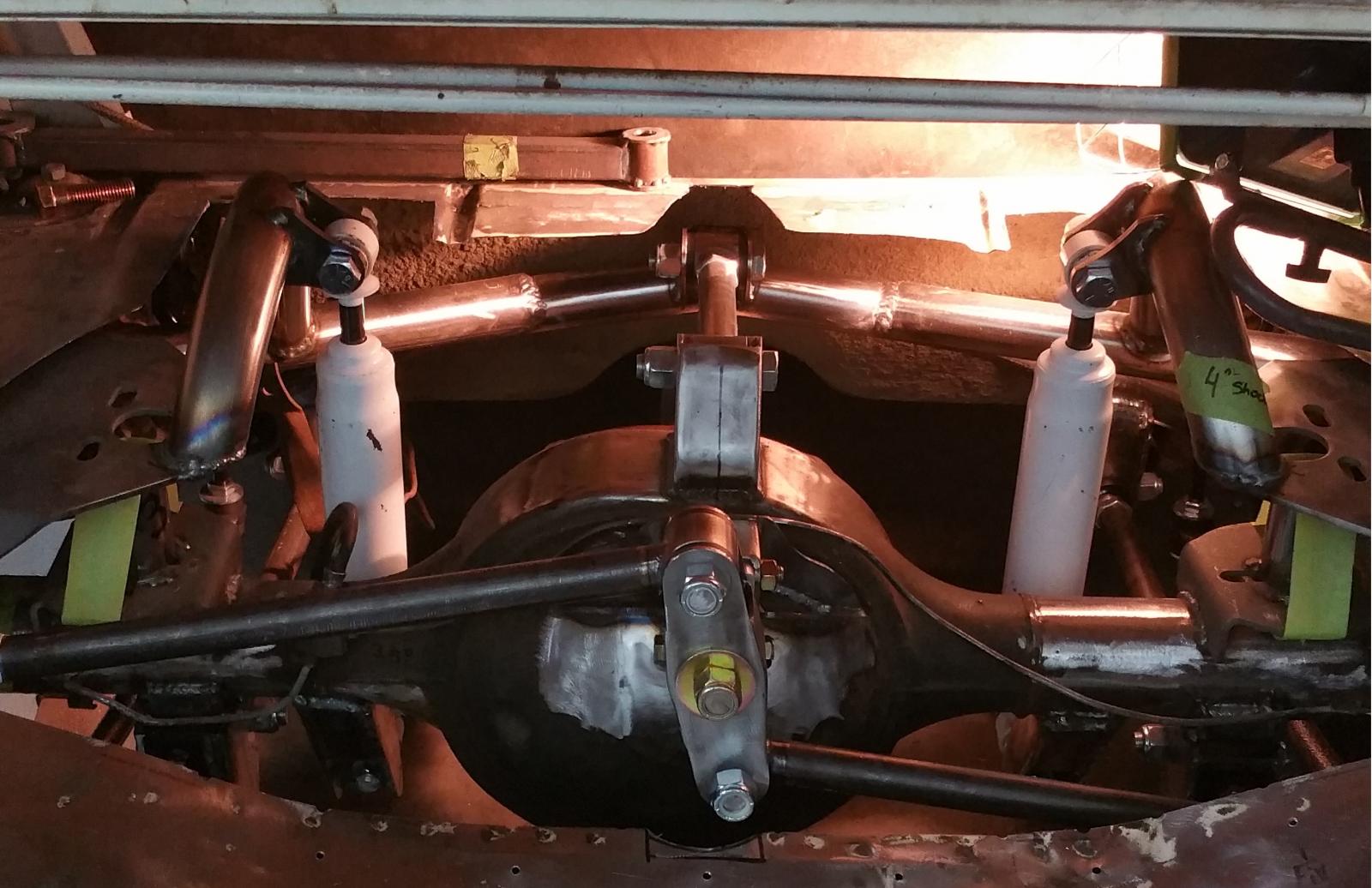

      here is a mock up of everything put together. I now realize after lurking on this forum, that the watts link being slightly above center may be too high, but hey, its a street car, I have a 1 inch rear sway bar in the back, a 1 and a half sway bar in the front and commonline airbags, so hopefully it all works out. We will see.

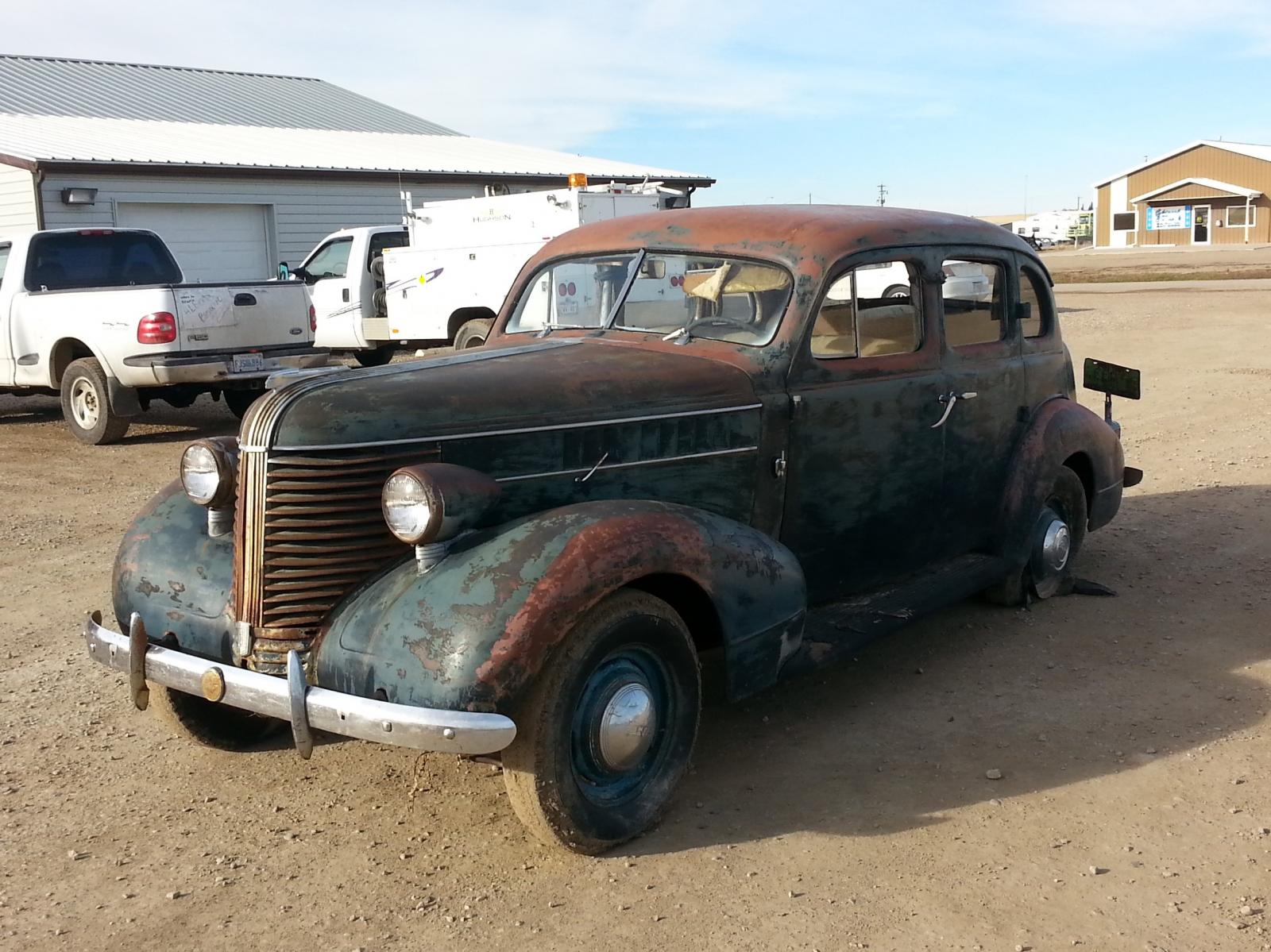

      The 38 Pontiac touring sedan, soon to be Pontiac Pro-touring Sedan. Hopefully I can pull enough knowledge from you guys to have a nice handing luxurious car
