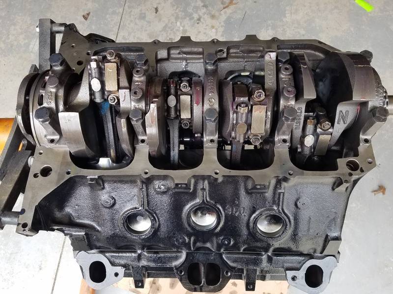

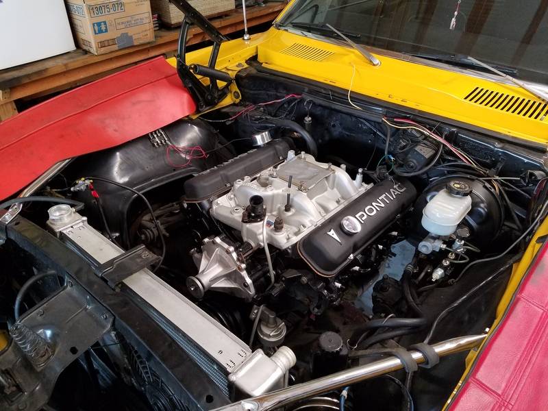

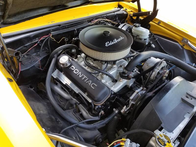

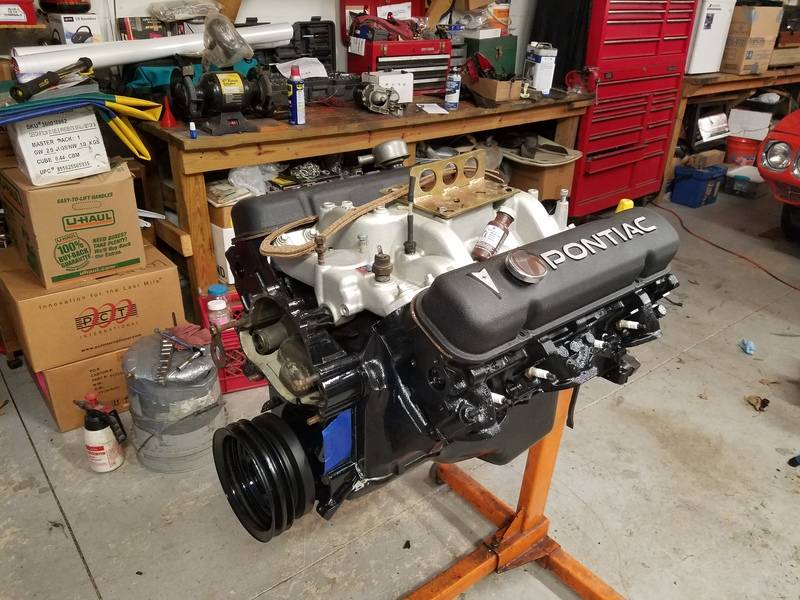

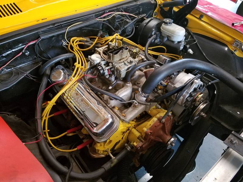

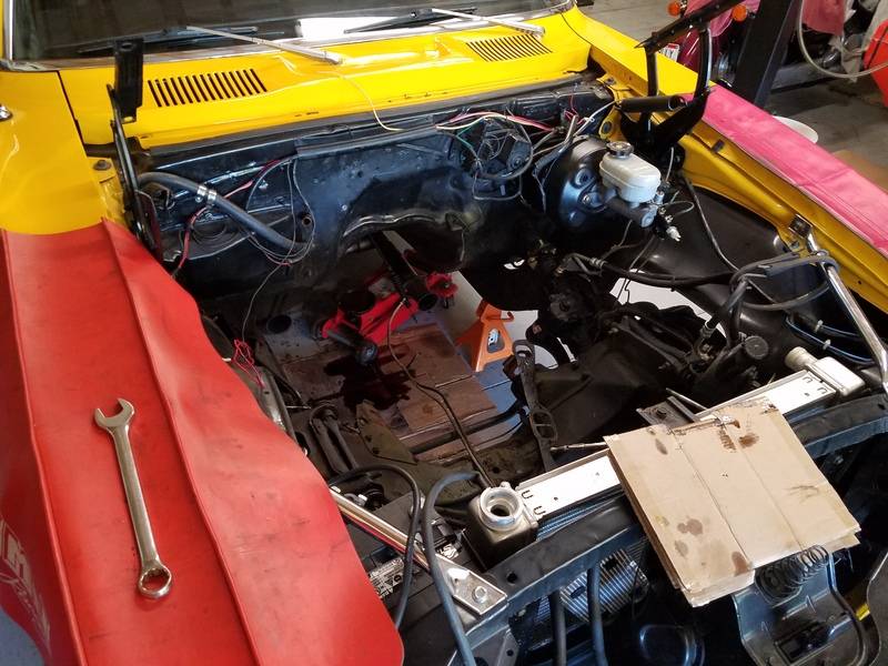

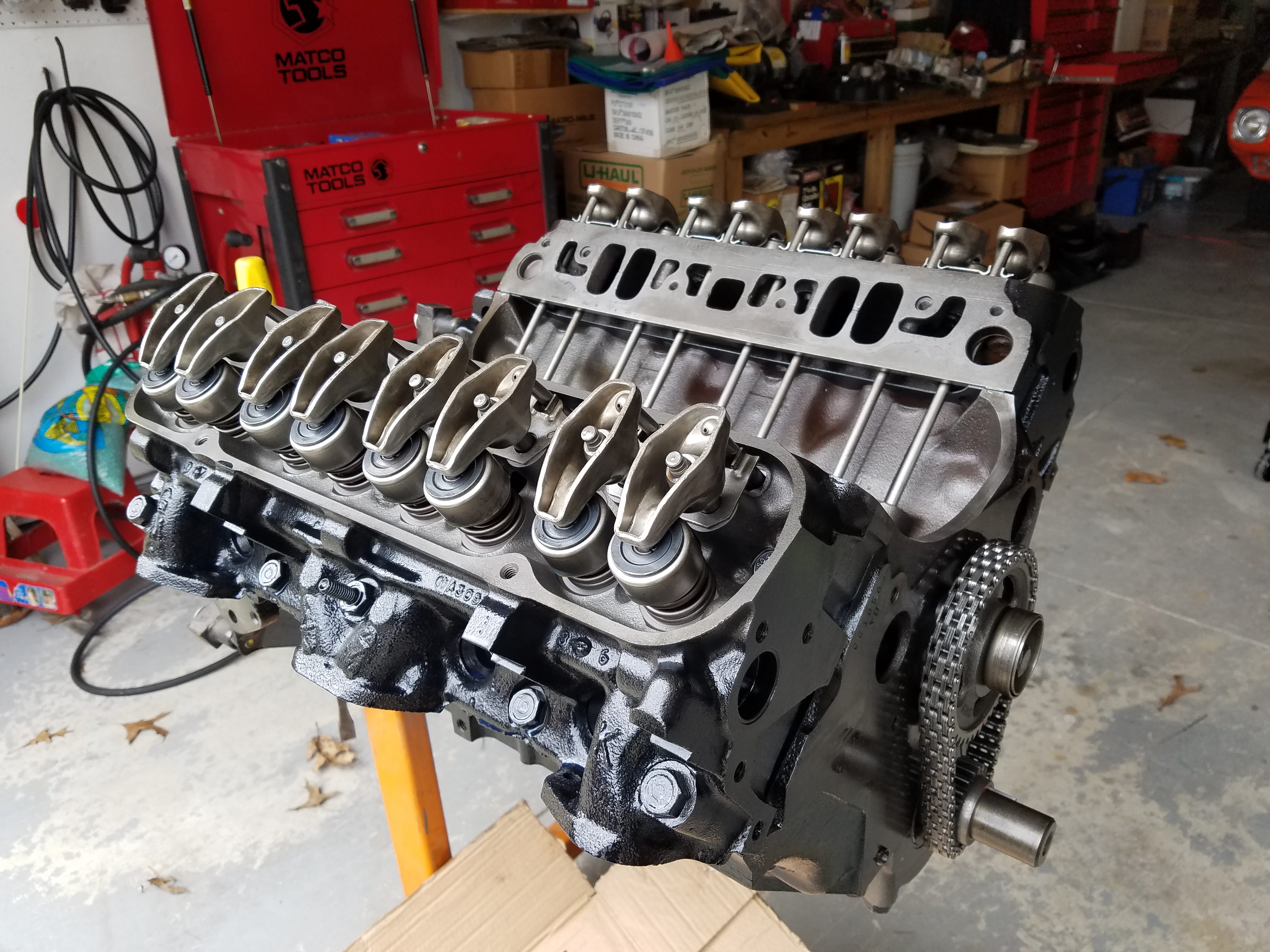

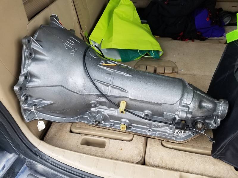

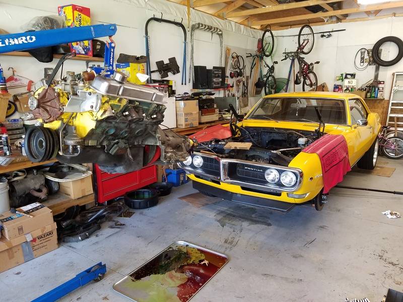

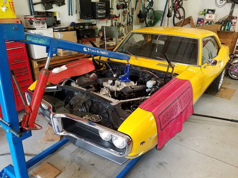

      For something as seemingly simple as replacing my motor with the same motor, the swap was a real PITA! It was just one thing after another!!
      -Took a while to reassemble the motor, I was waiting for a friend's help because certain parts were intimidating to me since I'd never dug that deep into a motor. I also found out I needed a new dipstick tube, so that postponed it due to slow shipping from Classic Industries.
      -I get to the point where the engine is ready to pull, and the brand new picker I bought is TOO SHORT to reach the carb plate! So I have to stop and borrow a friend's...
      -Found out the Flowkooler water pump on my old engine wouldn't work on the new one, 8 bolt on the '68, 11 bolt on the '69. Seemed as simple as ordering a new 11 bolt FKWP? Nope, they're 4.5" long, so now my pulleys don't line up!!! Tried a March pulley from Summit, still too short. PM'ed with some people back and forth for over a week before ordering a certain stock pulley needed to make the swap work, then waited a few more days for it to arrive. All good now.
      -Bought plug wires for a stock '68 Firebird...meaning with points. New motor came with a HEI distributor, I was unaware plug wires would be different!
      -New crossmember for the 2004-R is set back further, so it interfered with my H-pipe. Had to chop it off and just run true duals.
      -Finally got the motor fired and broken in, after another small setback. Had to swap out the fuel pump, tried to use the one that came with the motor, but it was shot. Another week passes before my friend can make it back over to tune it and make sure it's road worthy, and the 2nd time we start it...the throttle cable snaps!!!!! So I have to wait another day, after running down to Summit to pick one up the next morning.
      Doesn't seem like much now that I typed it out, but between parts setbacks, an expected/unexpected death (cancer), quick trip out of town with the family, my work schedule, gym schedule, family obligations, and my buddy's schedule, this whole process took over a month! I thought for sure it was simply going to be a weekend project. lol Oh well, looking back, it's cool to have the experience under my belt, and I'm glad I went this route, instead of parking the car for years and years waiting for some great build that would have never happened.
      The car's performance is beyond my expectations! Went through the typical hiccups with a drivetrain swap, few kinks to work out. Throttle cable was a touch too short, so it was causing the idle to hang up. Vibration in the drivetrain, fixed by the same shims I used under the mount on the TH350 when I had a vibration after that swap...to fix the pinion angle. Tach wasn't working properly, simply bought a new one. lol And I put a new set of gauges where the radio was mounted, between the console and the bottom of the dash, so I had that radio flopping around on the floor for over a week. Got a mount from a member here (see for sale section) that worked perfectly to place the radio in the factory location. I also finally added a set of Morris Classic Concepts 3 point seat belts. Way safer than the factory ones!!
      It drives awesome though, and overdrive is amazing!! 3.08 gears, and I'm only at 2000rpm's at 75mph. Around town, 50-ish mph, 1700rpm...it's lovely! The choke is also working properly for the first time in ever, so the car fires right up and runs great!
      Onto the pics!!

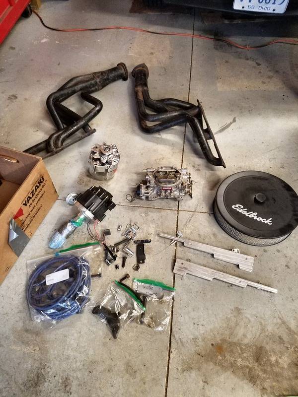

      Used motor came with a bunch of goodies! Selling off the stuff I don't need will help offset the costs.
      Freshly rebuilt 2004-R
      Reassembled
