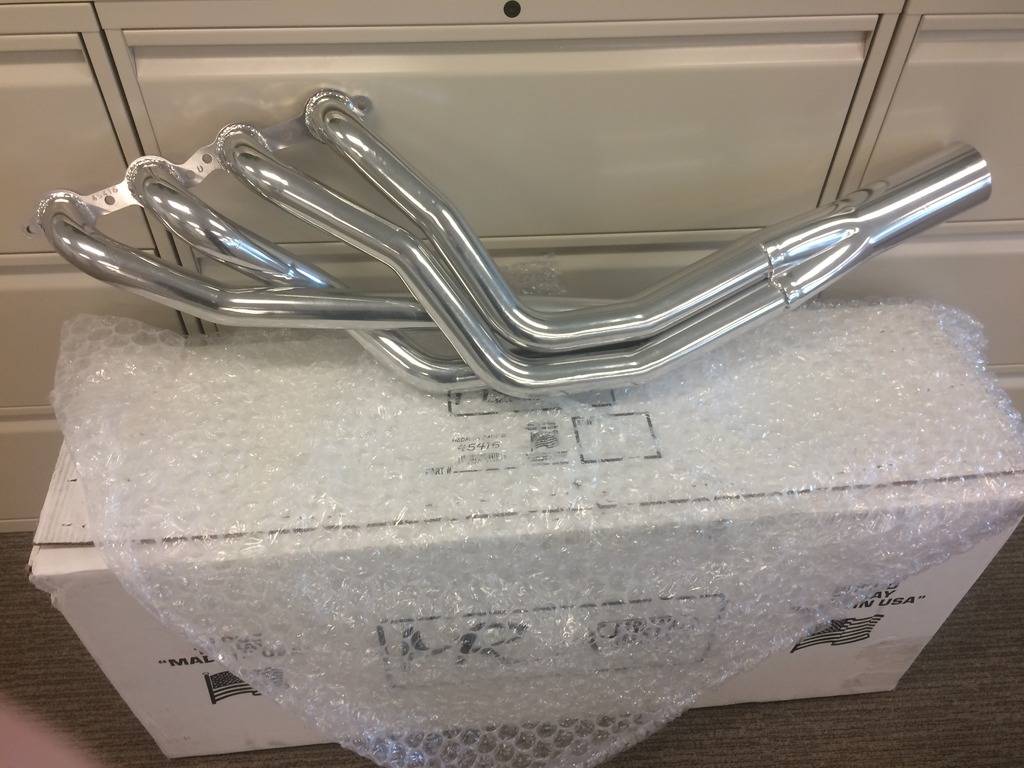

      tadaaaa!

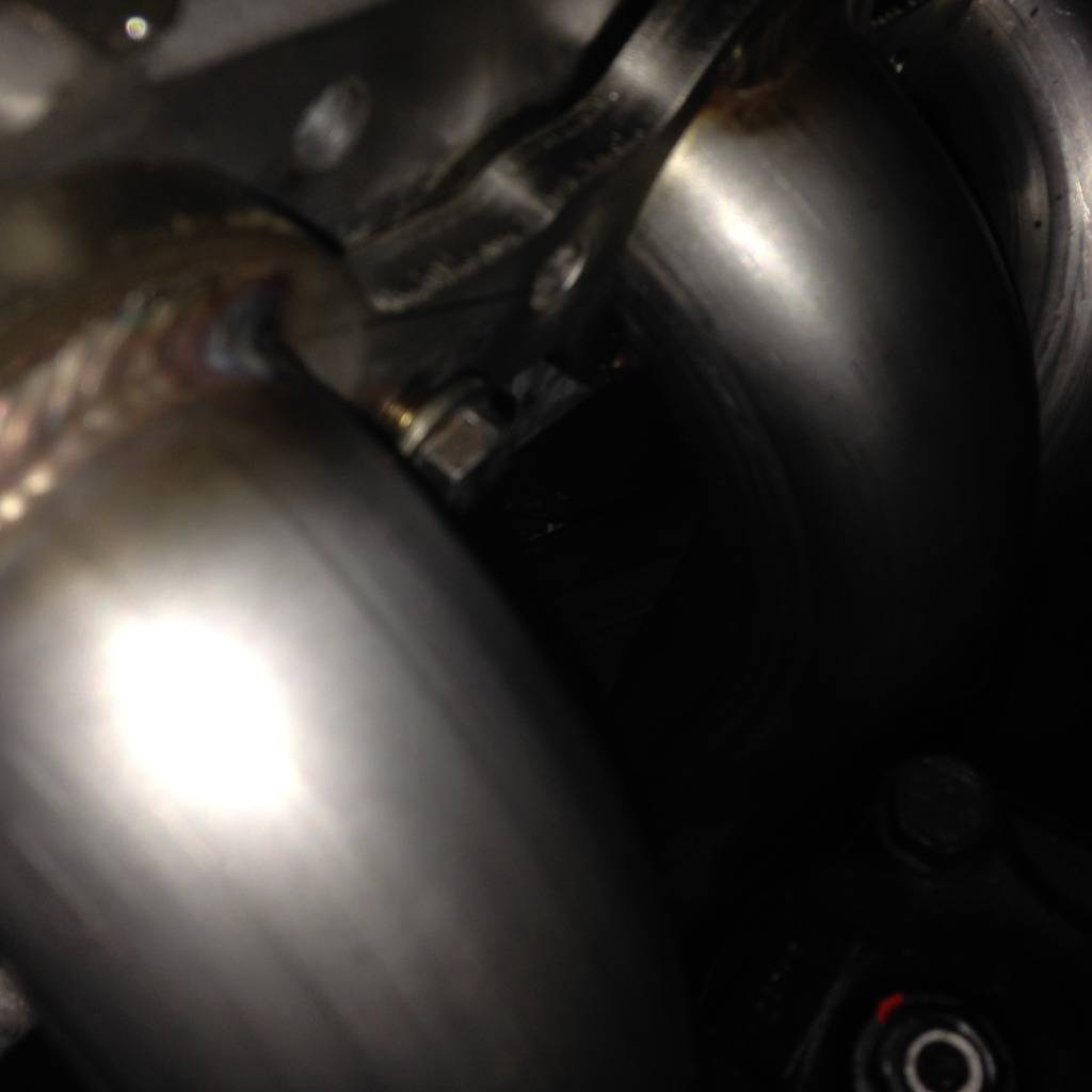

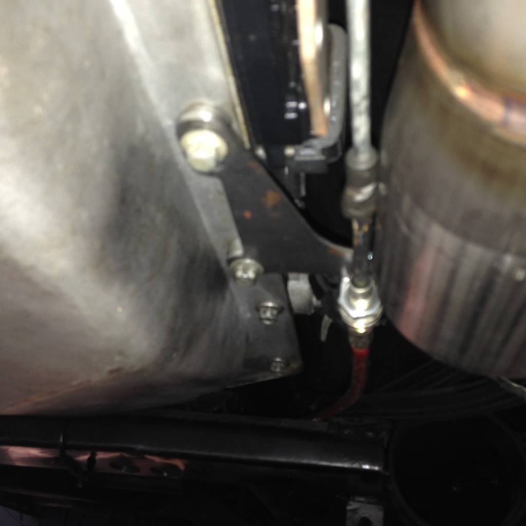

      I sent the hedmans back because my hood wouldn't shut with their motor mounts (blower on top of motor). I sent ARH my money and they don't fit with the 80e. they basically told me It was designed for the turbo 400 and wont fit with 80e....you would think they would put that on their site after running into the issue a few times.
      here is where the collector fit with ARH.
      and that wasn't even with the header torqued down.
